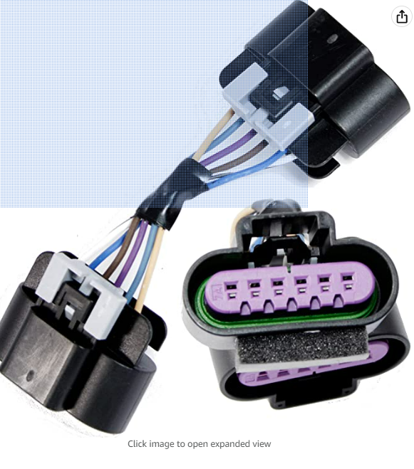

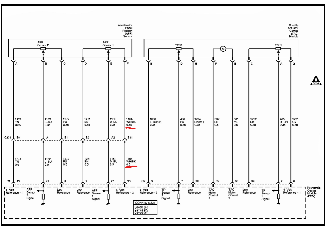

Had a little bit of time tonight and got the APP connector side soldered. When I took out the heat shrink connectors, 2 of the 6 pulled out with a bit of force. Another thing I noticed is that one of the old stock connector harness terminals came unseated from the harness. I was able to reseat this female terminal. All these things very well could have caused the P2138 code still. This now gives me new connectors and wiring all the way to 3-4” from the ECM C1 connector.
Also, I was able to remove the LSJ APP connector harness by wiring it correctly. For mine, it’s just a connector as the main harness and APP are male connectors. The wires do not cross as I originally thought. It fires and throttle works as normal.
