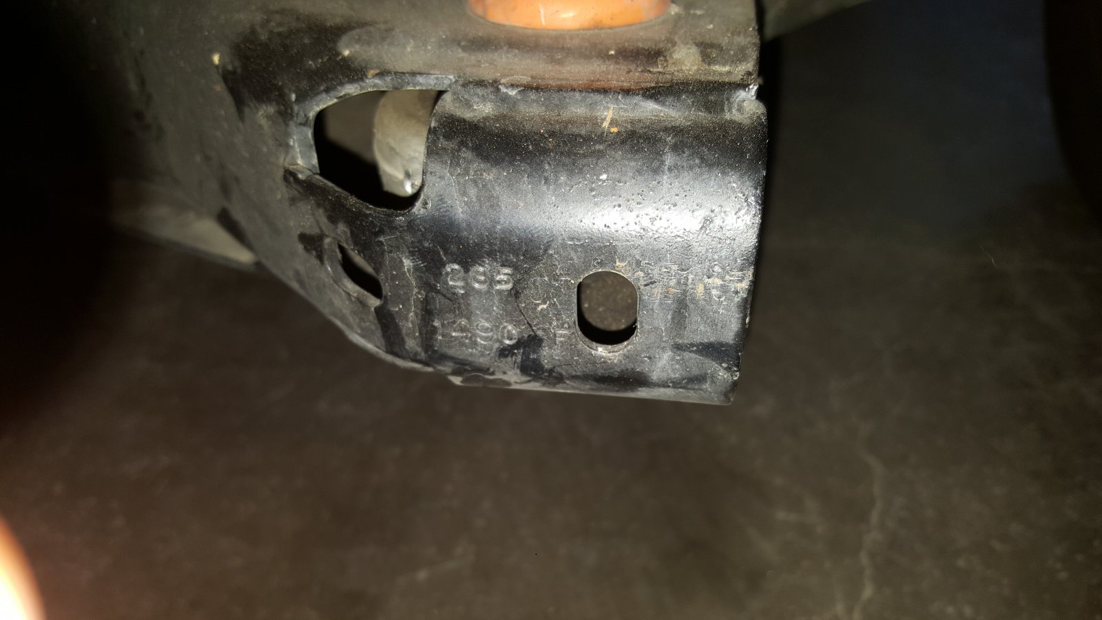

Part number for subframe?
On base models the sway bar attaches with one bolt on each side, SS sway bars attach with two bolts on each side.
Also when looking at the back of the subframe some of them have a hole out by the control arm area on both sides. Some of the don't.
