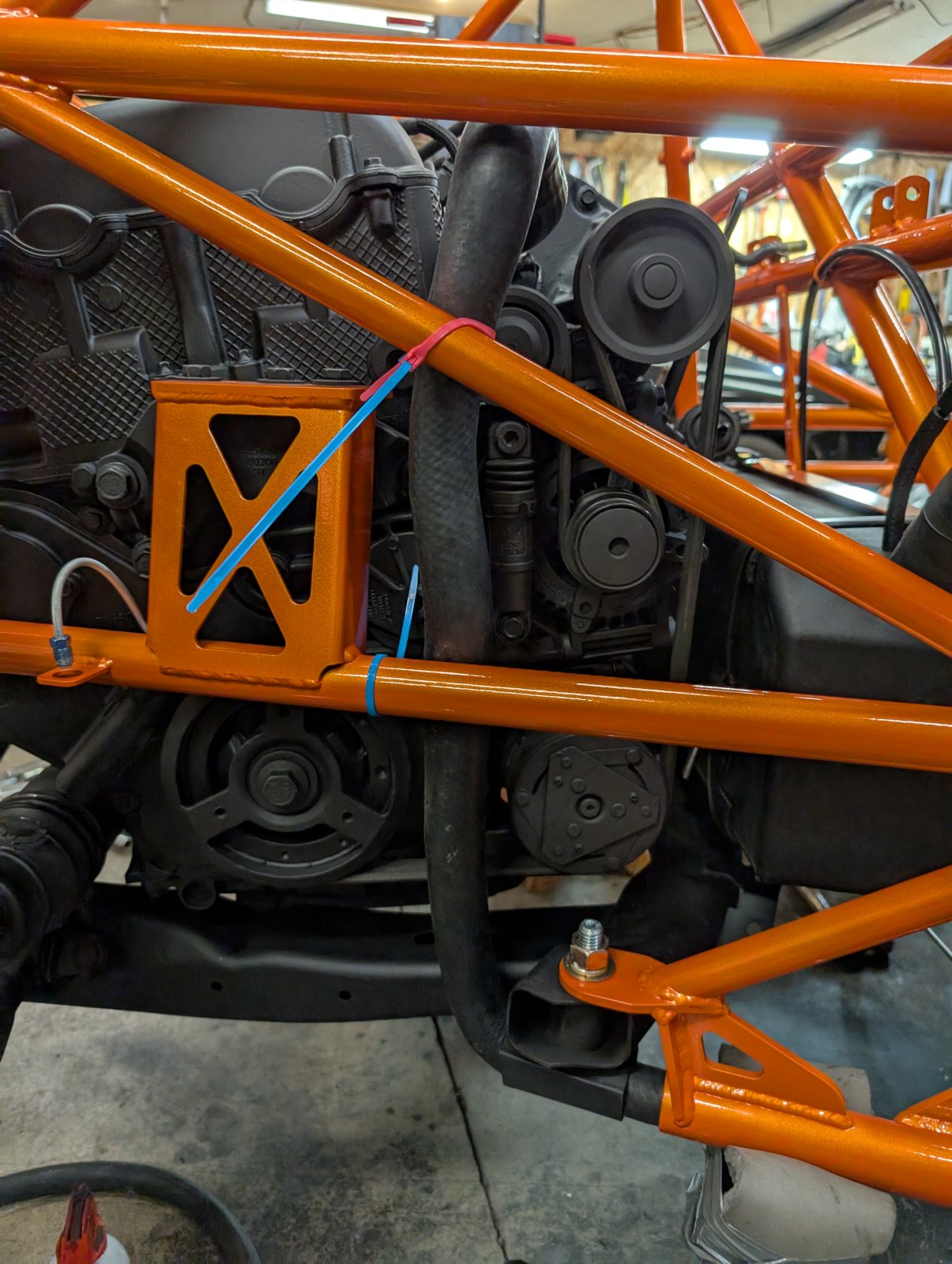

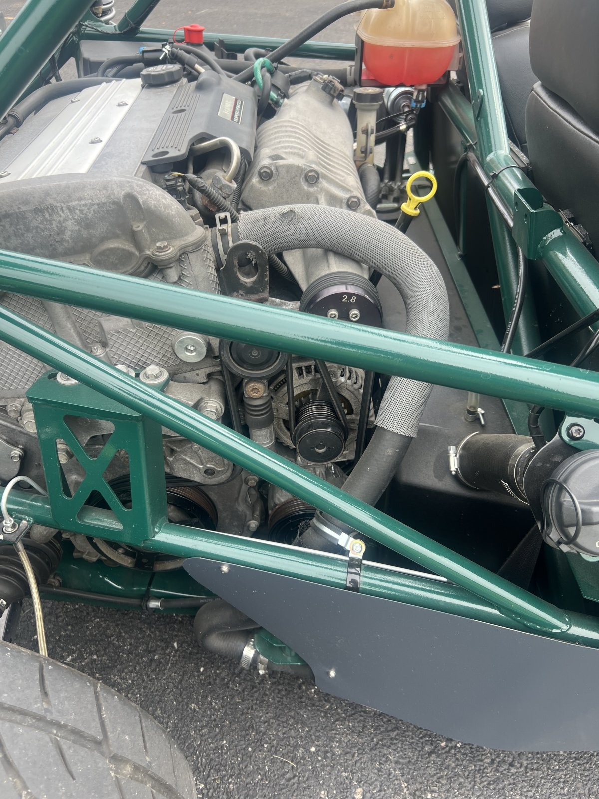

Does anyone have pictures of how they ran the passenger side cooling lines from the engine to the frame rail? The video is an NA engine and it looks like the water comes out of different part of the head.
Traé
1 piece, If I remember correctly it was supplied with the kit. I used clamps to keep it away from the SC pulley.
52604
Mine runs the same path as @Traé has his and is one piece. I believe it came from the donor vehicle. I will note that clamp in the middle section is to hold it to the frame and help keep the hose off the SC pulley, it's not a hose-to-hose connection.

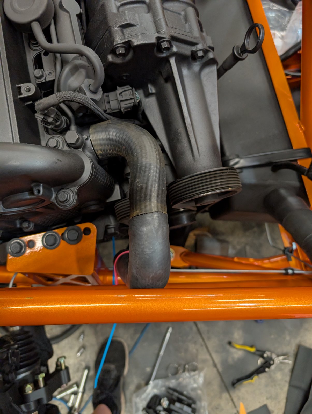

I turned 90 and went down before the sc. I also used a connector with a port on it so that I could fill the passenger side with coolant before sealing the system.

Sorry, noticed these are a bit old. I later changed to the connector with the port and used heat shrink tube to cover all of the connections/clamps
