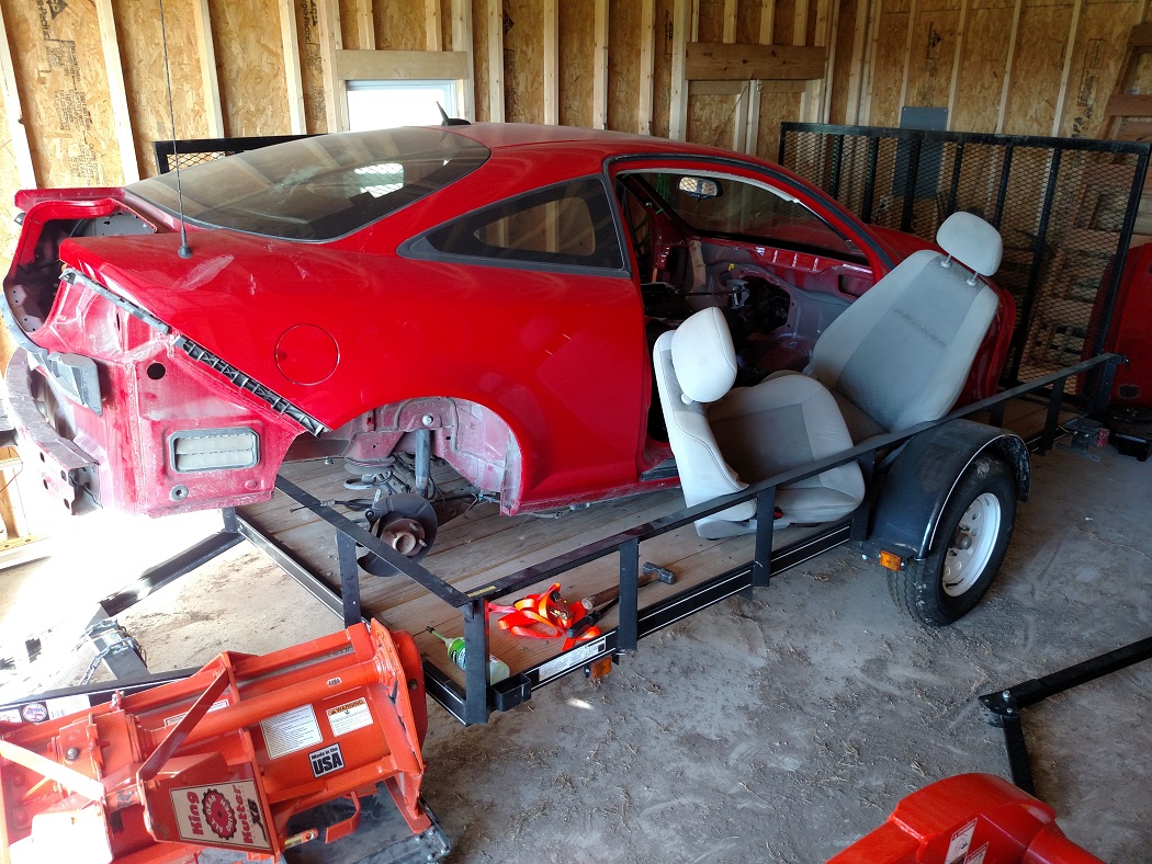

No one around here (Dodge City) really wanted to take the remains of the donor but I finally found a place that would take it but wouldn't give me anything for it.
At least it is gone.
Those seats were out of my 2008 Cobalt LS and were stained and beat up pretty badly (even if they don't show it in the picture!) and the driver's side seat foam was worn up and the seat really needed to be recovered. I put the SS leather seats from this car into my 2008 LS. Once school is about to start, I will advertise the 2008 LS again and maybe it will find a new home. In the mean while, I am driving it and getting used to driving a manual stick again! I haven't had anything with a manual transmission in it since the Stalker and that went away in 2005.

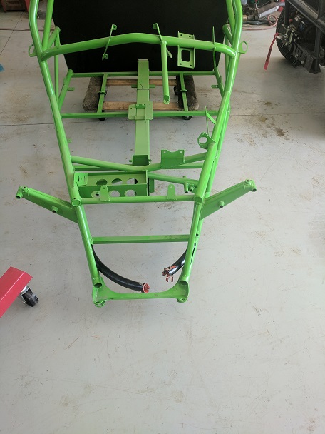

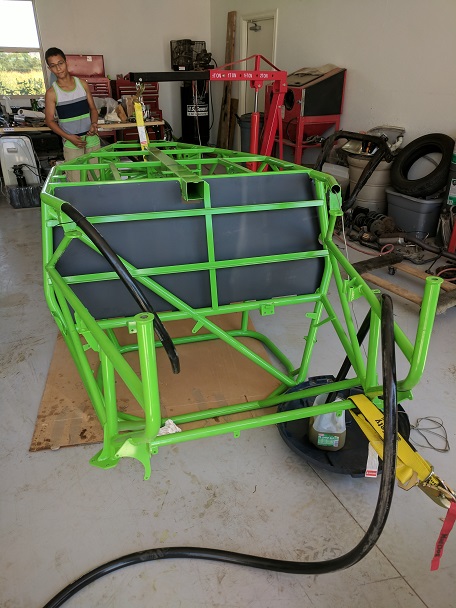

The most feared and stressful part of the build is complete! With the help of my neighbor and his son, we were able to pull the hoses thru the frame. We only broke two hoses, used up a bunch of safety wire (used to squish down the hose so that the washer wouldn't pull out) and even more nyties but the job is done! I found that the twisted safety wire did a much better job of clamping the hose than the nyties did. The problem was we ran out of the safety wire so nyties had to work. I did try some SS ties, normally used for exhaust insulation holding but could never get them tight enough to fit into the frame.
You might note that the hoses look different than the ones you were supplied in the kit. I gave up on those and purchased some silicon heater hose. Expensive and larger in diameter than what I expected. It had an 1" diameter ID with a 0.11" wall thickness means the total diameter would be 1.22" correct? Nope. There was another wall thickness of hose over top of the interior hose making it ~ the same diameter as the rubber hose supplied in the kit! I almost sent it back but I found it was easier to move in the frame (after lubing with such things as silicon spray lube and/or tire lube (which we ended up using) so in it went. Still not an easy install but I believe it was easier than the supplied rubber hoses.
You might also see a strap holding the end of the frame. It was attached to a Kubota RTV so that pulling on the hose wouldn't end up pulling the frame around the shop.
