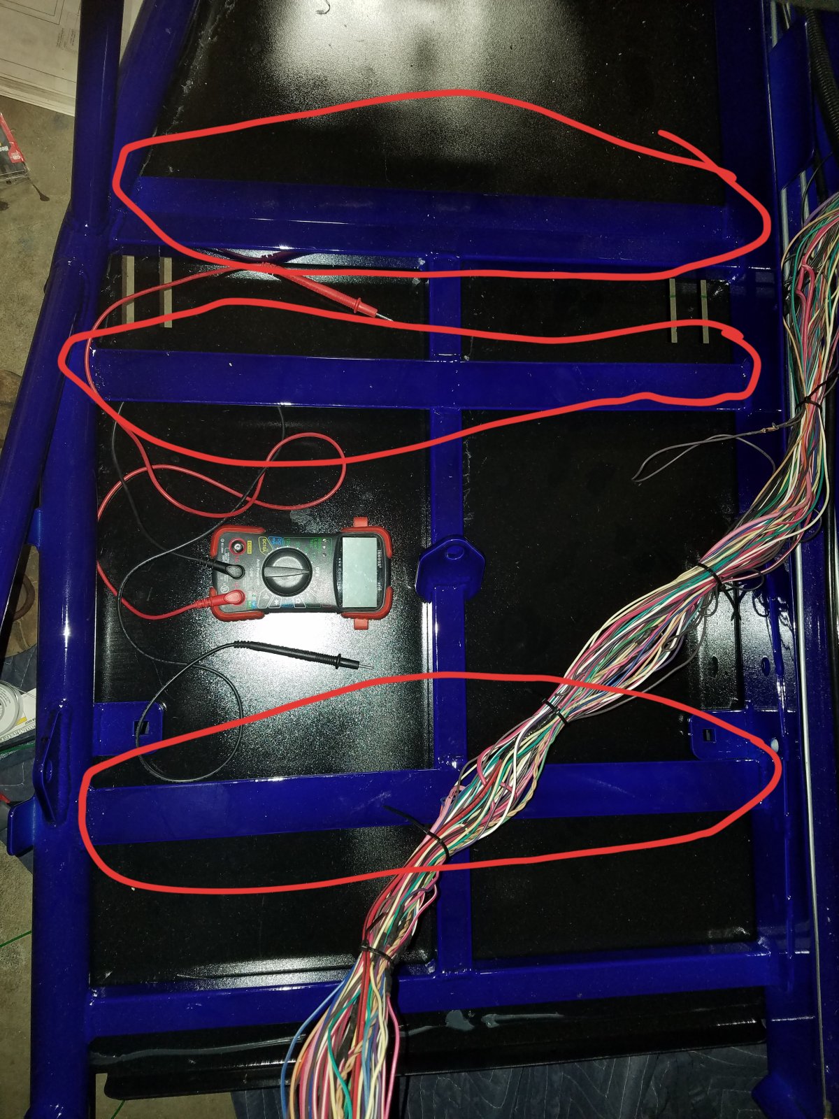

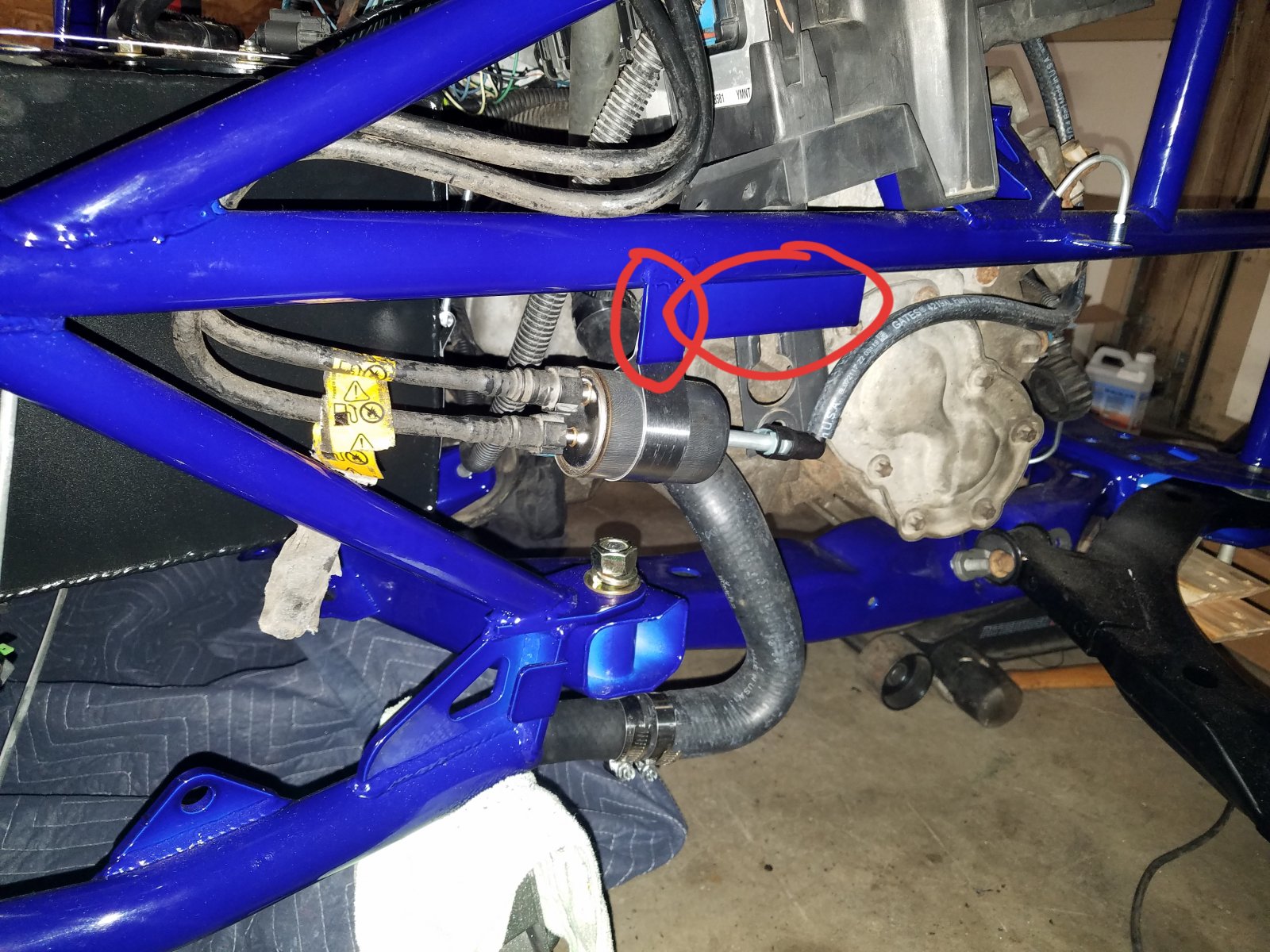

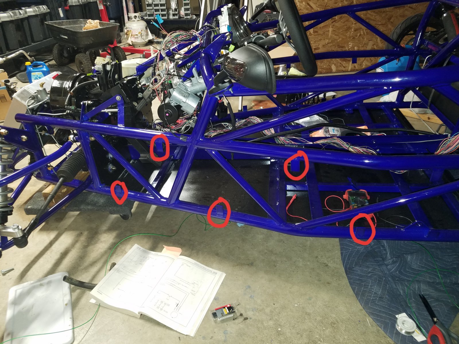

You may decide differently, but i had tabs welded on for attaching the side panels. I also welded extra support for the floor and provisions for my seat.
