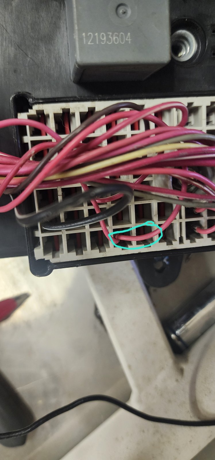

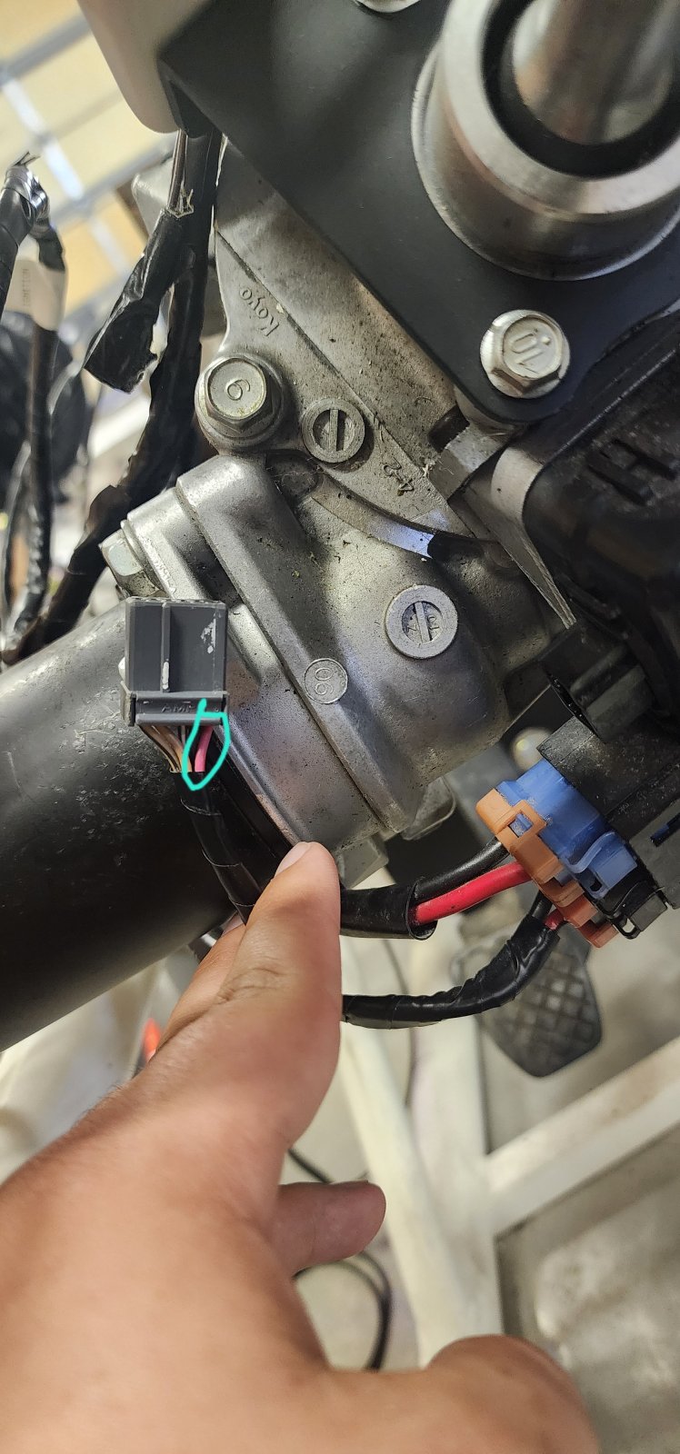

While testing voltage drop on every power imaginable, I noticed that this pink wire on the EPS module doesn't have power when the key is on. Anyone know if I should have power here, still no coms with the EPS module with solid theft light and no throttle body response?

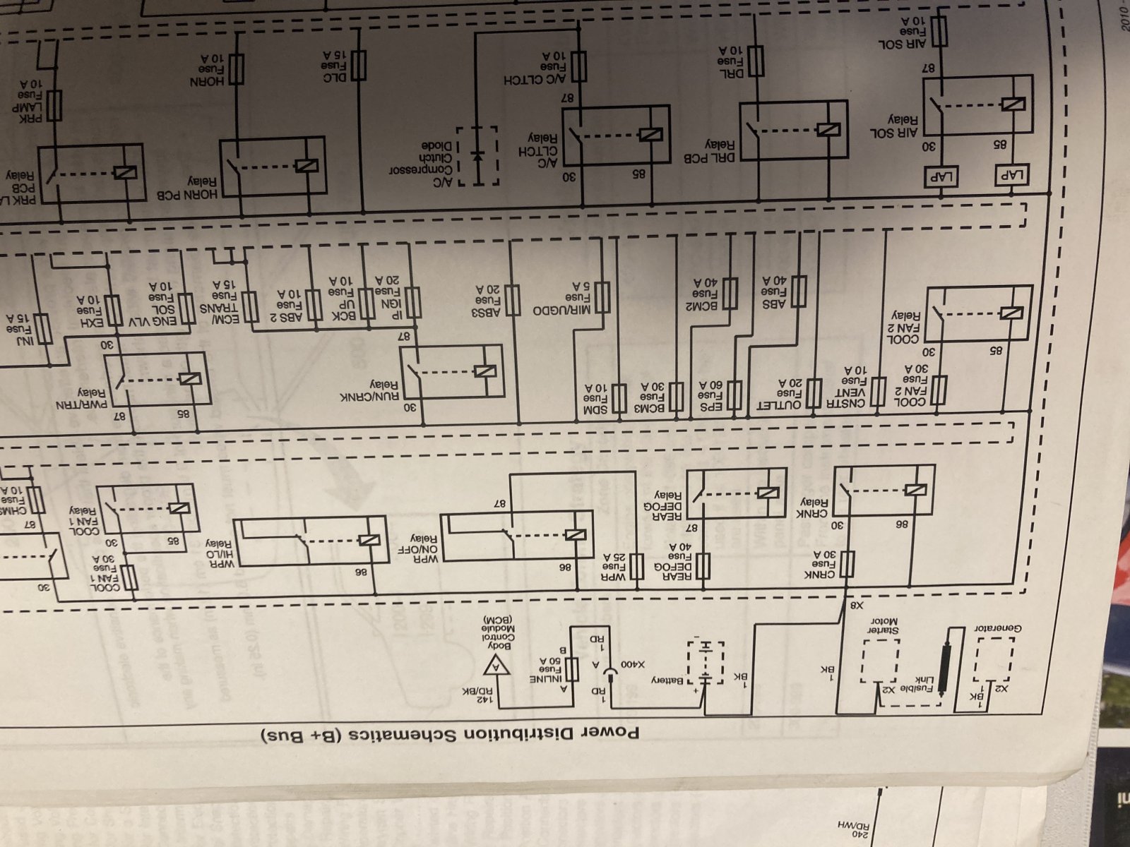

That circuit has a lot of failure points. But yes it should have power with the key in run position. If you track it back to no on signal at the run/crank relay, I’ll dig out the control wiring side diagram of the relay.

Dominicnicklyn
Your my savior, also do you have the book that these diagram came from?

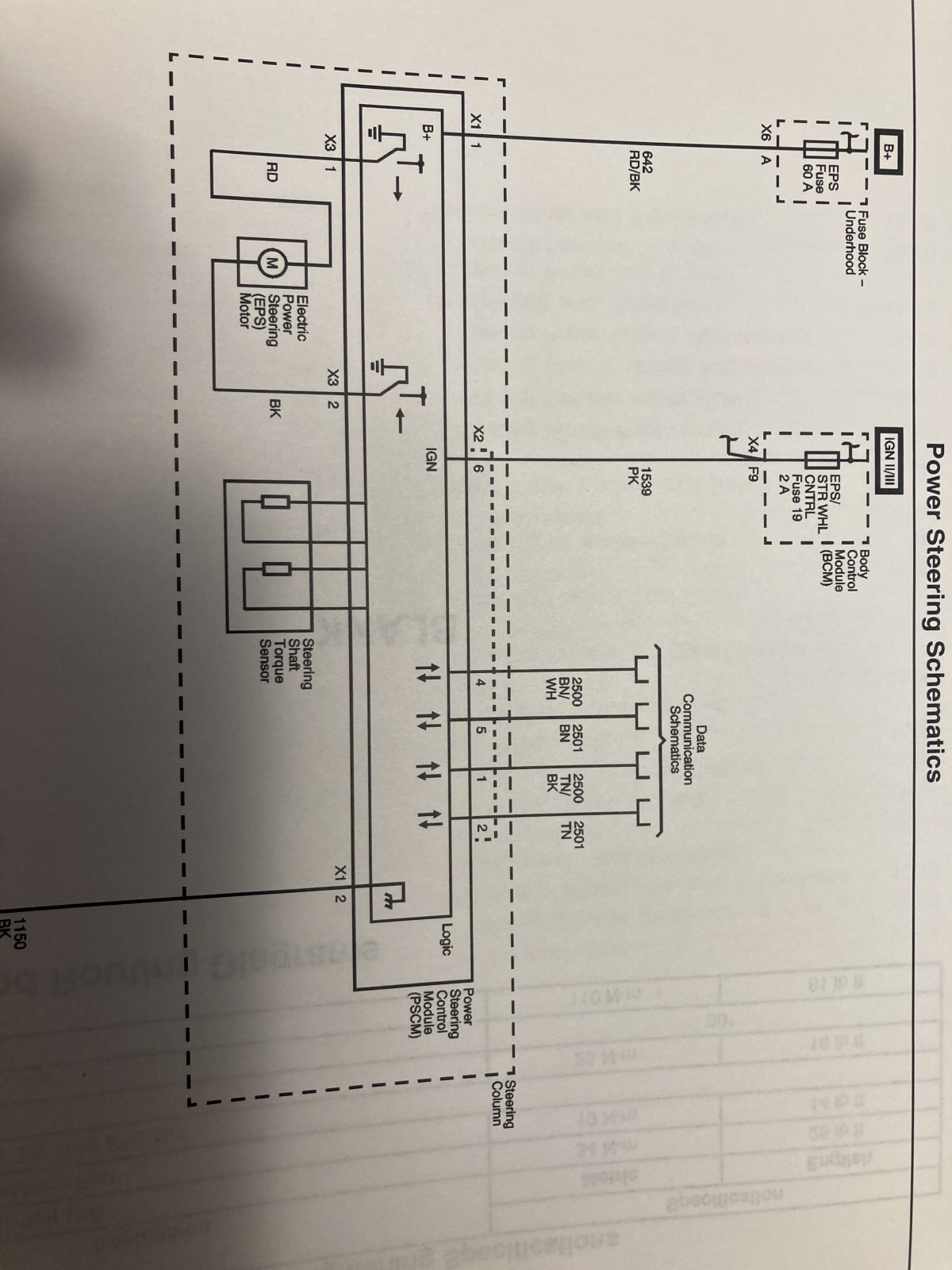

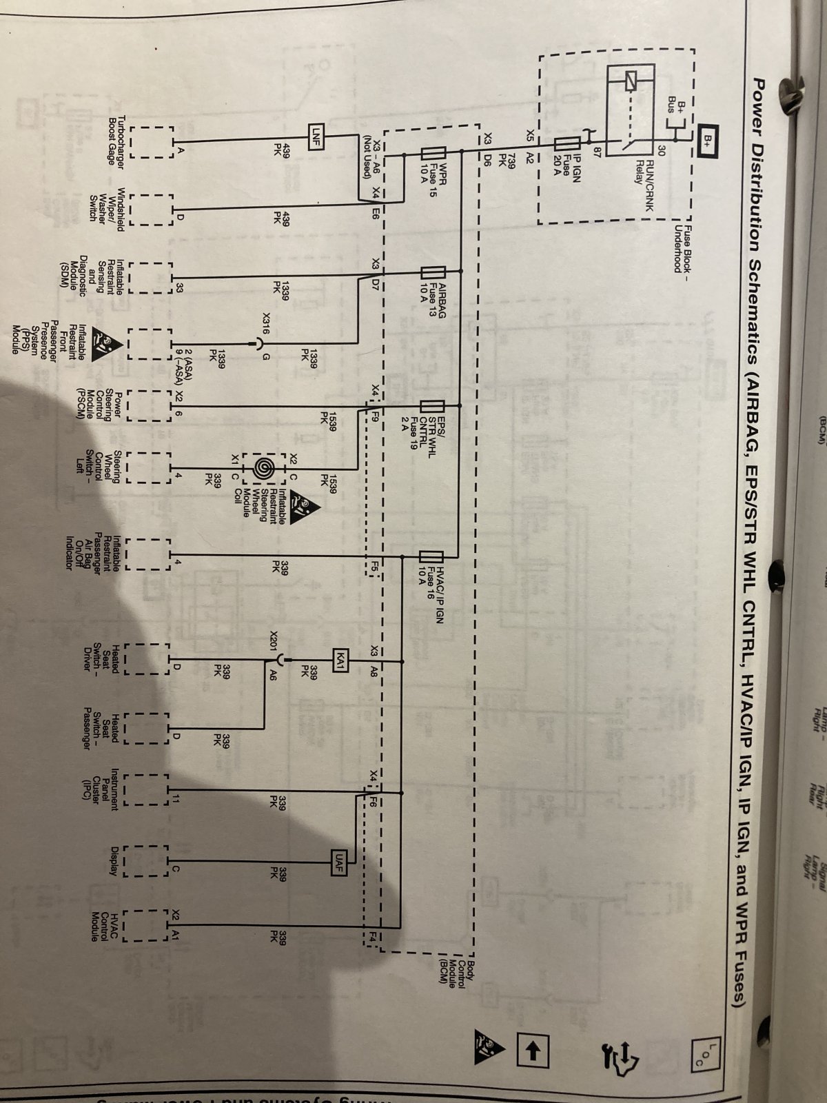

Another thing, seems that my bcm doesn't utilize fuse 19. Fuse 7 (2A) is the only one that would be for the power steering (also doesn't have power with key on)
Based upon what? My service manual is for 2010 so it might be wrong but I think I have found one wire color difference from my 09 (and that is likely an error instead a true difference in color). Have you pulled the wiring diagrams for your donor year? BCM fuse 7 is instrument cluster and DIC if it had that option in my manual.
And 7 should be hot all of the time, not ignition switched.
Sorry, I must have seen the wrong signature when checking donor on my phone. I thought you had an 08. I must have looked at the wrong post.
Beyond that, figuring out why a circuit doesn’t have power shouldn’t take long if you use your wiring diagram and start checking at one end and trace the chain all the way back to the battery.

Of course you could just run a temporary power wire to your eps and see if that is the cause of the no data issue.With a fused source.
So, ended up doing exactly that. Left a 2A fuse in the bcm and ran a 12v power with another 2A fuse to the power steering. Immediately after hooking both up I heard relays click and my dash lights all worked.
Ran tech2win and have coms with everything except the theft deterrent module. Tried cranking, and what do I know. STARTER TURNED OVER!!!
Thanks everyone! I know it was a slow process but trust me, this has been bothering me for so long.
Now I need to solve my power issue in the power steering and steering wheel button circuit. Any tips or recommendations are welcome. Honestly have little experience chasing something this far back in the circuit. (2A, fuse 7 on 06 lsj BCM)

Again, have you pulled the wiring diagram for your donor for the eps? You are making things a lot harder on yourself if you are trying to work on this stuff without one.
