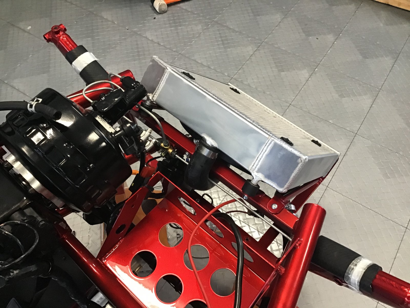

Just a silly question, But I thought a radiator was supposed to have a radiator cap.
Karter2026
The first ones did. They have eliminated them. I think for the reason of the surge tank is higher than top of radiator, and the need to plug the over flow barb on the radiator.
Gotta remember, the original build videos are from... 2016? Maybe even 2015? The kit has evolved since then, you'll see some other differences as well.

Some of the DF supplied radiator's have caps, some don't. My first build didn't but my second build did. Not an issue either way. Just follow Ross's directions above and you should be good to go.
