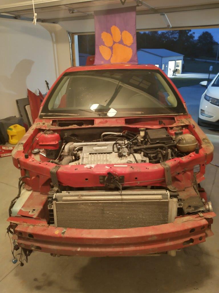

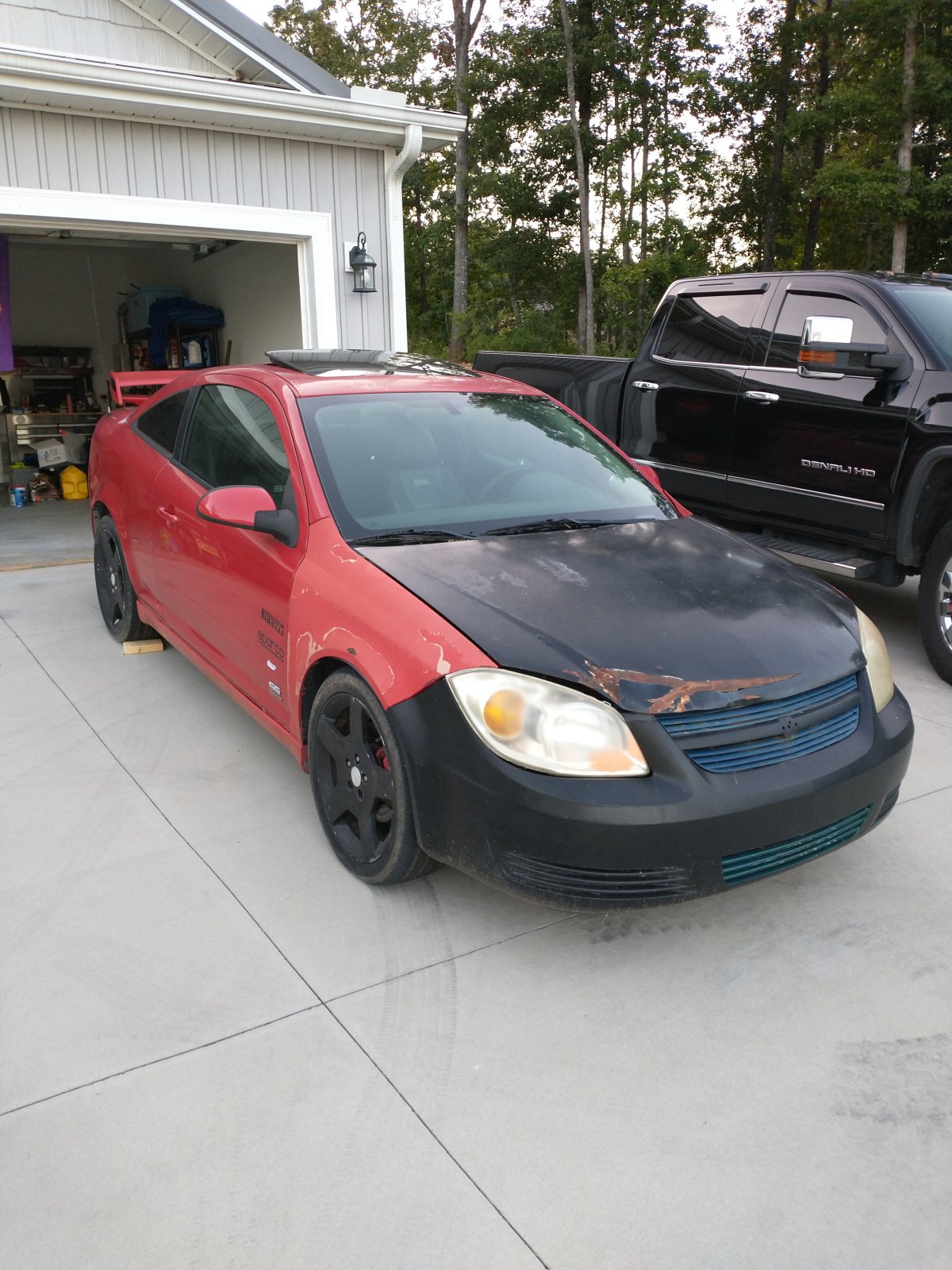

Check out this hot rod! 2006 SS/SC with the G85! 141k miles but not a lot of other information. Besides the whole body it's in pretty good shape. I don't really have a lot of information on the car and would guess it's got the base front end due to damage to the original but the subframe looks straight and that's about all I can ask for. Intermittent CELs for P0068 and P1182 but I'm not sure how hard I'm going to try to get those straightened out ahead of time. It needs wheel bearings and is missing a little over an average of one lug stud per wheel so I'll definitely be picking up a set of new hubs. It doesn't do one wheel peels which is cool too.
I have a few other open projects around the house so I'm going to try to tie those up first before digging into the car. My kit's estimated somewhere November-ish so I have a bit of time to do the teardown but getting the harness out and sent off for rework will be a priority. Does anyone have a ballpark of how long that takes to get reworked? Ideally it'd come back completed with the kit.

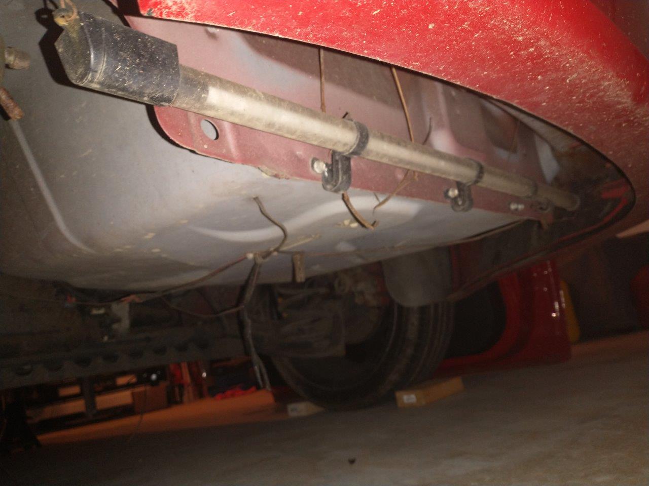

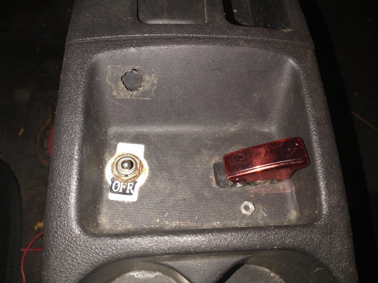

Got into the teardown over the weekend and yesterday. The car is full of surprises. What I thought was going to be a ghettofab'd straight pipe is actually a $400+ stainless system with short muffler (albeit an ineffective one). I think the switches originally ran to the underglow (but not anymore). If the lights work, isn't it a build rule that they have to be installed on the Goblin? I'm up to $0.27 in change found under the seats but the real score was the unopened pack of socks. I got to remove the exact same pack from my Amazon cart!

Also, lighting the @JBINTX signal, this donor has your coveted "undercar lighting"! :D:D:D

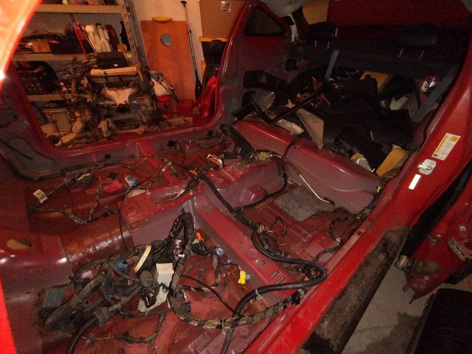

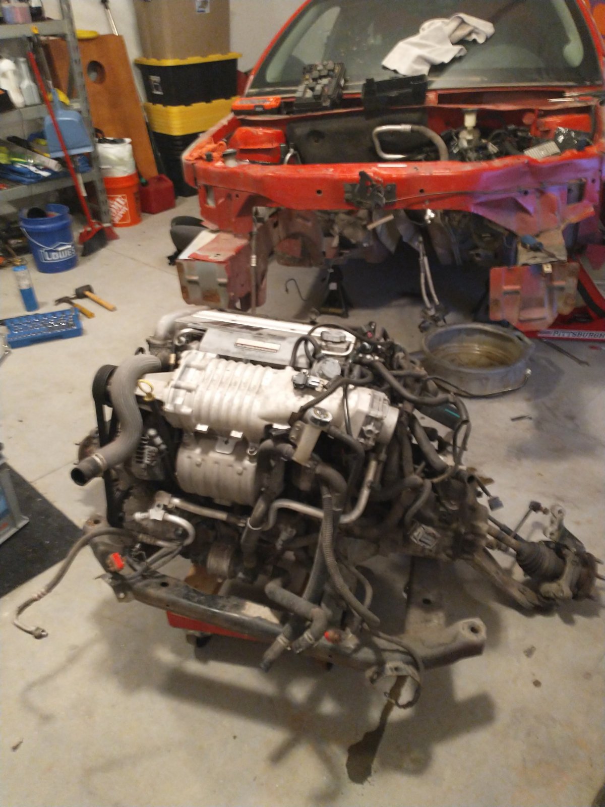

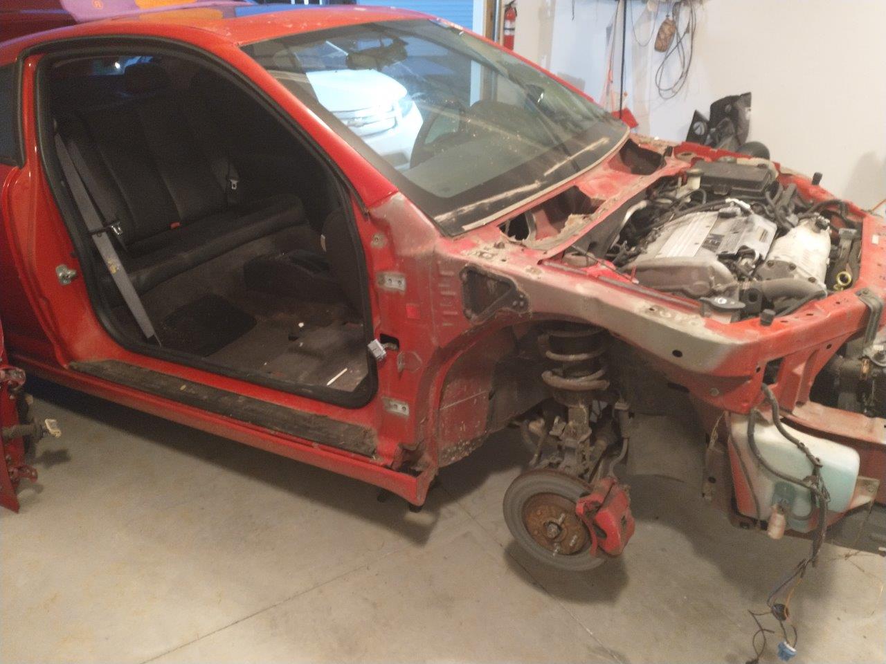

Got the whole engine, trans, and cradle dropped as one unit last week. I got the interior stripped as far as removing the carpet last night. Hopefully the dash will come out tonight- my weekly nighttime overseas conference calls have gotten pointless enough that I'm pretty sure I can just put myself on speakerphone + mute and work in the garage.

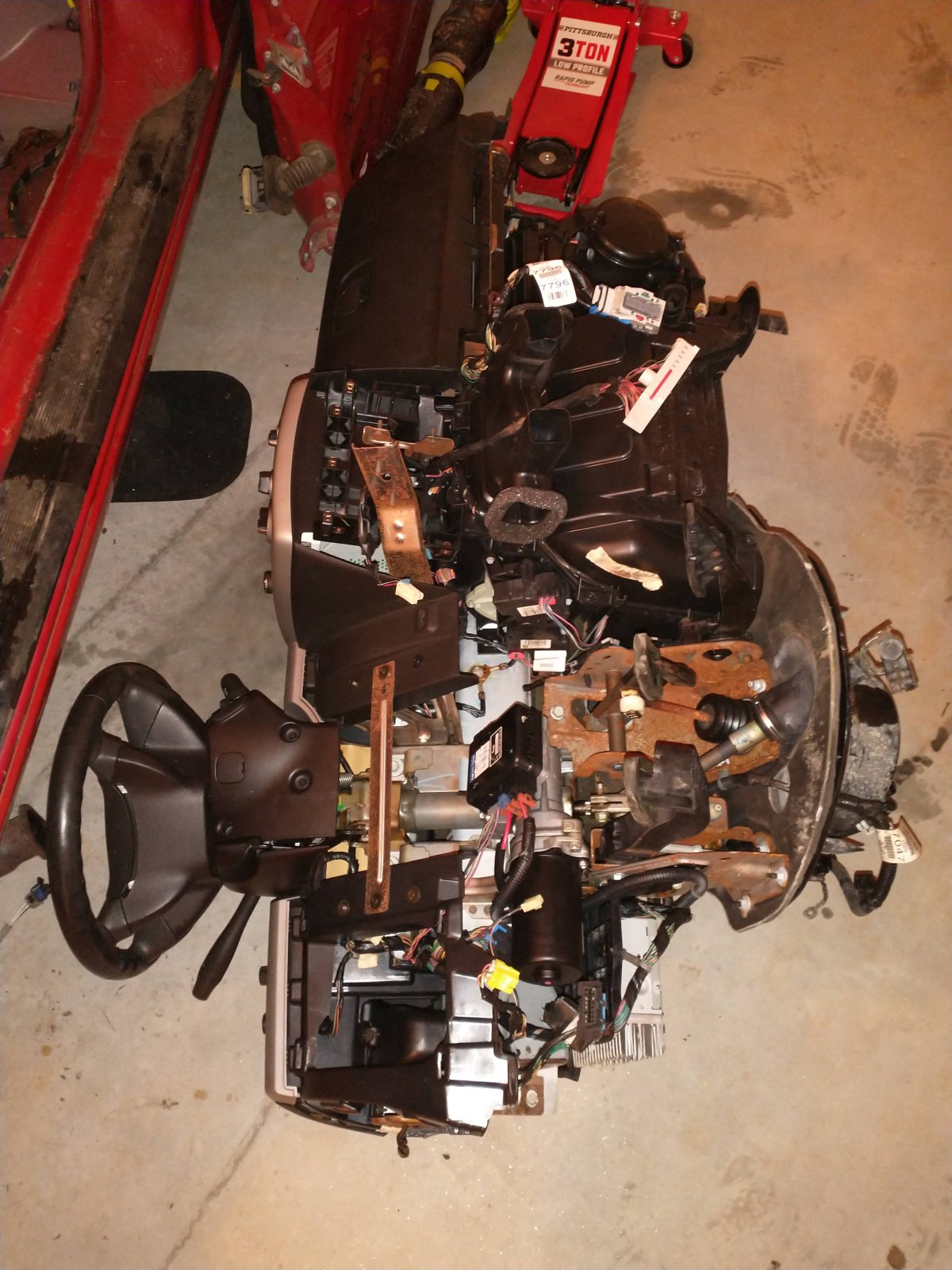

Got the dash pulled and the front half of the harness freed up. I guess I knew this was coming but chucking all the trim panels in the trunk is going to be a bit of a hindrance to getting the back half of the harness out, and I have higher standards for myself than chucking them all into a corner of the garage... who am I kidding, that's probably what I'm going to end up doing. At some point I'll probably end up making a run to the local dump.
Pic of the motor is from last week.
