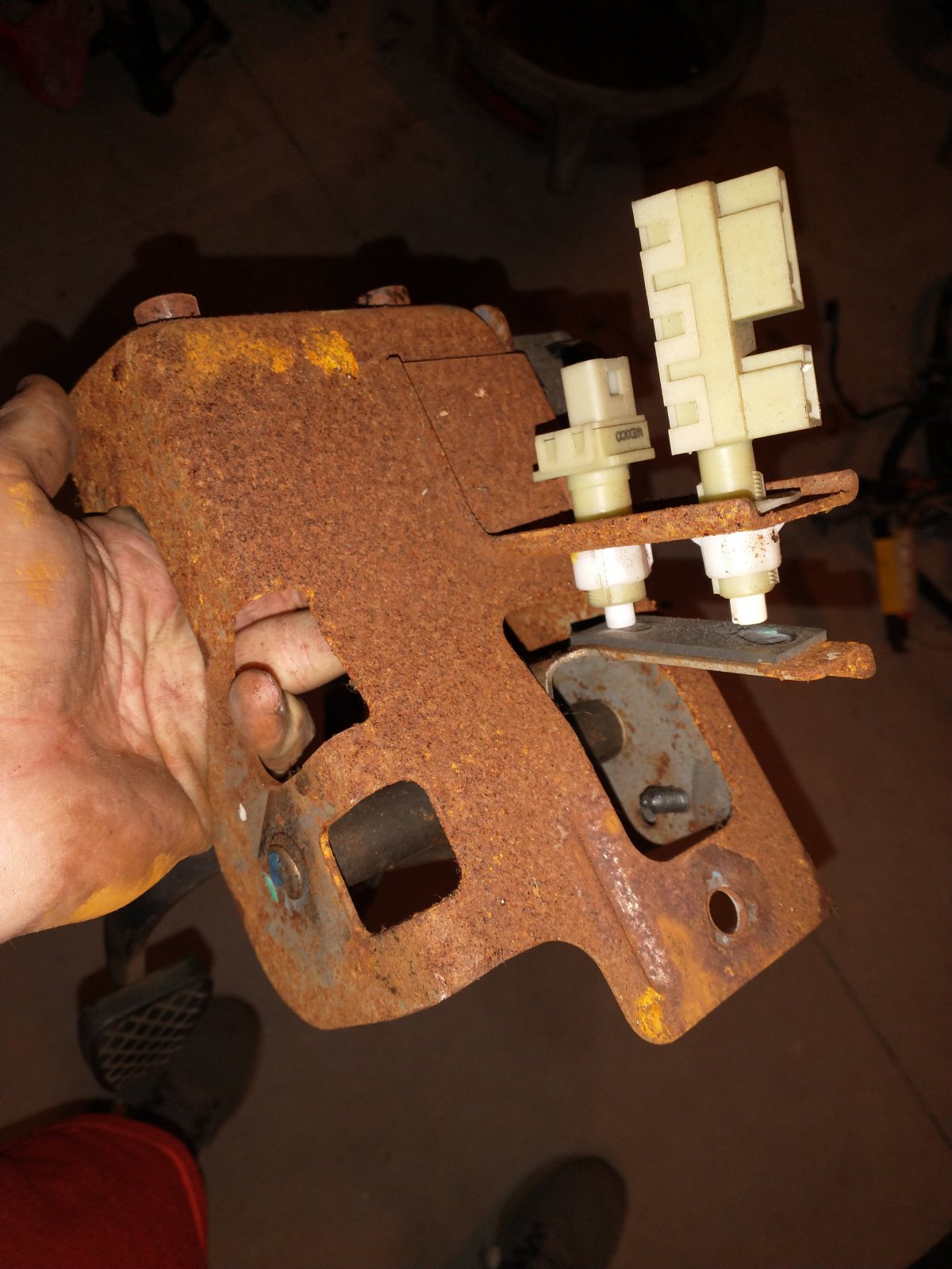

I got the rest of the body harness out last night and started on stripping the dash. A lot of the sheet metal behind the dash had some serious surface rust. I don't have a particular reason to believe the donor had been flooded or that it had been left out in the rain- the car drove fine on the way home, no electrical issues, and no mold or anything like that. Is that just what these parts look like after a lifetime of normal levels of humidity? It's lived its whole life in SC and NC, away from the coast. Subframe and other metal parts off the donor looked fine as well. Anyway, these and a few other parts will be getting some blasting and paint before install.

Yeah mine looked like garbage too, a life-long SC car with no hint of interior flood damage... I just sand blasted and powdered them and sent them on their way.

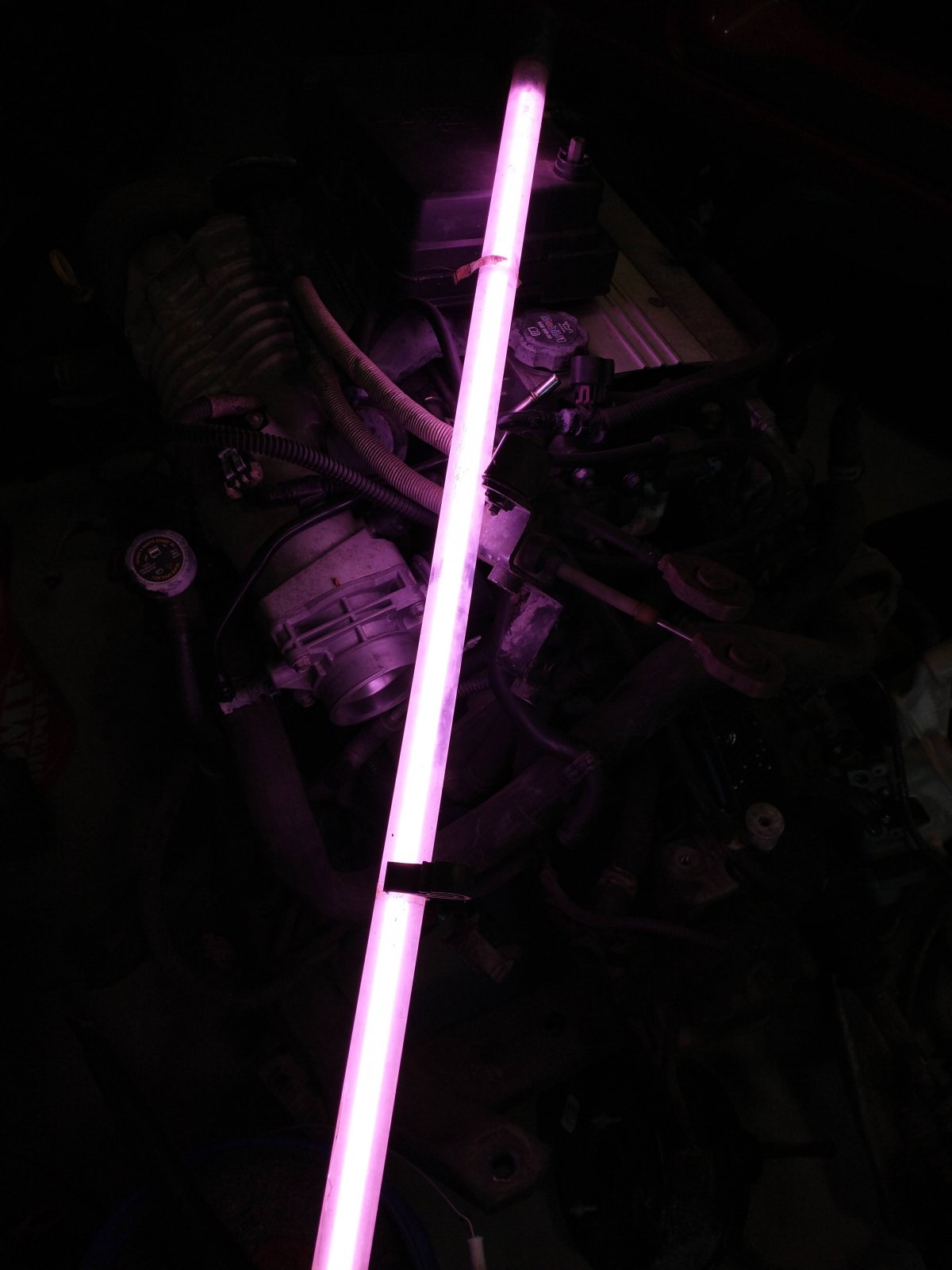

@Mayor West unfortunately the underglow is actually underglow. Not sure that will jive with the planned gunmetal/green paint scheme... although my original color proposal was black and purple, but I'm not even sure that will work. This is definitely pink, the picture doesn't even do it justice.

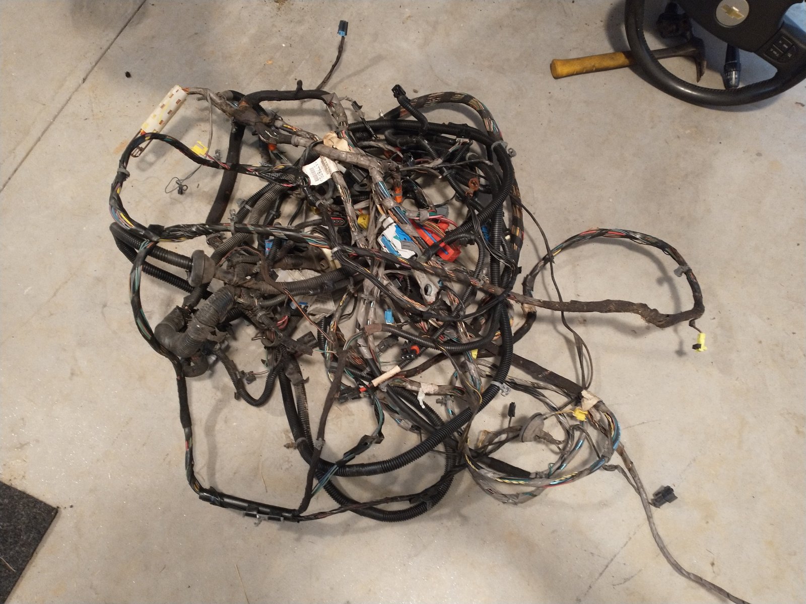

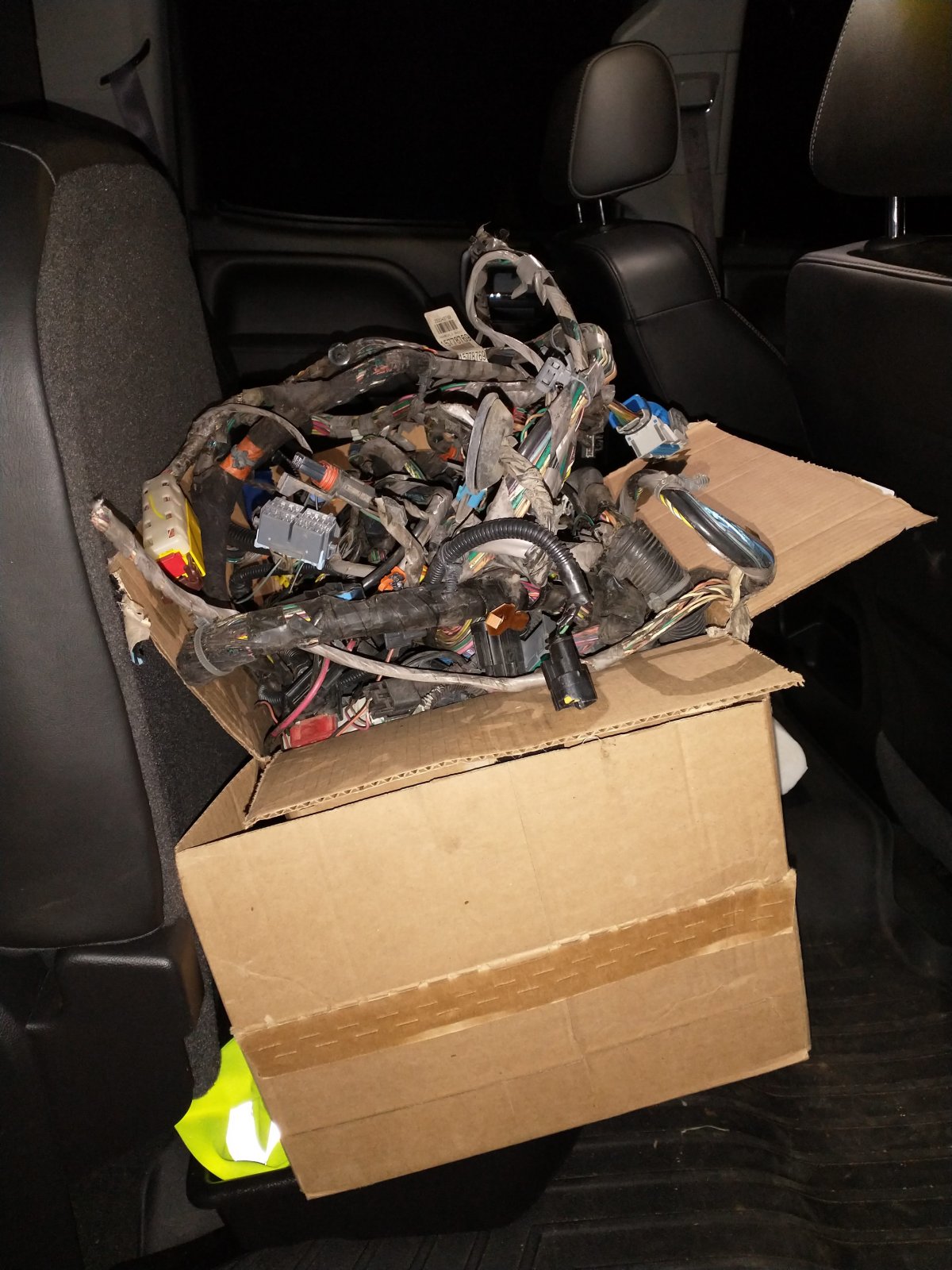

Got all the harnesses out, finally, so they'll be getting shipped in today. I doubt they'll be ready in time to return with the kit, though, as I got word this morning it'll be ready next week and awaiting a shipping soon thereafter.

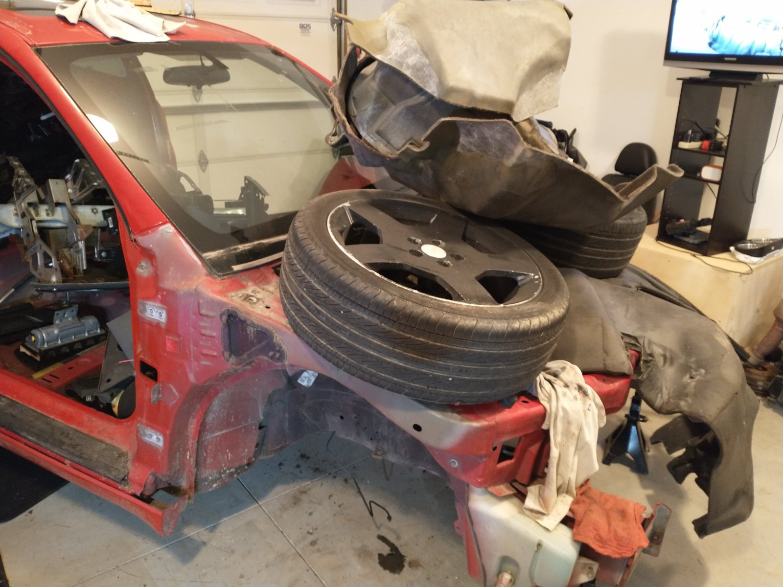

For future reference, loosen your lug nuts while it's still easy! At this point I had no rear brakes on the car. With the tires on the ground, my breaker bar was just driving the car forwards. I ended up putting jackstands under the rear jack points, but with the rear wheels on the car and no engine, the car rocked on the rear jackstands. I ended up putting my jack under the tire and pushing down on the breaker bar to get the tire to have enough traction on the jack to stop from spinning. With lug nuts that tight, it's no wonder the car came with 11 lug nuts and 12 lug studs. Once I got the wheels off, they went from the back of the car, behind the rear jackstands, into the engine bay with the carpet and dash pad to reduce the likelihood of the car rocking. The front wheels went under the car with me just for a little additional safety confidence.
Hmm, a 1/2 inch drive impact gun would have been easier and safer - if you had access to use one. Good you got those busted loose without a mishap. :)

If only I had access to one... unfortunately assistance is hard to come by during the week as there's a general rule that requires joint car work to be accompanied by beverages that preclude driving home safely and thus preparing for work the next morning.

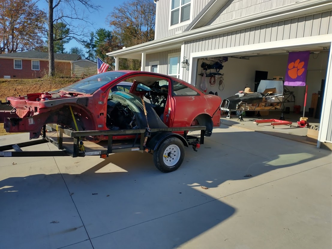

I sold a handful of parts for $600 yesterday... I have a buyer scheduled to pick up the shell this weekend with the rear bumper, trunk + spoiler, and rockers for $400. Then I'll be left with the Recaros as about the highest dollar items remaining, plus a few other odds and ends that may end up in the trash in the end.
Out with the old, in with the new.

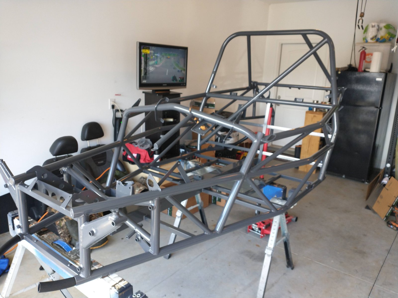

The chassis and most of the other parts got dropped off for powdercoating this past Monday and will be done this coming week. The garage is more organized now than it has been recently, but still not quite where I'd like it to be. This is how I watched college football this weekend.

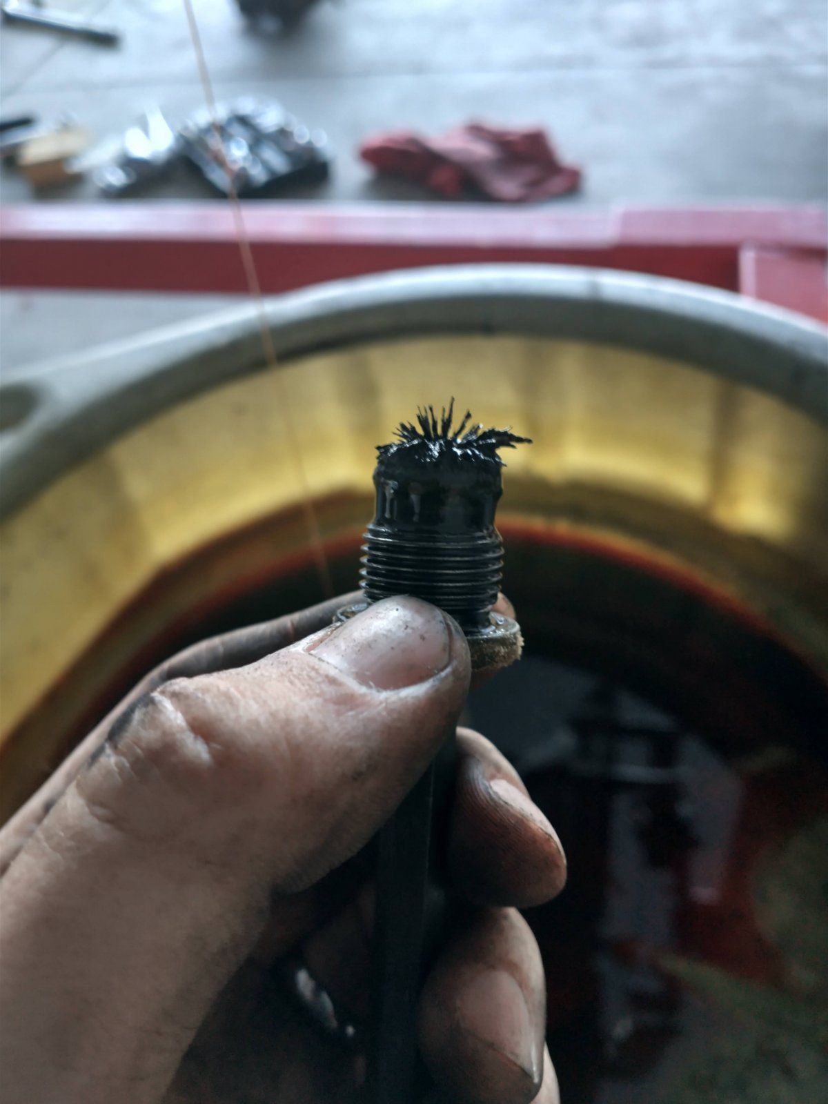

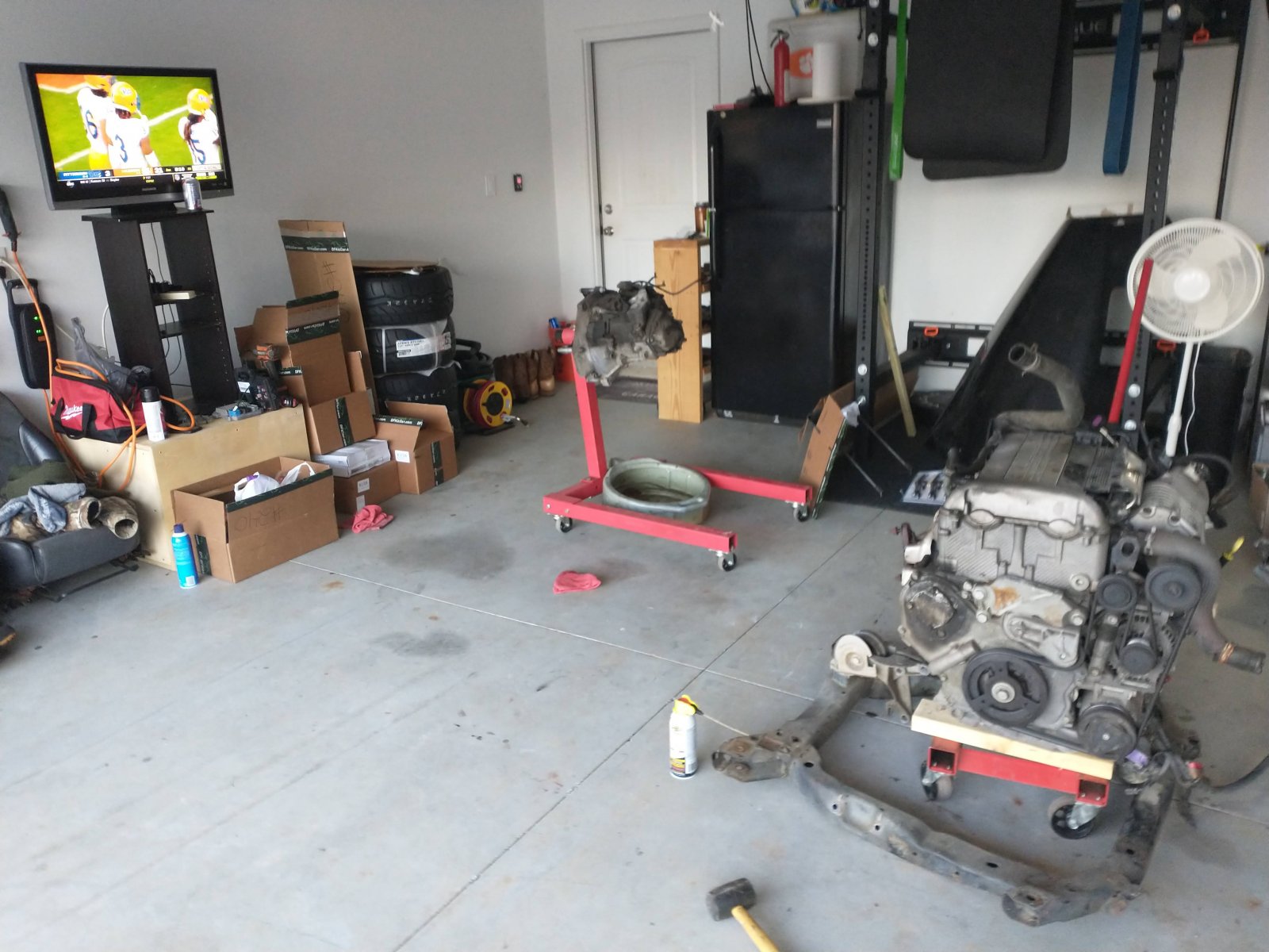

I didn't realize how it was going to unfold that I dropped the motor + trans + subframe as a unit onto my wheel dolly... can't get the subframe outside for cleaning and painting until the motor gets onto the engine stand. Right now I have the trans on it for cleaning and painting. My donor had Exedy stickers on the grocery list, so I was hoping it had had the clutch replaced in its 141k miles, but I don't see anything to suggest it's anything other than the OEM clutch. Then again, it also had Sparco and Pirelli stickers. Interestingly, the Carfax shows it got a new cylinder head at 7k miles and the trans "removed and reinstalled" and "clutch checked" at 14k miles. Speaking of the trans, is this drain plug magnet an unexpected sight? G85 trans if that's relevant.
18772
18773
That's a transmission in the process of slowly eating itself. I wonder if the transmission had been serviced since the supposed 14K maintenance. That looks like something maybe a little more than normal wear and tear, as it is steel material which shouldn't be occurring - even with 141K. Try flushing the transmission with a light oil to wash out the rest of the crap and fill with the correct gear oil. At some point recheck the magnetic plug again for steel particles.
That's generally what I was thinking, on each of your points. Why would have been serviced again? It's "fill-for-life"! The car drove home ~25 miles just fine, rowed through the gears with no issues. LSD seemed to work great as well. From what I've read, these are not particularly serviceable, so I'm guessing there's not much to do besides drive it and see what happens.

Not everything was finished powdercoating on Friday as agreed, so I picked up just the frame. Got the coolant hoses run with the assistance of a buddy with a winch. Also got a bunch of parts delivered, some from Black Friday and some from preplanned Rock Auto purchases, including a 2.9 pulley, shorty header, wideband, all new wheel bearings, Moog Problem Solver control arm bushings, front brake pads, and fuel filter. I'm sure I've missed a few things. Dorman timing chain guide bolt is installed as well. We got the valve cover painted in wrinkle black, I know I owe a picture of that bad boy. I'm pleased how it turned out.

DOOD!!! That Nardo gray is sick!!!!
View attachment 18772View attachment 18773
That is how my plug looked along with the speed sensor... I'm assuming that in a 179k someone had to grind a gear or two!
