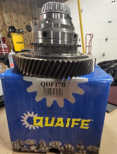

For anyone who doesn't have an LSD but wants one, the two cheapest ways to accomplish the task are to find an LSD equipped F35 or to swap to an F23 that you install an LSD into. Been a while since I have seen an F23 Quaife this cheap. I endorse this swap.
jirwin
Too bad its not "Buy It Now". I tried to buy one directly from Quaife last night and my card got declined because blah blah overseas purchase suspicious activity. I was gunna call the bank today to get that sorted out. I think its ~$900 after shipping/taxes/conversion if I remember correctly.
