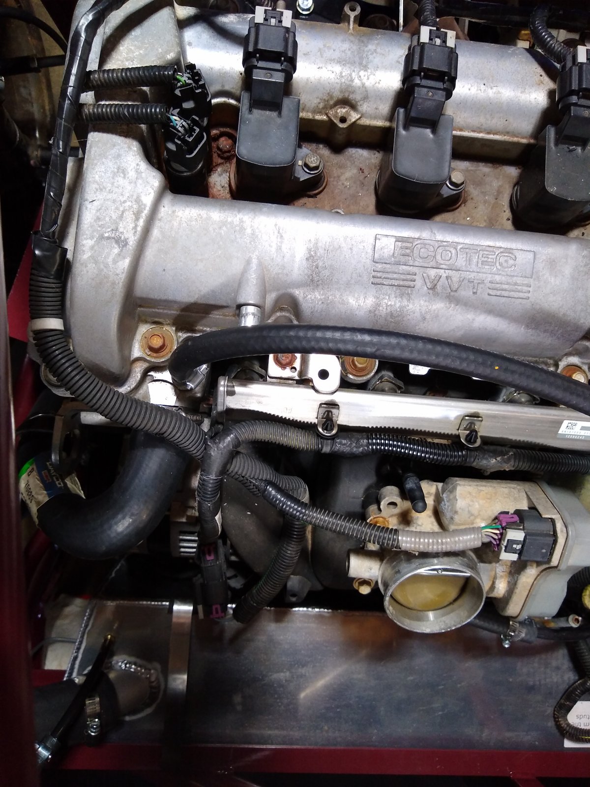

Alright, I'm at my wit's end. I jumped the starter and the motor spun, but the solenoid did not engage, which tells me it's not getting 'permission' to start. I have found the coil packs (I think) and traced the cable to the throttle body (pictured). These connectors were never disconnected. I think the headlight harness is ok. When I turn the key on they light up, and I have to manually turn them off due to the auto lights feature. I have no idea how to find the body harness connector. I have jumped the fuel pump and it is working. I'm no longer getting error codes on the dash for power steering or engine power reduced. I'm just about to the point of asking Lonny if I could ship or bring the car to him to figure this thing out ! Again I will state I am a (nearly) complete electrical illiterate. I am wanting to get the engine started because I have some transmission issues (another time, another thread) and since I am also transmission illiterate I will take the car to a transmission shop in town that I trust. Once I have these two issues resolved I can drive! I am 95% done with 25% left to do.

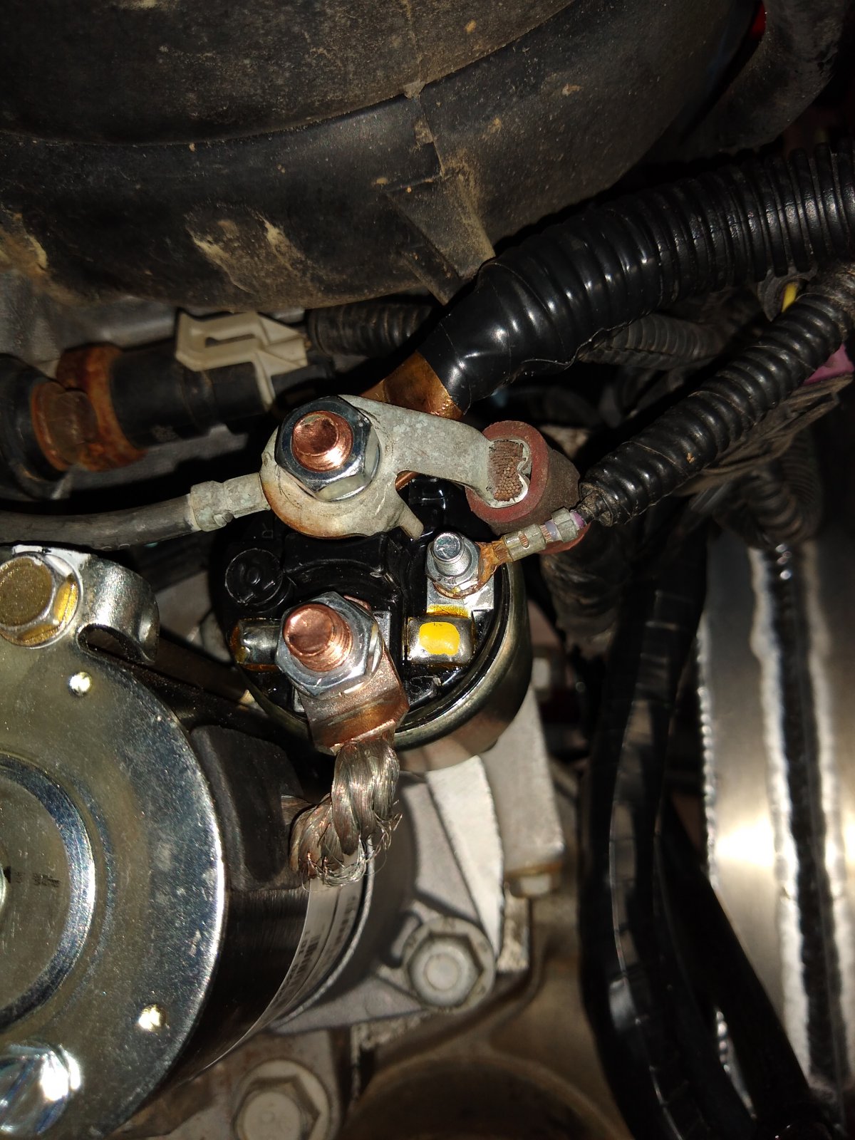

When I installed the starter, I was told to connect all 3 wires to the first connector (one from the alternator, one from the fuse box, and the power cable from the battery), the data wire to the small post, and to connect nothing to the other post that has the wire going to the actual starter. That's how it is wired up now.

Well, the shift was in park, but the transmission was not. Apparently the cable has come off the shifter. Who would have guessed that? New problem; the starter cranked the engine, the engine did not start, and quit as if it timed out. On second attempt the starter did not turn and I got relays clicking from both fuse boxes. Last time this happened the starter had gone bad. I'm thinking the starter was connected correctly (see previous post). I will dig in and see if I can fix the shifter cable issue. Any guesses on the starter issue?
Still getting bad responses from the starter. I could not get it to turn over so I had it tested and it is good. I reinstalled it with all three wires (power from the battery, one from the fuse box and one from the alternator) to one post, the small data wire to the small post, and nothing to the post with the wires going from the solenoid to the starter. Now I am getting a loud 'clack, clack, clack' from the fuse box at the engine. I'm very frustrated and have no idea how to fix this. Any suggestions?
