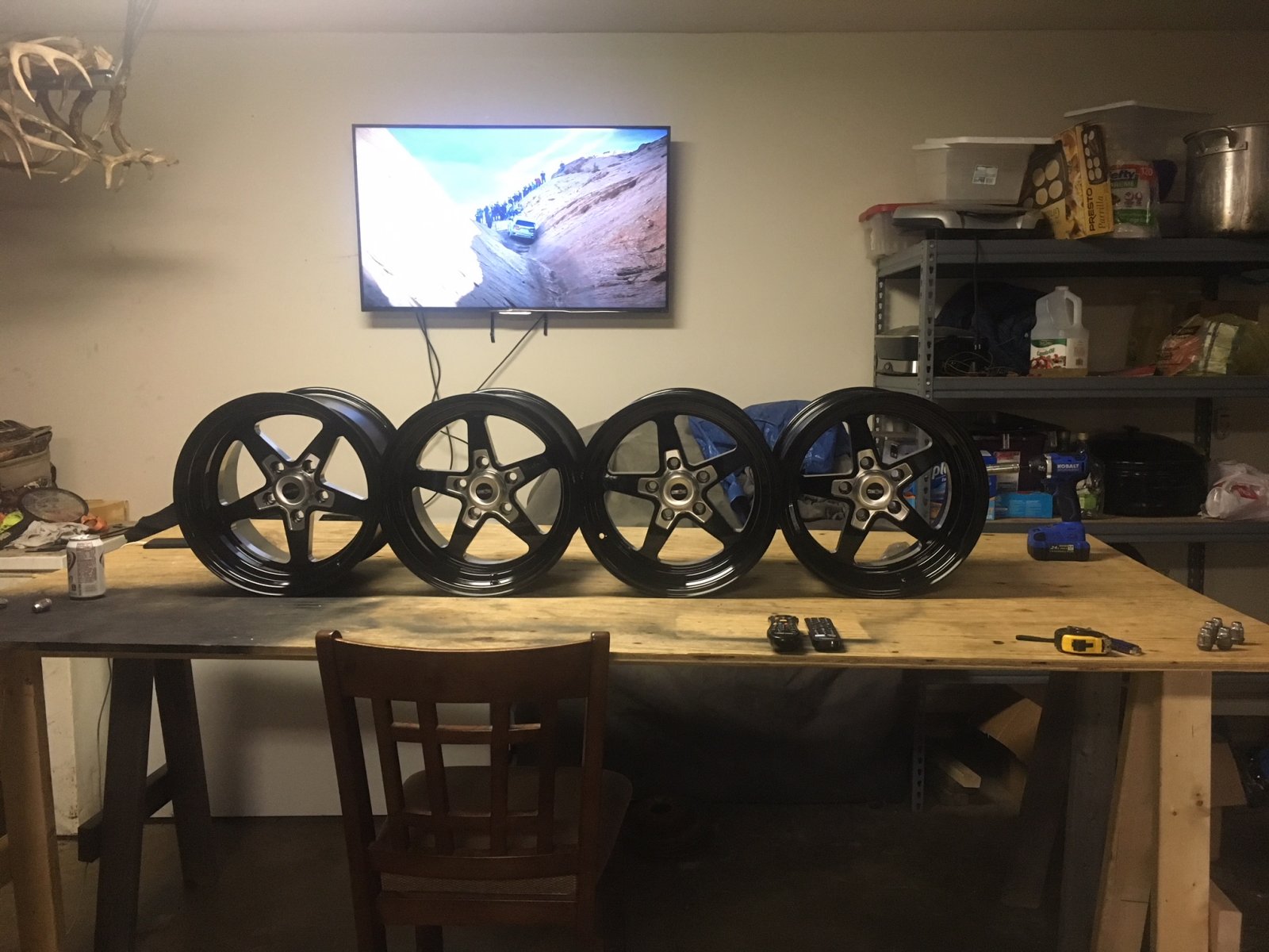

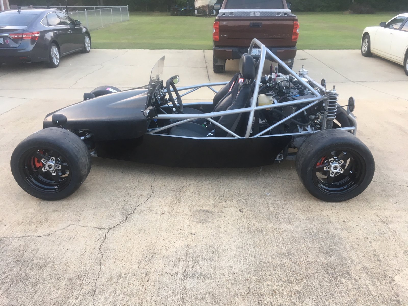

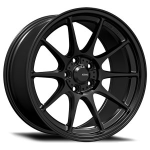

Thanks ordered :) I went with Dekagram 15 in front 16 in rear 205 in front 275 in rear on R888Rs. Excited to see the performance. 295's all around is going to be crazy on the track.
ncgoblin
What did those run you? why did you want such a difference between your front and rear?
It was about $1500 with tires, wheels, spacers, and lugs. I did a good amount of research and determined that the fronts do not require as much traction and that 205s would be fine I probably could have went up to 225 but decided to not. I went with much larger in the rear obviously for performance but also the big difference of front to rear will look very nice. I am not an expert so maybe going equal front and rear width would be best I just know the aerial atom does not have an equal width.
redline
depends on what your doing. I am setup for autocross. the atoms that track race and autocross all run equal. I think the offset widths is much more a looks thing.
redline
Note to all spacer buyers, go with 1 1/2 inch spacers. I used 1" and I had to cut the tip of each of my lugs with a cutting wheel so that they didn't stick out of the spacer. only had to cut off maybe a 1/4" but it was still a pain in the arse.
