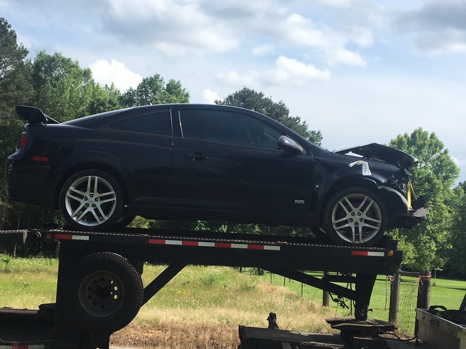

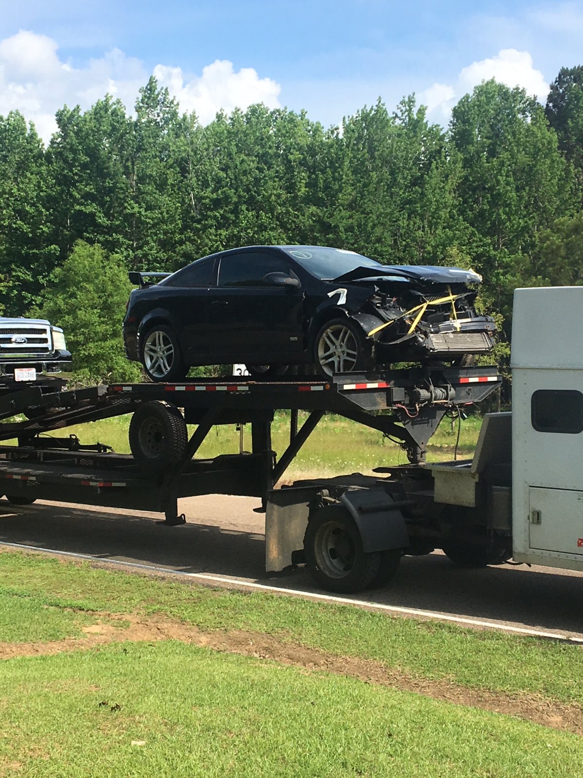

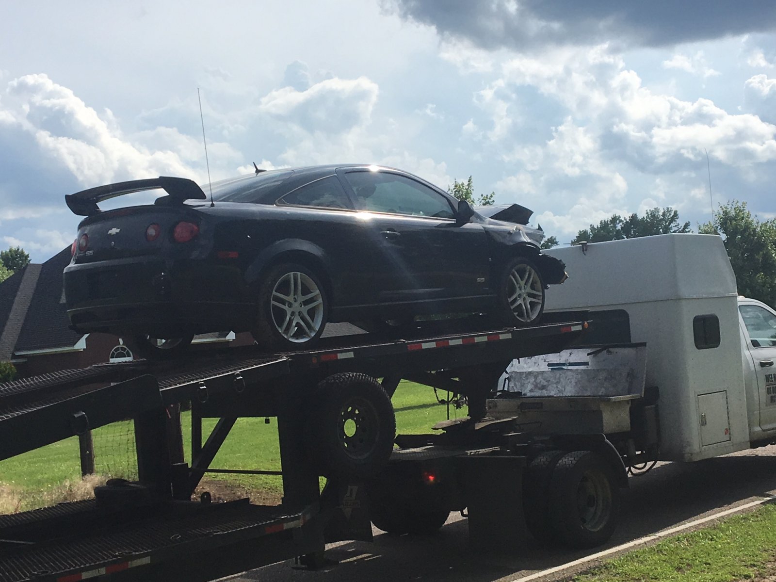

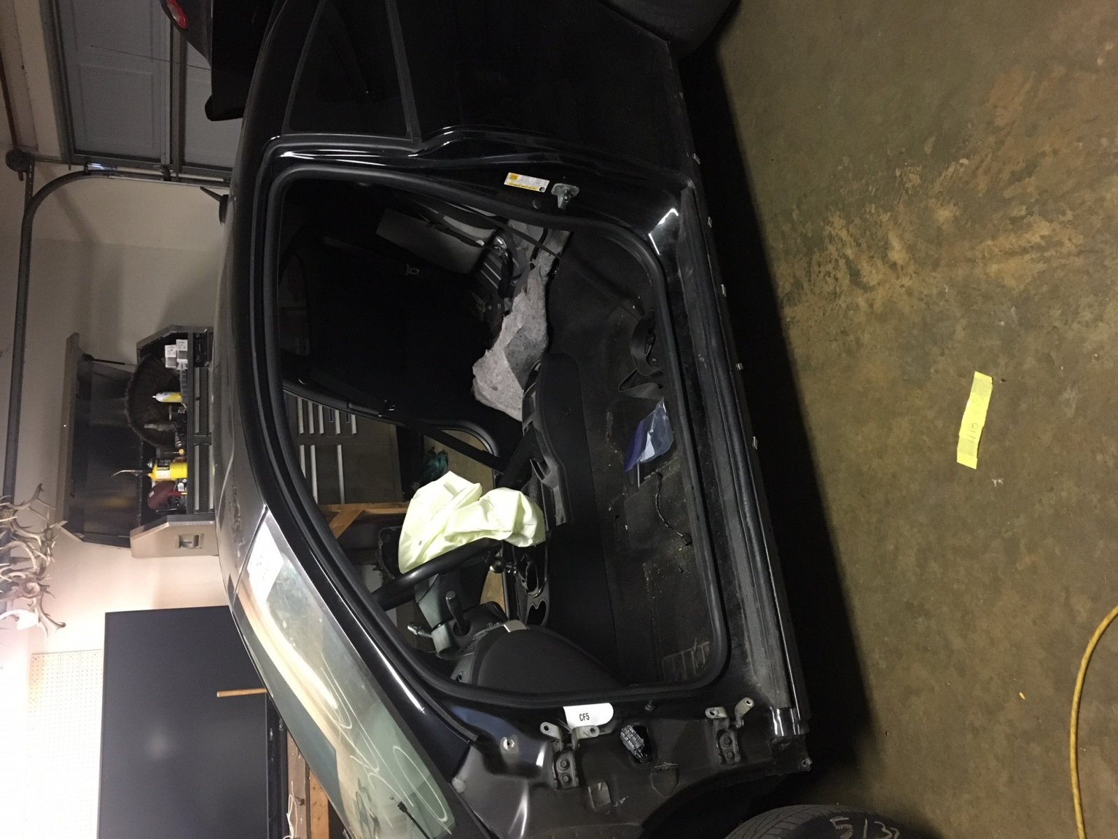

Donor showed up and it runs just fine even with the front nearly gone. bonus it has a short throw shifter already!

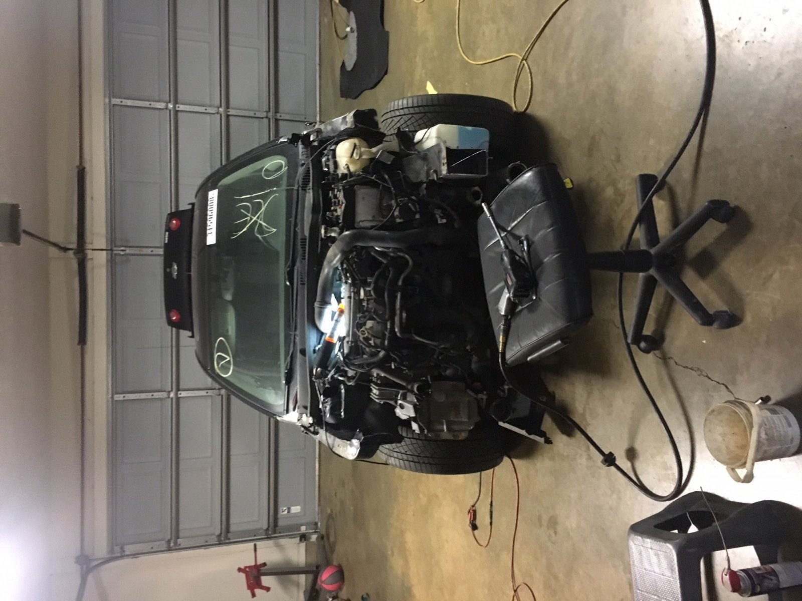

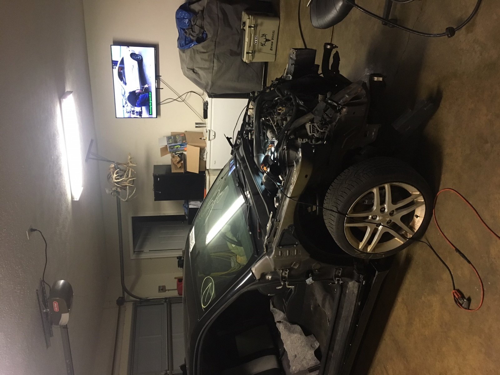

redline

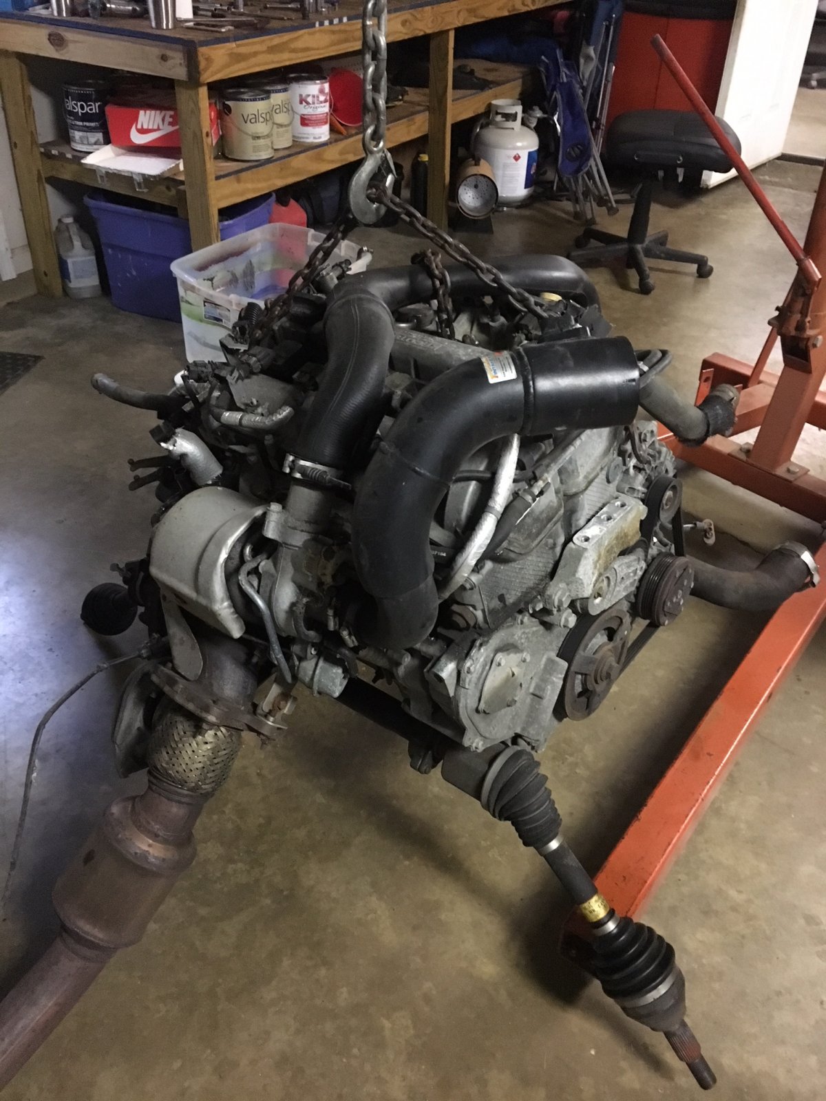

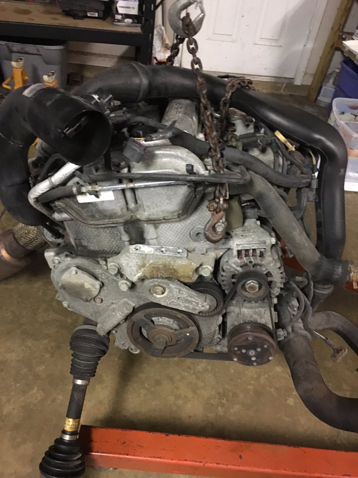

got the Engine out last night. just a little left for today to get the donor off to the junk yard.

redline

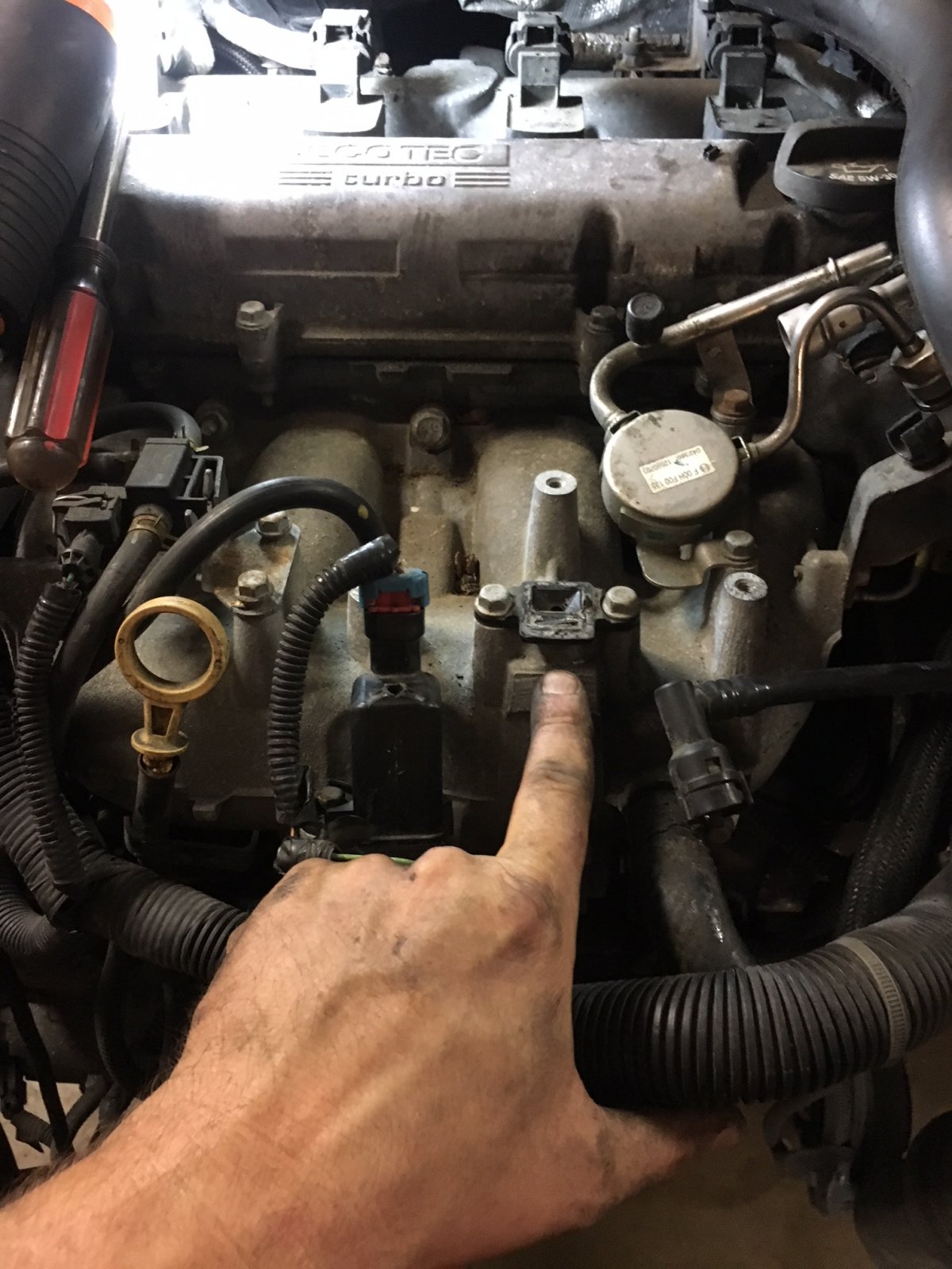

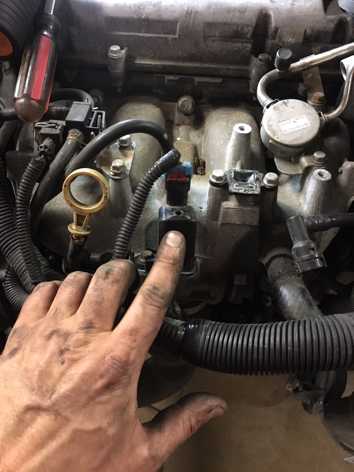

both of these sensors were damaged. anyone know what they are so I can order them? They are both on the front of the intake manifold..
