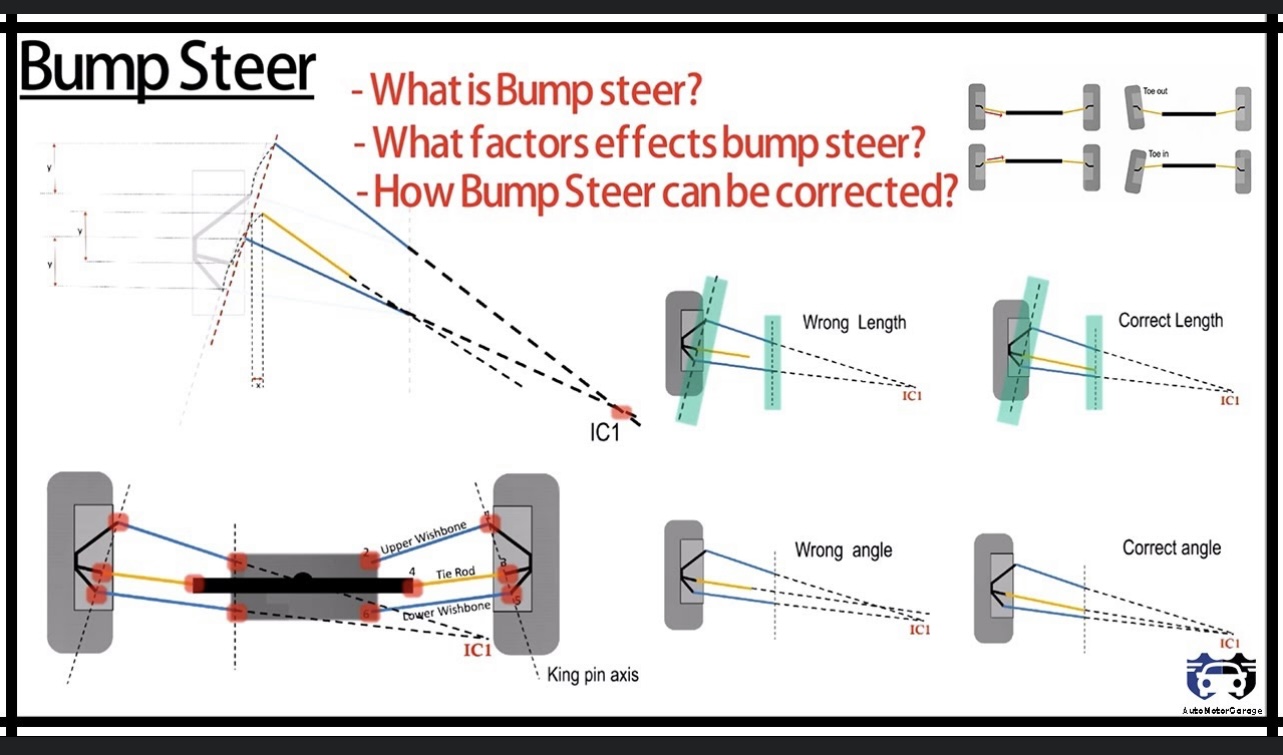

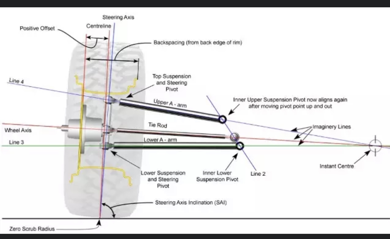

Scott I never heard I heim joints looked it up I kinda get it. I think these two images you can kind visual the effect of two much negative rim off set could put ties rods in a bump steer situation?cause the rim would be to far out and the steering inclination would be to negative so that a pothole would push the wheel in the wrong direction? In all the years doing alignment never heard of heim joints. Scott do you know your actual sai #’s with that setup?

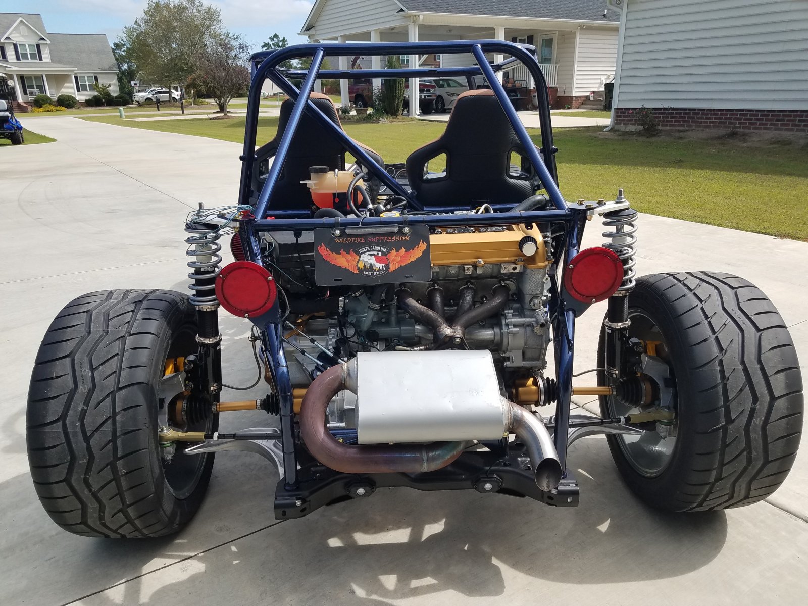

In the front, I'm running a 17x7.5 +45 with 245/45s.
In the rear, I went with 18x10 +24 w/ and adapter and 295/40s. I chose those for cosmetics. I'm not disappointed.
