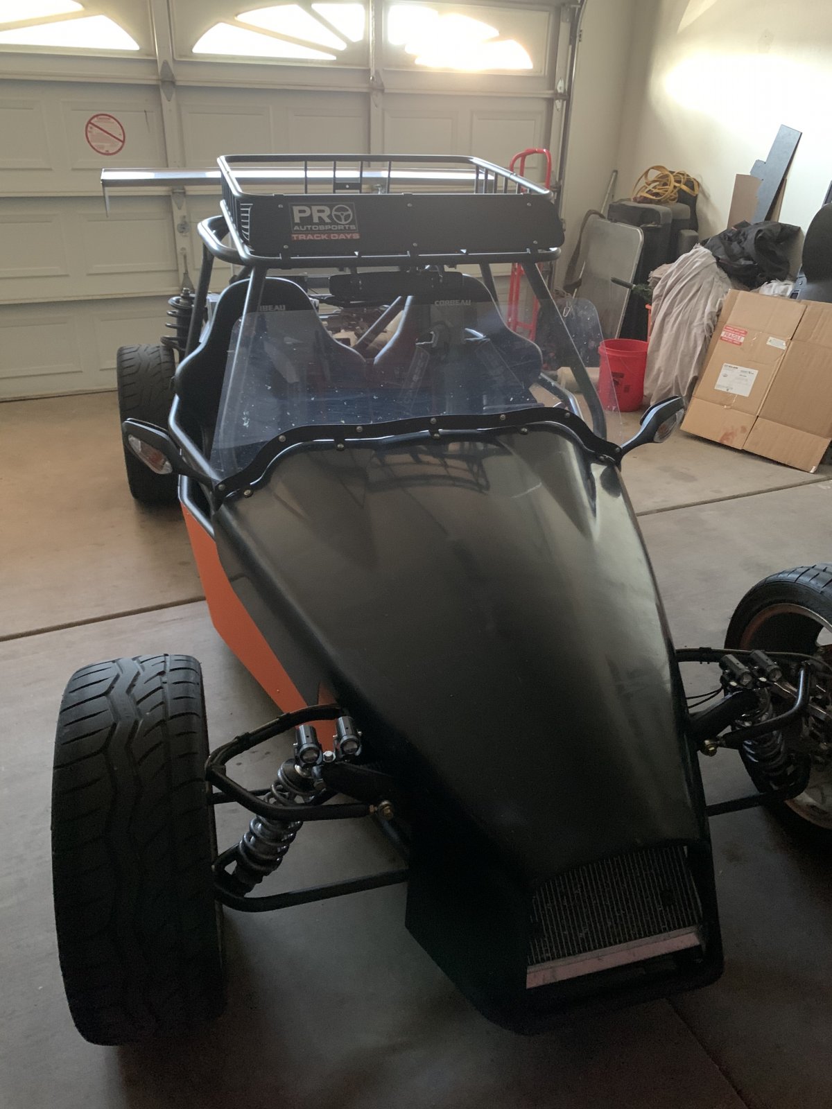

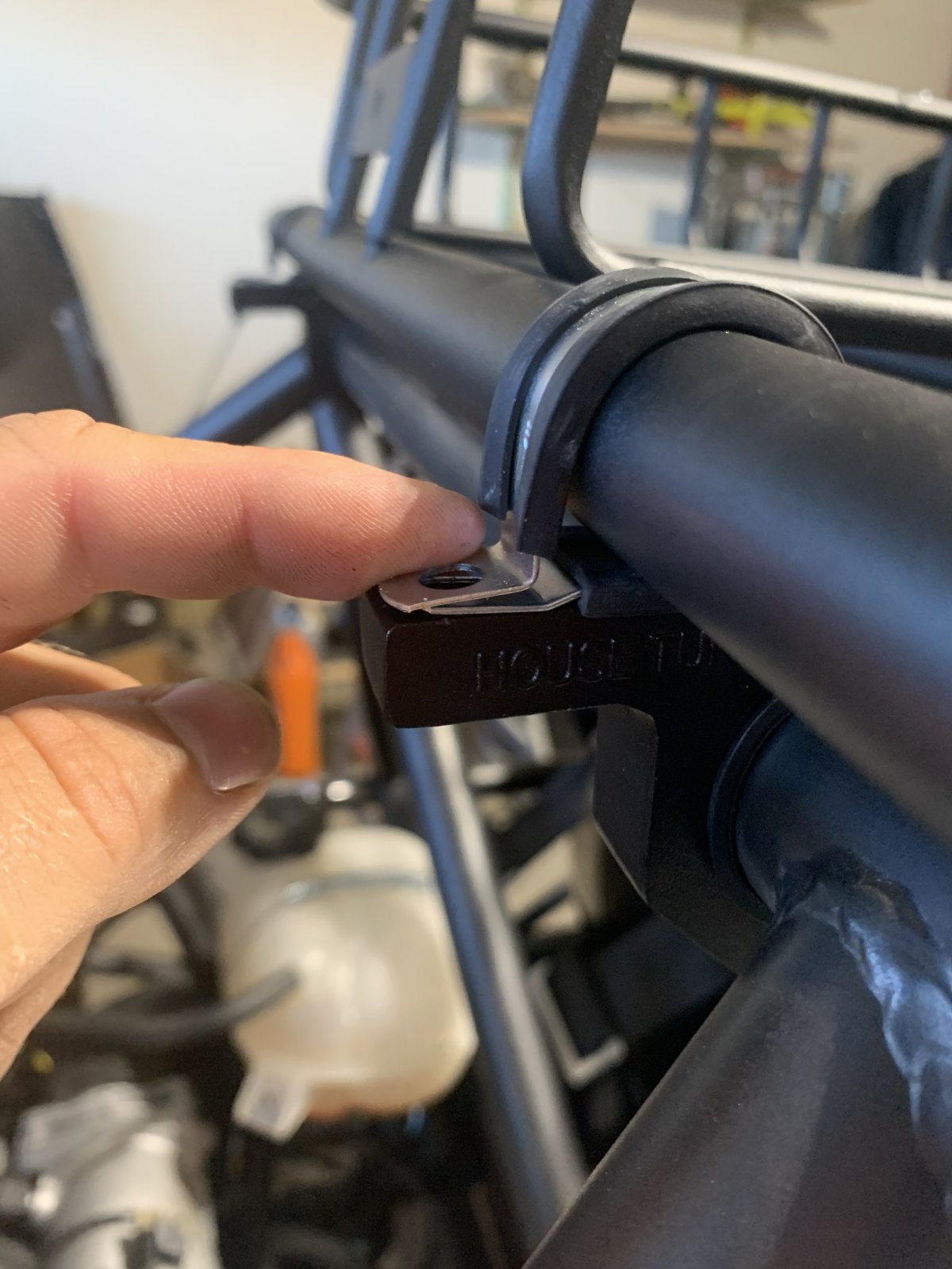

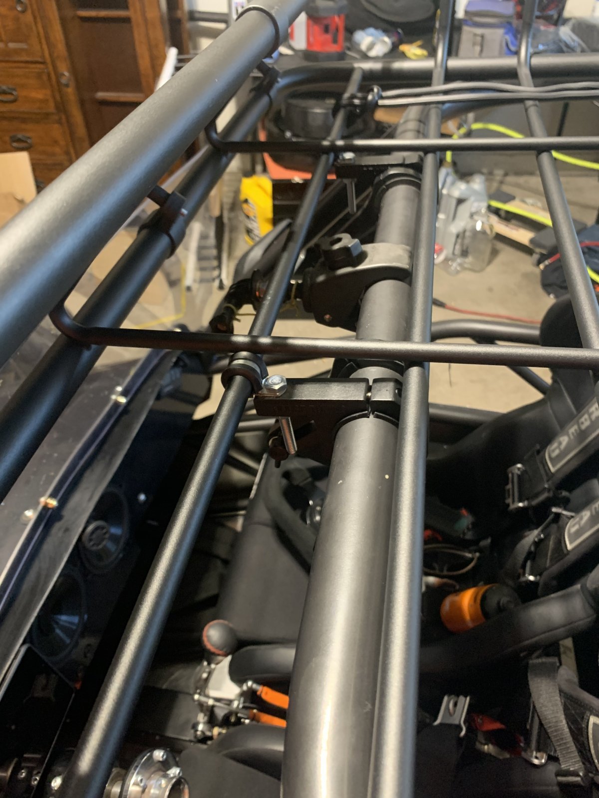

Inspired by @Wes writeup on his roof rack install I ordered the same one but it came with missing pieces and was the last one In stock. This left me with trying another rack option. The spacing of supports on the rack lined up perfectly with the mounts and was able to use insulted clamps with 1/4 hardware to bolt it down. The rack comes with an extension piece that makes it the 54” but without it the smaller dimensions line up great in my opinion and makes it a pretty much bolt on option.
Rack : https://www.amazon.com/gp/aw/d/B0B6TR9ZLF?psc=1&ref=ppx_pop_mob_b_asin_title

Matt, I'm trying to figure out how those 'insulted' clamps cooperated with you during the install? LOL!!! :p
Seriously, looks great and I'm guessing it will be hauling your gear out to the track?

Looks like the same rack I used on a Drag And Drive recently.
It works great but if I could make one recommendation. Its to protect your entire top bar of your goblin's cage with something. I had roughly 200lbs in mine for 470 miles and even though you could fit a finger between the rack and the cage it still flexed enough going down the road that it rubbed the paint off in multiple places. It also actually put a little gouge in one spot.
