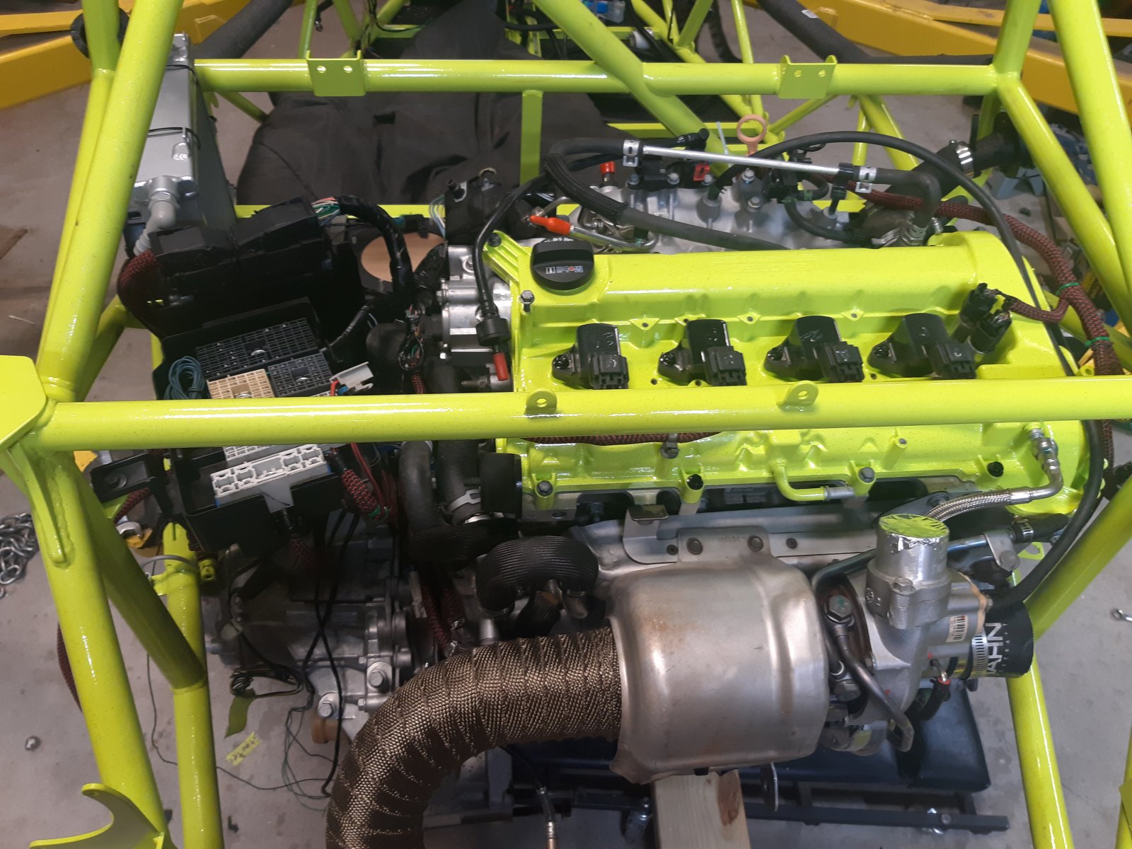

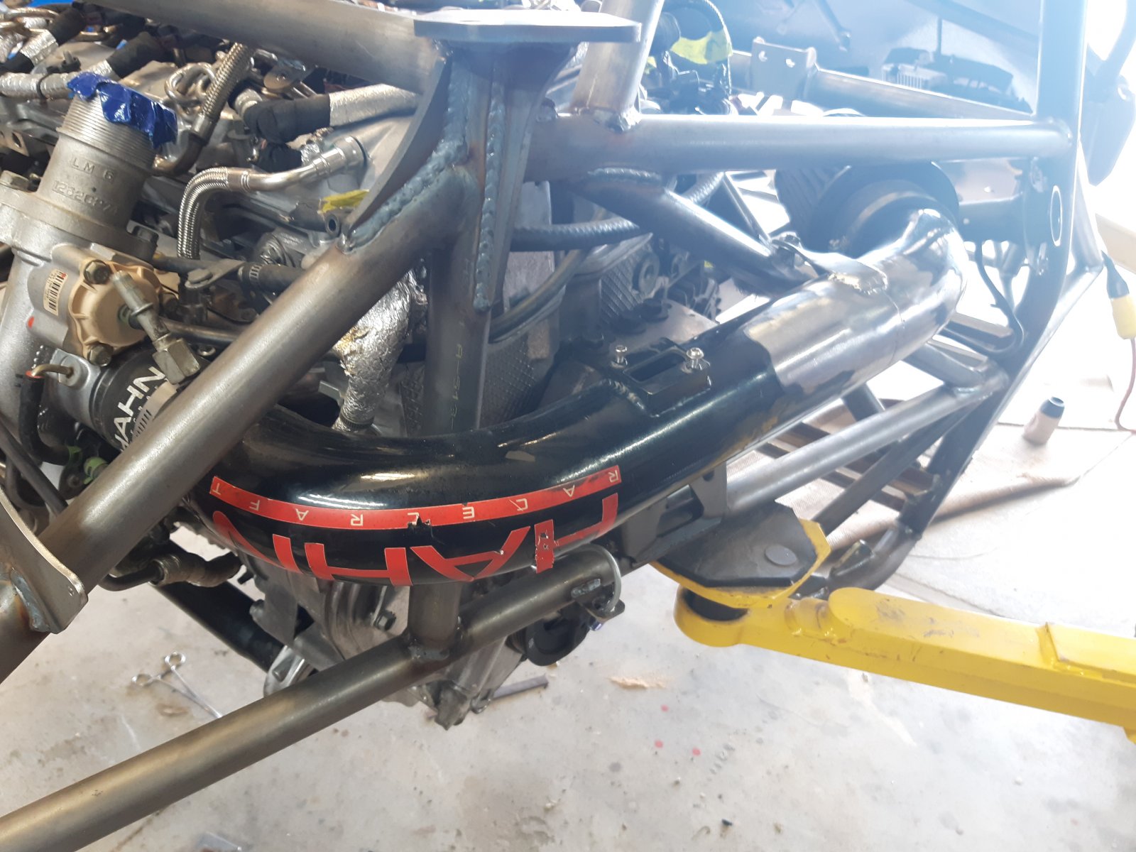

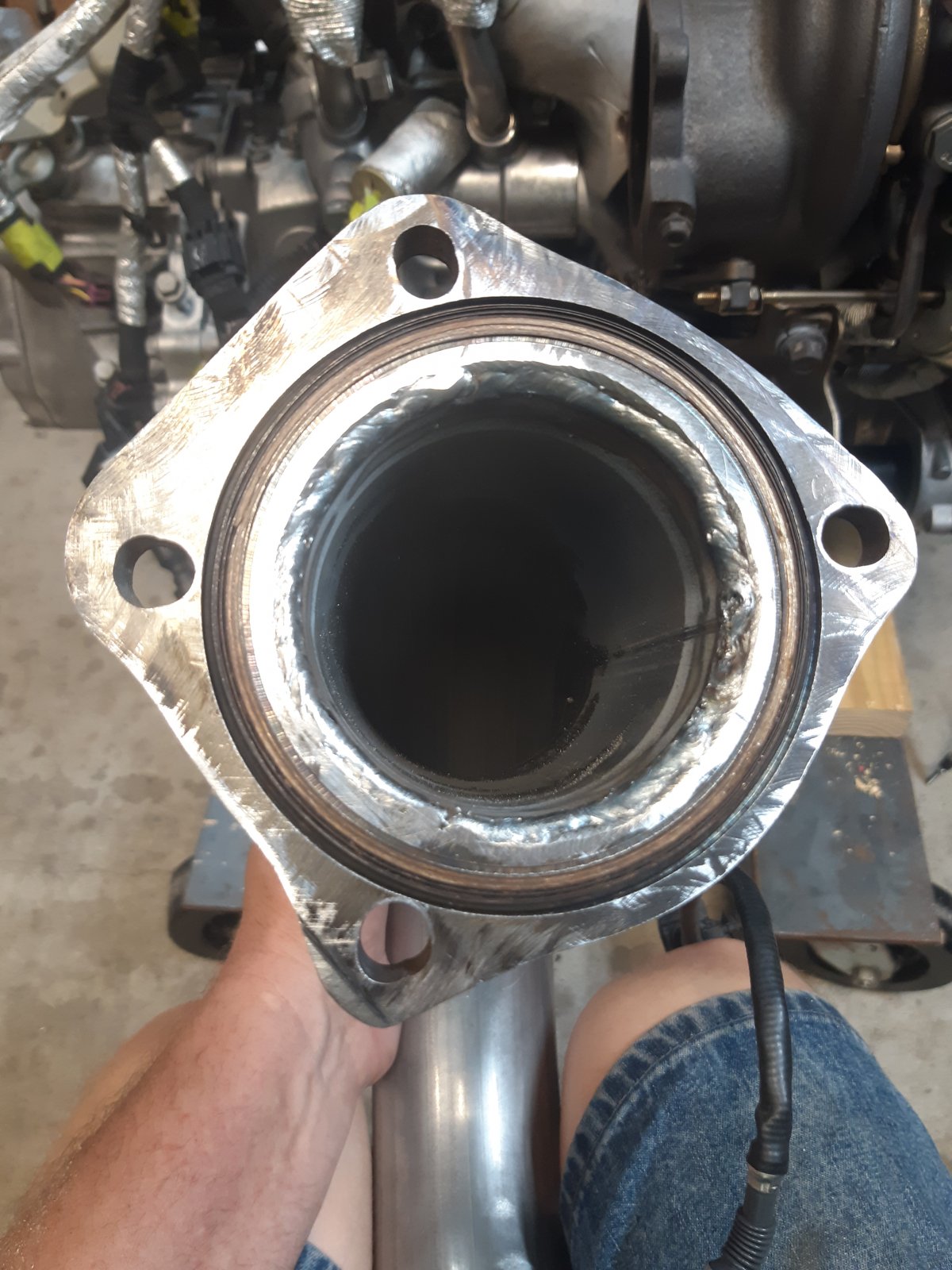

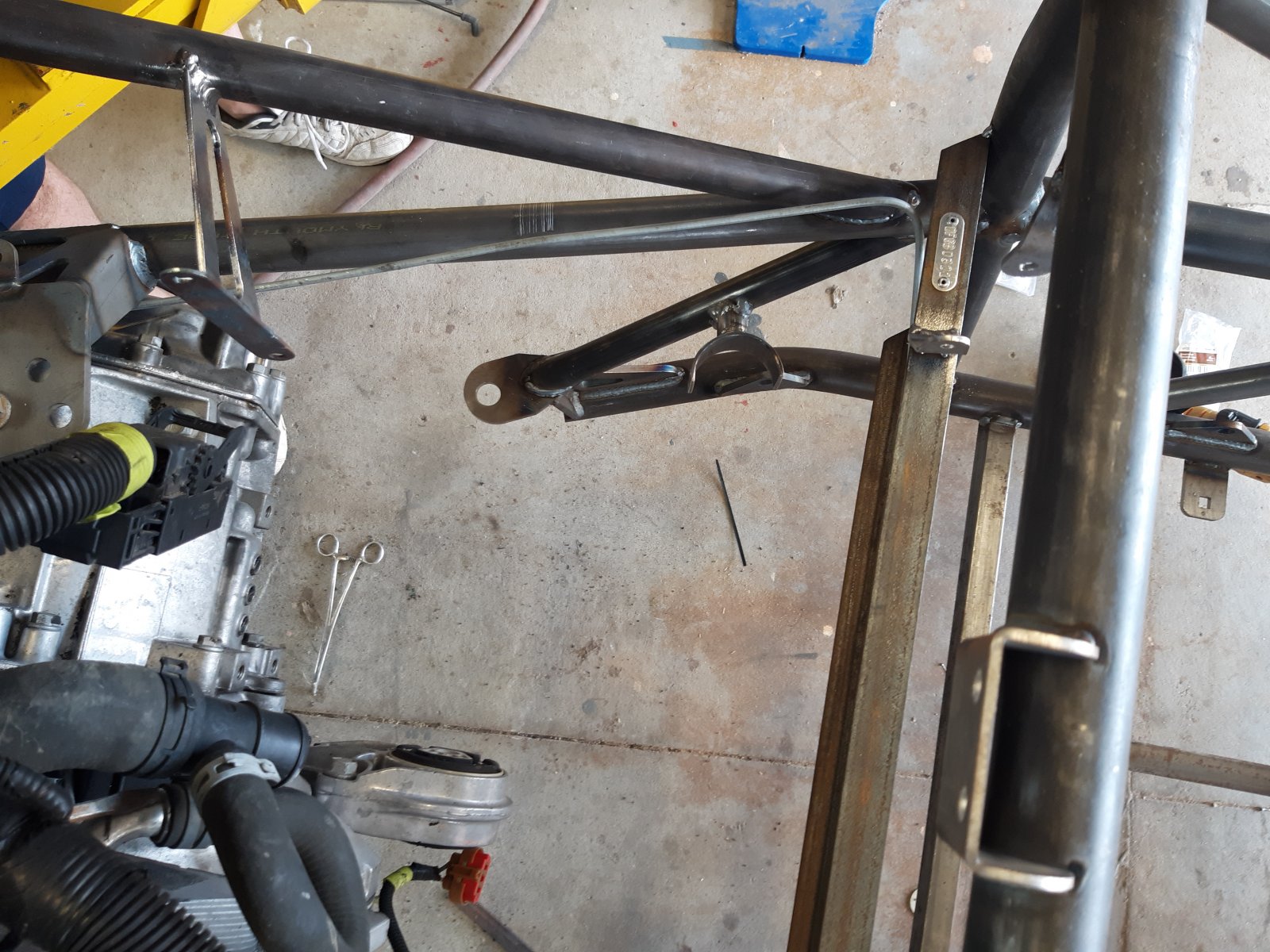

Only been able to work on it a little this week but on my way to some modifications I had planned prior to powder coating. Donor had the Hahn cold air intake so I cut it and rewelded including add in a frame tab.

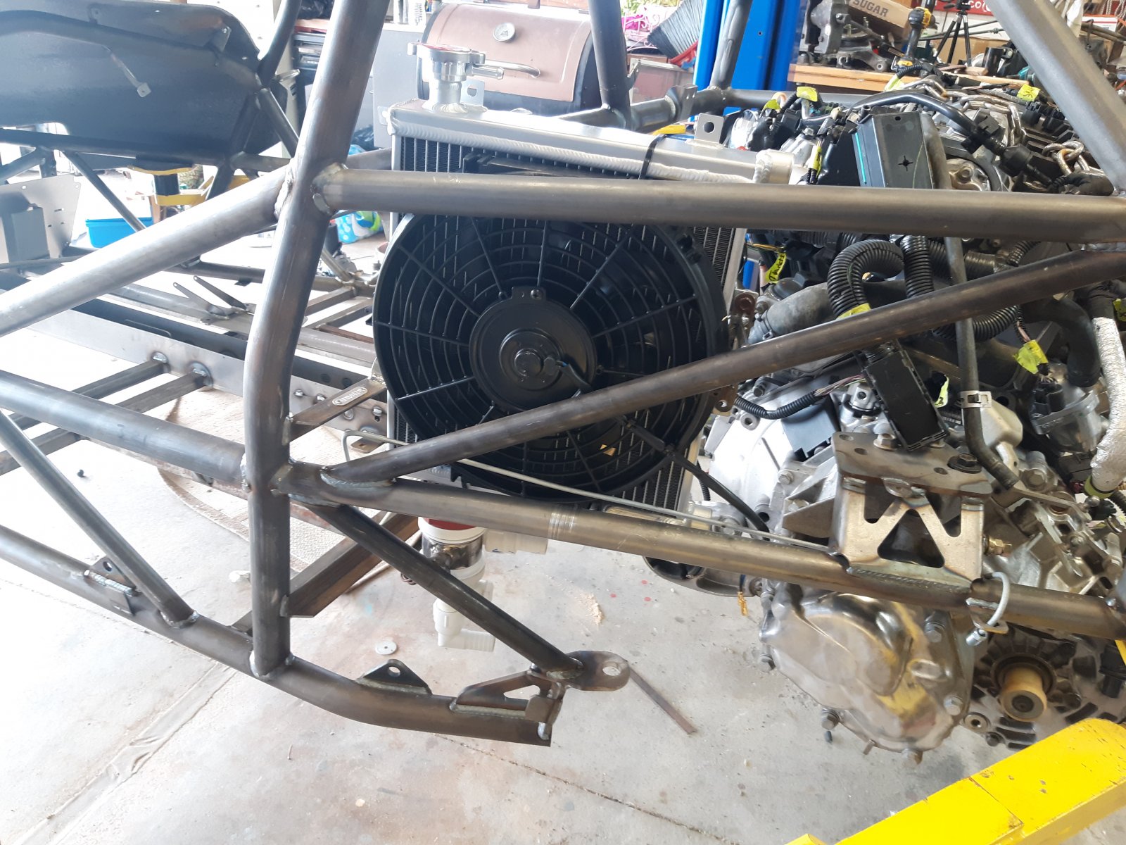

Added mounting tabs for larger intercooler and 401FC pump.
Here it is w/intercooler and pump in place. Not pictured but it does clear the fuel tank and PDC.

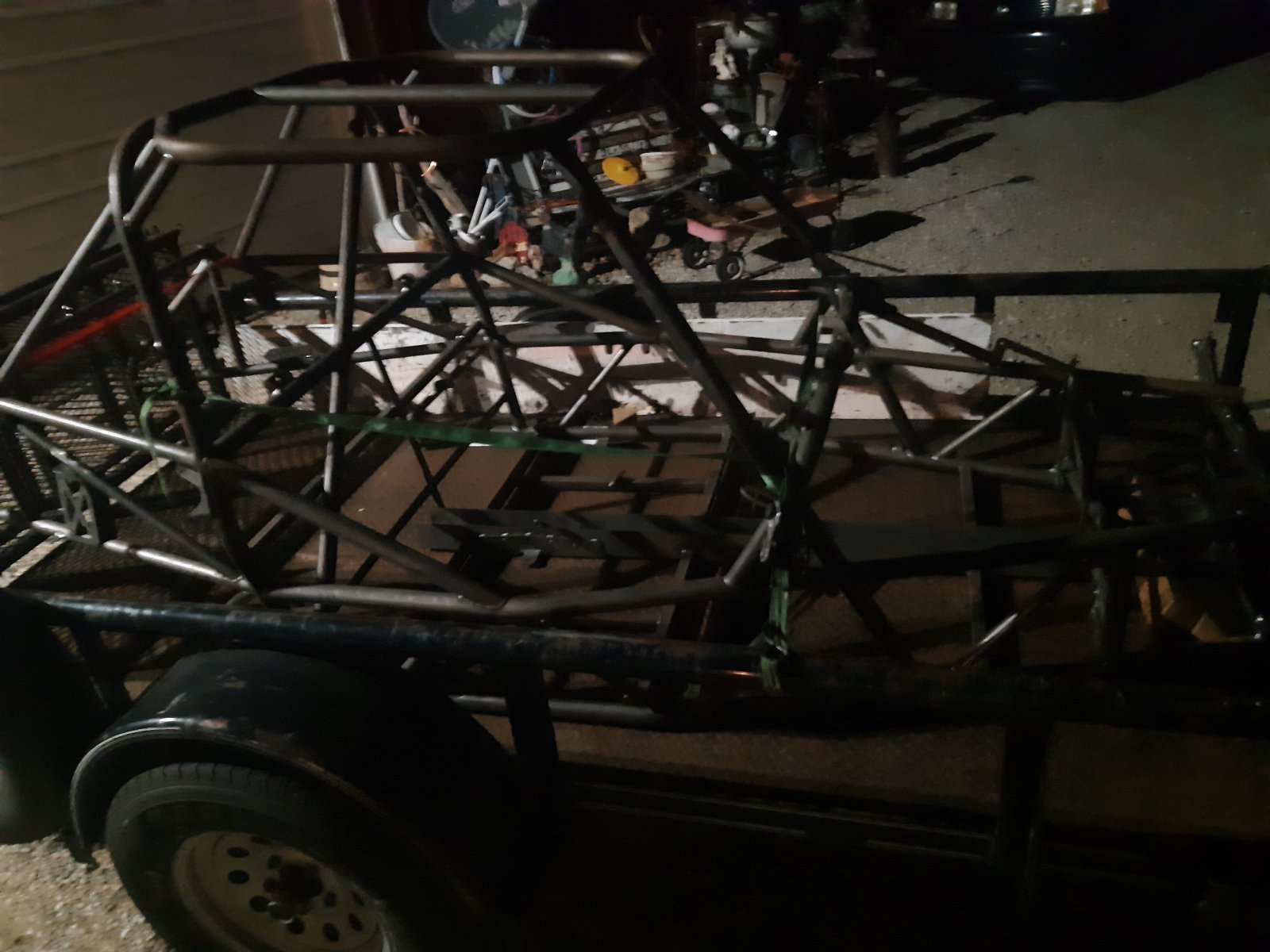

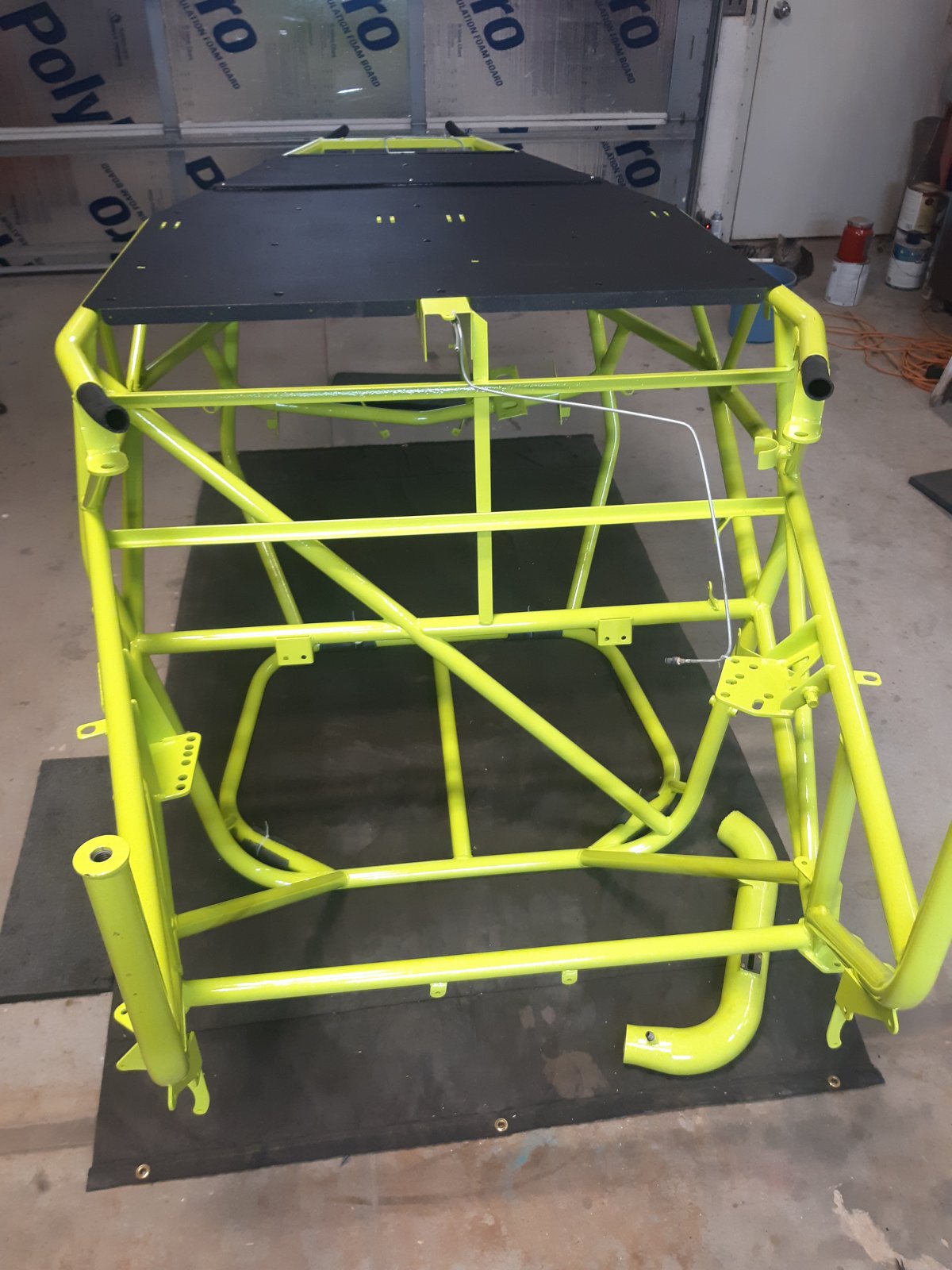

Finished making my frame modifications and powercoater is ready for me to drop off in the morning. Going to be a long two weeks waiting. Never thought o would stress so much picking a color. Really liked the look of the shocker yellow but could not duplicate the color of the nearest goblin.

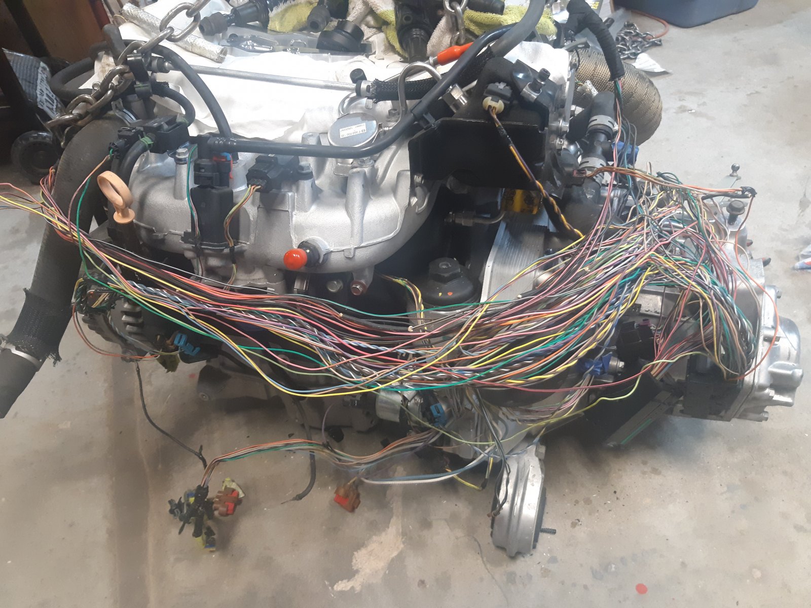

I really did not have a problem with corrosion during teardown or with components suffering oxidation cancer with my donor I picked up in Alabama. Interior was a different story as a mixture of soda, coffee, and I assume some form of hardwood floor sealer covered the floor areas. Steering shaft was seized to the point that I almost ended up destroying it to break it free. Just FYI if you drill out the set crimp to separate the halves the splines only allow assembly to go back together in the correct phase. At least the case with my 09 sedan donor.

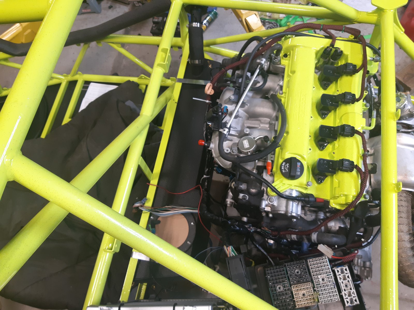

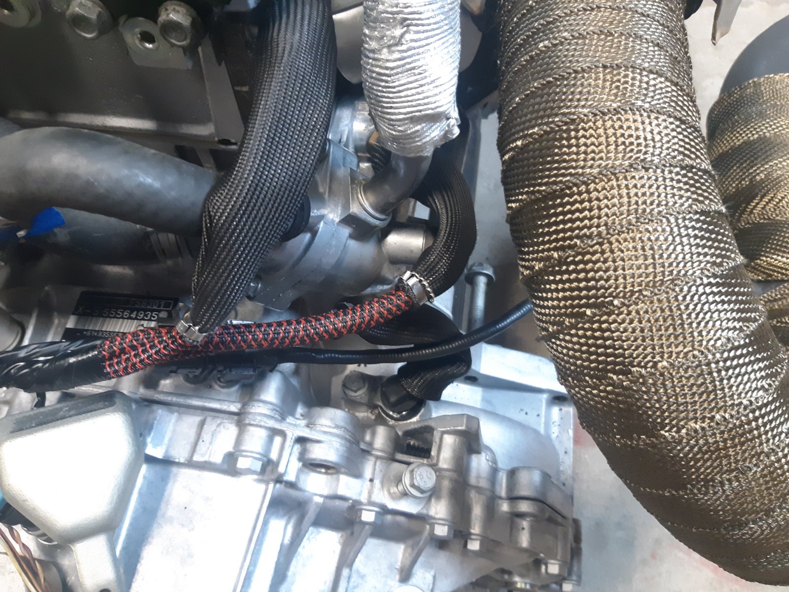

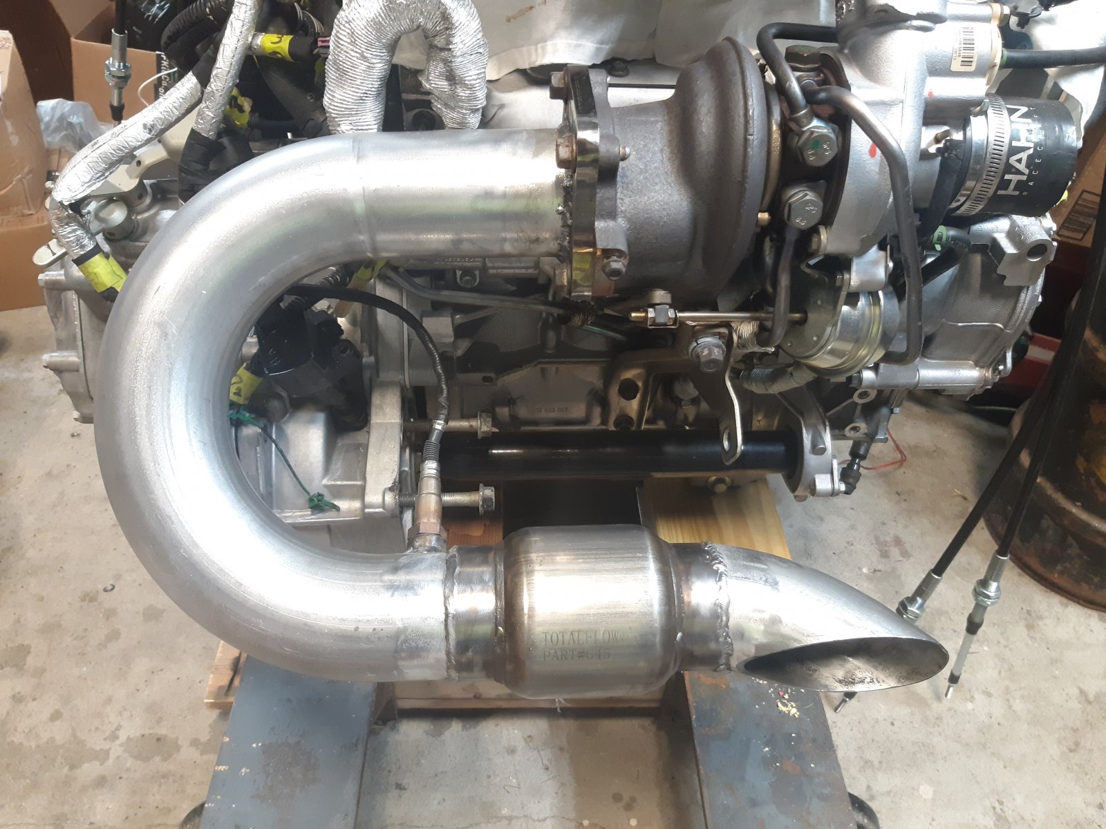

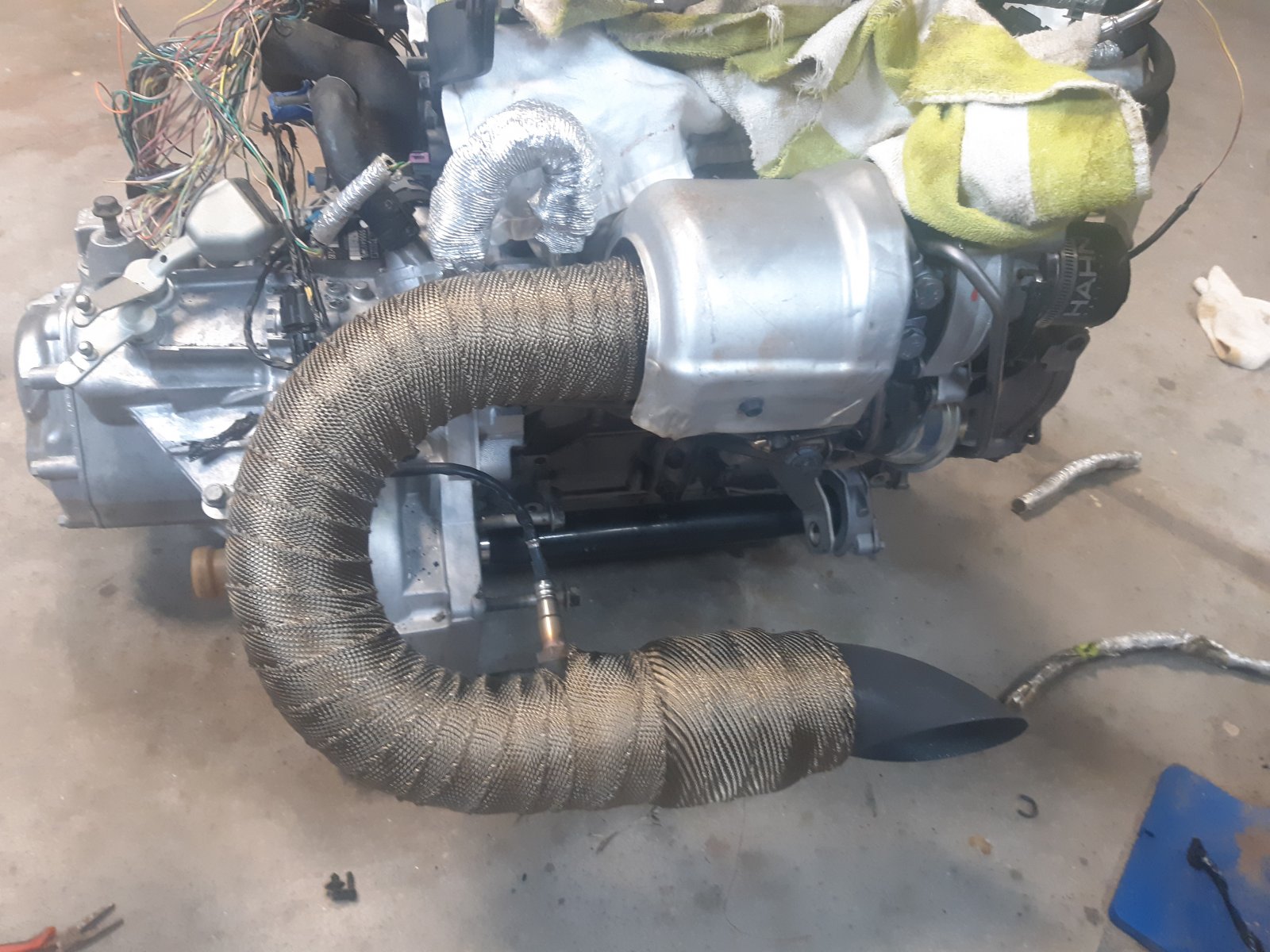

Exhaust finished and starting rewrap of engine harness. Hoping frame is done power coating by weeks end.

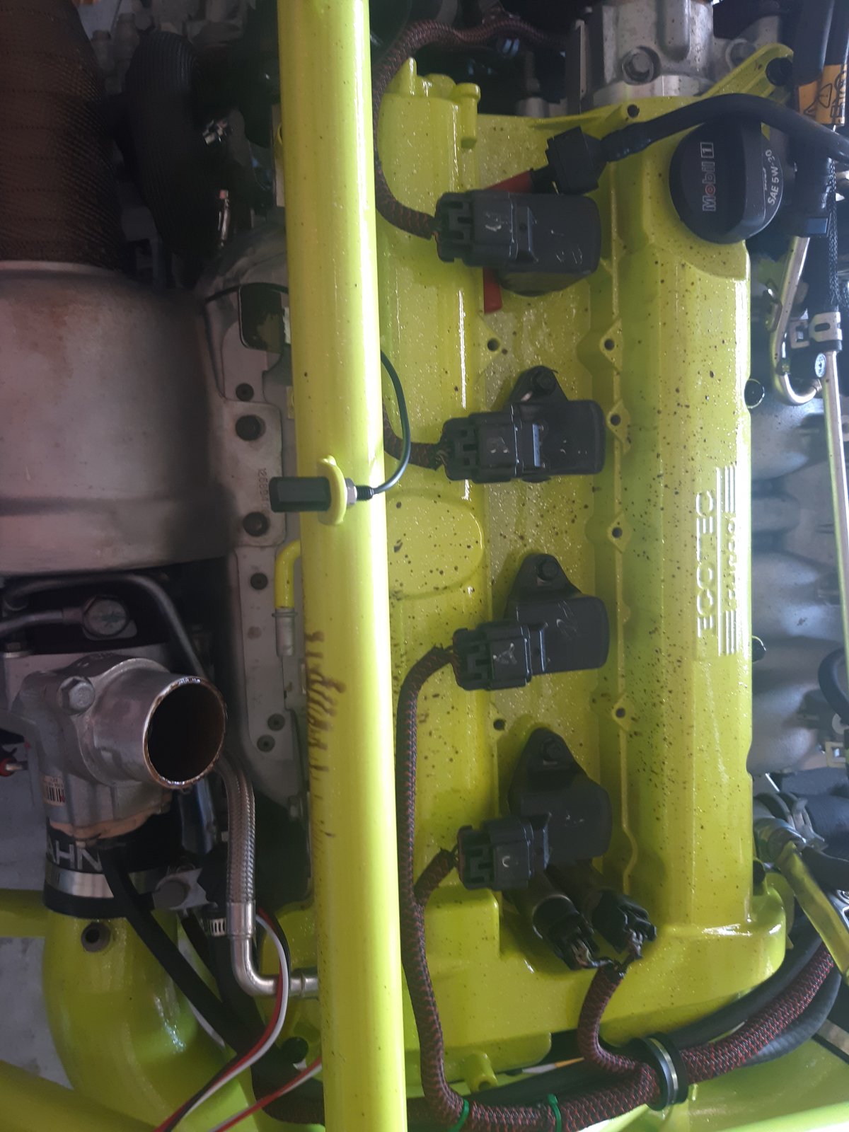

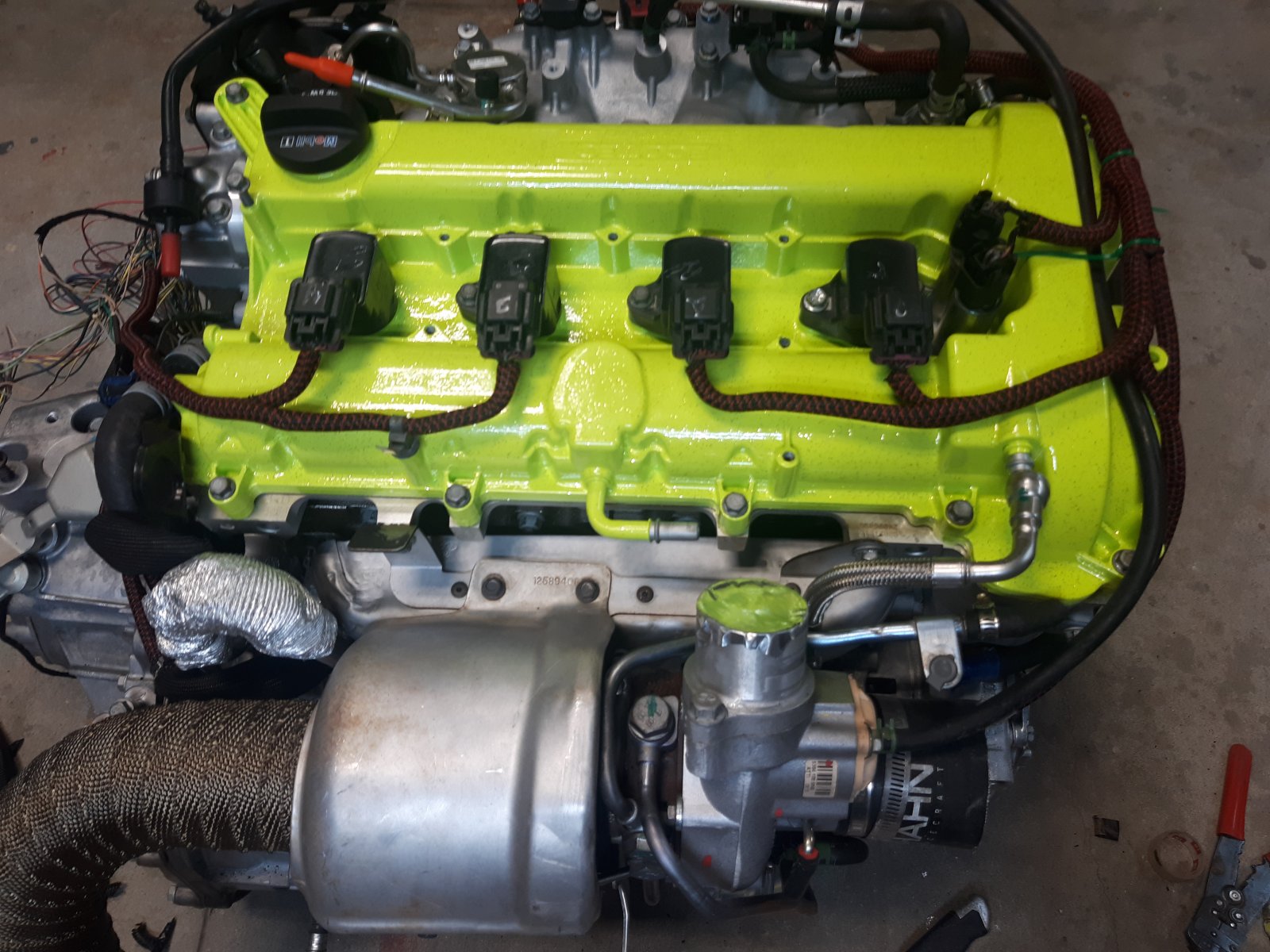

OK finally received frame and components back from powder coat late Friday. Didn't get much time today but did get hoses pulled and floor pan installed. Installed valve cover and started finalizing engine harness rewrap. Used spark plug boot insulators for heat protection but not really excited about the boot insulator look.

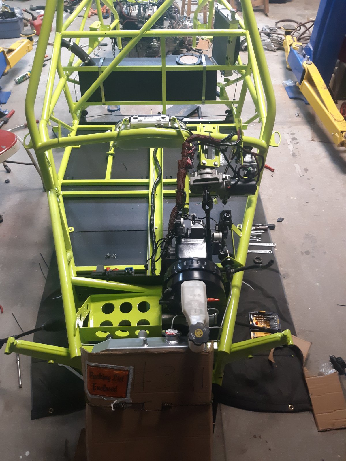

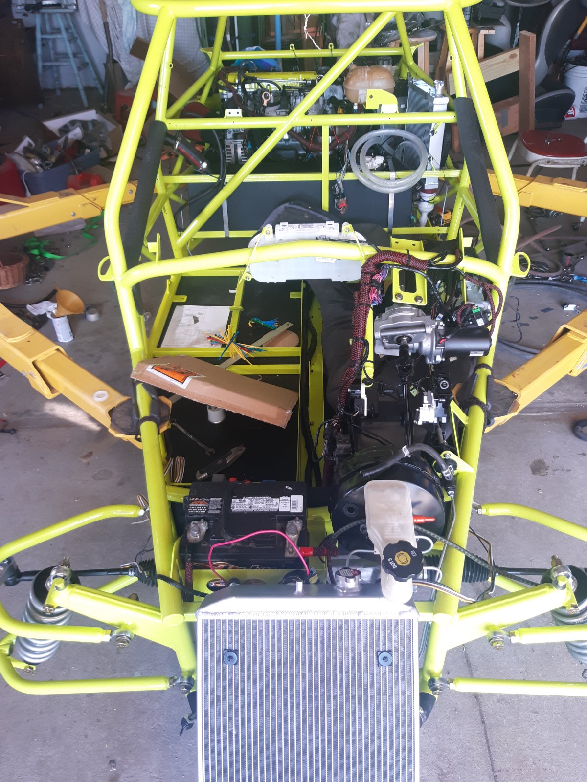

Managed to get 8 uninterrupted hour in on the car today. Amazing what you van get accomplished when you actually get time left alone to work. Excuse the mess I just called it a night without cleaning up. Hope I didn't get over zealous and install something I'll have to remove later.
Managed to get 8 uninterrupted hour in on the car today. Amazing what you van get accomplished when you actually get time left alone to work. Excuse the mess I just called it a night without cleaning up. Hope I didn't get over zealous and install something I'll have to remove later. View attachment 26774
Does the clutch master cylinder need to be clocked (counter clockwise) to have the hose inlet pointed in more toward the middle of the car? Seems it would interfere with the hood being angled off toward the next lane. :D
Lol I had to do a double take at the pic and then the car. I guess I snapped the pic prior to completely installing the clutch cyl, good catch.
Towerdog
Going to have to cut a big hole in the hood if you are keeping the brake reservoir in the stock location.....

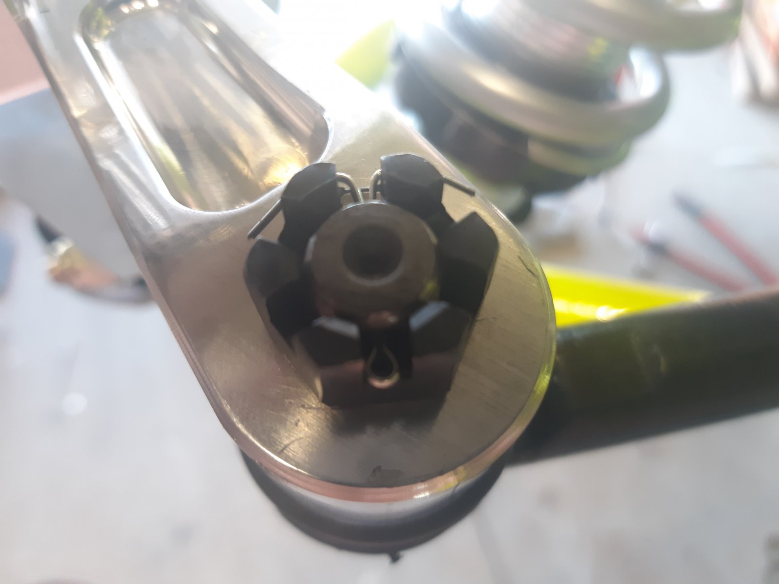

Ok, I find this highly questionable. These or the DF supplied tie rod ends moved to the front per other duild logs. Both sides are identical and the tie rod does not penatrate far enough for the supplied cotter pin to be inserted. Even these tiny ones installed had to be bent to go through???? These are not powder coated or painted so no debris is stopping them from seating. What am I missing here?
MJP61
Double check that you put the tie rod into that piece the correct way. Try turning it around. The tie rod only fits all the way in one way.
There should have been two nyloc nuts supplied with the rod ends to replace the castle nuts.
If you did not receive them let DF support know and we will send you a set.

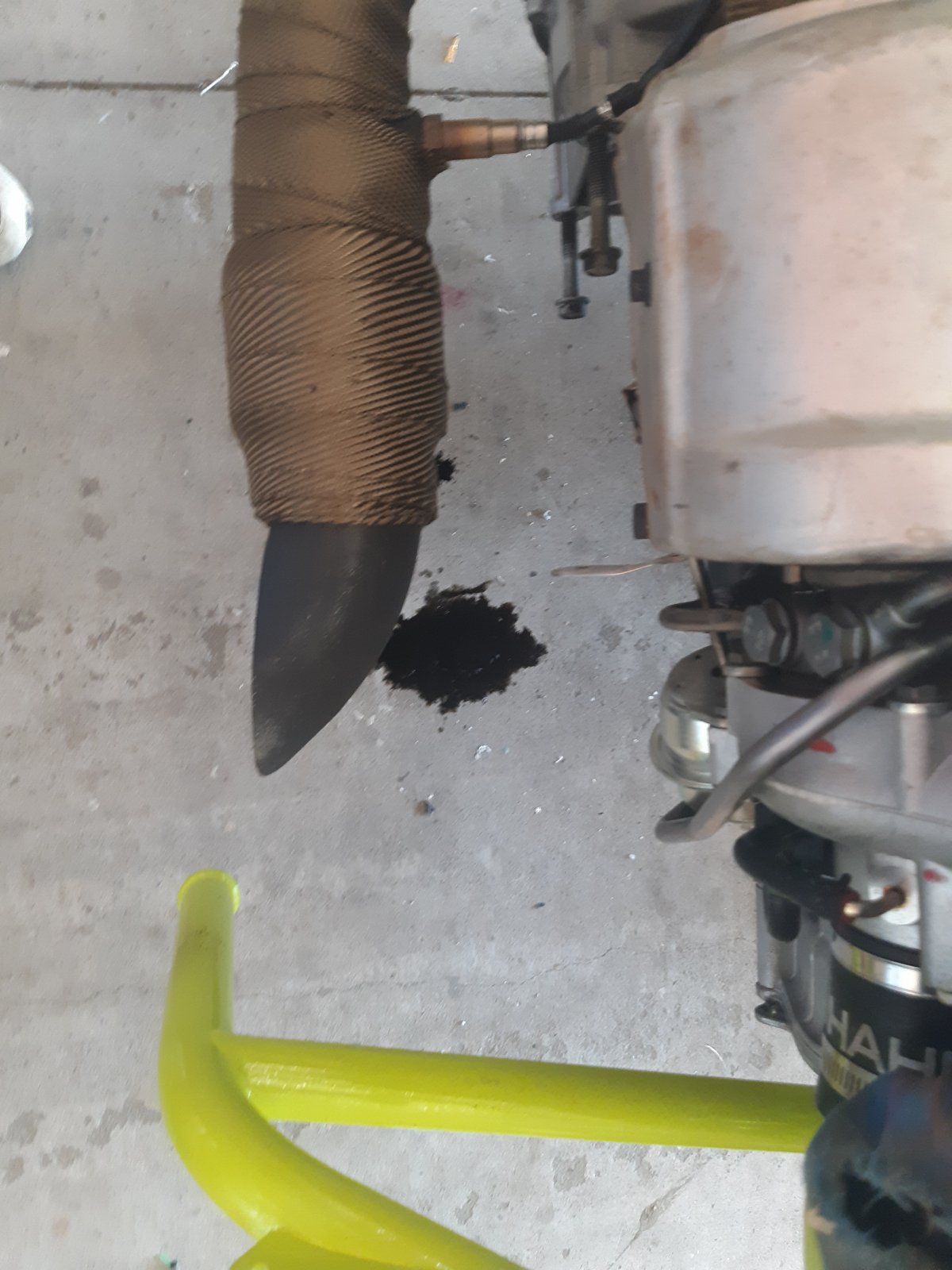

Update 8 days since I picked up the frame from the powder coater and she runs. After letting the coolant fan cycle a few times to make sure no air pockets were present I performed a BG products intake cleaning for direct injection vehicles. Did not dissemble before or after but she burped out a lot of soot and smoke during the process.
Now the bad news. Running the car without the charge air pipe connected to the turbo or the intake I found myself getting covered with small oil droplets from the turbo. Bummer.... Zzp has been out of the Z54 for months and I really don't want to spring for the ZFR. Anyone got a good used k04 they want to part with?
