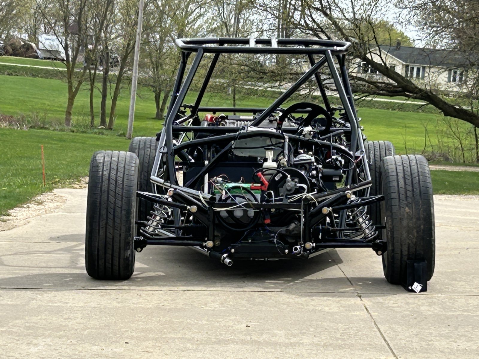

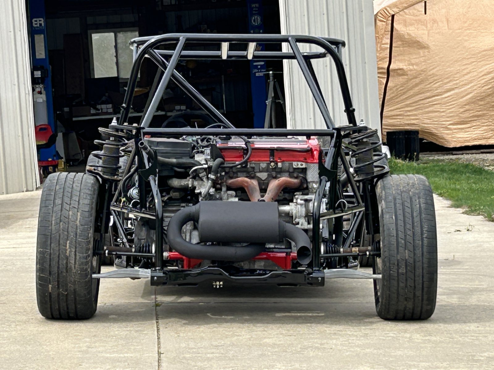

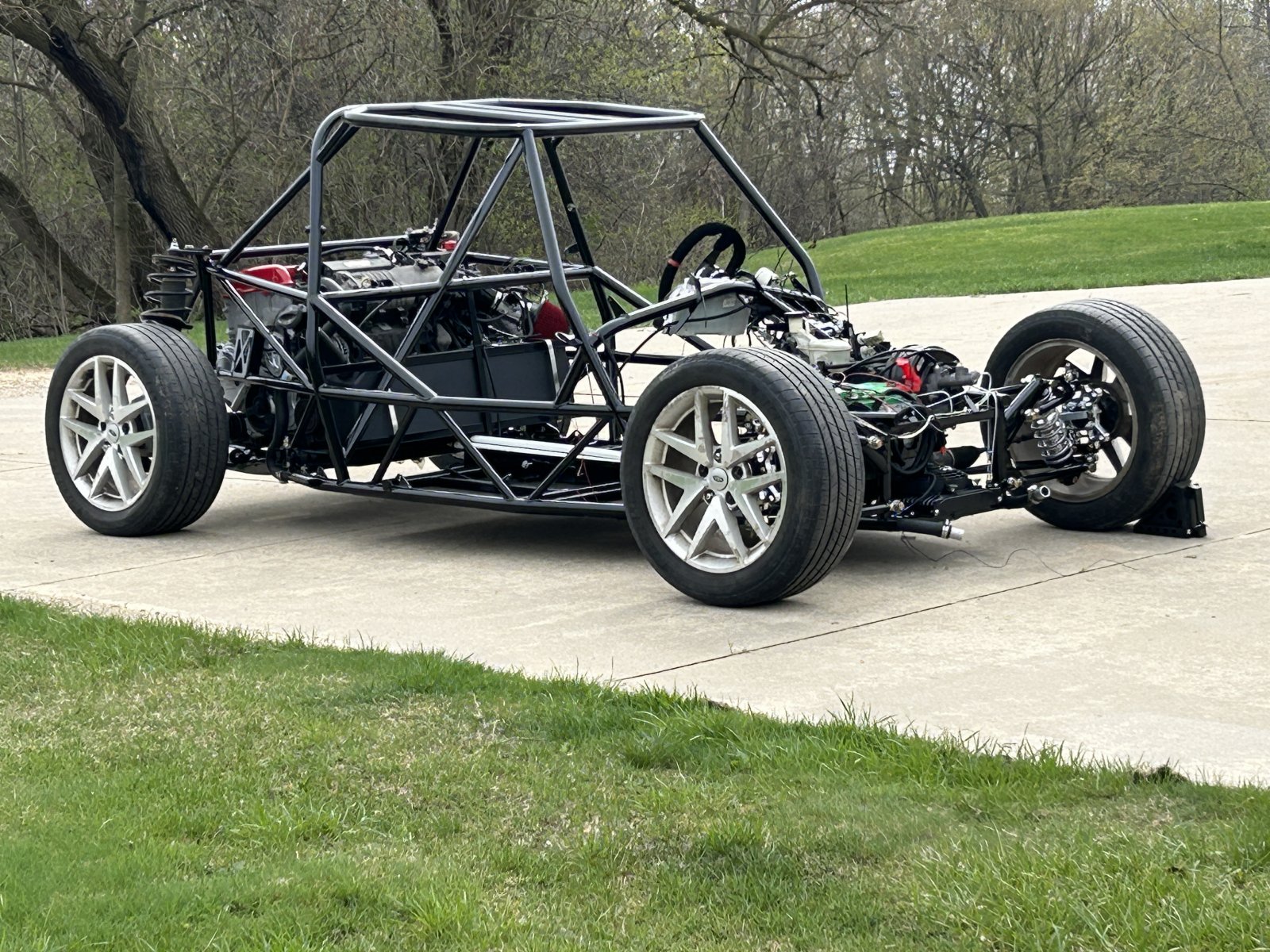

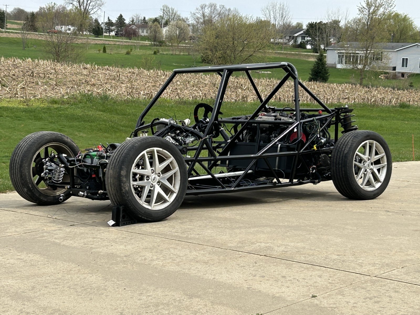

Some progress has been made. I needed my lift back for a different car tomorrow, so I made the Goblin a roller to be able to get it out of the barn. It starts and runs, but no cooling, shifter or brakes on it yet. Wheels are off a 2011 Ford Fusion.
39828
39829
39831
39832

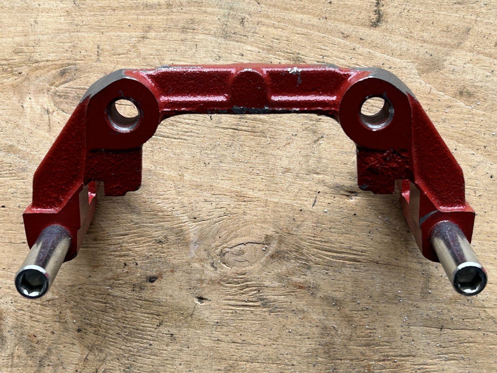

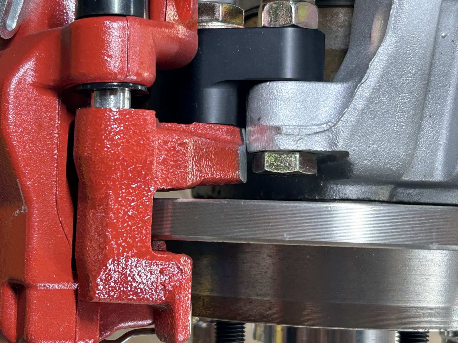

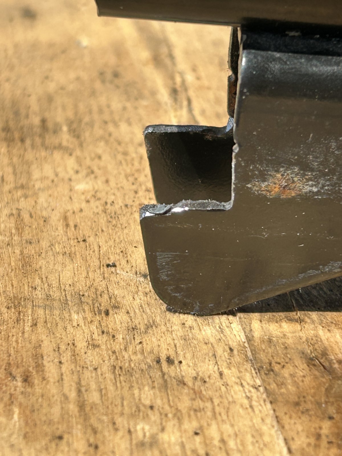

So more progress, but it's a slog. Spent about 6 hours yesterday just getting the rear brakes to fit. Not sure if DF sent me the wrong units or what, but the initial fitup was terrible. First had to file off a significant amount of the bracket ears:
39890
and shave the knuckles ears a little just to get them to play together:
39891

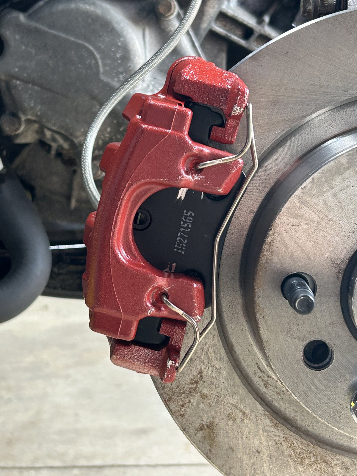

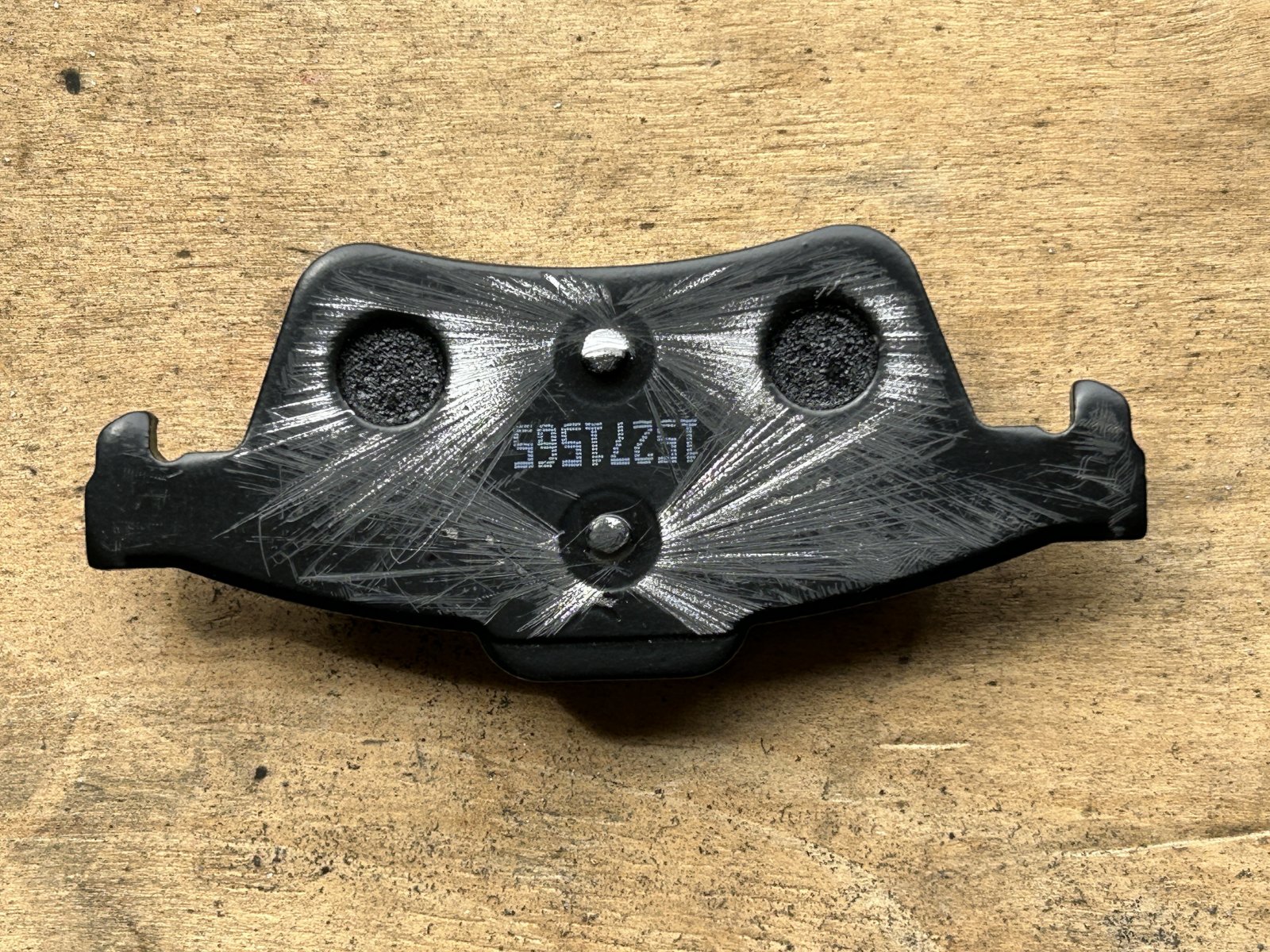

It was like that on both sides. And then the pads DF supplied didn't fit the calipers. The little buttons on the back of both inner and outer pad interfered. I completely removed the the buttons on the outboard pad, but the inboard buttons were needed to fit into the anti-rotation holes in the caliper piston. I had to file about 50% of the buttons away before the pad would fit into the caliper:
39892

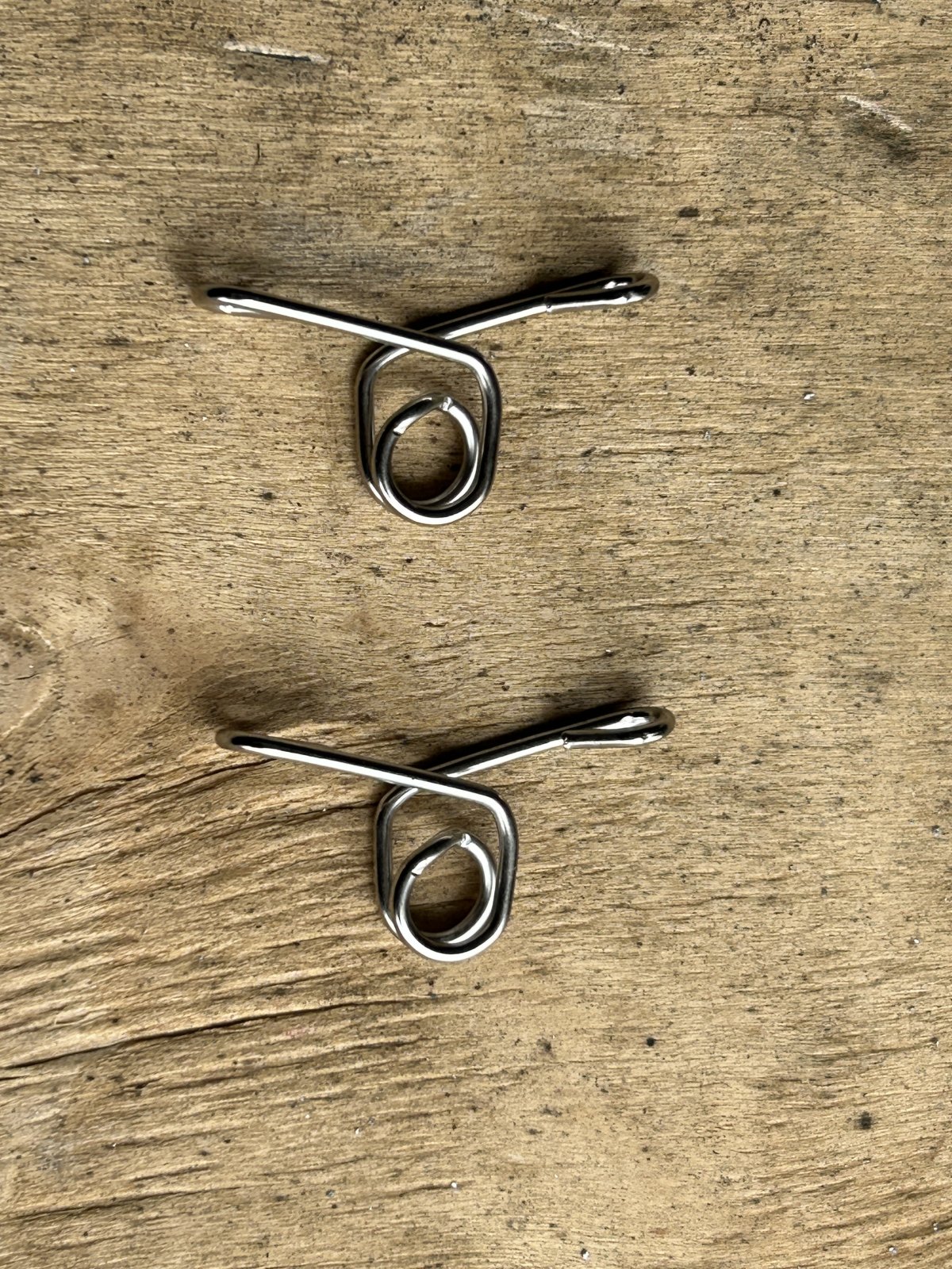

These springs were included in the brake kit from DF:
39893
No idea where these go.

can you post a pic a bit more zoomed out? I haven’t messed with my rear brakes since the build, but I don’t remember having any issues and looking at pictures, it doesn’t look the same as yours.

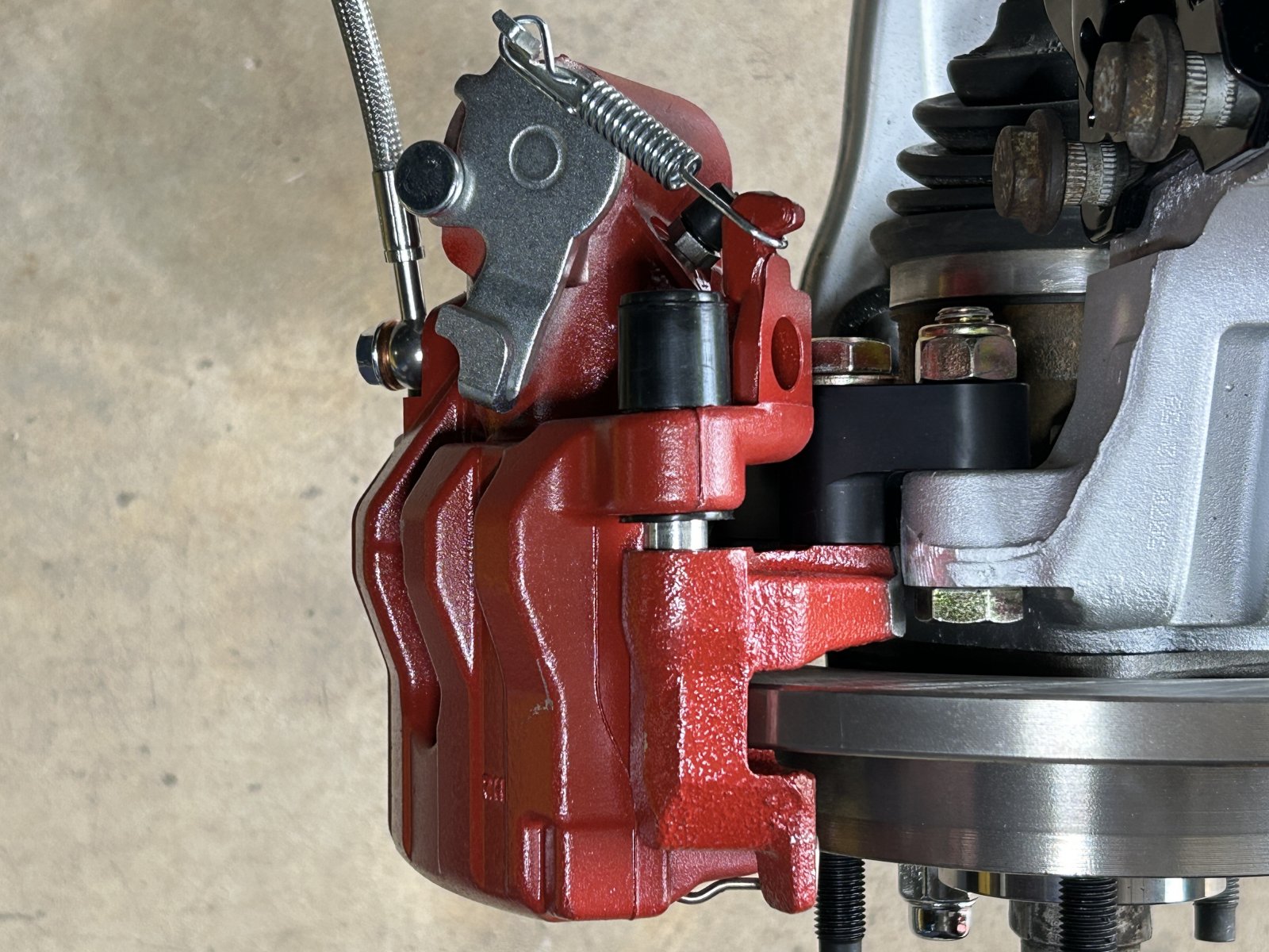

Not sure what you wanted to see more zoomed out. Do these help?
39894
39895
Just needed a better visual, just in case something was out of place. Everything looks the same as mine, just odd you had to do so much grinding to make it fit.

Be careful grinding those buttons on the backside of the brake pads as I believe those are the rivets that hold the pad material to the metal backing plate. Having those two separate under heavy braking would not be good. If they didn't fit without grinding maybe your pistons weren't compressed into the caliper all the way?

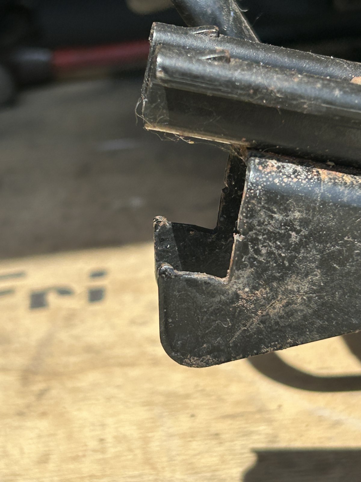

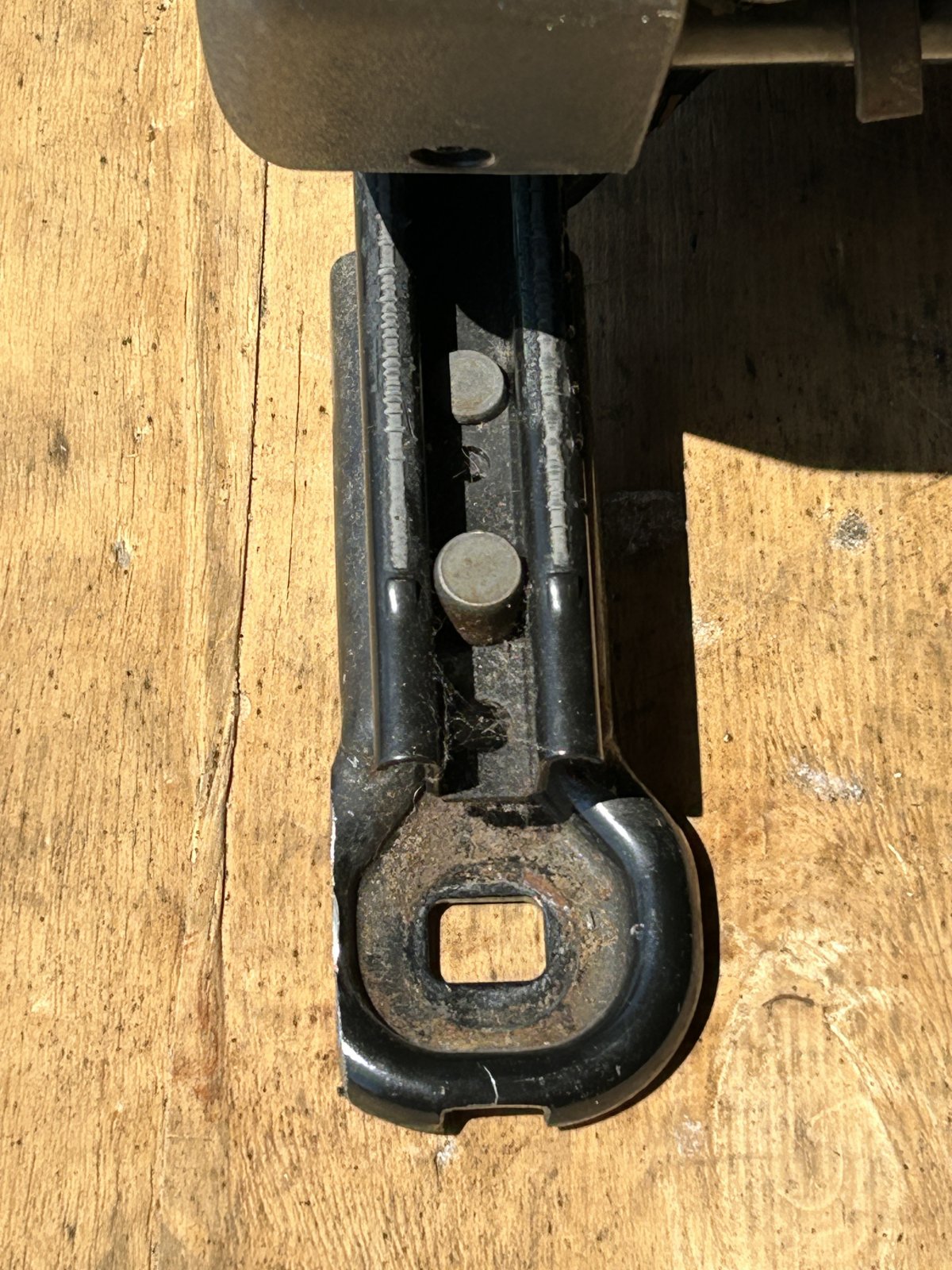

So just like in my last post, still making progress, but everything is still a slog. Took me an hour to try to get my driver's seat installed. I'm reusing my donor's seats, so I thought they'd be a direct fit into the Goblin. Oh nay nay. First mod is to remove and discard the plastic hinge cover on the inboard side that makes contact with the tunnel. Second mod is to grind off the little nubs on the front of the seat tracks:
40306
40307
Third mod is to grind off the edge of the rear outboard seat track mount:
40308

Went for my first test drive, which was mostly uneventful. The goal was just to do a short shakedown run to get the car up to temperature and check for any anomalies. For just eyeballing the alignment, the car tracked better than I expected. No major surprises in the shakedown run. However, upon my return I noticed the rear brakes were dragging a little, which didn't really surprise me as I had a terrible time trying to get the parking brake cables fitted. I assumed that after a couple runs the cables/calipers would settle in and loosen up. I assumed wrong.
After my second shakedown run (about a mile) I pulled into the garage and I could smell the brakes dragging. The rotors were taking on a golden-turning-blue shade from the heat. I'm starting to wonder if DF gave me the wrong pads for the rear too (they sent the wrong pads for the front - discussed in the "This can't be right" thread here on the forum). Detailed in post #24 above, I had to grind away most of the anti-rotation buttons for the pads to even fit in the caliper (the buttons on the pads were 6mm dia and the holes in the caliper are 5mm dia). I googled the part number on the pad (15271565) and it shows its for the 06-09 Solstice. Others on the forum say they're using that pad and it fit without issue. Now I wonder if the pads I got are defective, the caliper piston is defective or if the caliper itself is wrong.

When you istall the handle, you might need to adjust the threaded rod on the handle to just take up the slack when the handle is down all the way. If the nut is tighted too much, it will engage the brakes when you don't want them to. Also you might have the piston in the caliper indexed out too much so that it won't retract off the rotor when the hydraulic brakes are released. IF you were playing with the parking brake system without the pads or the rotors installed, the piston may index closer to the rotor as a system designed to account for pad wear over time. with the new rotor and new pads, thay clearance might have been taken up before you used the brakes on the Goblin the first time.
First thing is to check that you have a tiny bit of slack in the cabling at the parking handle when fully lowered. If so, then remove a caliper and see if you can push or rotate the piston back into the bore. Reassemble and see if the wheel spins free.
The good news is you have bedded your pads to the rotors which should increase your rear braking force significantly.
Joe
I had to use a brake caliper tool to reset mine to even get the caliper to install on the disc.
Disc Brake Pad and Caliper Service Tool Kit, 11-Piece (harborfreight.com)
Yeah, that's the tool I used to wind the pistons all the way in. Its how I discovered that the buttons on the pad were bigger than the buttons on the caliper tool.
I did not know the parking brake handle was adjustable (per @Joebob). I'll give that a try. And maybe another brake bleeding for good measure.
