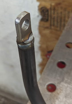

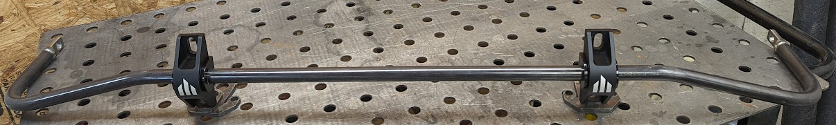

Managed to get my front ARB fabbed up today.
3/4"ODx.120 wall 4130 chromoly tubing formed on a custom tube bender that uses JD2 Model 3 dies.

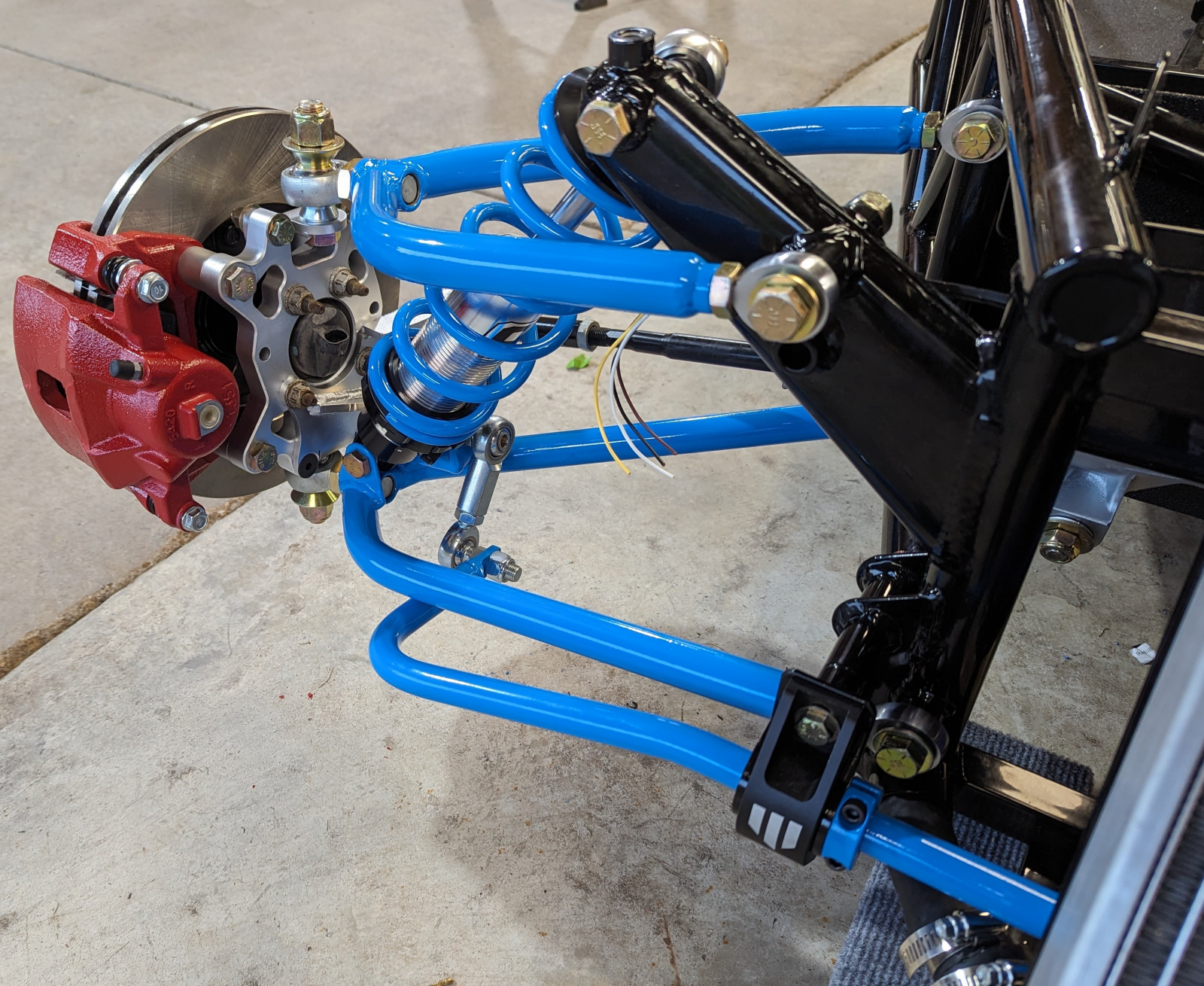

I'm planning on using standard 2 piece shaft collars up against the bushings to keep the bar from shifting left to right.
I made up some inserts to weld in for the linkage mounts, I think they look a little nicer than the smash and drill method.

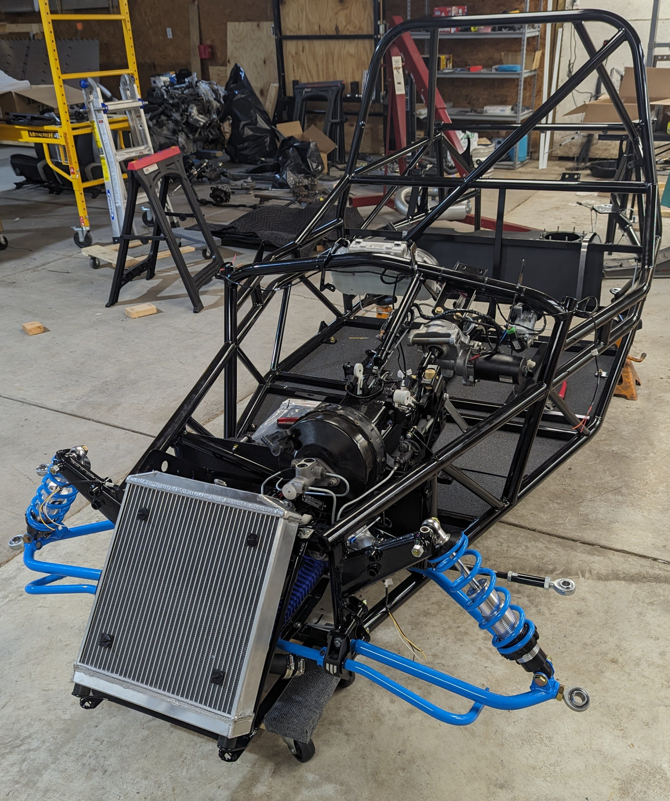

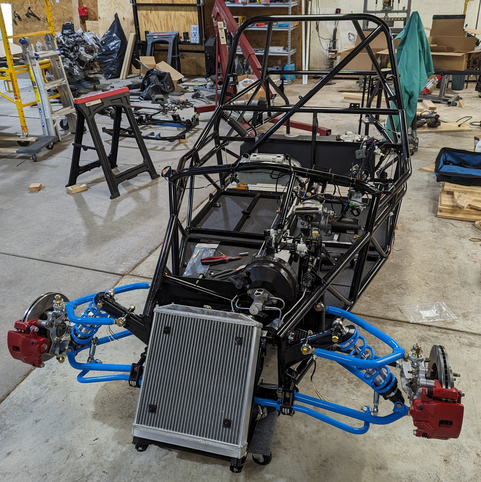

If the powder coater is on schedule, my frame should be done some time this week, so if all goes well, final assembly will start next weekend
