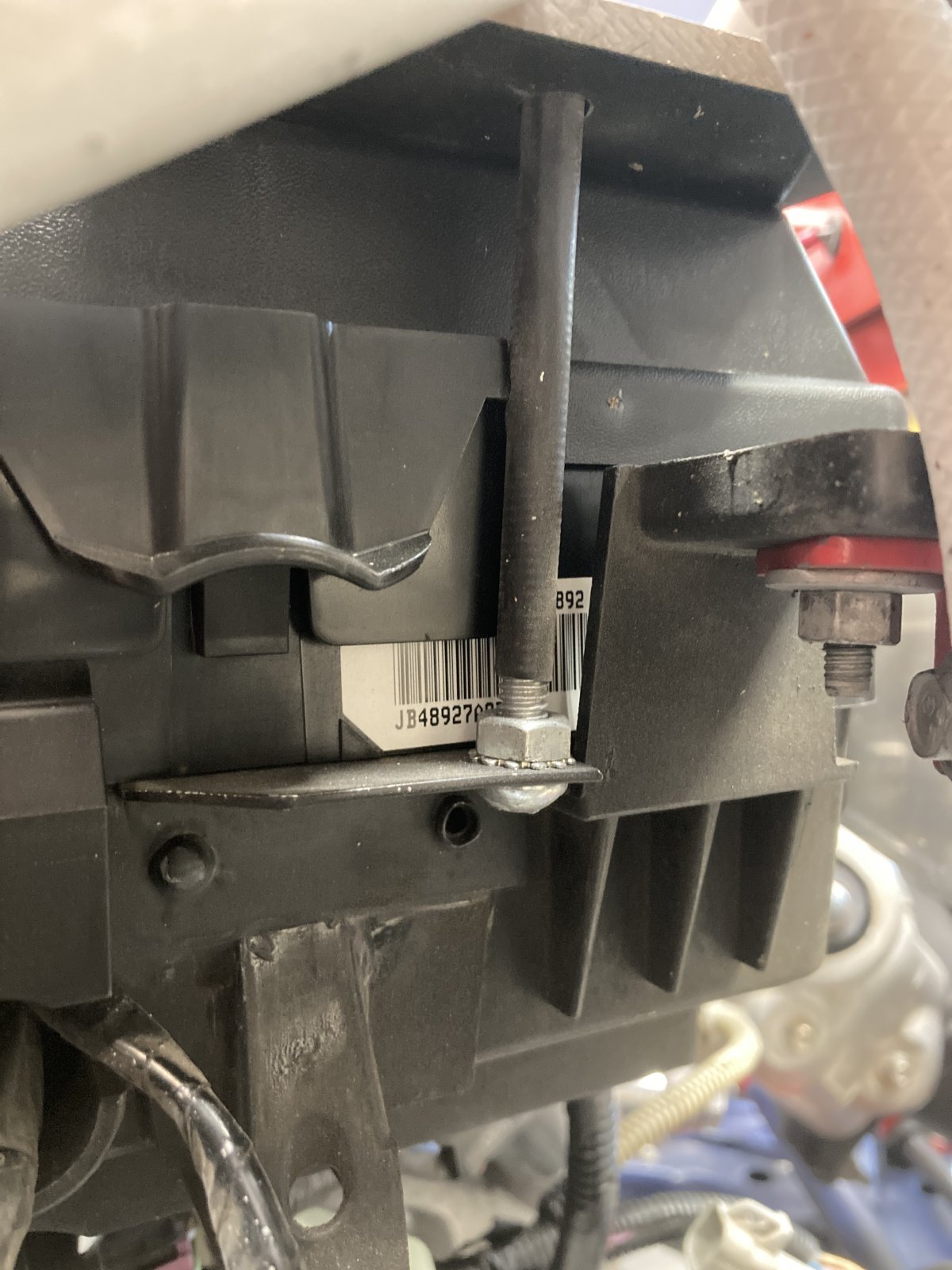

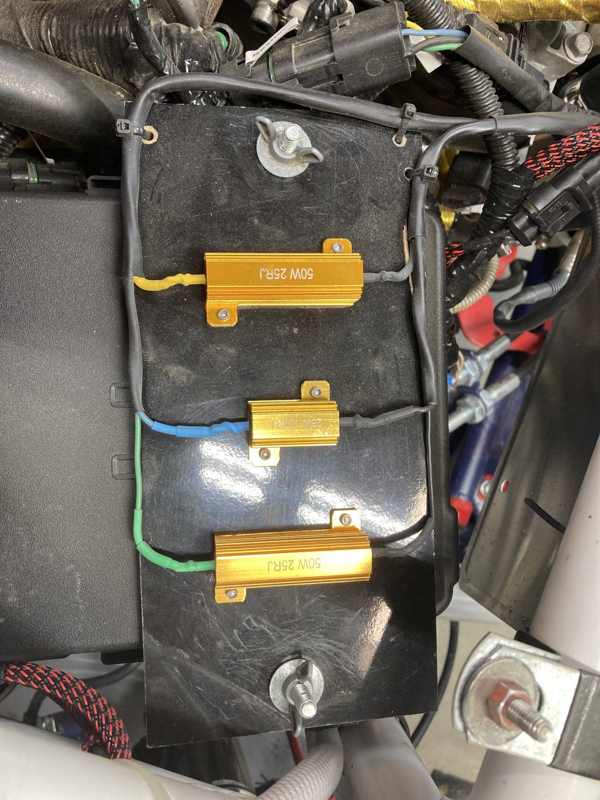

So the lower portion of the box is mounted and the upper portion doesn't clip into the lower? I epoxied/riveted an L bracket on either side of mine with stainless all-thread through. I then had another piece (used a piece of fiberglass with turn signal & Brake light resistors attached) across the entire top that was screwed down with wing nuts.
Thanks! Exactly the type of example I was looking for.
Sluggonaut
Ah, most of the damage looks to be the "middle section" of the assembly, so the fuse box itself. I have seen someone run a bungie cord around the fuse box and the lower piece to hold it together.
Exactly. I also refer to it as the middle section but called it the top section as I didn't know if everyone thought of it as a 3-piece assembly.
All of the damage is on the fuse box itself. The bottom part that bolts to the frame has all of the tabs and it's just the clips on the middle section that latch onto those that are broken off.

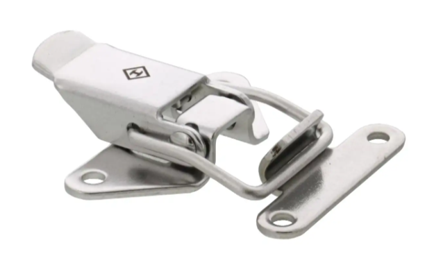

Wht not buy some cabinet latches, and rivet/epoxy them on?

All the hold down does now is keep the mount for the resistors in place, but it worked fine with the fuse box that had the broken tabs.
