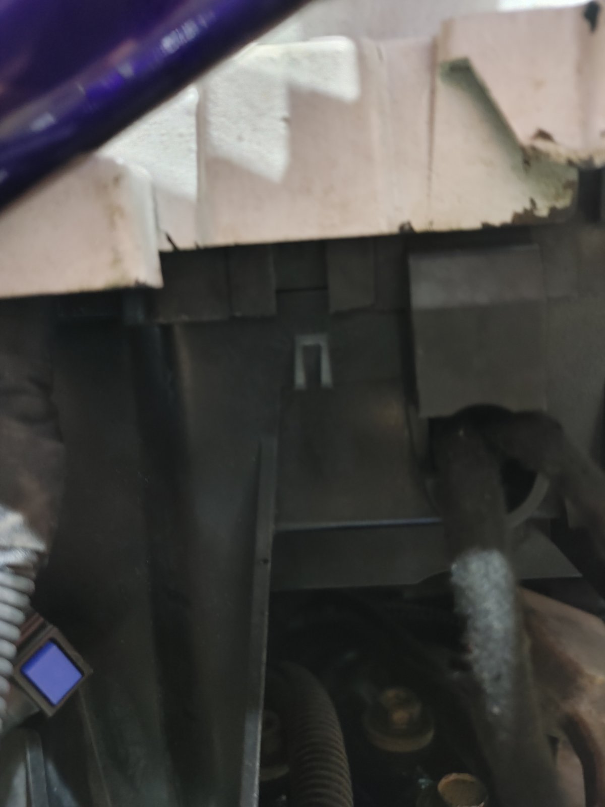

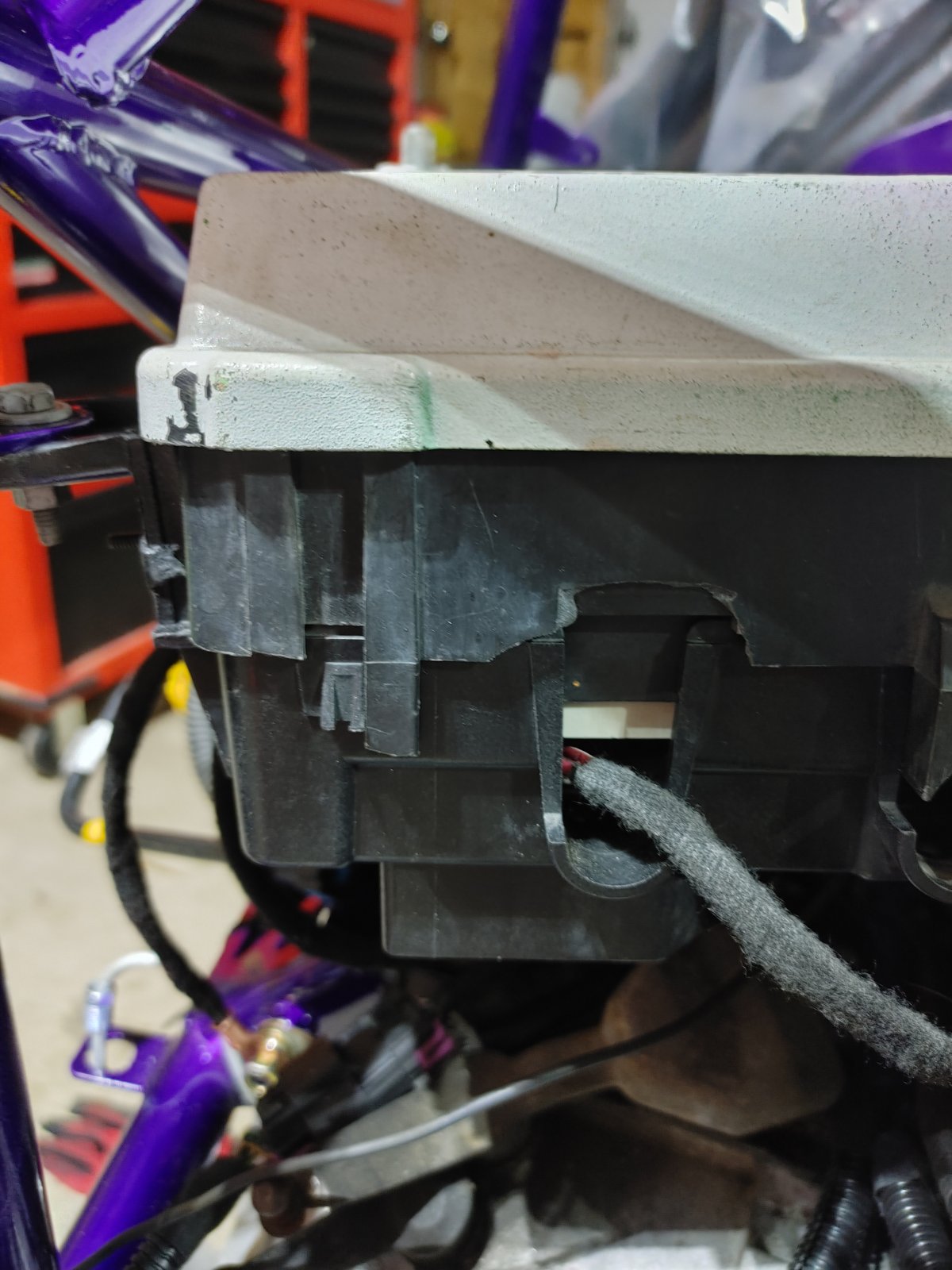

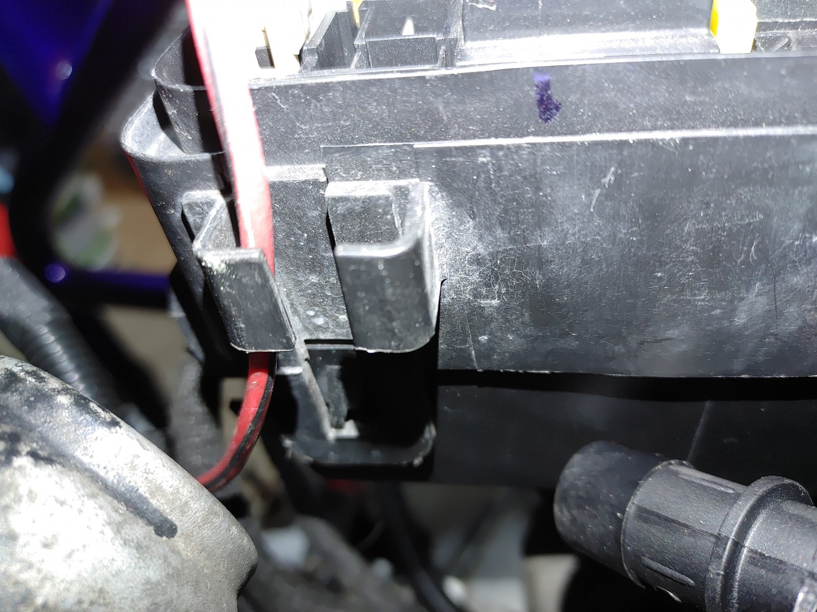

I ran into a couple of minor issues while working on the car this weekend. I didn't notice it before but it looks like every one of my fusebox tabs is busted off, so even with all the miniplugs bolted down, the top half of my fusebox can just move on its own and bounce around. The donor was running with the current fusebox so I really don't want to swap it out yet and introduce any variables or unknown issues. Is there a quick/easy trick for my situation or do I need to get creative with some metal strapping?

Sorry, had to run out to the garage to snap a few. The driver side and rear tabs on the top piece are snapped off. the only one intact is the passenger side under the power steering power cable.

So the lower portion of the box is mounted and the upper portion doesn't clip into the lower? I epoxied/riveted an L bracket on either side of mine with stainless all-thread through. I then had another piece (used a piece of fiberglass with turn signal & Brake light resistors attached) across the entire top that was screwed down with wing nuts.

Ah, most of the damage looks to be the "middle section" of the assembly, so the fuse box itself. I have seen someone run a bungie cord around the fuse box and the lower piece to hold it together.
I like Gtstorey's solution of epoxying brackets on then securing it. I was thinking about a short self taping screw to go through the sides but you need to be careful of where it is place so that it doesn't hit any critical wiring components.
