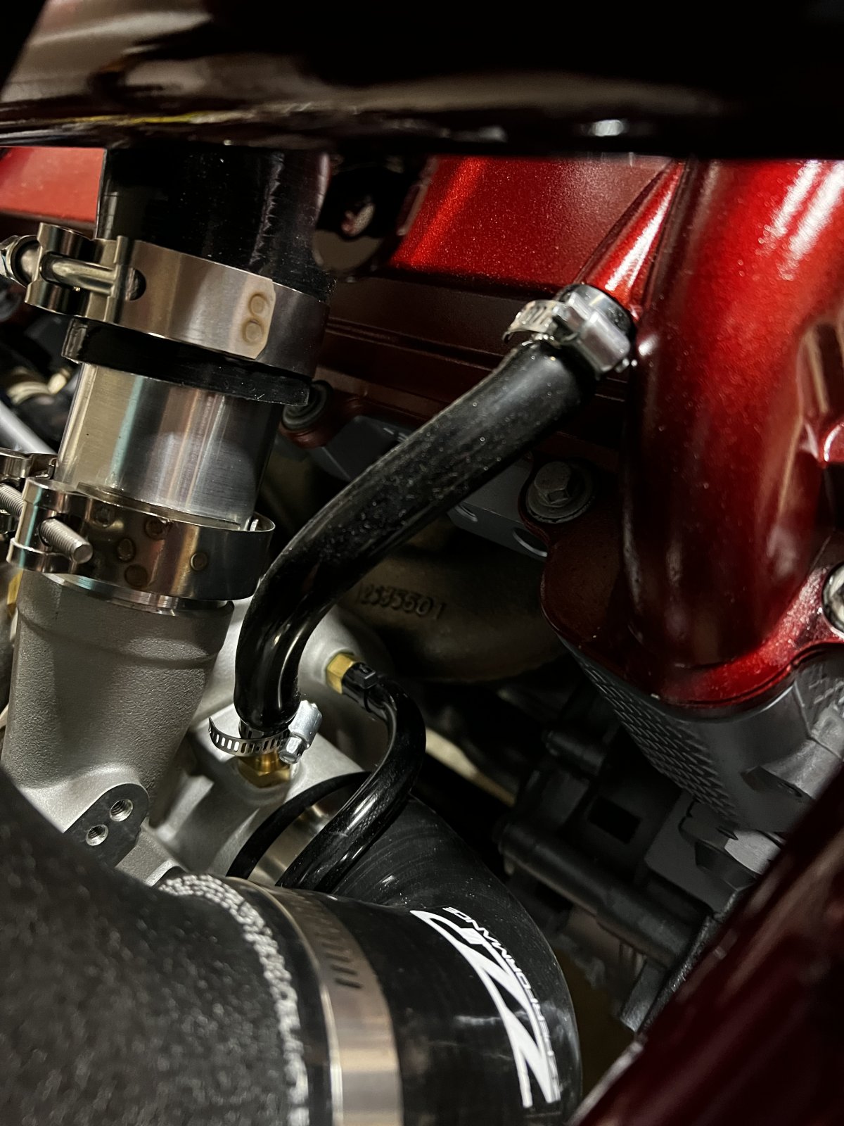

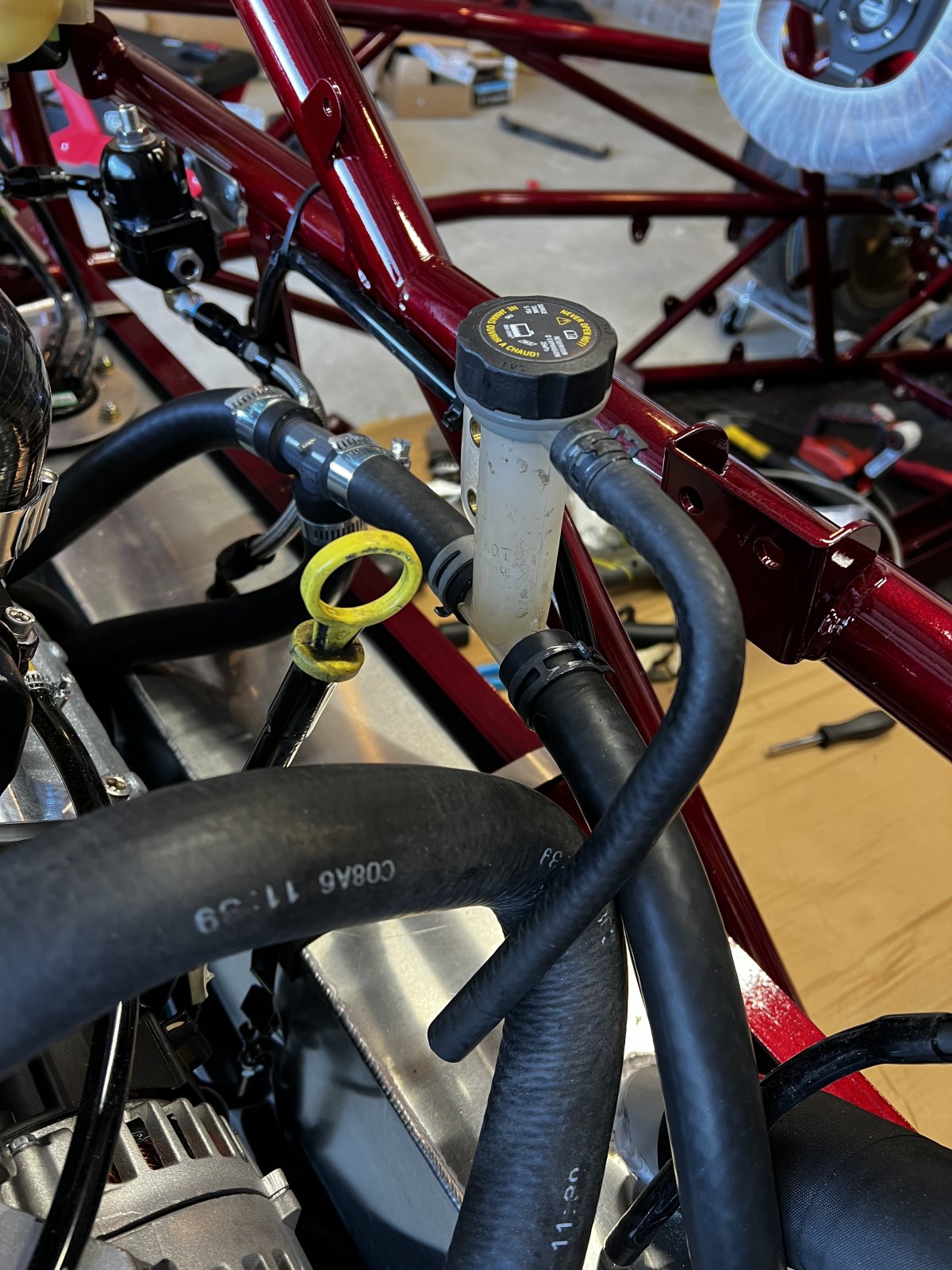

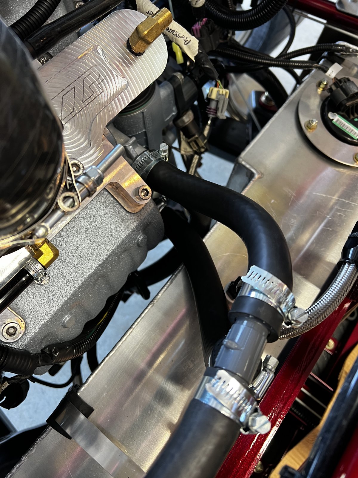

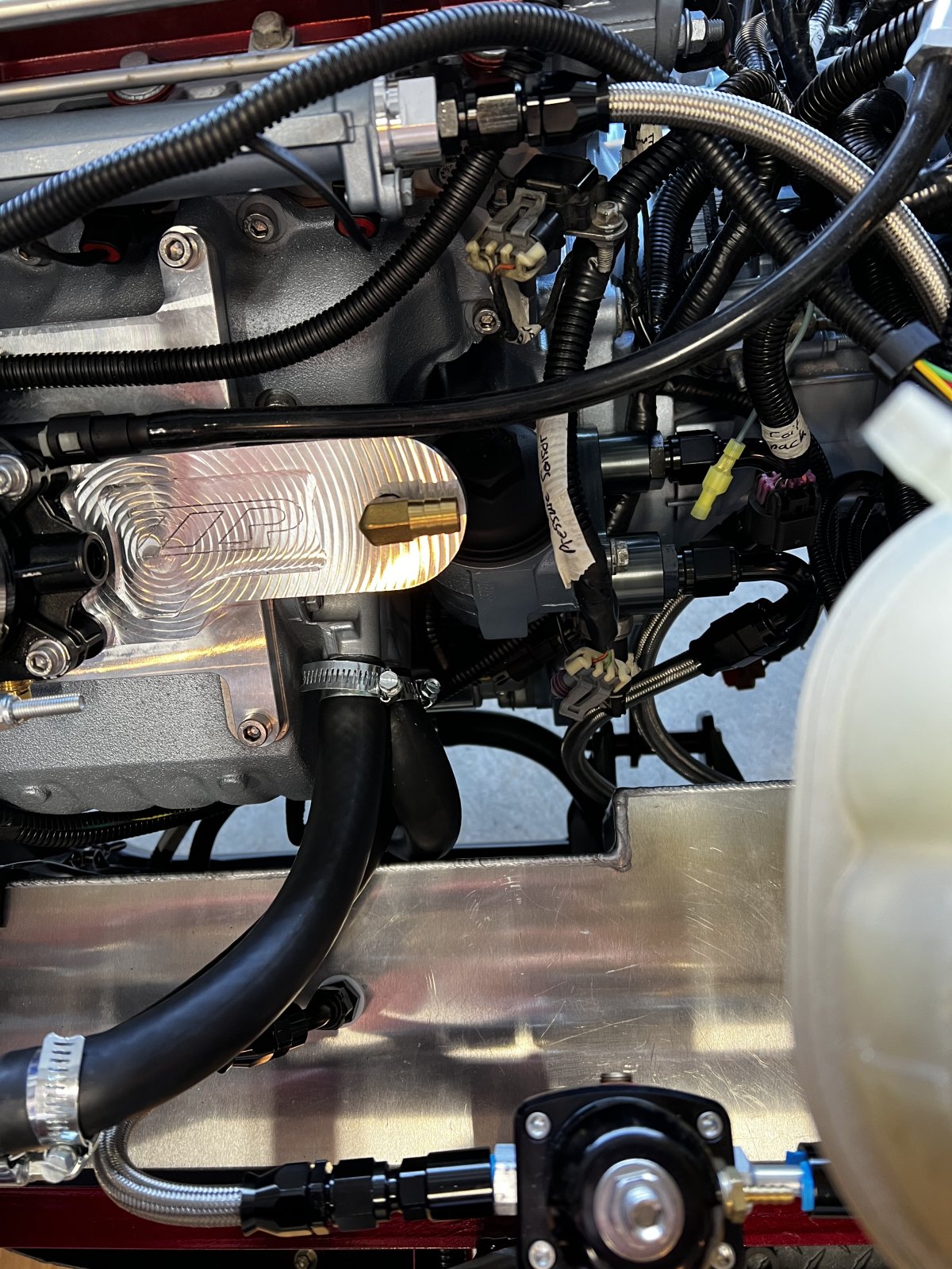

Hey @Sluggonaut, finally got my stuff plumbed up. Here’s the vent tube from the valve cover. It goes straight to the turbo housing according to zzp’s install instructions for the z54 and z57 turbo. I’d assume your ko4 is similar. If not, then put a catch can on that port (oil line from valve cover to catch can, filter on outlet port of catch can).
I forgone the option B tank as there wasn’t much room for it with the swooping corners I had to do with the straight hose I had to avoid kinks. It put the lines higher than I wanted to mount the option B tank. So I reused the Factory fill neck and it’s the highest point in the system.

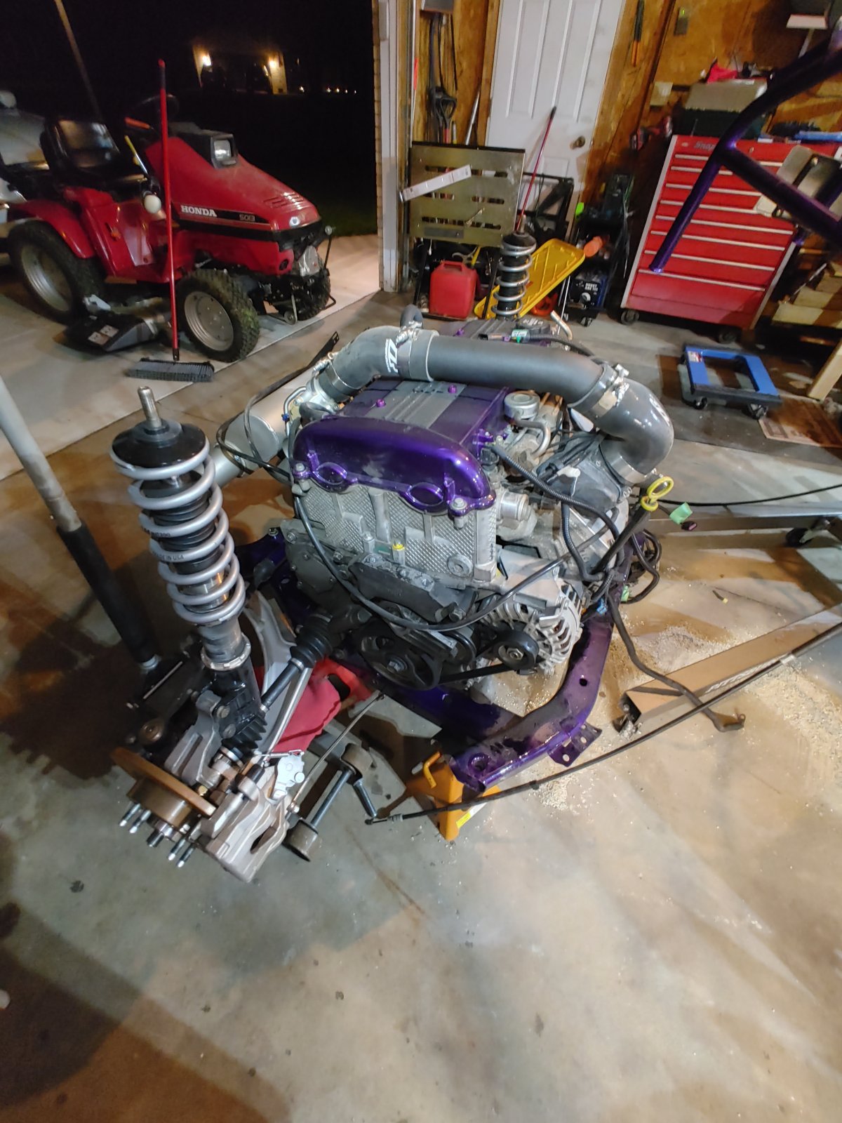

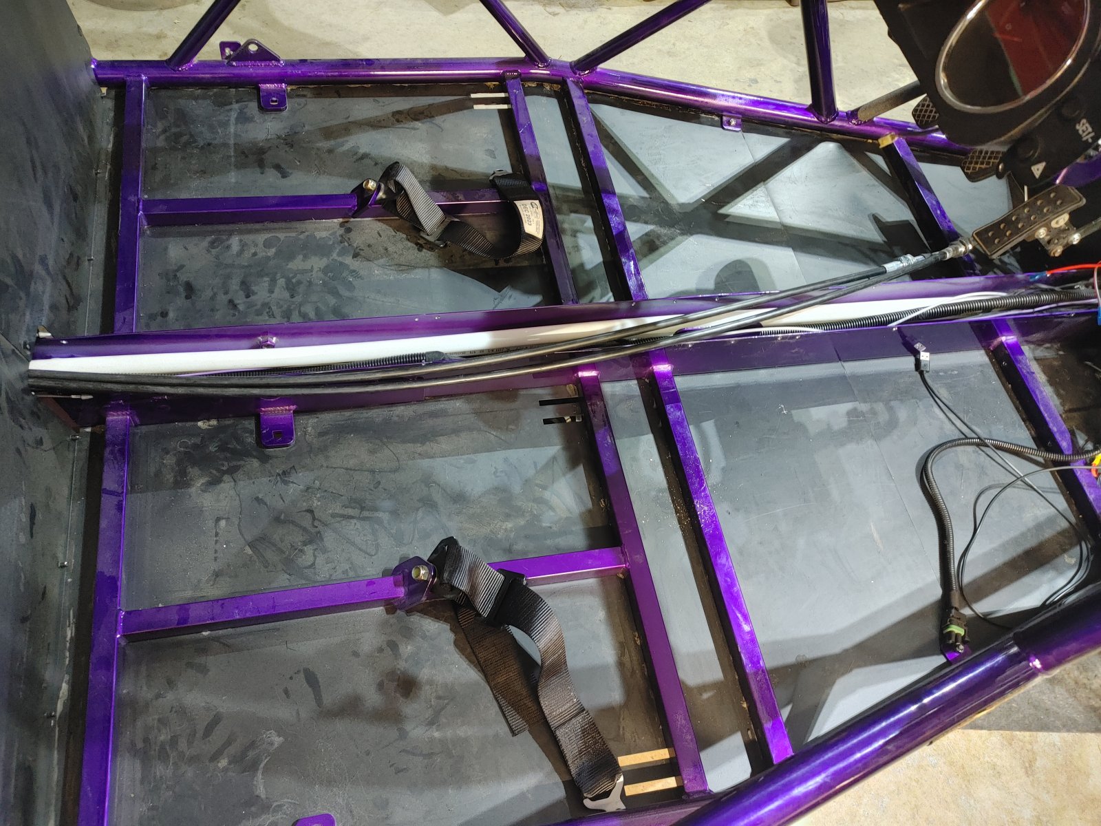

Started back into the off-season work by disconnecting everything between the subframe assembly and the chassis. I plan to drop the whole backend in one piece to preserve my alignment and minimize work a little.
However, I soon realized I was going to have to pull the seats and the tunnel cover in order to get to the IC hoses to disconnect them, as there is no easy way to do it from above or below with the subframe still attached to the trans. This should also make maneuvering the wire harness a little easier. I just hope I don't need to drill out the firewall rivets too.
After getting the seats out I'm wondering if dropping the subframe by itself and redoing the alignment would have been easier. I forgot what a pain the seats and harnesses were.
On the bright side, I get to clean up the mess a single season made under, around, and behind the seats. I picked up a lot of this towing the Goblin through all of the harvest dust on my way down to Goblinfest last year:
39364

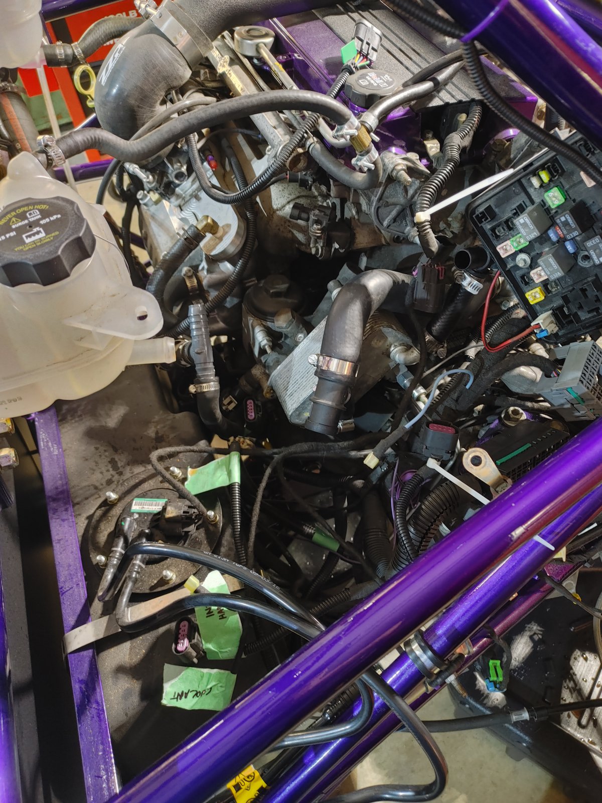

I also made sure to label everything again while disconnecting - I'm sure I missed something though:
39365

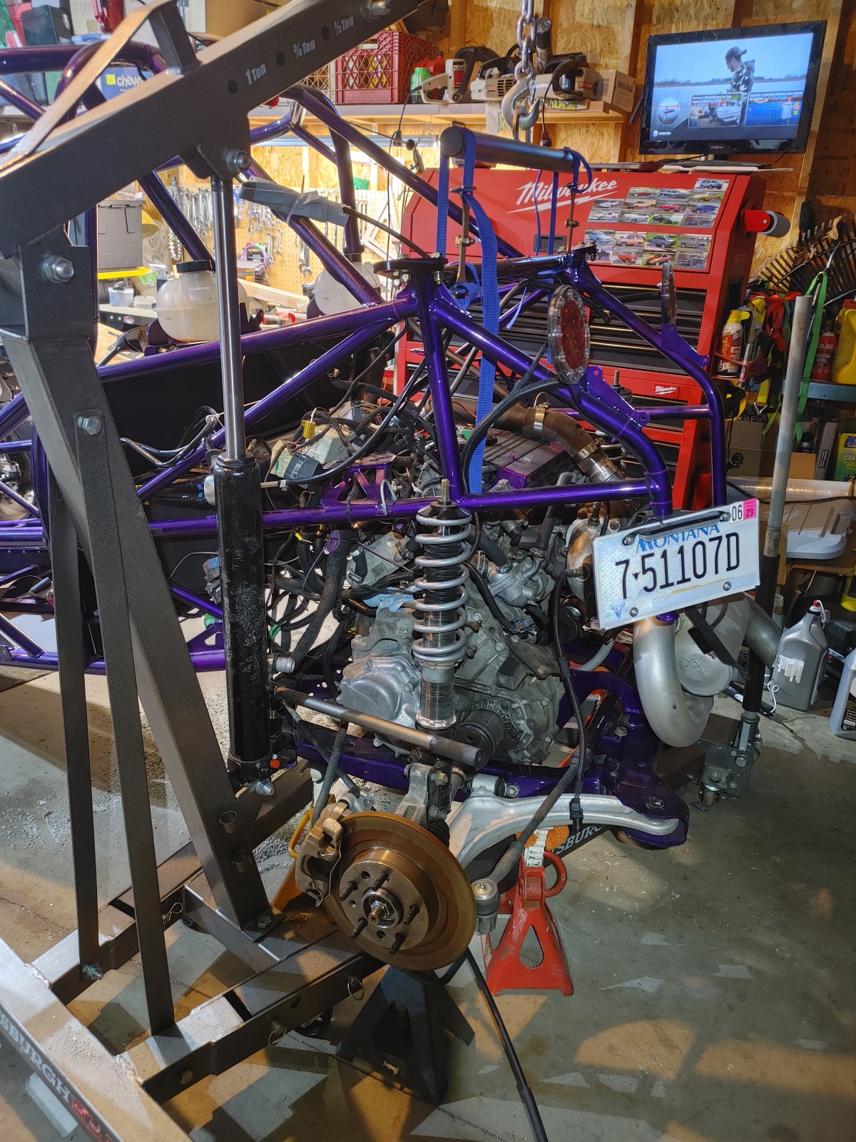

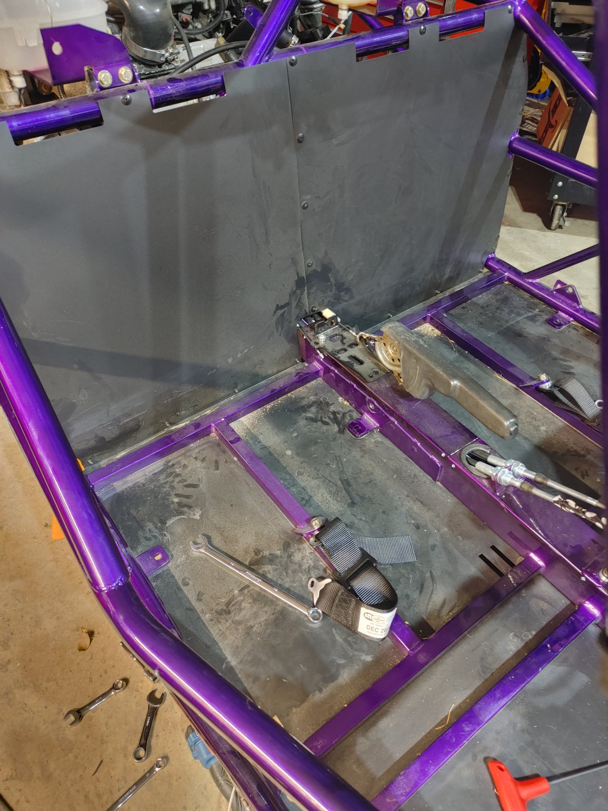

It's been a while since I have been able to address my "winter" projects. I was able to get the subframe assembly separated from the chassis tonight.
I'll definitely need a second hand when I go to mate these halves back together again to make sure wires and hoses go back where they're supposed to go.
I'll be getting started on several projects this weekend and hope to finish in a couple of weeks.
40527
40528
As dirty as the interior was behind and under the seats, the subframe is worse. It will be nice to be driving a clean car again in a few weeks.

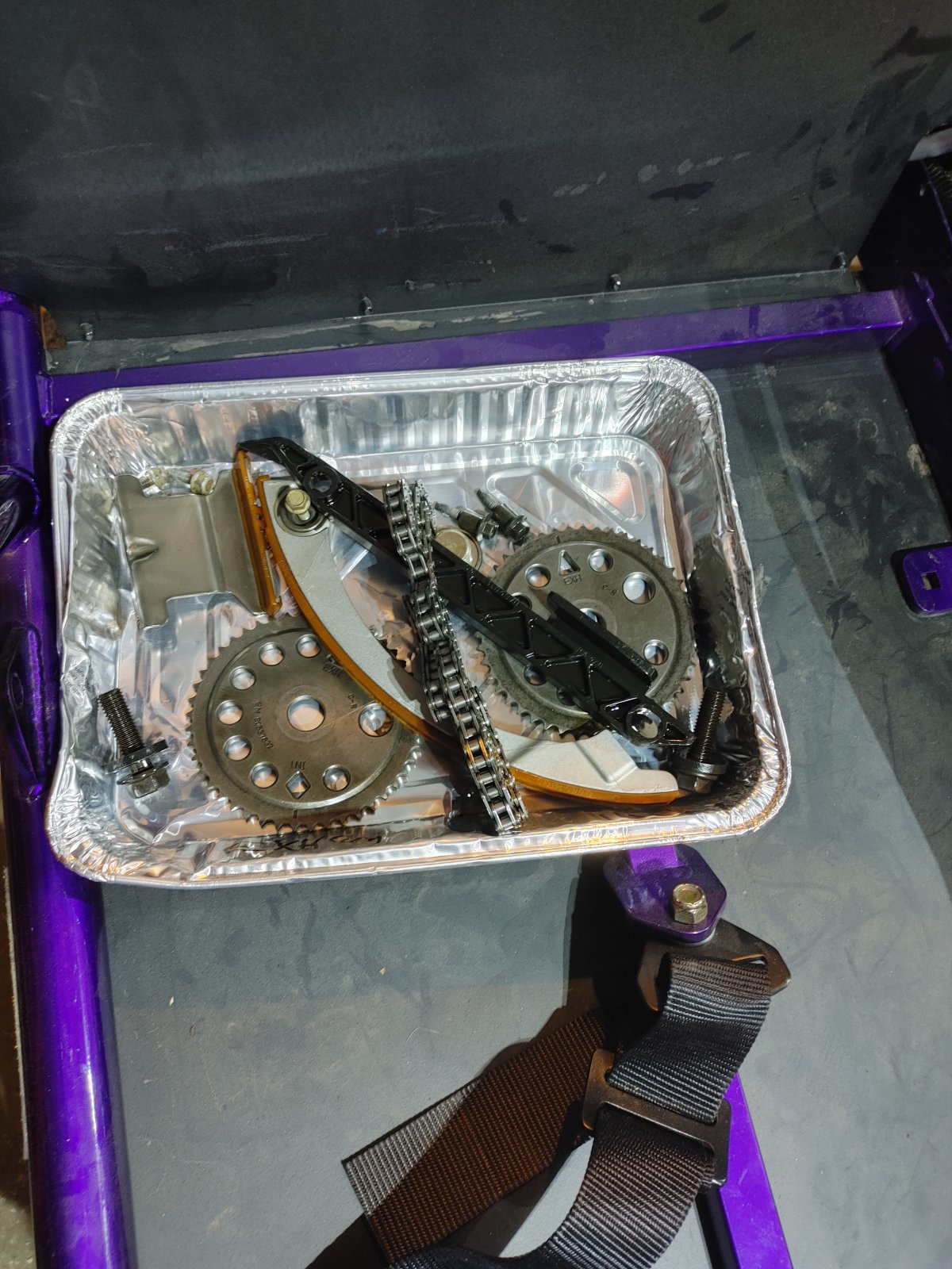

I pushed to get the timing chain set replaced tonight but ran into a roadblock pretty quickly with the crank sprocket. I couldn't get it off and can't find my jaw-type puller to get it off. I knew things were too good to be true when I found my pulley puller too quickly earlier in the evening to get the pulley off. All of the timing gear appears to be intact and in decent shape, so no plastic or guide bolt parts are bouncing around anywhere.

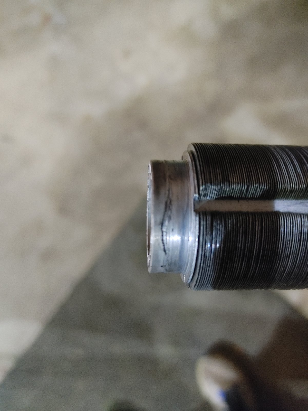

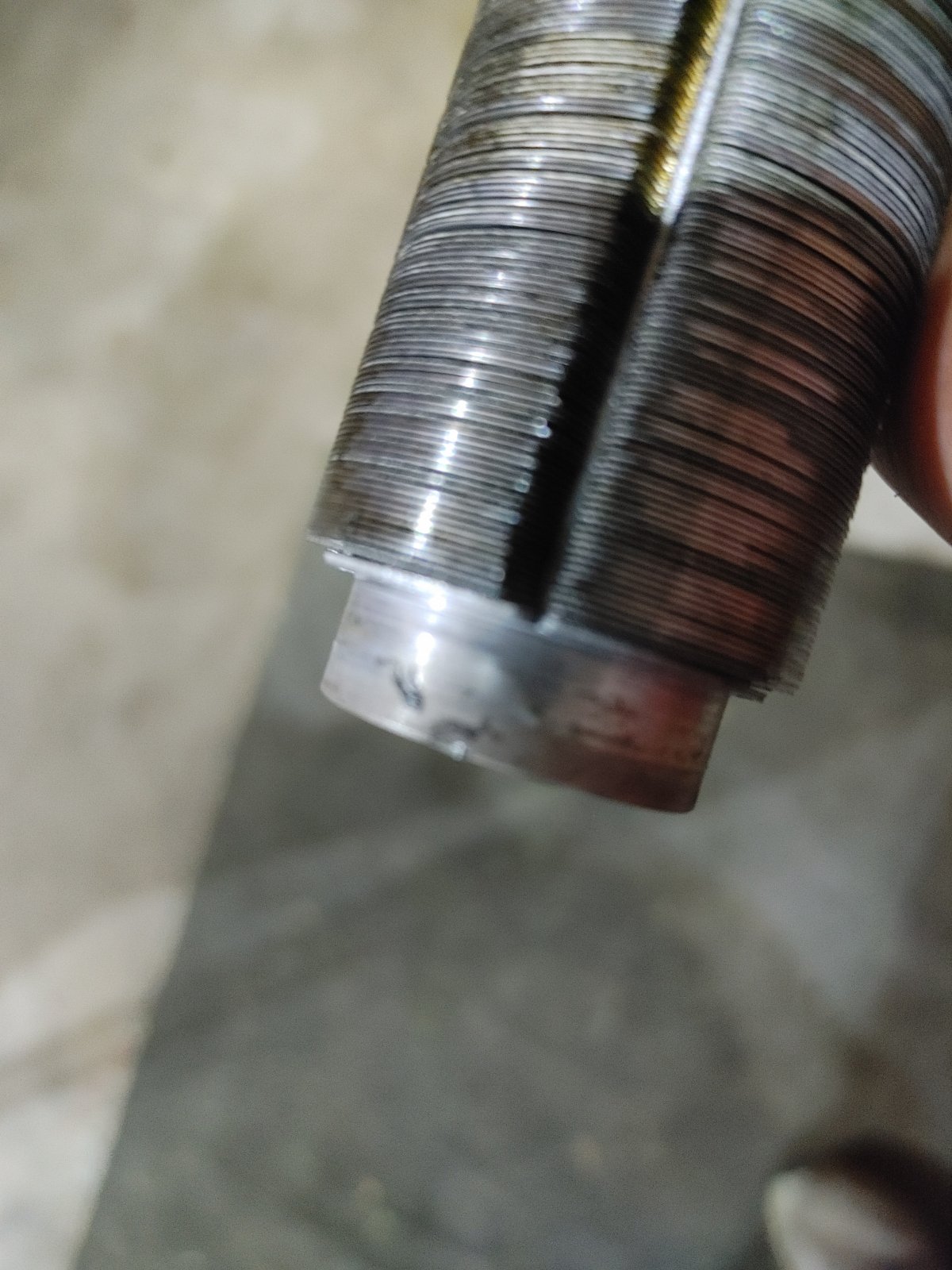

I moved on to cleaning up the intake manifold and laminova cores. I found all the cores to be in perfect shape except for one - looks like someone used pliers on it previously. Is there any way to fix or fill gouges like this?

I was expecting them to be much dirtier. I still used a toothbrush to try and get some dirt off but the brake clean was still clear in my pan after spraying and brushing these. I just have some concerns over the one end on one core that is boogered up.
Once I can find my jaw pullers and get the crank sprocket off, I hope to be able to finish the timing chain and water pump replacement fairly quickly.
Good and bad - good the scrapes are not all the way across the sealing surface, bad they will reduce the sealing surface. Light filing to remove any raised burrs on the surface is probably the best you can do without resorting to more drastic measures. Do you know if they leaked at all before disassembly? Maybe a little extra silicone on the seals to fill the scratches?
Sluggonaut
I suspected a slight leak due to some minor HE circuit coolant consumption over the course of the season. I've seen some people use dielectric grease to lube the o-rings during installation - would a healthier dose of grease on the o-ring on that end help at all?
