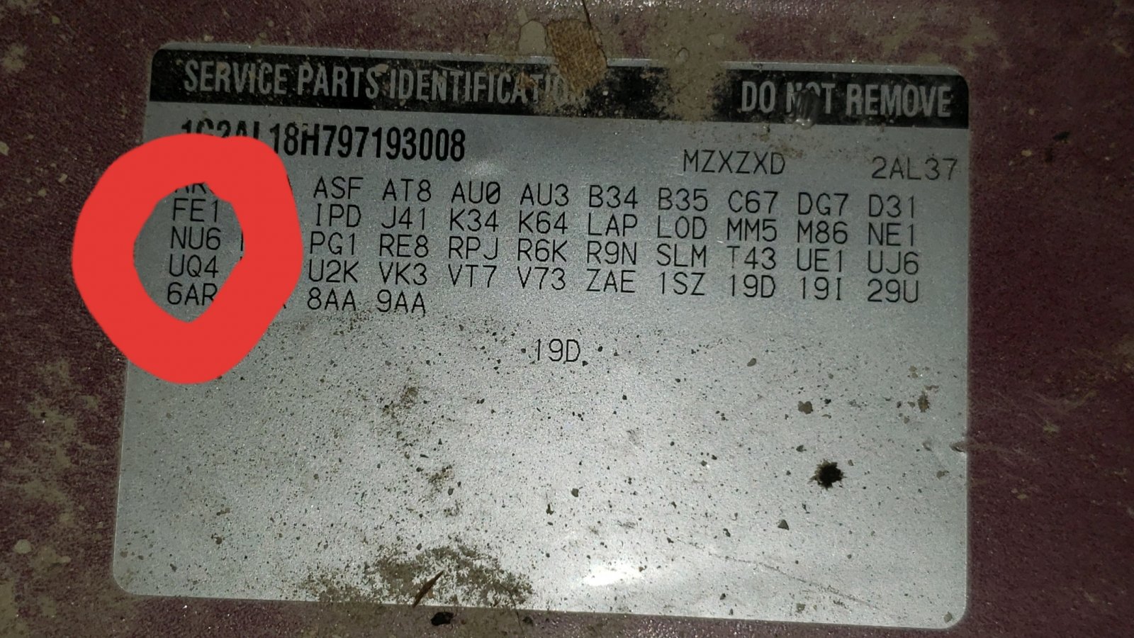

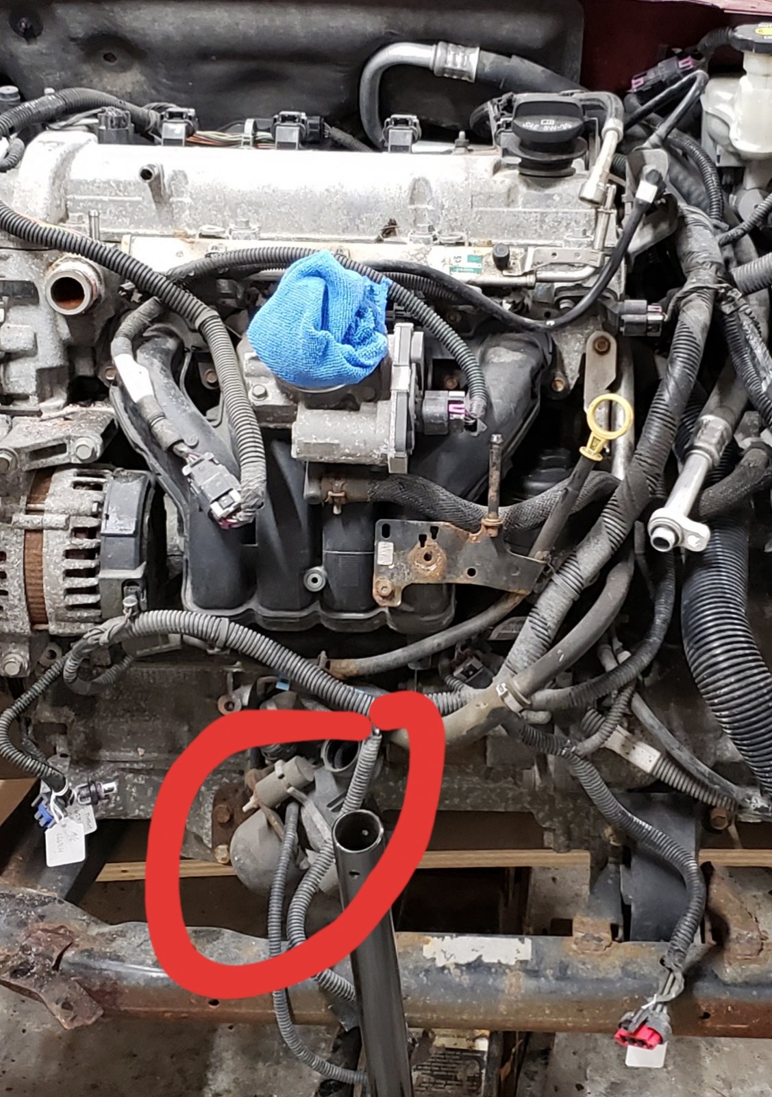

Not coming up with much while searching. It would appear that the smog/air pump indicates my G5 is a California car. Is that correct?
That is used in places where the states have tighter emission standards not just California. My PA car had it. It is called Secondary Air Injection (SAI). Yes you can remove it. It will however determine what header you will use See this post . Your car has the NU6 code that is a PZEV does it have the XFE logo on the decklid? If so JSATX and I have used the same donors. If it has the XFE it will have the FY1 code for a 3.63 axle ratio Vs. the 3.82.

Yes, it's also an FY1car. There isn't an XFE sticker on the lid though. Explains why it got such great gas mileage on my trip back from Detroit.
I'm from central Wisconsin, so no emissions here.
Thanks for all info. I'll grab a pump and harness from Rock Auto. Going to have to look into the exhaust manifold/header situation. Thanks for the note on not pulling the tank. I would have done that today.
