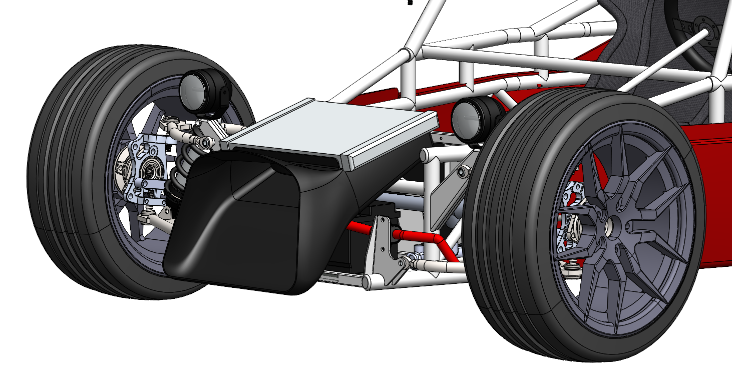

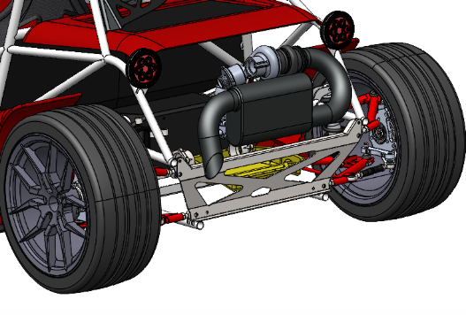

Is the subframe tubular? Or you need to take off donor ?
*whats the difference with v2 & v1 rear suspension.? And what difference does it make?
It was already mentioned that the v2 suspension was Lotus Elise inspired. The difference that makes in the rear is better suspension geometry (more camber gain in bump, no pro-squat during accel, no pro-lift while braking etc).
You can see the tubular subframe and rear control arms in this previously posted pic
