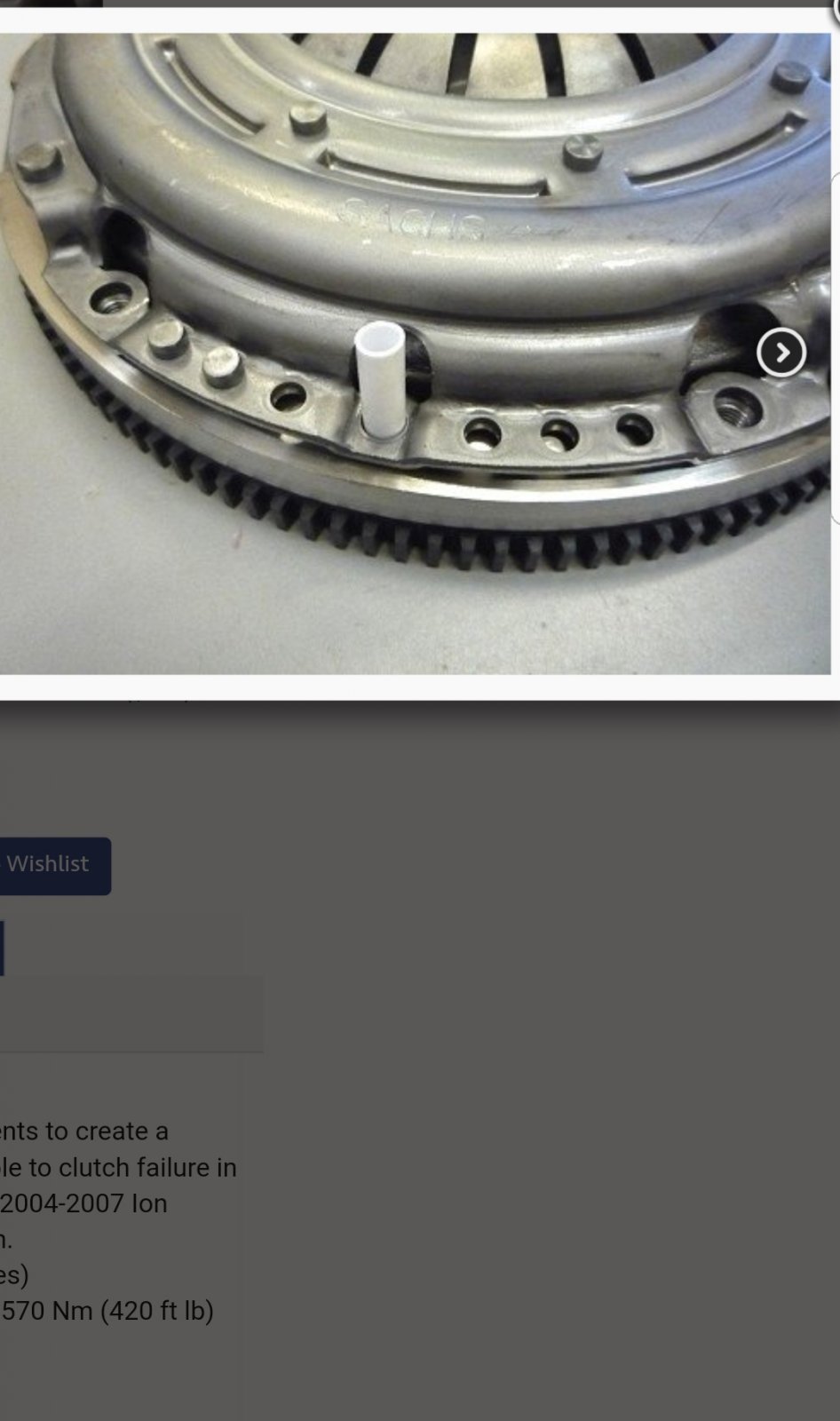

Getting ready to swap my clutch out for the GM upgrade kit. I have the kit, new flywheel and bolts, new clutch pipe/elbow to install as well.
Any tips for the project?

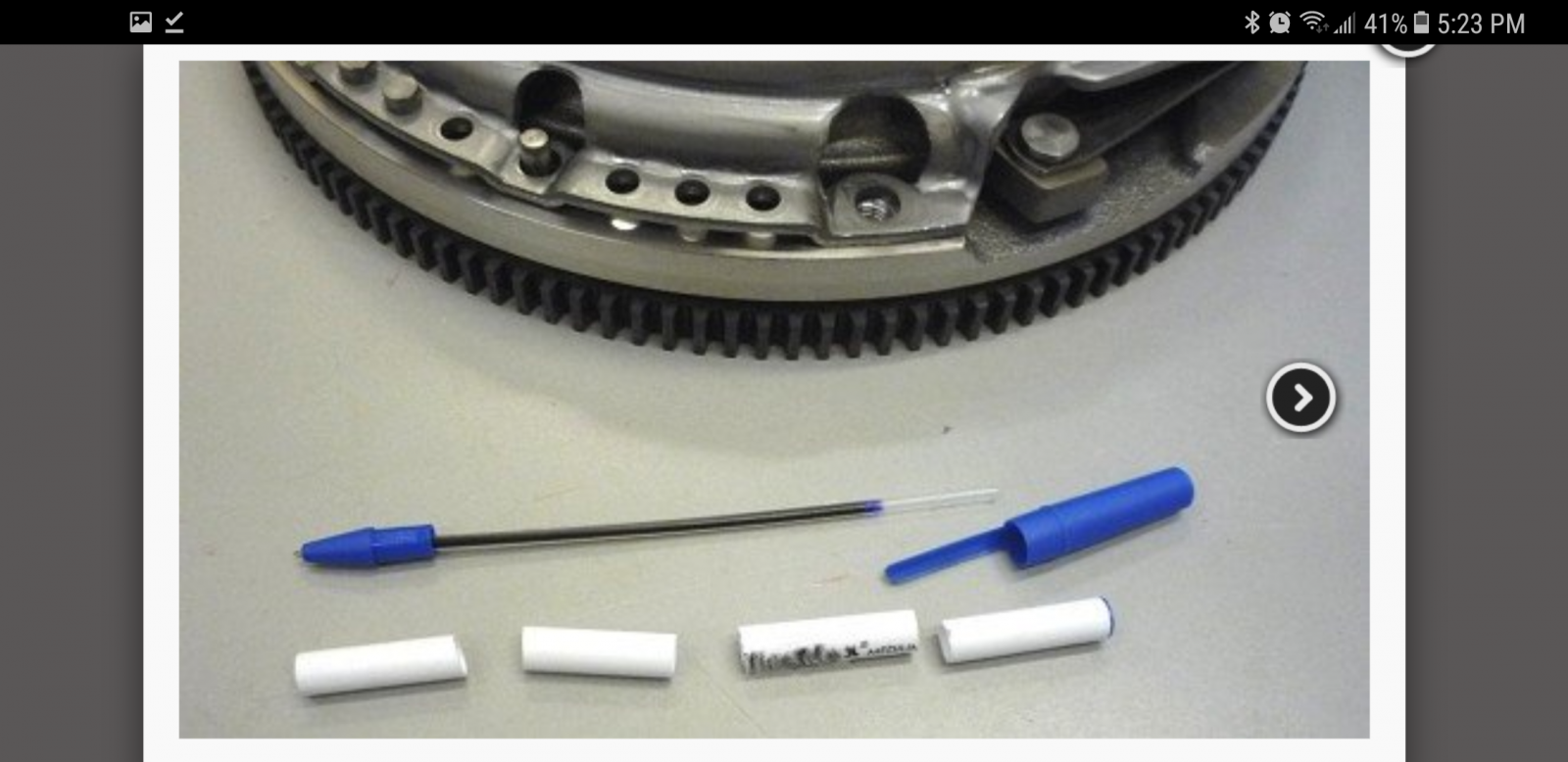

Not sure if it applies to the S/C but I was reading that when you use it on the LNF you have to use a bic pin case and make little spacers so it can be Aligned correctly
TheNuker
I did not need those spacers but you will want the clutch alignment tool. It was pretty straight forward, I'd replace the TOB and pipe while in there. The upgraded tob feels good.

Did you have any play on your pressure plate and the guide pins because that's what the pen is for because lots of people where saying that if it's not dead center it creates a little vibration that way they came up with that I'm just passing the info I hate to see you guys have to pull everything out again because of the vibrations

I dident use the pen maybe I just got lucky! You do have a clutch alignment tool right?
Hope your replacing the TOB also the upgraded LSJ aka LNF is a big upgrade.
