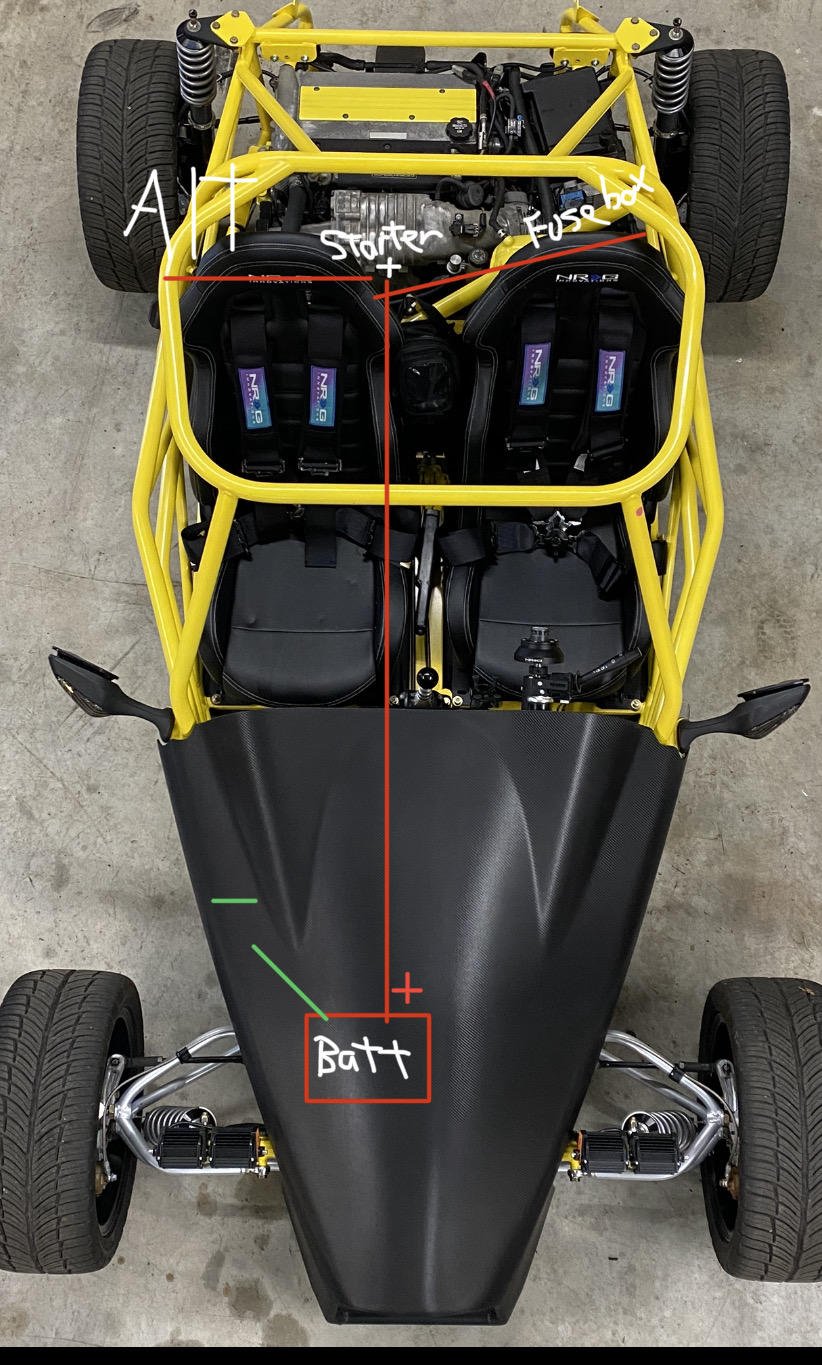

Putting the electrical back together after the trans swap and had a weird electrical issue. When I was hooking up the negative cable to the battery it tried to fire the starter which tried to turn the engine over.
The vehicle did not have the fusebox installed, did not have to large 50-amp under hood fuse or B+ cable attached to the fuse box.
The negative batter cable only goes from the battery to the ground post on the side of the battery box.
I think I might have a negative battery hooked up to the +side of the starter. Is this even possible?

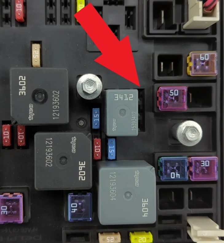

I then had an issue for a P0230 fuel pump main relay. I apparently put the relay in the wrong 4 of 6 slots it could go in.
I don't know why GM made it in such a way that you can install a relay incorrectly. I have to try and see the outline of the relay to know which set of slots to use.
I don't think it's possible to install them incorrectly. The 4 pin relays at least work across the diagonals so they work in either direction. I think he was saying he installed it in the relay spot.
Sorry. It might be possible mine has that, but I've never noticed it. And I've had all of the relays and fuses pulled out before to dissasmble it.
Looks like panel is probably shared with another application or GM made a switch after initial design or during production.
