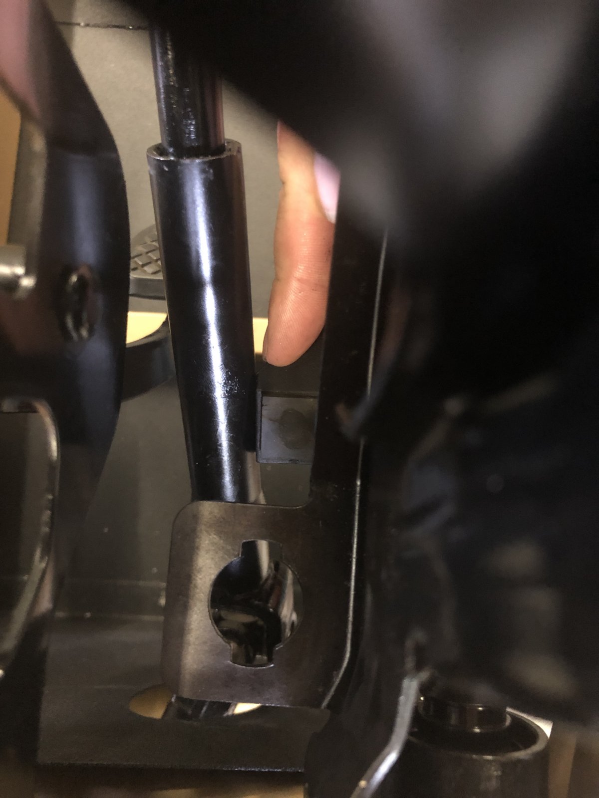

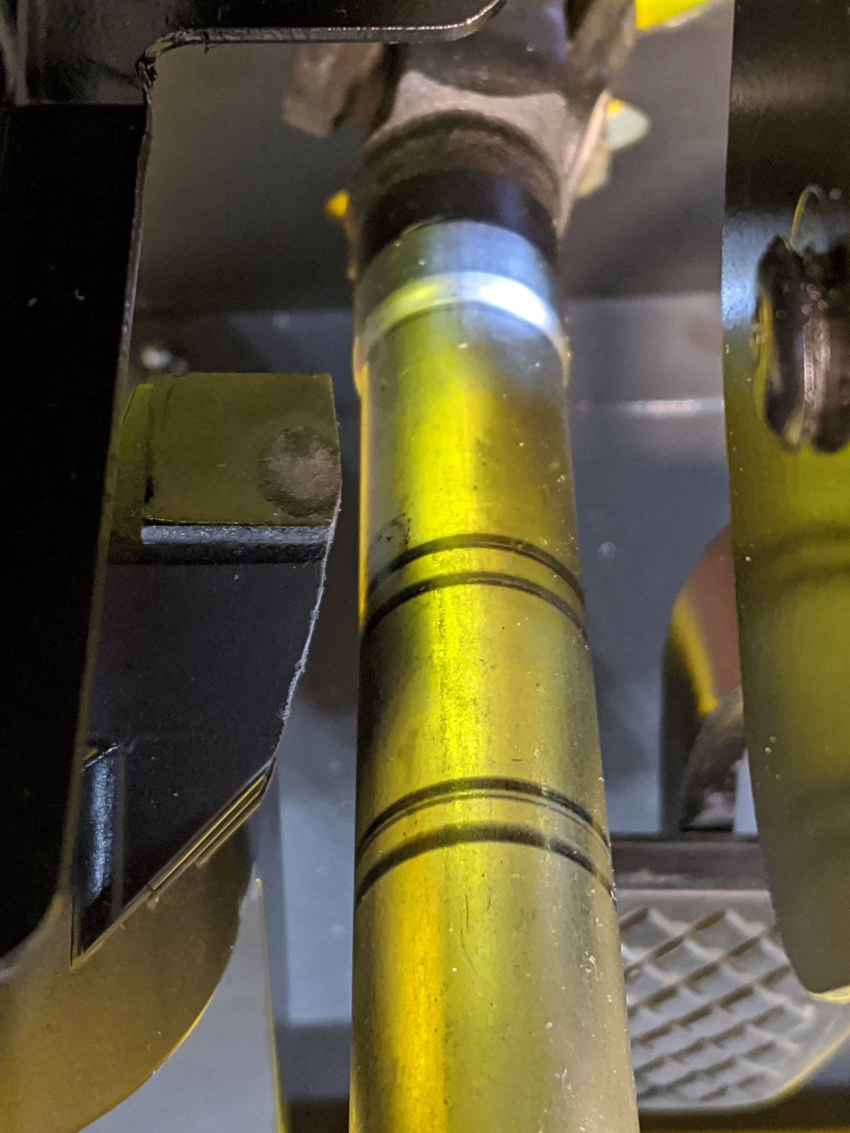

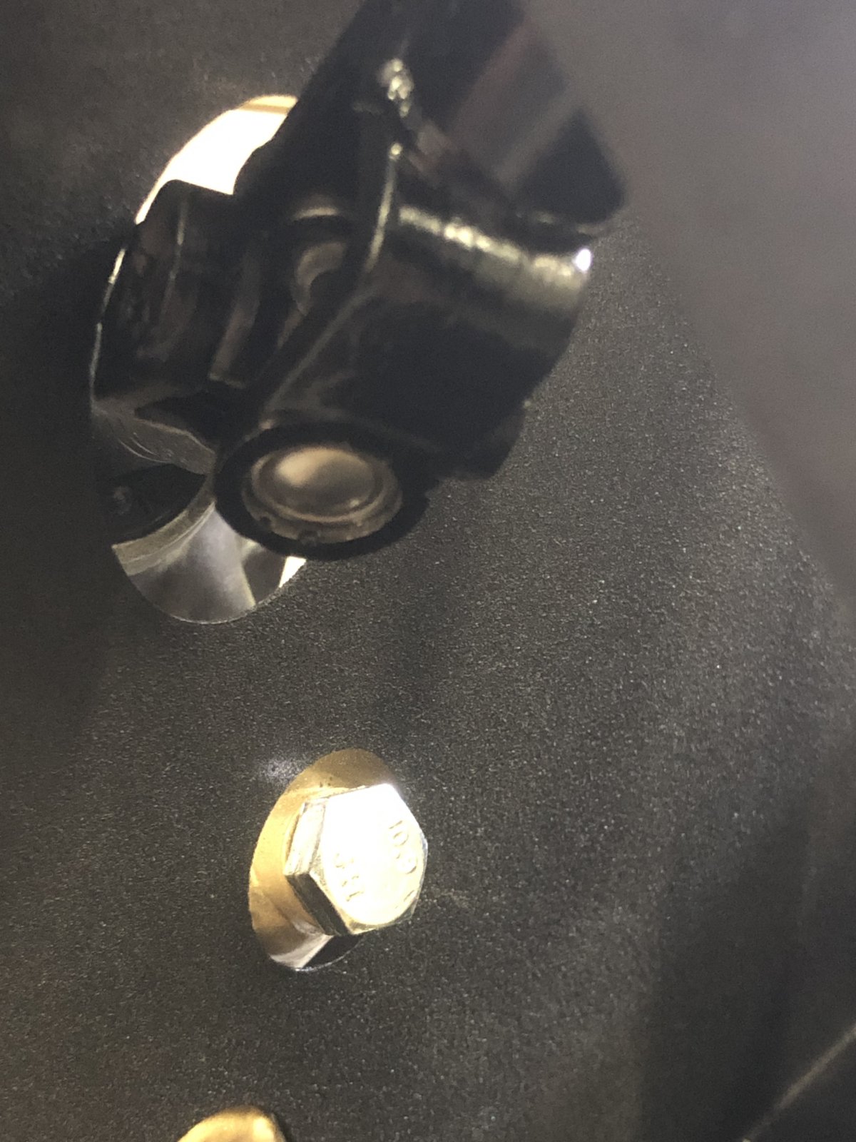

So skid the mid link assembly onto the rack and pinion and the steering shaft and aligned the knuckles with the bolt slots and rotated it around. First thing. The steering shaft rest up against the clutch pedal. And second my bottom knuckle hits the front bulkhead. Any ideas?

Regarding #2: A lot of people, including myself, have had to trim more off the bulkhead to avoid the steering shaft knuckle hitting it.

I just discovered I have the same two issues last night. Must be an '06 SS thing. Unless we both did something wrong, ha.
Found this from DF in an older post:
With the pedal assembly bolted up you need to push away on the top an pull on the bottom to position the pedal far enough away from the steering shaft that it does not hit the ujoint when fully depressed.
You will also need to remove some of the brake switch pad to clear the steering shaft.
For what it's worth, I just double-checked my 08 SS/TC clutch pedal, and while it's pretty close, it does clear. So it must be an 05-07 thing.
H
so mine doesn’t hit the knuckle it the switch pad. So it looks like the old sawsall will get some action

I had to grind on mine with a Dremel also... 2009 SS.
FYI... Its tight in there. When my foot is too high on the clutch pedal, I can feel the u-joints on the steering shaft.
You can easily gain a little clearance by pushing the top of the pedal assembly away from you while pulling the bottom away from the steering shaft. You will still need to clearance a little though. Clearance a little at a time and keep rechecking so you don't loose you switch pad.
