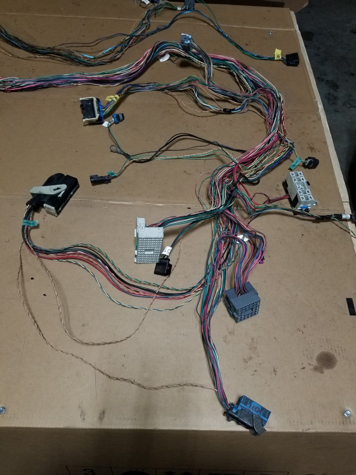

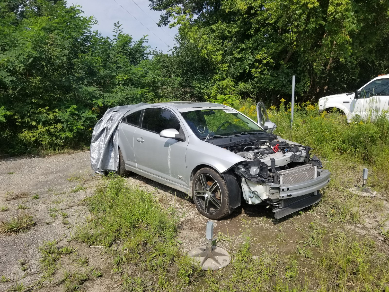

i have a 2006 Cobalt SS Supercharged model. I HAVE ABS. I do NOT have OnStar. What do i do with the data wires and any other supercharged specific wiring that i need to complete.

You will not be using the ABS in the build. So the data wires will simply bypass the ABS and the OnStar.
I posted this in your other thread (I didn't see your question here). Let us know if this doesn't make sense.

Makes sense. thanks for the schematic. I knew abs was out the window just had to understand those wires
