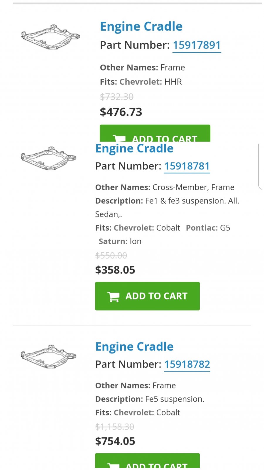

First off, I’m sorry for bringing up the HHR SS haha. The motor and trans in the hhr are both used in cobalts so theoretically they should line right up. The charged piping into the tc manifold is pretty tight so that extra inch may be a factor. The real issues are going to be wiring harnesses, fuse box, bcm. You can always modify a cobalt pedal box to allow hhr pedals to mount up that should be easy. In my own personal opinion if you take everything that is required to make the engine/trans run and drive from the HHR SS donor. modify the pedal box and harness accordingly to fit the goblin it should run like a stock hhr. Which sounds like that’s what you want. The subframes look really freaking similar as do the front spindles. Brakes come new from DF in the turbo kit so you’re good there. If you buy the coil overs from DF then you’re set with suspension.. honestly I’d sell the 2.4 donor and just pick and pull any small pieces you may need along the way. Its an auto so parking brake is optional unless your state requires it for reg. The speedo cluster will mount differently and the power steering on hhr SS looks different but is the same on the base hhrs I am sure some other small things will come up but I say go for it! I’d call around and check on the front spindles and subframe to know for sure whether it will mount to the goblin. ZZP 2.4 turbo would be sick!
Christopher Sanchez
I would use the auto SS hhr for my donor, not an LT cobalt.
