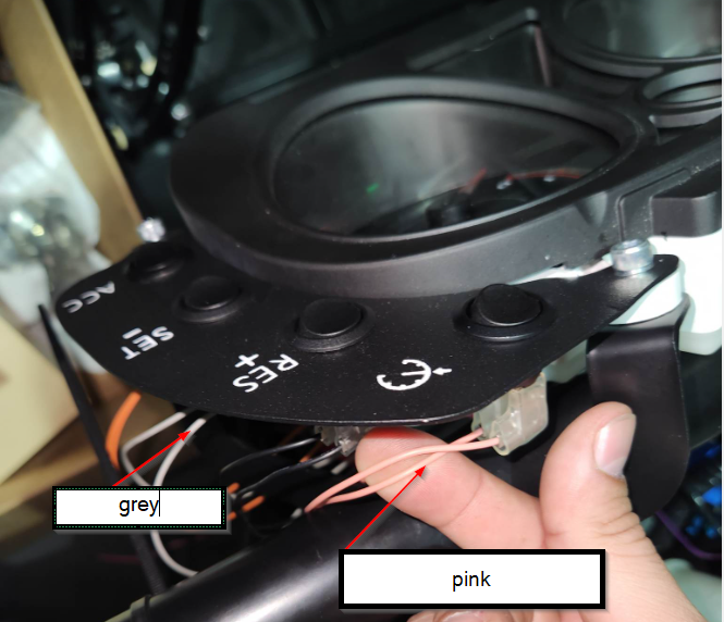

Has anyone had issued with the wires on their tachometer not adding up? I was in the process of installing but had a small hiccup on the "pink" and "grey" wires.
The paperwork given by DF indicates that:
* The pink set of wires is to go to the "Cruise ON/OFF"
* The grey set of wires goes to the "SET" button option. (I understand this is setting the cruise control at the desired speed)

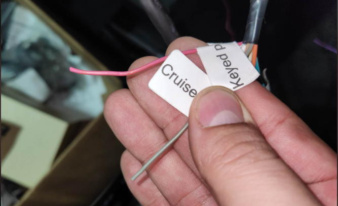

But my question is, where do I hook them up to, since the Pink wire (coming from the main wire harness) states it is for the "Keypad Power". And the Grey wire is for the "Cruise Control".
(I had my main wire harness assembled by DF Goblin, I didn't wire it myself). Help, pictures would be very helpful!

See the PDF Lonny linked here.
You should have the free ends listed in P1. Unless the DF Harness Service already made the connection.
I think the one on page 4 is the late model (without the Yellow at P1).
