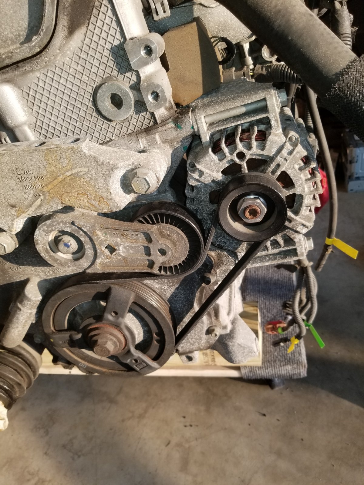

ZZP has the "345" is the stock replacement belt for LSJ(turbo) without Air Conditioning. Or if you were to remove your AC compressor.

I got a 34.5” belt of rock auto. It was too short for my 2008 TC. Ended up making two runs to Napa and came up with a 35 5/8” that worked.
The 345 from ZZP fits exactly as shown in the photo from Ark with the correct tension applied. As the belt gets 'broken in' it will stretch slightly and the gap between the tensioner and the opposite side will reduce slightly. Installing a longer belt may allow the belt to slip as it ages.
