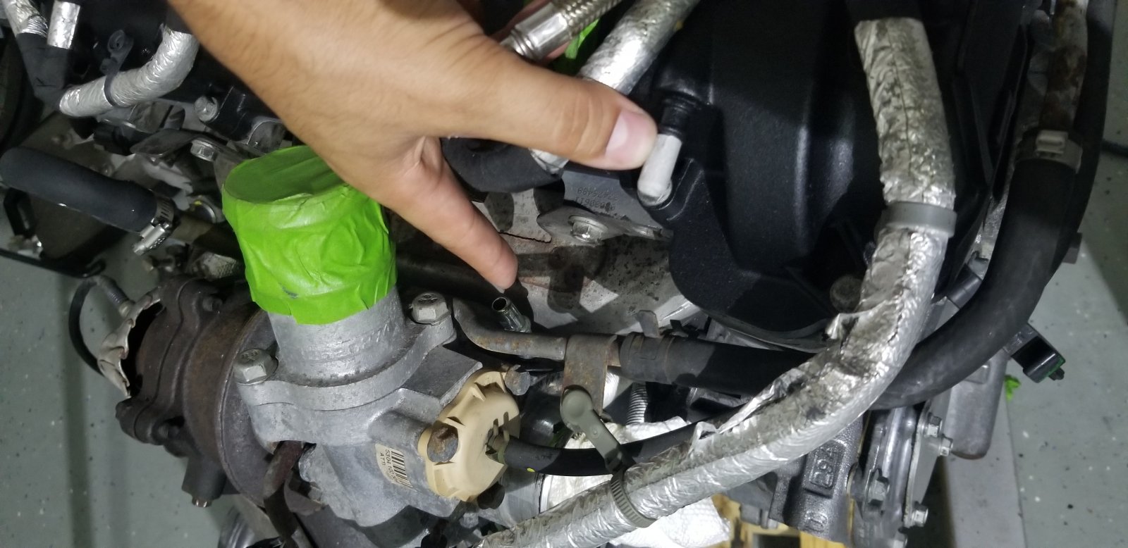

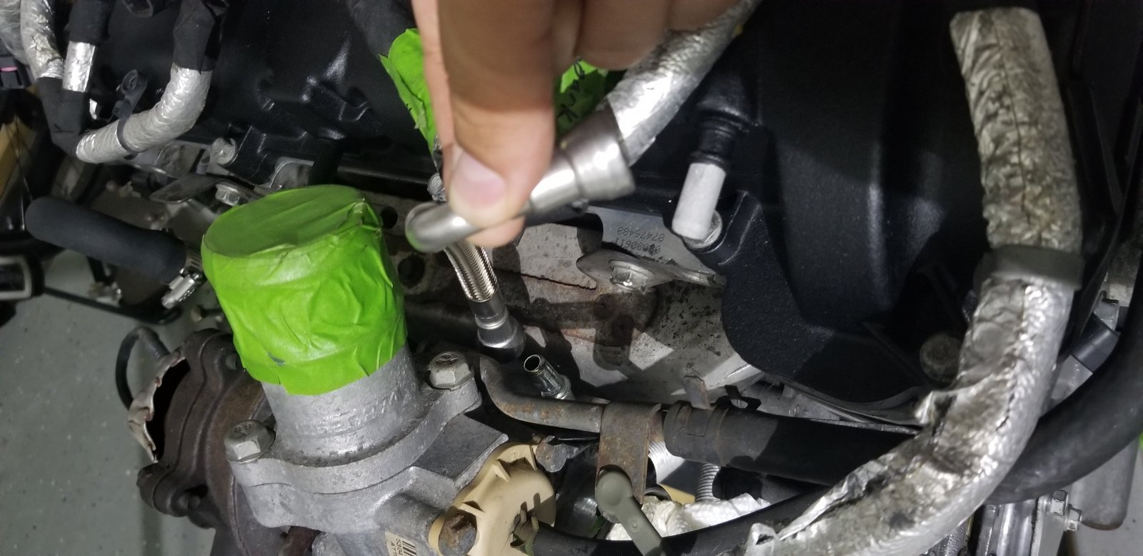

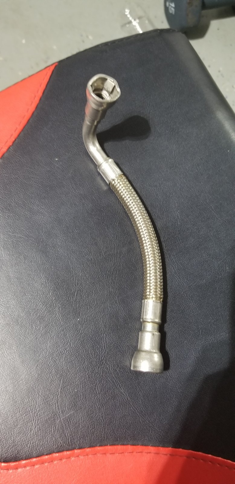

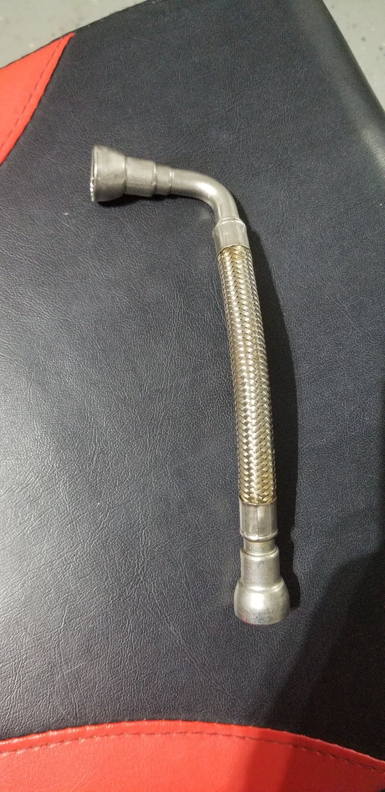

Hey, got a question for you all. I removed (barely) the fuel line that goes from the turbo to the valve cover so it (valve cover) could be powder coated. Upon doing so, I damaged the end of the fuel line that goes to the valve cover, and now I am at the point of replacing it. Unfortunately Oreiley could not find the part tonight. I was wondering if someone knows where I could find another one or has a part number for this. Pics coming soon! Any help would be greatly appreciated!
J
Here is a couple pics for context

That’s not a fuel line and isn’t considered removable by GM so only comes with the valve cover normally.
The link indicates that Powell Racing created a tool to be able to remove them so they could powder coat the valve covers. Maybe they can source you one.
J

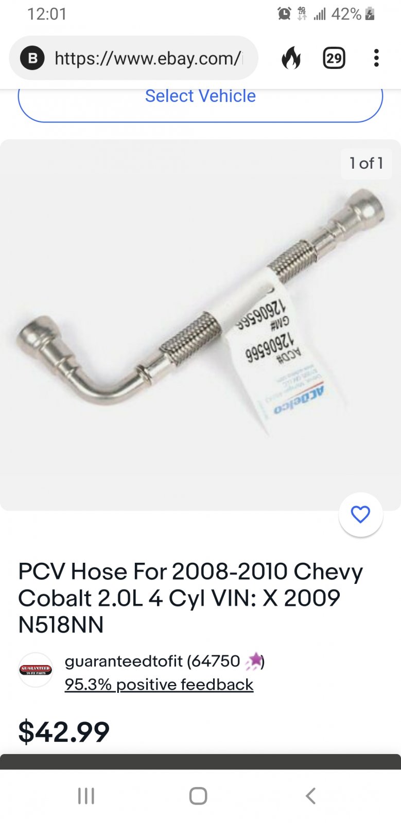

Ohh okay, thank you for the info, do you know what the line is called?
KSLunsfo
I haven't personally done this yet anyway, but apparently the internal clamps can be replaced:
Just depends how damaged the end of the line is I guess...
It is just a vacuum hose. Use rubber hose and hose clamps each end.
The temp from the turbo should not be a problem since we have open engine bay now.
You may want to read a little further in the link below to better understand what the vacuum system is doing on the turbo valve cover.
