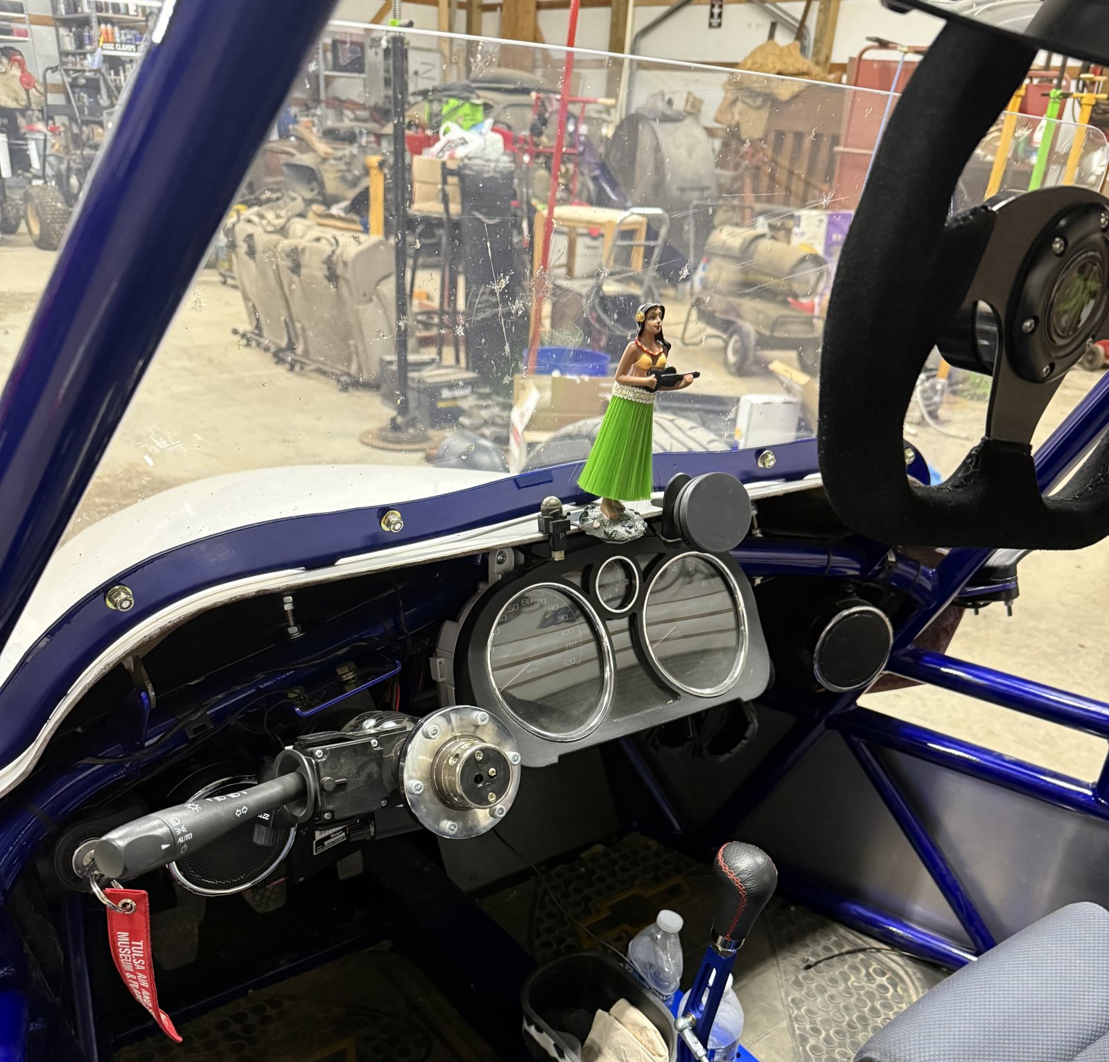

Did a few simple things for the wife while her and the kids went to spring break without me. I relocated the tag, moved the ambient light sensor and installed her hula girl :)

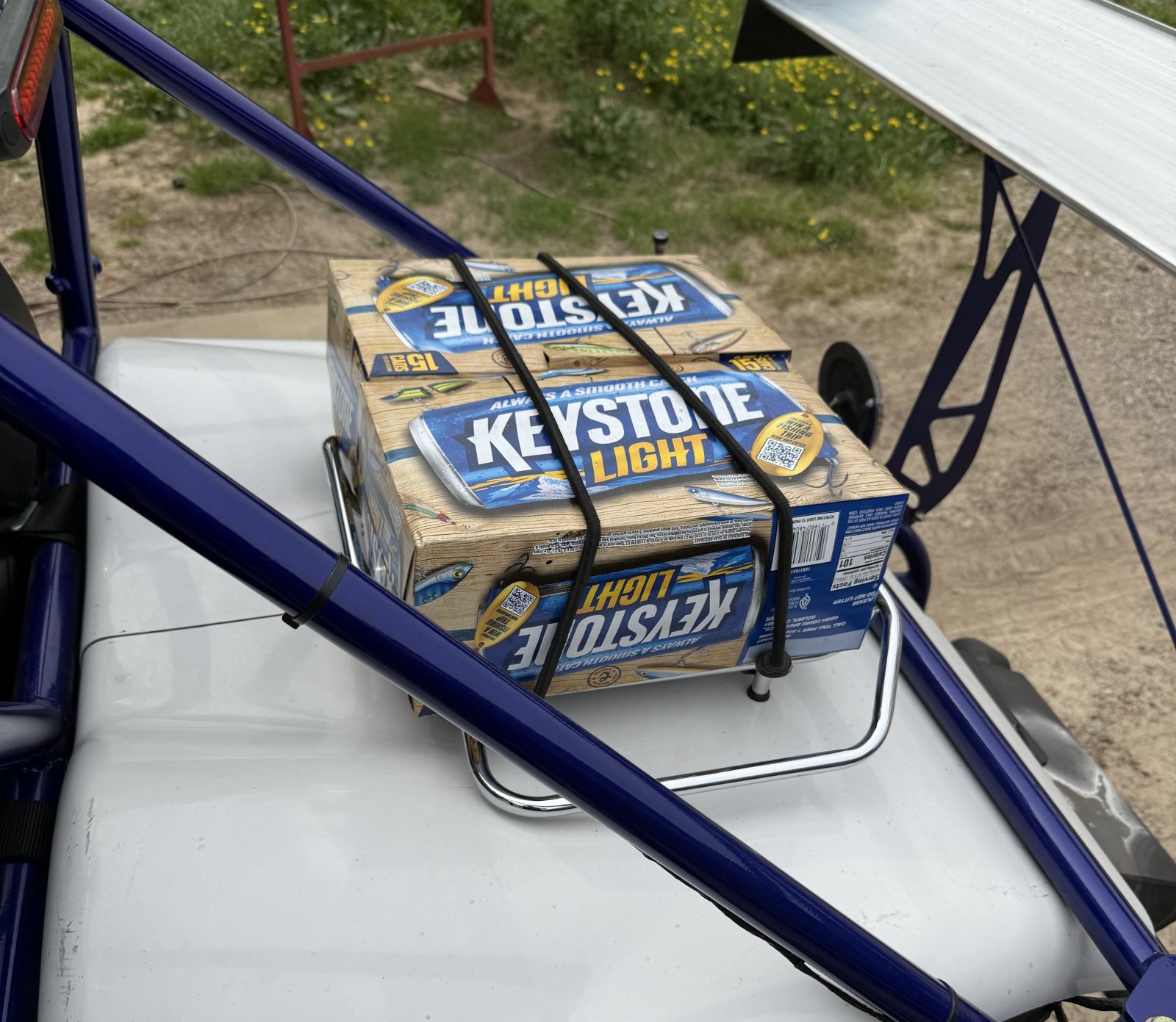

Oooh, luggage rack. Luxury in this car, as I only have a pocket in the back of the seat. :)
I like the hula girl too. Nice touch.

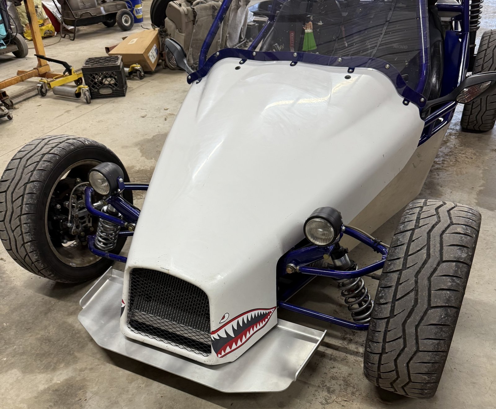

Emmett and I took the Goblin out today and put about 150 miles on it after I finally installed the critter splitter. The splitter doesn’t appear like it would work as well as it does. I’m really happy with how it handles and feels at road speeds. Next is the wrap after the wife decides what she wants. I was going to wait until after getting it wrapped to install the splitter but I really wanted to try it.

It’s amazing what a little piece of flat metal does on the front. I didn’t believe it either until I tried it. It really pushed down the front for what it is.
It does look like much but it makes a yuge difference. Noticeable at anything above 40-45 mph. I believe this is a must have item, unless a builder is doing a front wing (wang?).
be careful at GF25, Rttoys and I can attest that you’ll redecorate the gravel driveway with the front splitter….

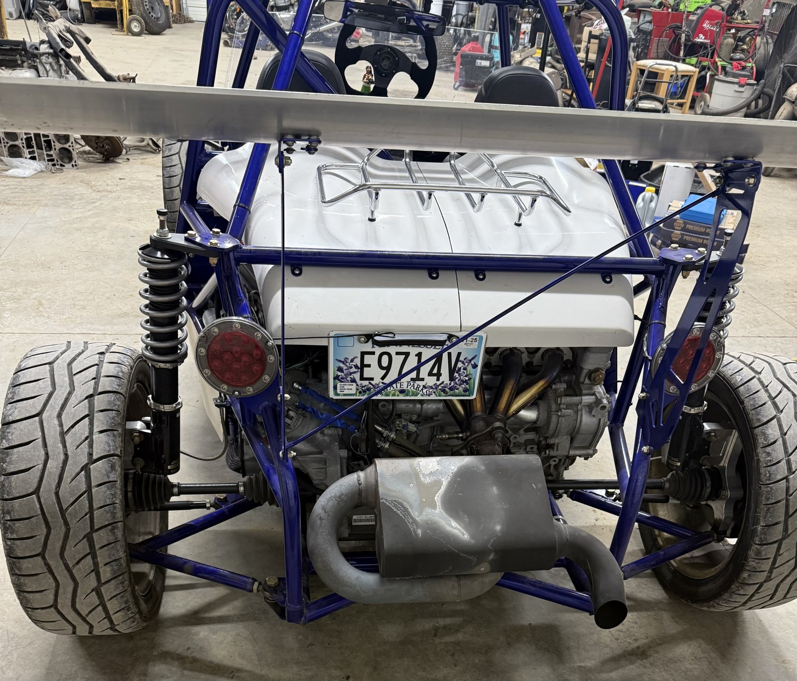

Emmett and I went to a cruise-in and got lunch while we were there and rode through where the tornado went through Grand Junction a few weeks ago and stopped at the gun shop on the way home. We stopped for ice cream and also hit up tractor supply for a tiller belt and almost forgot the most important part about the entire trip. Y’all can laugh about the wife’s luggage rack but it works great
51844
