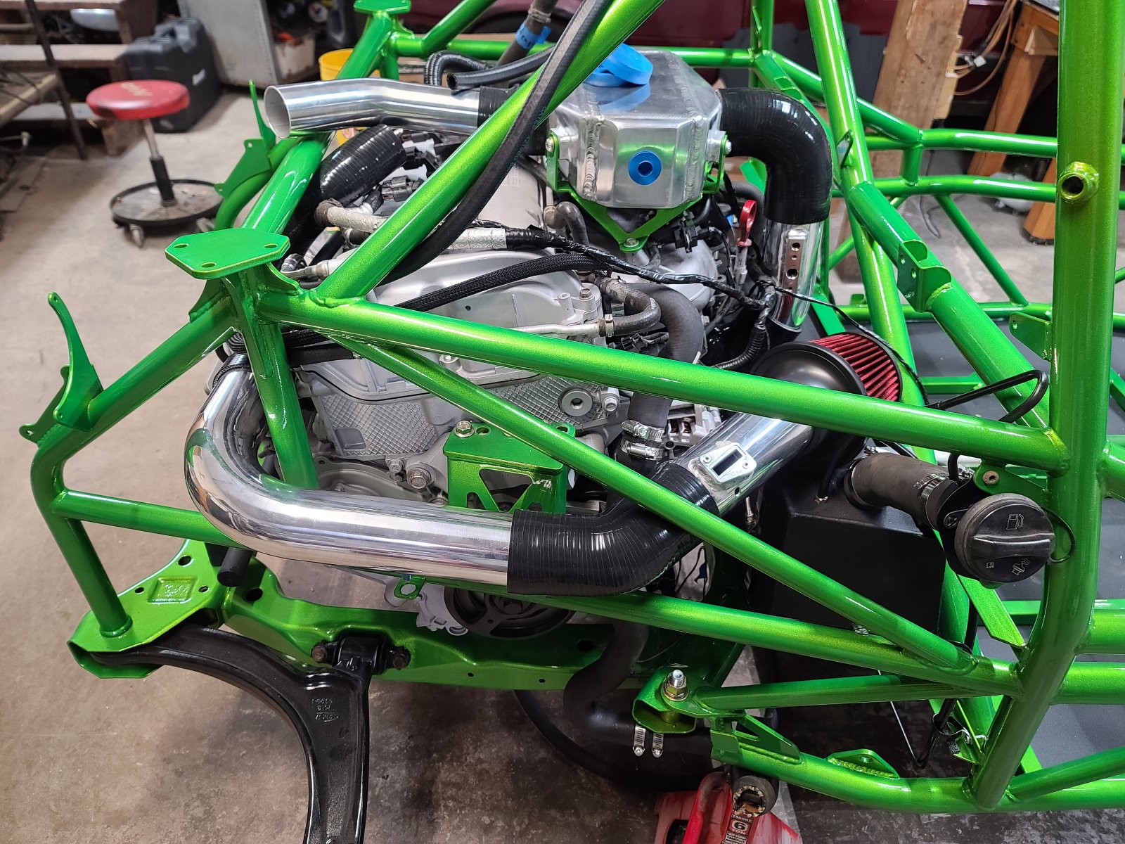

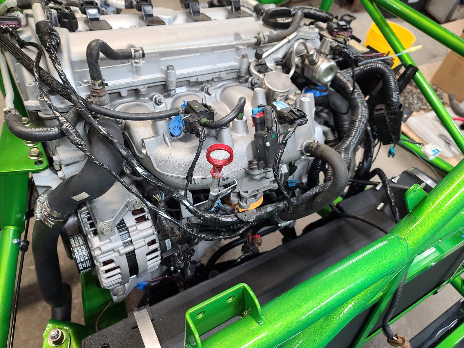

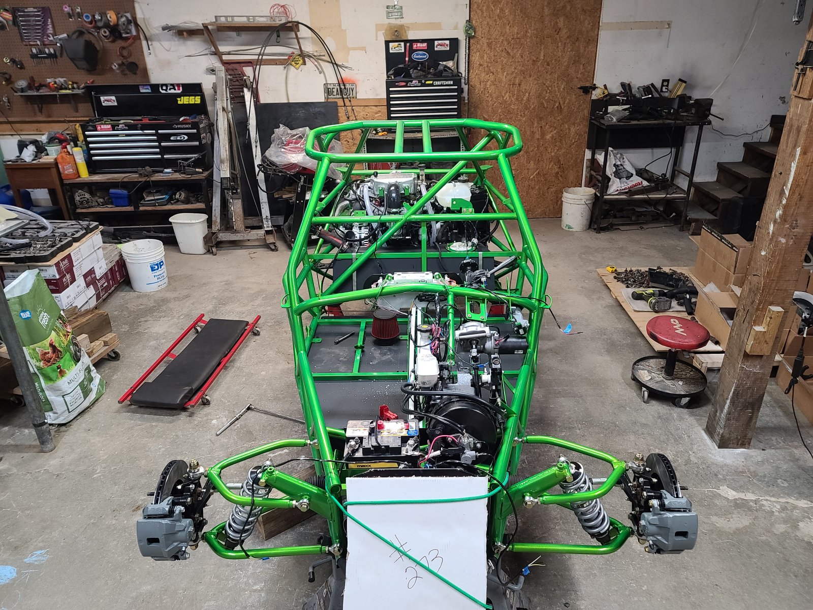

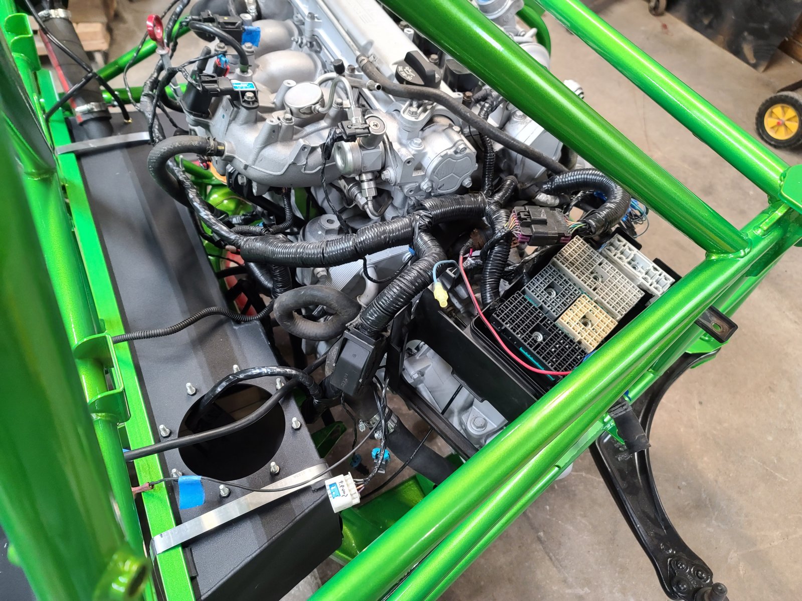

Rear sub frame and solid mounts all in and torqued down now for some wiring before I get to much stuff in the way.

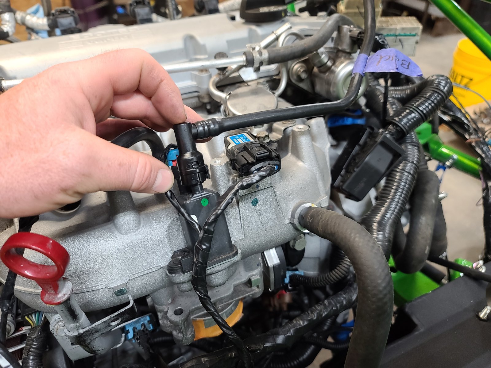

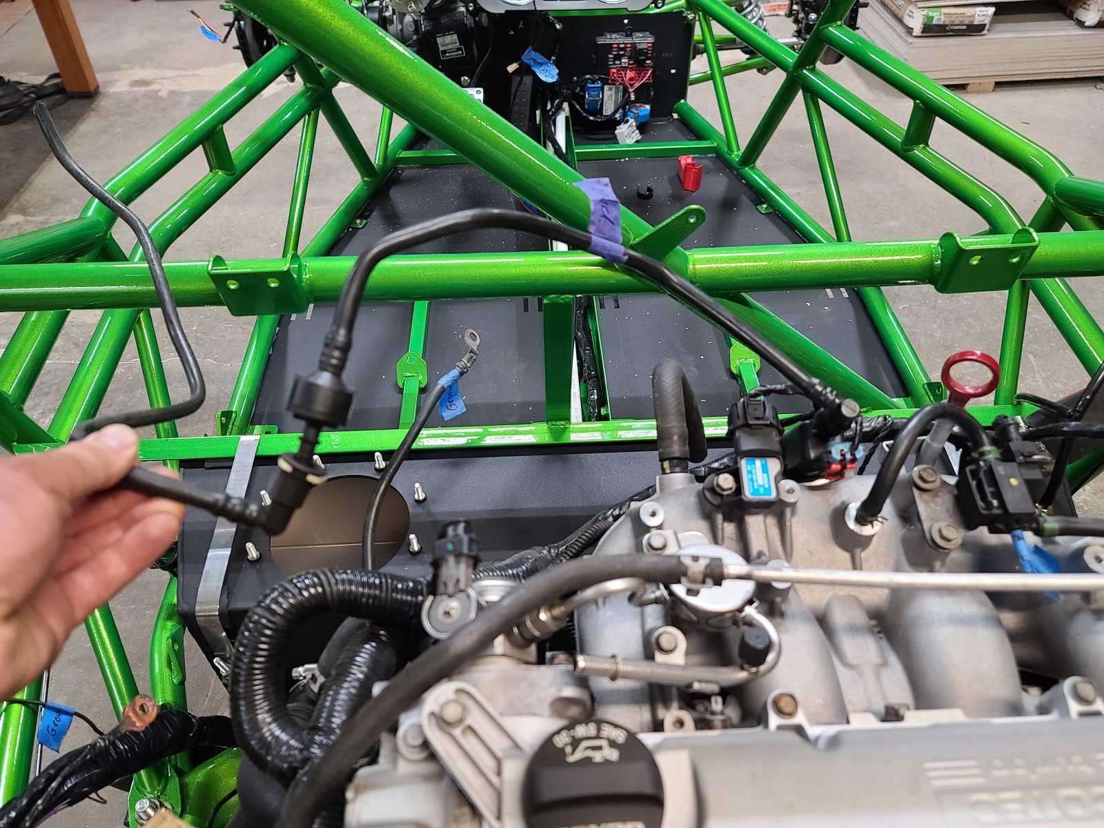

Been looking all over not sure where this line goes or if it just gets capped?
Brett
That's for emissions. I took the sensor off an made a plate to cap off the opening.
You might need it if emissions are required.

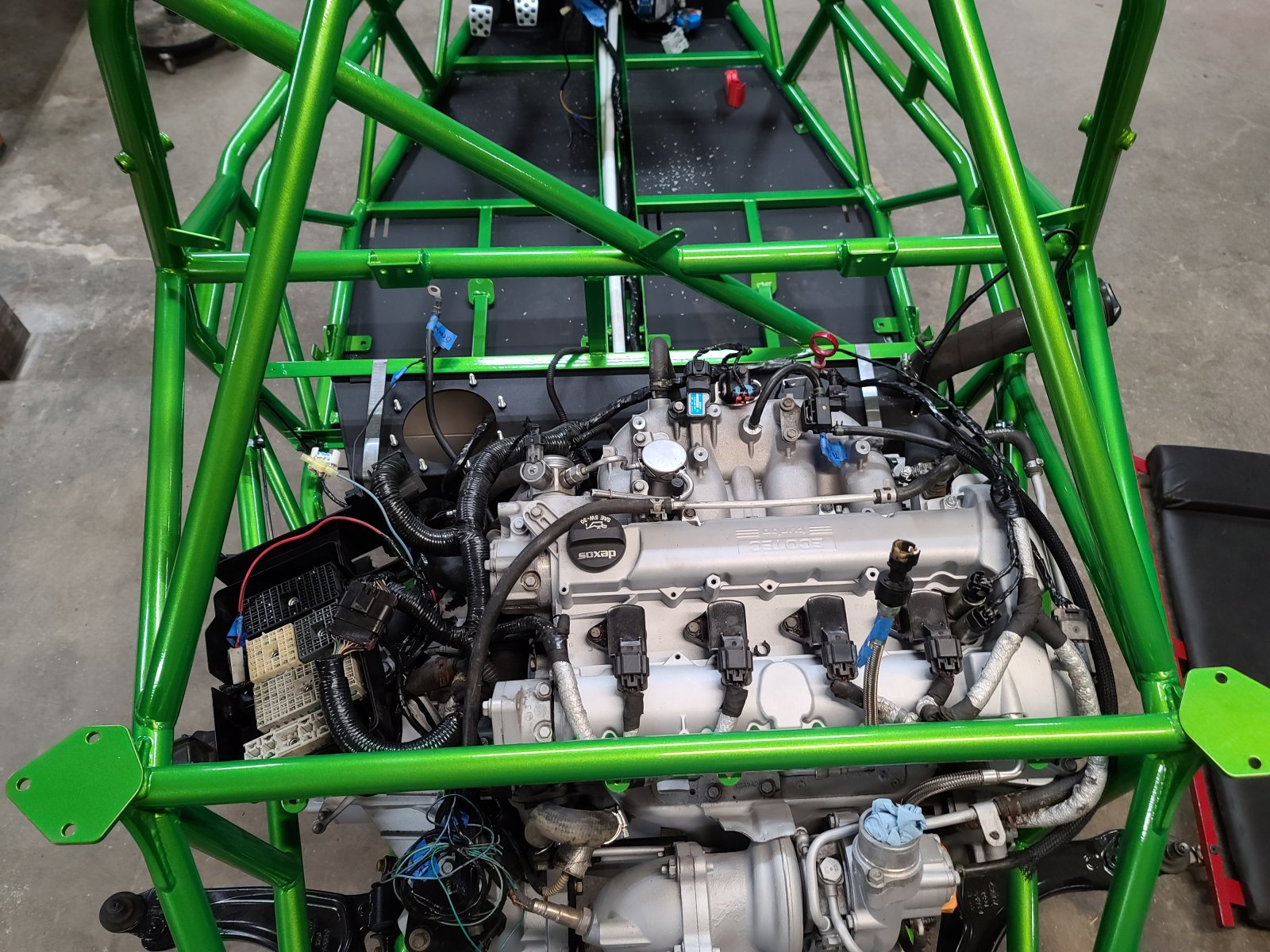

Slow going trying to fit all wires where they need to go

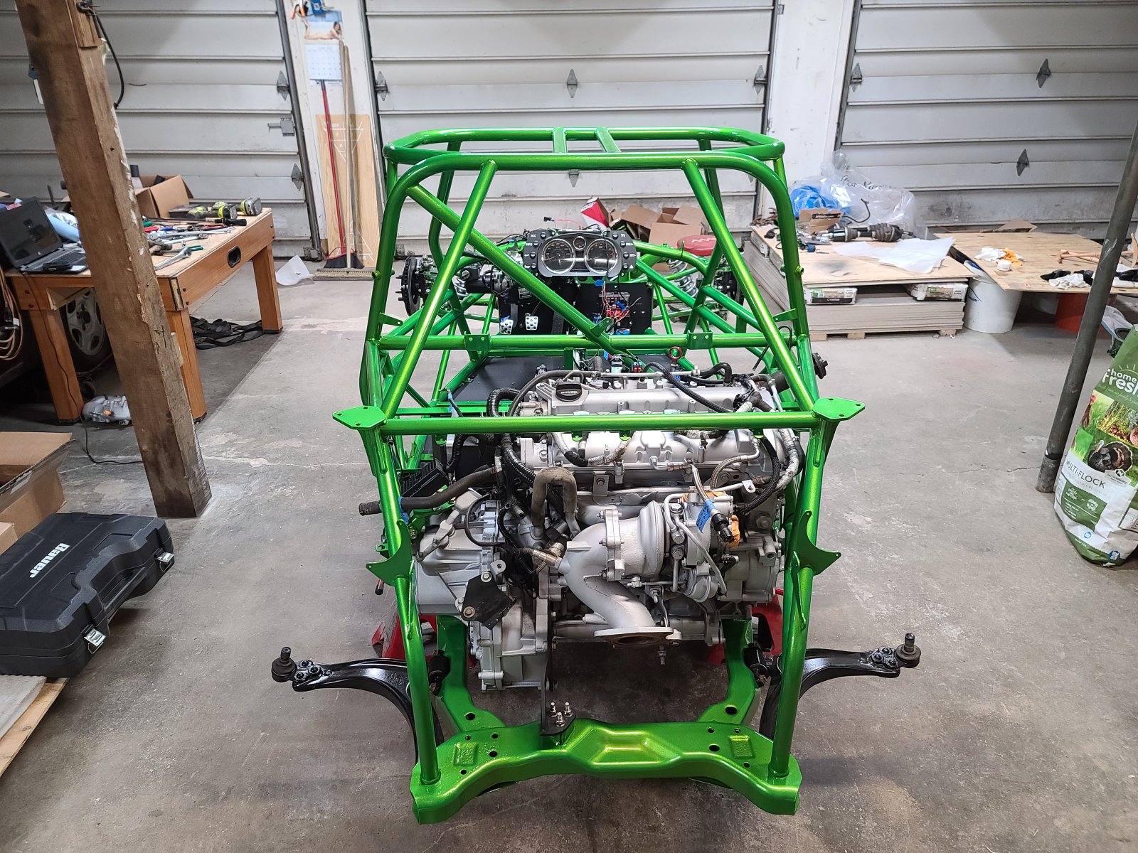

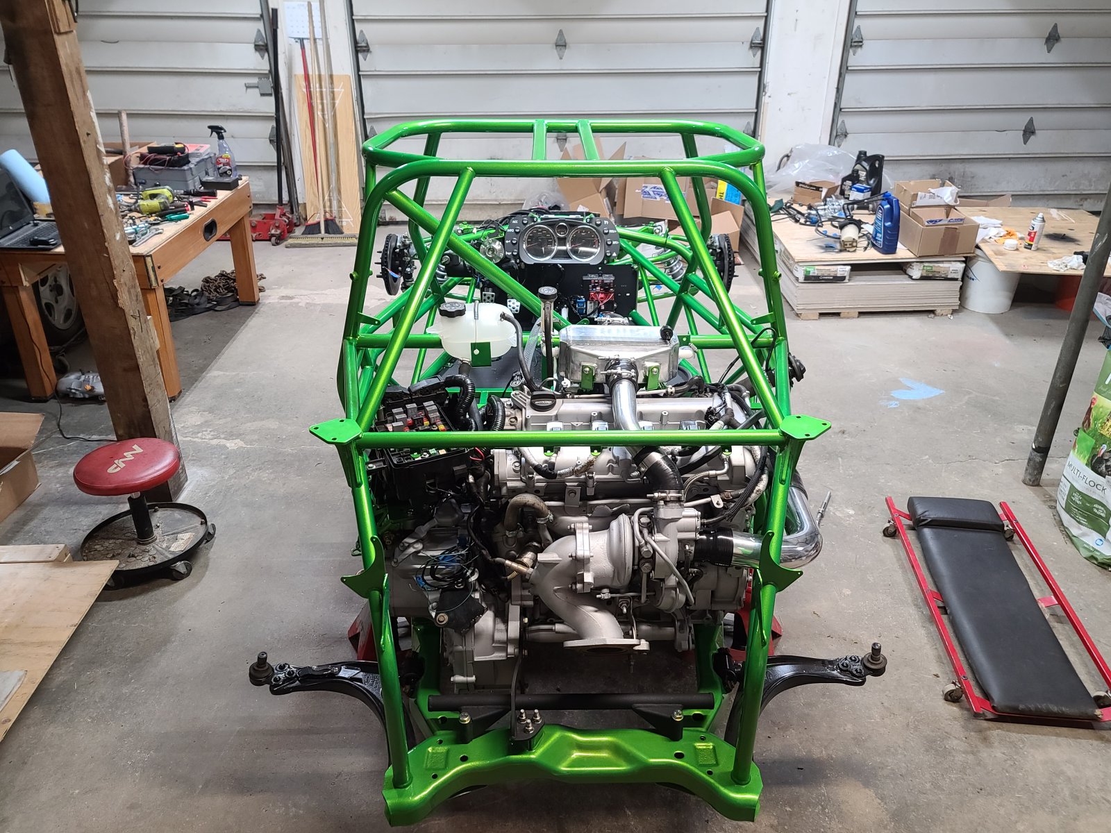

TheDon

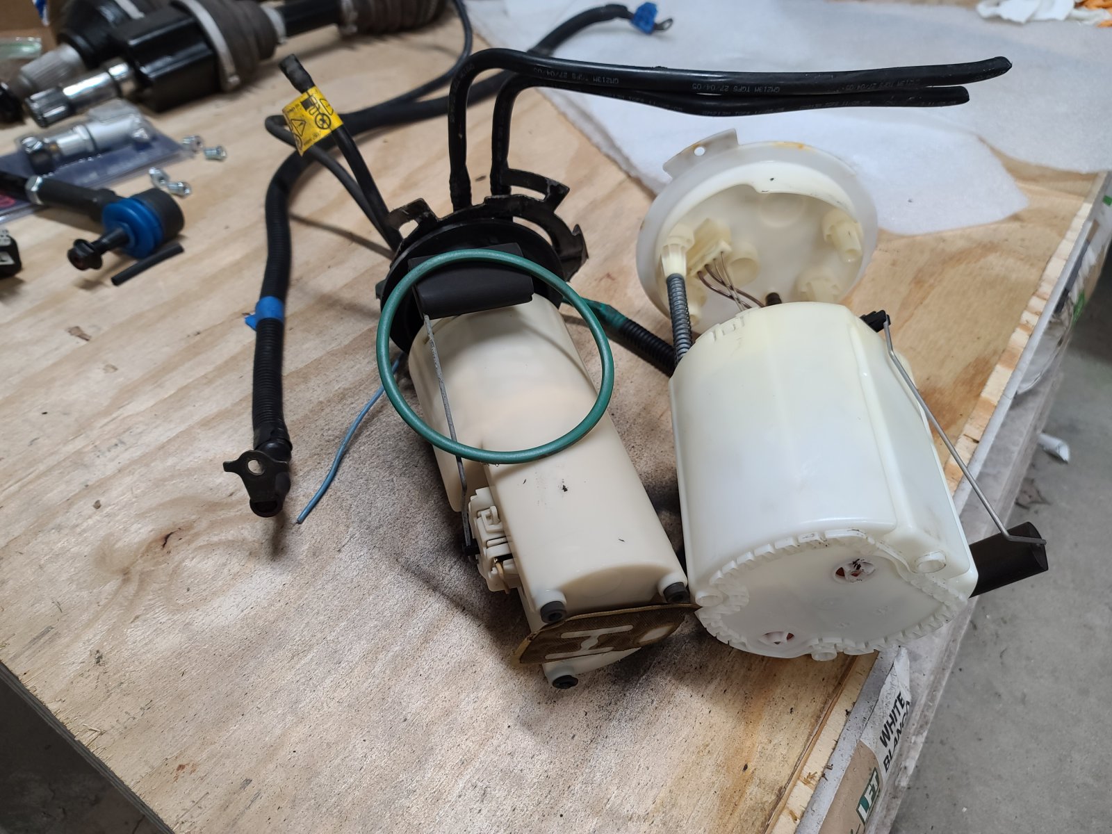

Think I may have set a record for fuel pump removal.
But was for nothing the ss/sc pump is different from the ss/tc. Ordered a new pump gasket because I know I saved mine but can't find it
I did block it with tires before going under

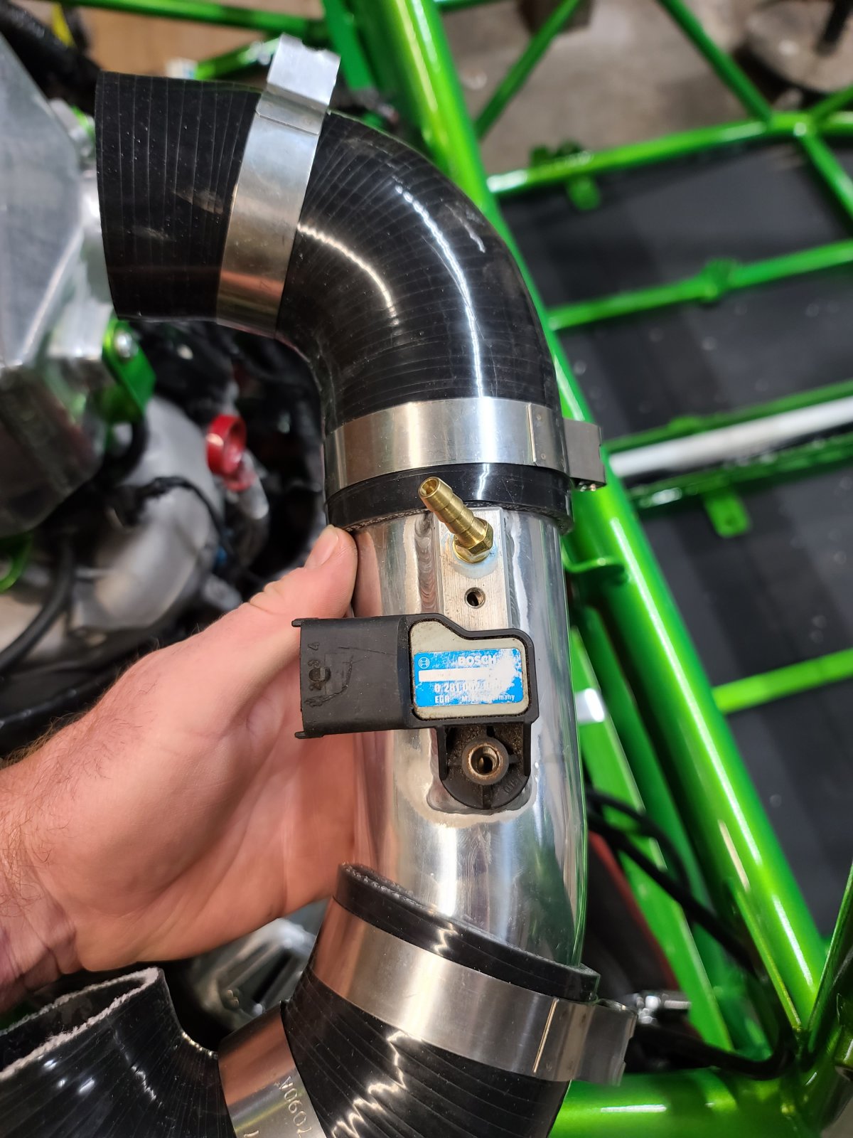

Pretty sure this is an intake air temp sensor and that it goes in pipe between throttle body and intercooler, but looks different than ones I've seen in other builds and hole doesn't line up?
Trying to confirm it does go here before I start making it fit. Thanks
Brett
Looks like the 3 bar map sensors. Common upgrade with a tune to get more HP out of the LNF.
Single bolt is fine. I believe that there is a 3d printed bracket that would help hold it in but plenty of people run just the one bolt with no issues.
TheDon
Thank you hole is a little off, but close enough I can make it work

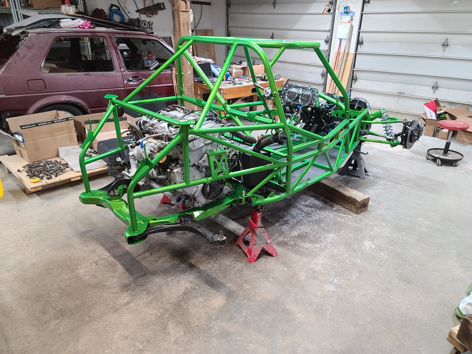

TheDon
Turns over just need to get some fuel line fittings.
Fingers crossed it fires right up.

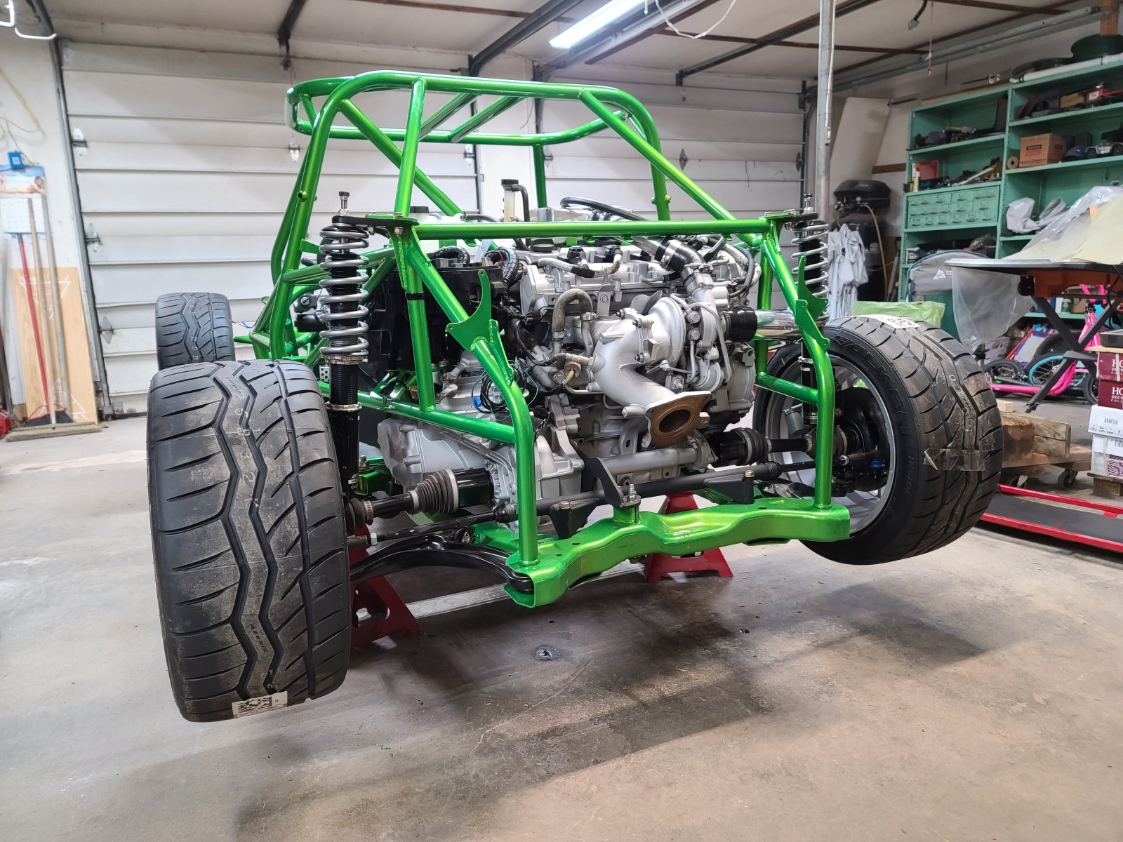

TheDon

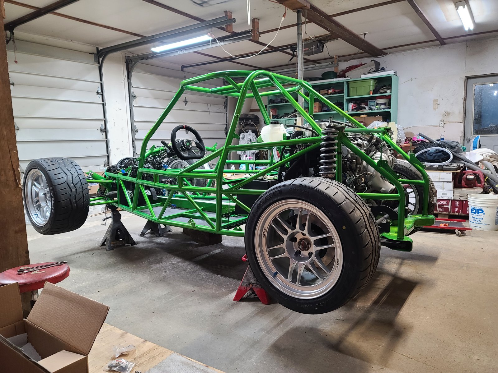

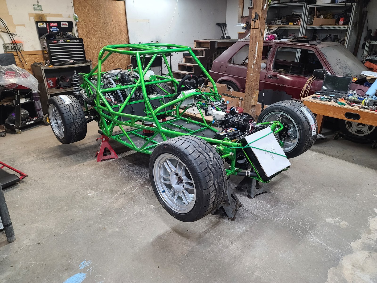

Going to have to take the wheels off to continue progress, since I test fit them all I do is stare at it and take pics.
