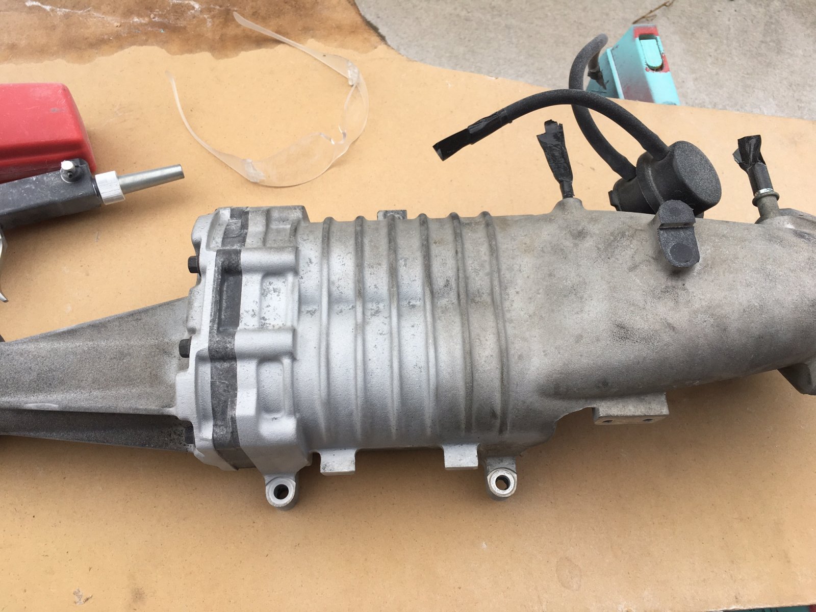

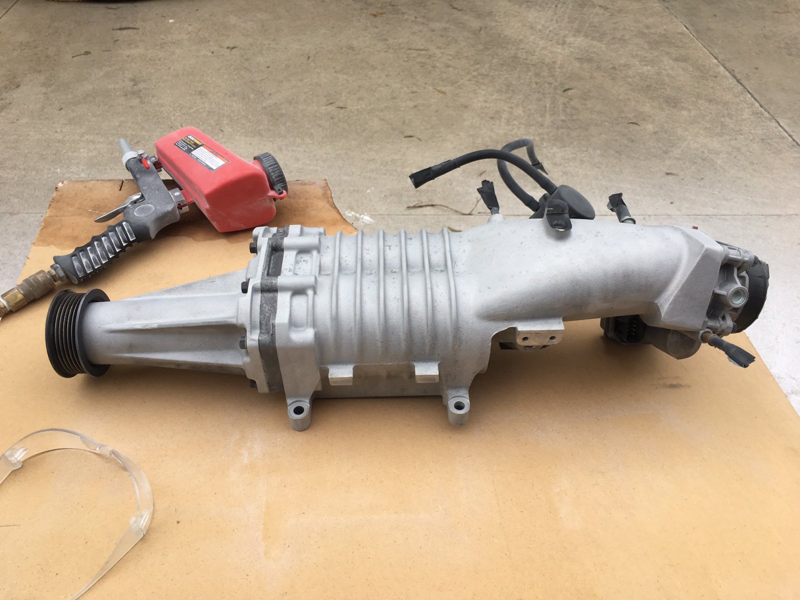

SliderR1
I've been soda blasting all the aluminum pieces on my LSJ engine. I had issues with water in my air lines, but after building an aftercooler for the air compressor, the soda blasting has been working great. It doesn't get everything 'perfect', but its good enough to paint...
Here are some pictures:
Just getting started on the supercharger:
Finished:

Soda blasted my engine. I just used one of the cheap air line filters before the gun and didn't have an issue with water. Soda is good (vs sand/walnut/glass media) because it won't damage plastic or rubber parts, and if it does sneak into any cracks, it dissolves in water/oil/fuel, so it won't hurt anything.
Slider, that IS perfect as far as soda goes! Looks great! Soda will not etch the metal like the other abrasives do so you can't expect operating-room-clean. But that will be the best surface to paint the block if you wanted. I wish I would have thought of it early on and invested in it.
SliderR1
Thanks Chad - you are right about it providing a great surface to paint. I already experimented with painting a few other pieces that were blasted and it is coming out great.
If the soda blasting was just a little bit better at getting it perfectly clean - I wouldn't even bother with paint. Some of the pieces I've blasted look brand new.
I will also add that I started with a 13.5 bag of 'food grade' baking soda that someone gave me. It is a lot finer than the soda that is meant for blasting and doesn't work as well. HF sells 50 lb bags for like $40 and its been working great.
