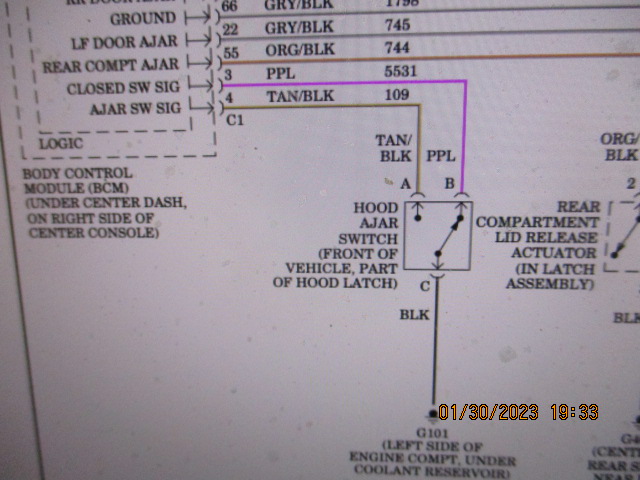

On my 2007 Cobalt SS SC I have 2 wires not addressed in the video that I can tell. BCM C1 connector pin 3 purple & pin 4 tan/black go to a hood ajar switch. It seems to me maybe I should ground pin 3 and remove pin 4. Any ideas? Thanks again. The help on this forum is awesome!!!:p
I would not physically remove the ajar pin just in case the wiring diagram isn’t exactly correct. The newer models have the switch drawn in a little different so it might not work the way you think. If you still have the switch you might confirm that it swaps the connection. The new one looks like it might have worked a little differently. But if the diagram is correct as drawn, you should be okay.
