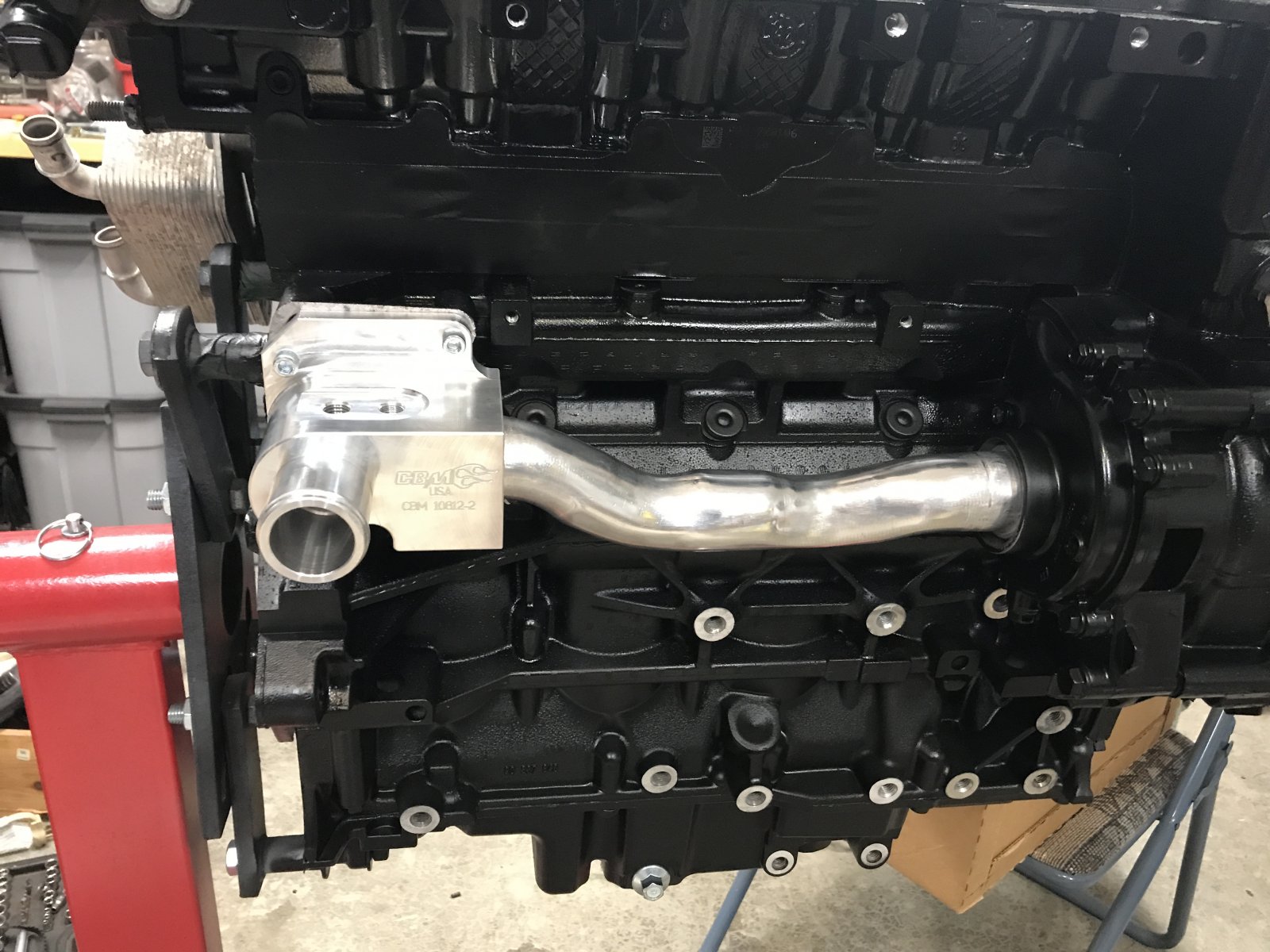

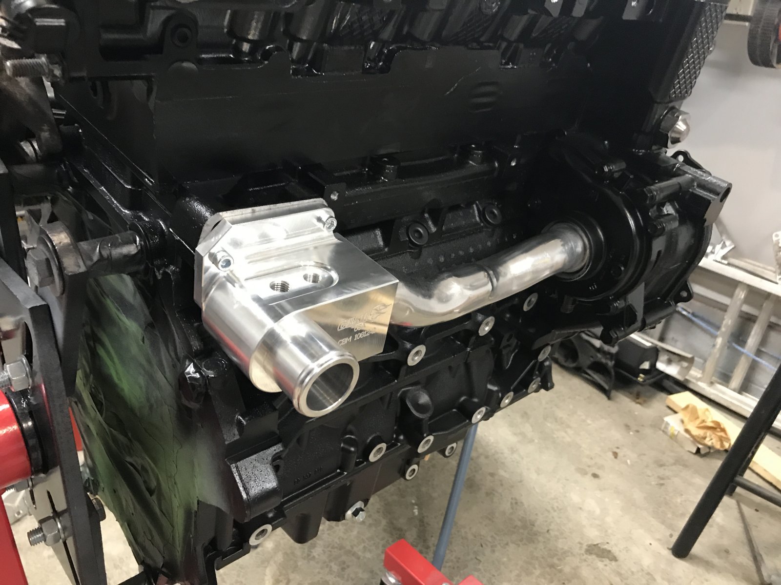

On most of our engines, including my LSJ, I never liked the look of the heater hose looping back into itself or the thermostat housing, so I had to buy one of these: https://store.custombuiltmotors.com...ec-billet-water-neck-block-15-barb-inlet.html

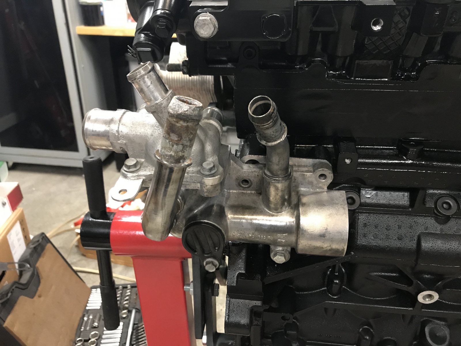

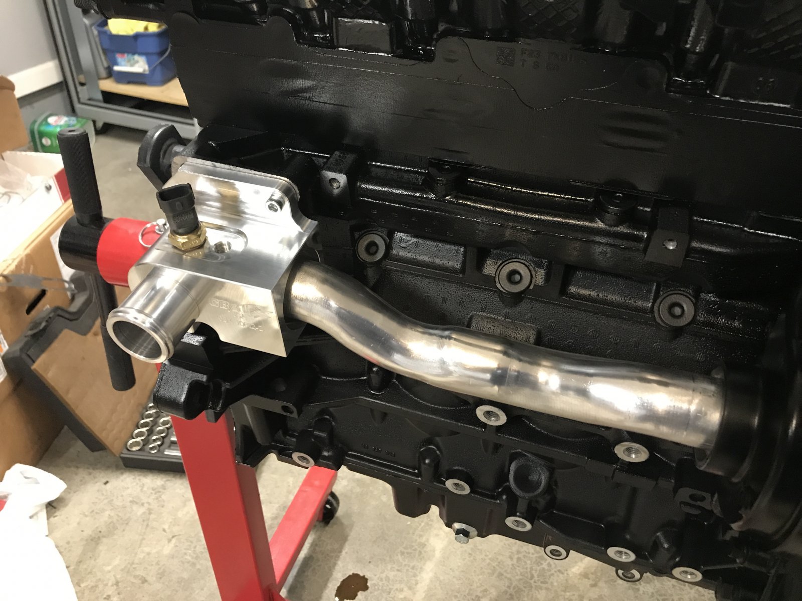

As you might know, here is picture of the LSJ thermostat housing without the looped hose and water pipe. Fairly ugly.

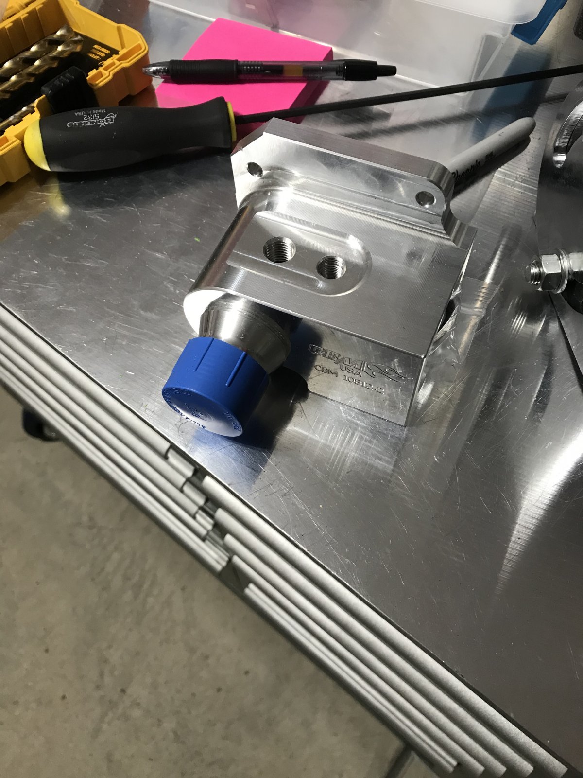

... and here's the water neck block from CBM. Much cleaner.

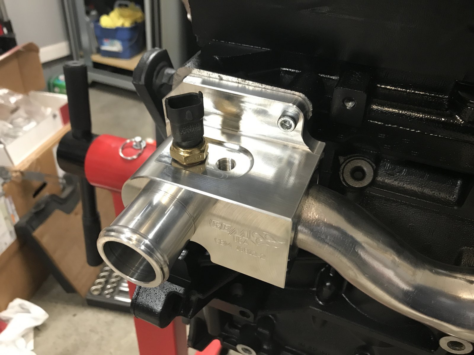

As you can see in the picture above, you can move your water temp sensor to the port provided. The other port can be used to go to the reservoir tank. I will need to purchase a 1/8" NPT to 3/8" barb fitting (if 3/8" hose is what the reservoir takes). I know I'm being picky, but it is just something I wanted to change. It provides no performance enhancements, just aesthetics. With this, I'll also need to do something else with the stock oil cooler and I'll provide a write up on that at a later time.

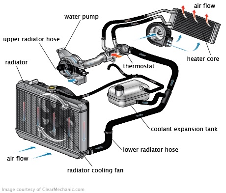

JSATX
Well, now you are opening yourself up to several other issues. Because the engine was originally designed to allow the water pump impeller to still cycle water through the radiator and around the thermostat.
JeffsGoblin
Justin, can you elaborate? When I look at the stock housing and the placement of the thermostat, I was under the assumption I was replicating the same setup just without the heater core hose and oil cooler hose connections.
JSATX
With an in-line thermostat and no heater core lines I’m not sure the water pump can still cycle though the engine. When the thermostat is closed in the oem config the water pump still pumps water though the engine, just not through the radiator. But it’s really been a long time since I’ve dealt with this so I could be misremembering.
All I’m saying is don’t close off your pump completely. It still needs to cycle water though the engine at all times.
JeffsGoblin
Thanks Justin. I think I see what you mean. Looking at your diagram above, I see where the bypass is indicated by red arrow going into the thermostat housing. This is blocked off using the CBM device and if I use a inline thermostat and it is closed, there will be no water flow at all.
I just called CBM and they said they've sold about 1,500 of these devices (their most popular ecotec item) and everyone is running with no thermostat without problems and they've been selling them for 10+ years. Obviously, they aren't running in cold temperatures. The coldest temp I'll ever get my Goblin out in will be ~70 degrees.
