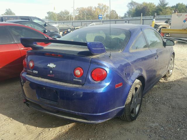

Yesterday I bought a donor car. So I guess the new project is officially started.
I have been looking/bidding for 3 weeks on Copart and IAAI auctions. The turbo cars are selling for more that I was expecting (I limited my biding to $3500 including all fees), and I haven't had much luck. Maybe I'm too picky. < 100K miles, within 800 miles of my home...
I have also been watching the supercharged Cobalts, when I came across a 'mystery' one nearby (5 hour drive) with very little information.

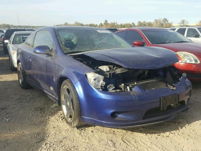

06 Cobalt SS, doesn't run, unknown mileage, and crunched in the front.
I thought it might go for cheap, as it is a gamble.

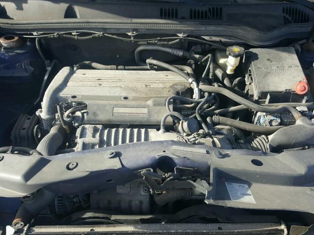

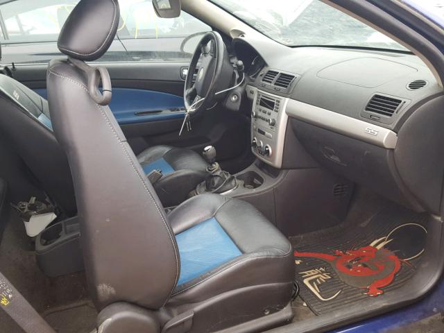

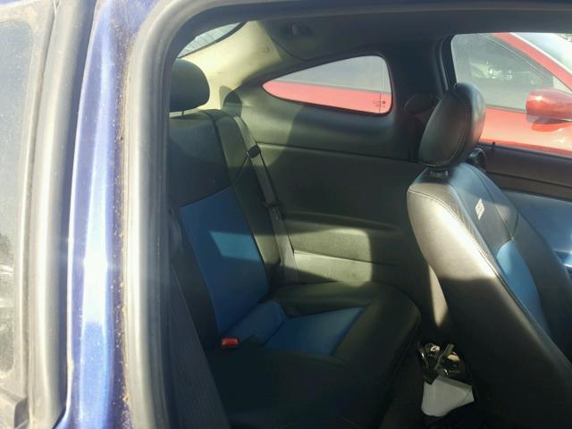

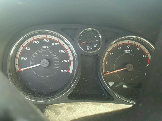

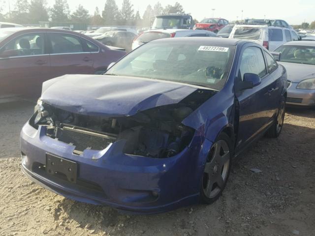

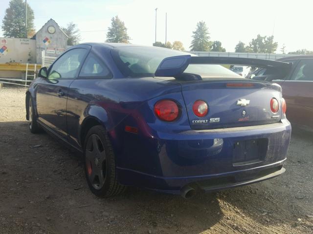

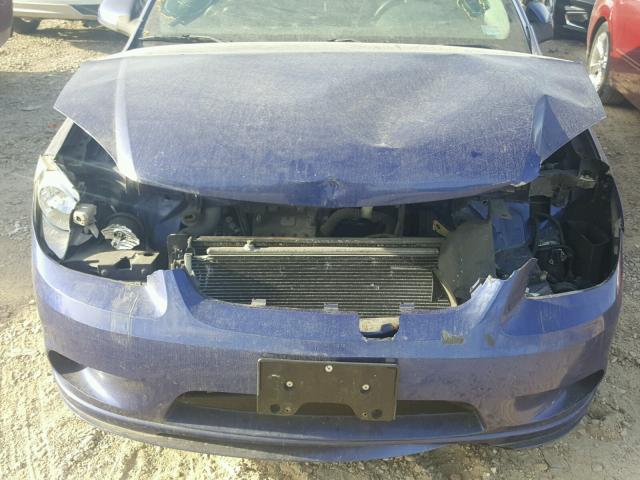

Even if the engine is toast, the rest of the Cobalt parts have a value right? (I'm justifying the gamble to myself)
I did a little research - VIN lookup on http://chevroletforum.com/forum/vindecoder.php revealed that it is a 2.0L supercharged LSJ. I prefer that over the 2.4L NA.
Copart even had an AutoCheck history report, which revealed that it was in an accident 6 months ago. So it has probably been sitting a while. (Still self-justifying a reason to bid). AutoCheck also says it was issued a duplicate title 6 weeks ago. So I look up the online form for duplicate titles, and there is a field for mileage... so I call the Missouri Department of Revenue, and explain that I'm doing some due-diligence on purchasing a car. They check the title document, and the mileage is filled in as ... 'Exempt'. Nice try, but I still don't know if it is worn out.
Inspecting the pictures, I think the front suspension and front frame clip wasn't impacted. Maybe the engine was hit. Airbags didn't deploy, rear is good.
So I waited for the car auction, bid once at $675, and then the Cobalt was sold. Only prebids, no counter bids during the online auction.
It's $985 after Copart fees, and i will pick up the car mid week, and start diagnosing on Thursday or Friday.
No idea if my gamble paid off... yet.
