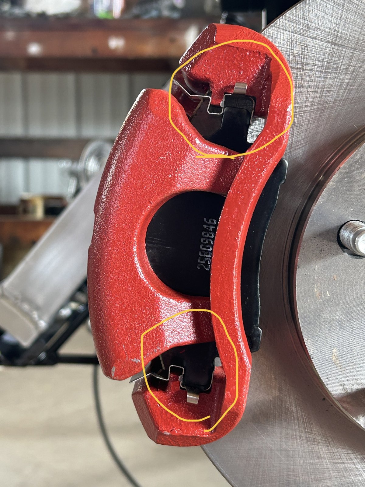

Started to do some preliminary alignment work and I just happened to notice that the front brake hardware didn't seem to fit right. Not sure why I didn't notice it while assembling the brakes, but on closer inspection today, I noticed that the pads and hardware don't fit the caliper bracket. Did I get the wrong bracket or the wrong pads/hardware from DF? It's like this on both LH and RH sides:

I think you only need 1 squealer per brake pad.

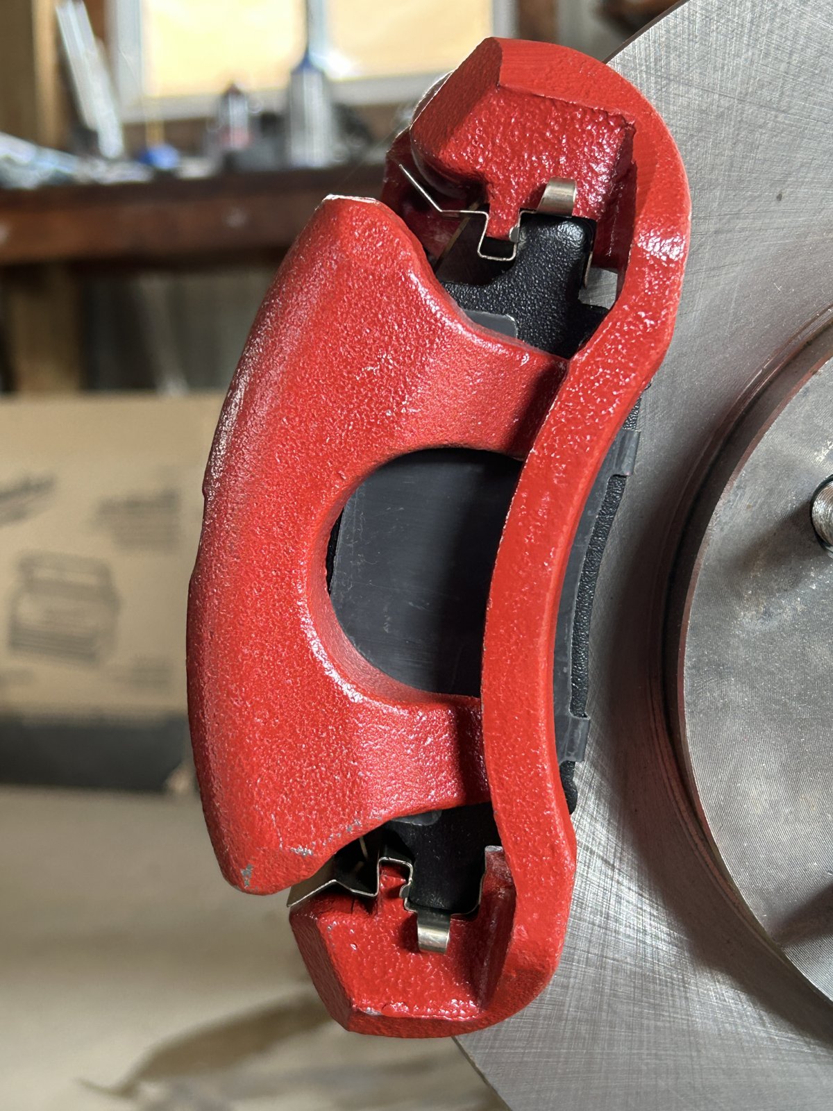

I have only one squealer per caliper - its on the inside pad, so not pictured here. Perhaps the picture isn't clear enough, but if you zoom in on the "ears" on the end of the pad, you can see the hardware fits the bracket very poorly and only about 10% of the top pad ear is engaged with the bracket.
That does look wrong.
Front brake pads should be for a 2009 Cobalt base model. I used Centric Posi Quiet Premium Ceramic pads.

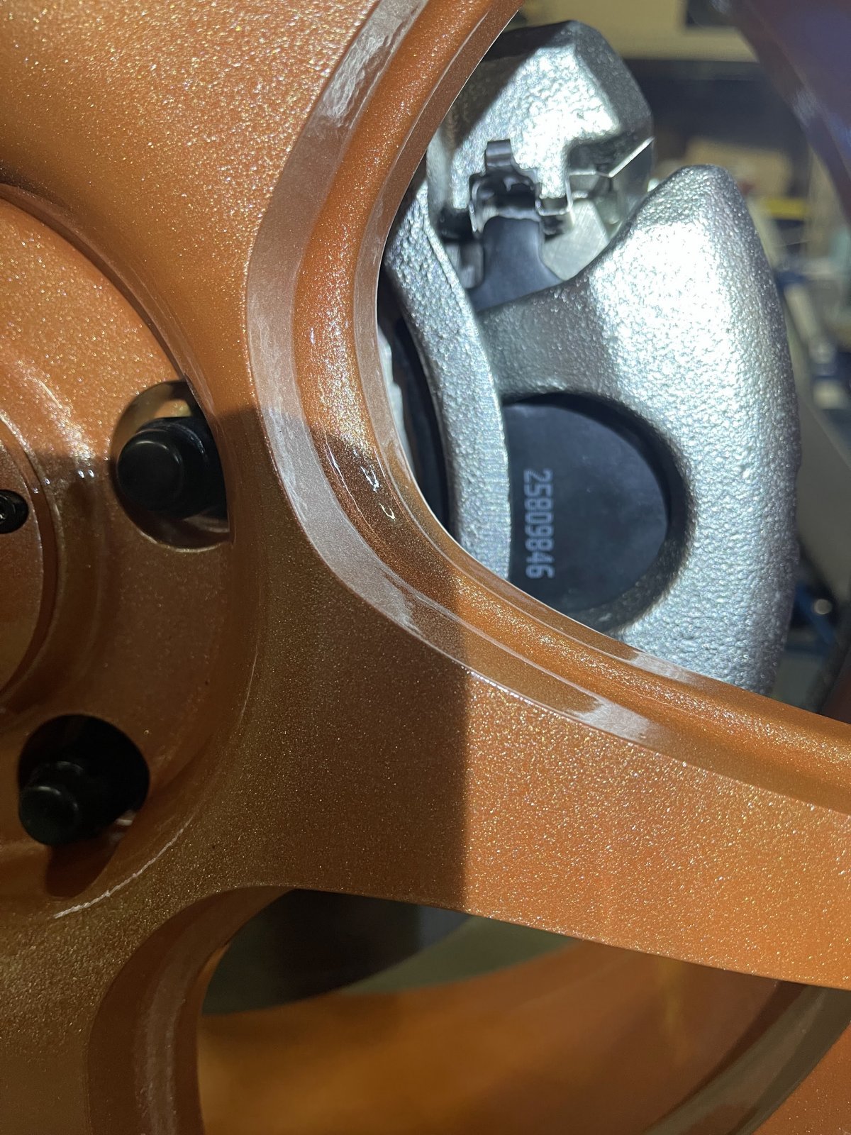

According to that part number on the pad, 25809846, those are for 2006-2008 Cobalt SS/Sport (2.0/SC and 2.4/NA) according to Summit. I think the front pads for the Goblin are supposed to be the front pads from a 2009-2010 base (2.2/NA) car. Here are the part numbers from the front calipers, according to Ross in another thread:

My DF stage 2 came with 15271565 pads for the rear, which fit as expected. However, it looks like I also have 25809846 pads up front, and they fit the same as yours. My car isn't drivable just yet (close), so I've not noticed. Yikes...
Wow! that's just wrong. The ears on the pads should be jammed against all of the anti rattle spring clip. It's usually a bit of a fight to get the pads into the pad guide with the spring clips in place. Don't be surprised if they were just mis-marked and mis-packed, there are thousands of different pads out there and in production mistakes get duplicated many times before they're caught! Great catch! This could have ended badly. Curious to see what the right pads looks like?
