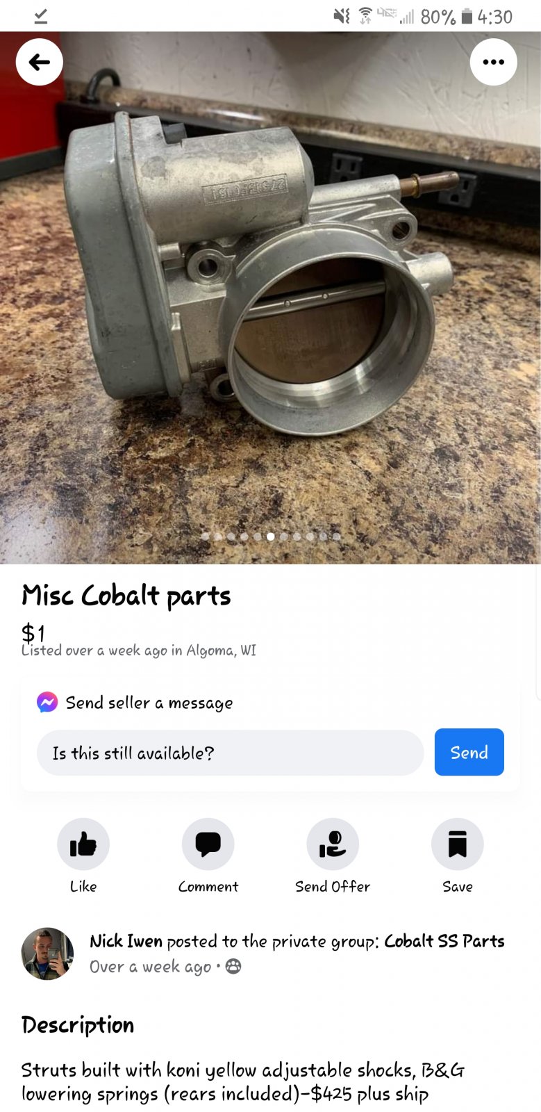

There's a bolt on upgraded throttle body already available, the ls4 tb, but from my reading it makes even a full-size cobalt very twitchy to drive, I can only imagine what it would be like for our goblins. But you might be able to play with the tune to tone it down, I know it's bolt on at least for the lsj motor, not sure about other motors?
I think this is what u mentioned at the end of your post.
