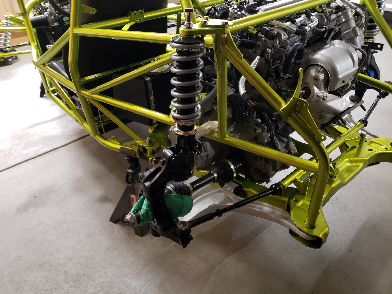

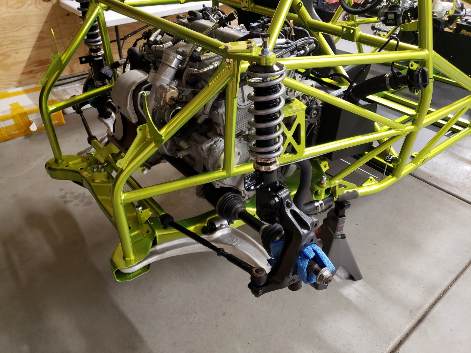

It is just bare aluminum. When I ordered the kit, I talked to Adam about the aluminum tarnishing. We looked at his car, and the uprights did not look tarnished. However, the rear shock tower mount plates(also aluminum) did have some discoloration. We speculated that it was because it was a horizontal surface that allowed water to sit in it. I got those powdercoated to match the frame. I could get the uprights clear coated I guess, but they were a pain to get installed simply because I do not own a 15/16" wrench. When tightening the pivot bolts, I had to use my Arkansas socket set, which did not fit in between the black brackets. I had to disassemble each black bracket, bolt it onto the opposite side for support, torque the pivot bolt, and then reassemble the black bracket back to its proper position. So in hind sight, I should have got them clear coated before I installed them if I were going to do it.
Tim Moland
Anyone with an assembled and driven car... And I mean driven a lot, how do your uprights look? Are they tarnished? Should I get mine clear coated to protect them?
Karter2026
I used a product called Protectaclear I got from Amazon waiting to see how it holds up. I coated all the un coated aluminum parts on my car. And still have some left. I coated the bolts also on the front suspension

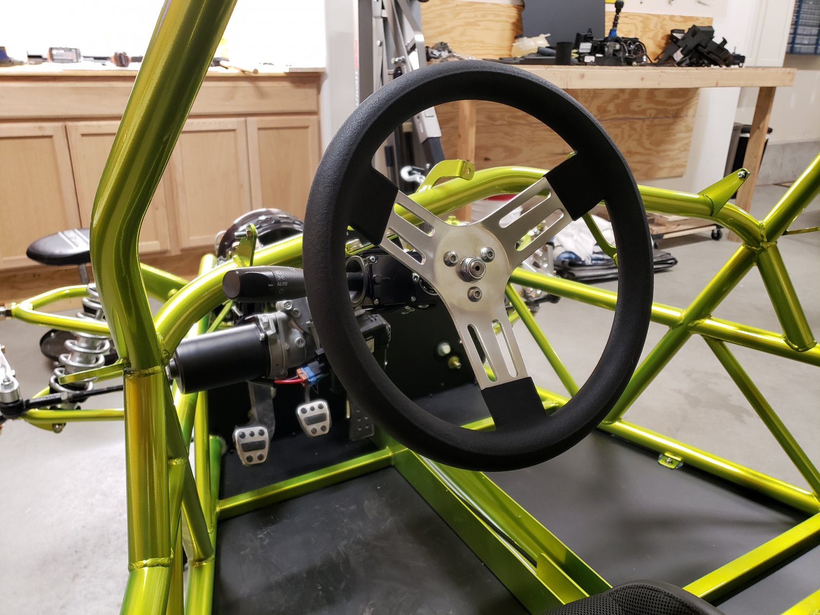

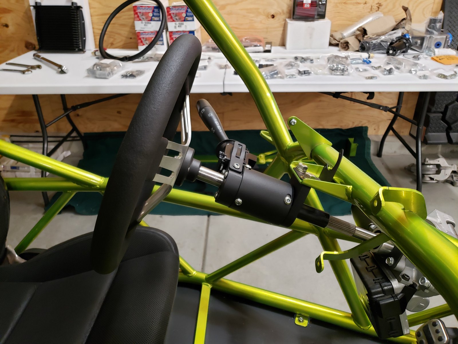

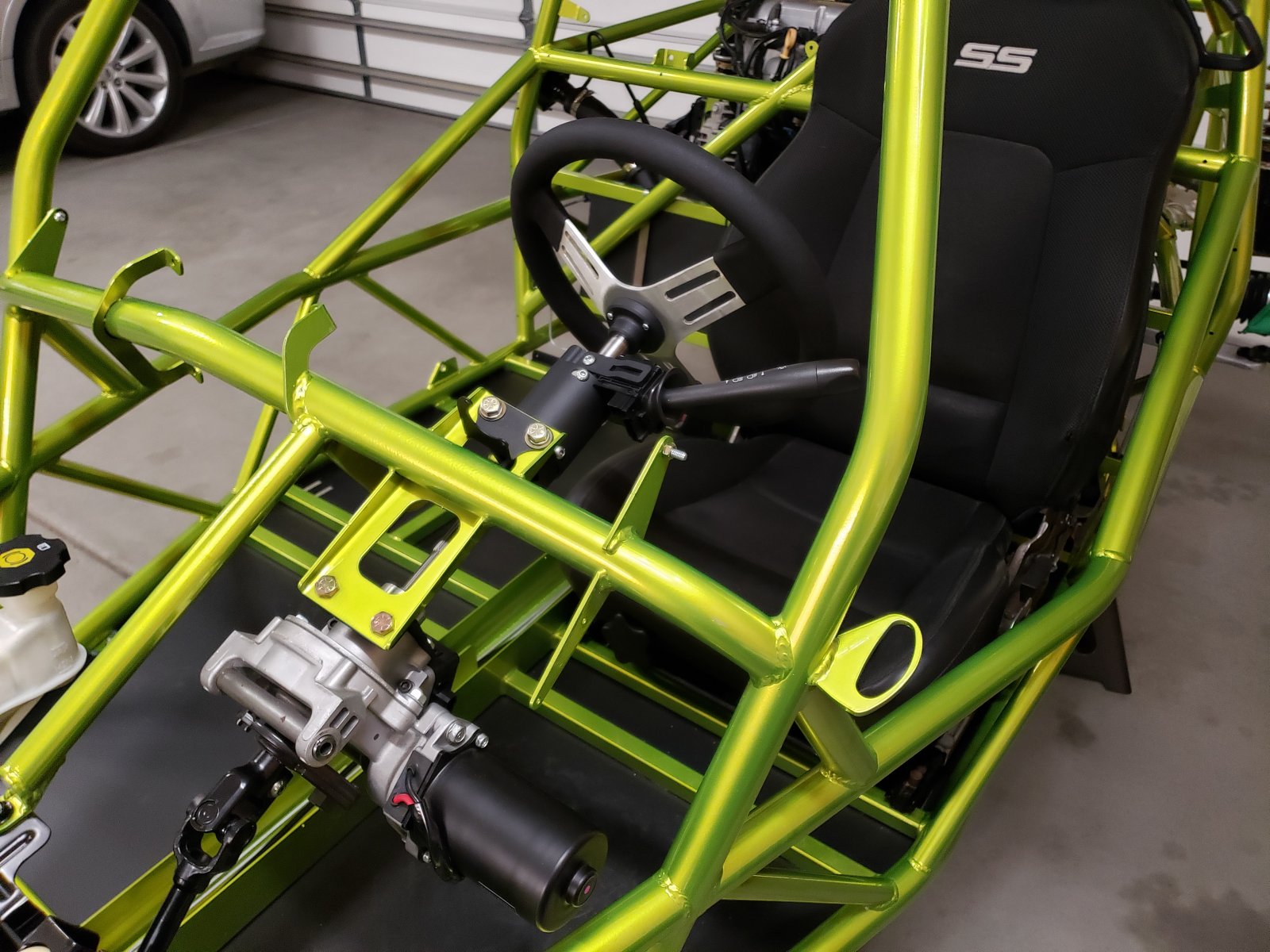

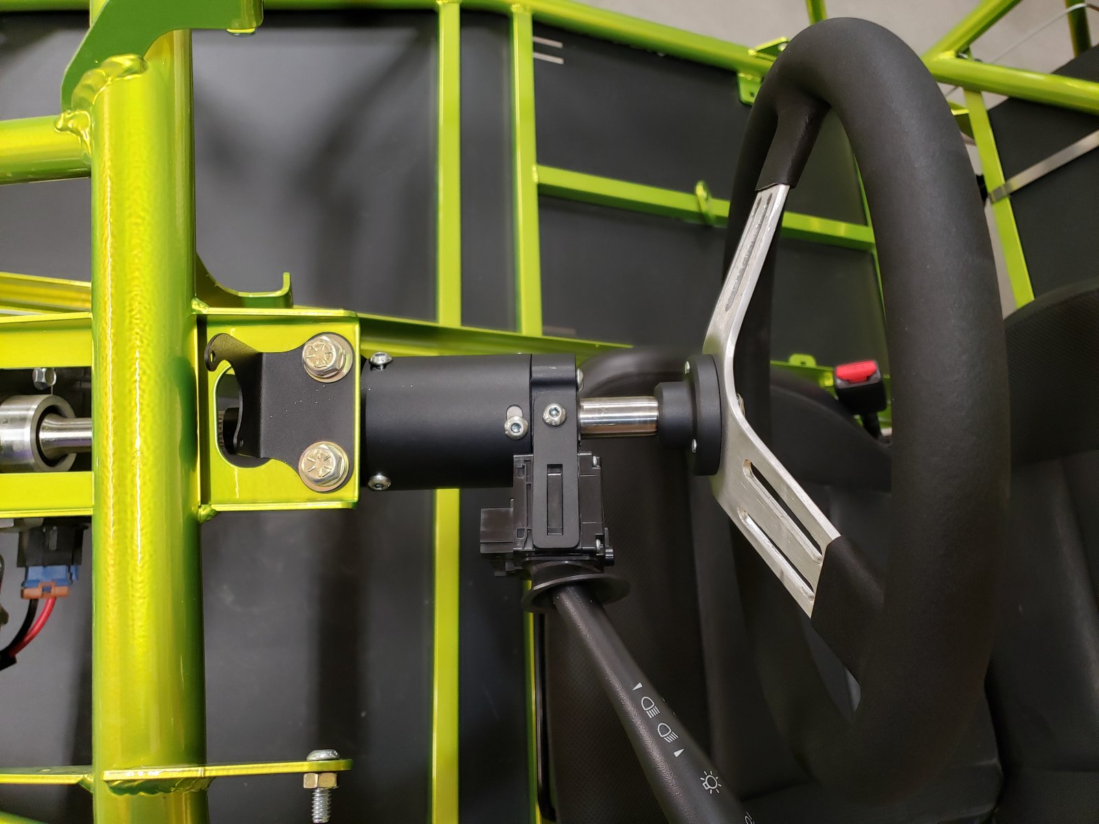

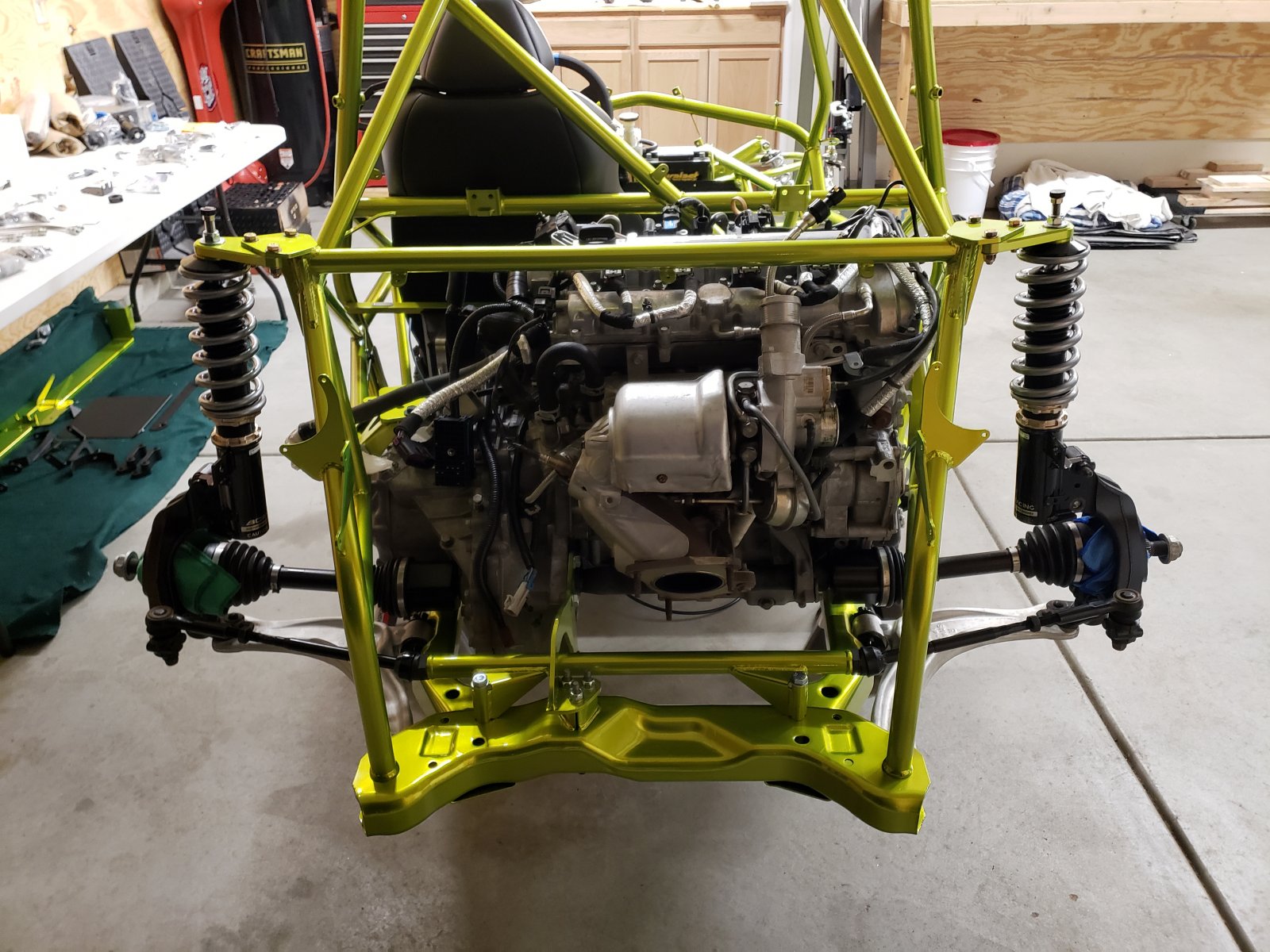

Started tonight off with getting all the subframe /suspension bolts in and torqued. Man, that front solid transmission mount was a pain in the @ss! I had to loosen all the motor mounts back up, use a jack to force things into place, and whack the bracket with a 2X4 and a rubber mallet to get everything lined up enough to get all the bolts started. By far the hardest thing I have done on this car(DF pulled my coolant hoses through the frame ). Then I moved on to the steering wheel. Took a little while to figure out how that all went together. Got everything on but the turn signal cancel arm. I'll wait till I get it driving and aligned before I place that.
Then I tackled the rear coilovers. I'm sure I don't have the springs adjusted right, and I need to add anti-seize before doing so. Inserted the drive shafts and slipped the knuckles over and torqued the bolts down. I had one of the knuckle bolts snap on me when tightening it, so it's off to the junk yard tomorrow. Finished the night off with installing the rear steering lock bar along with the rod ends. I Need to research how to align all this stuff.

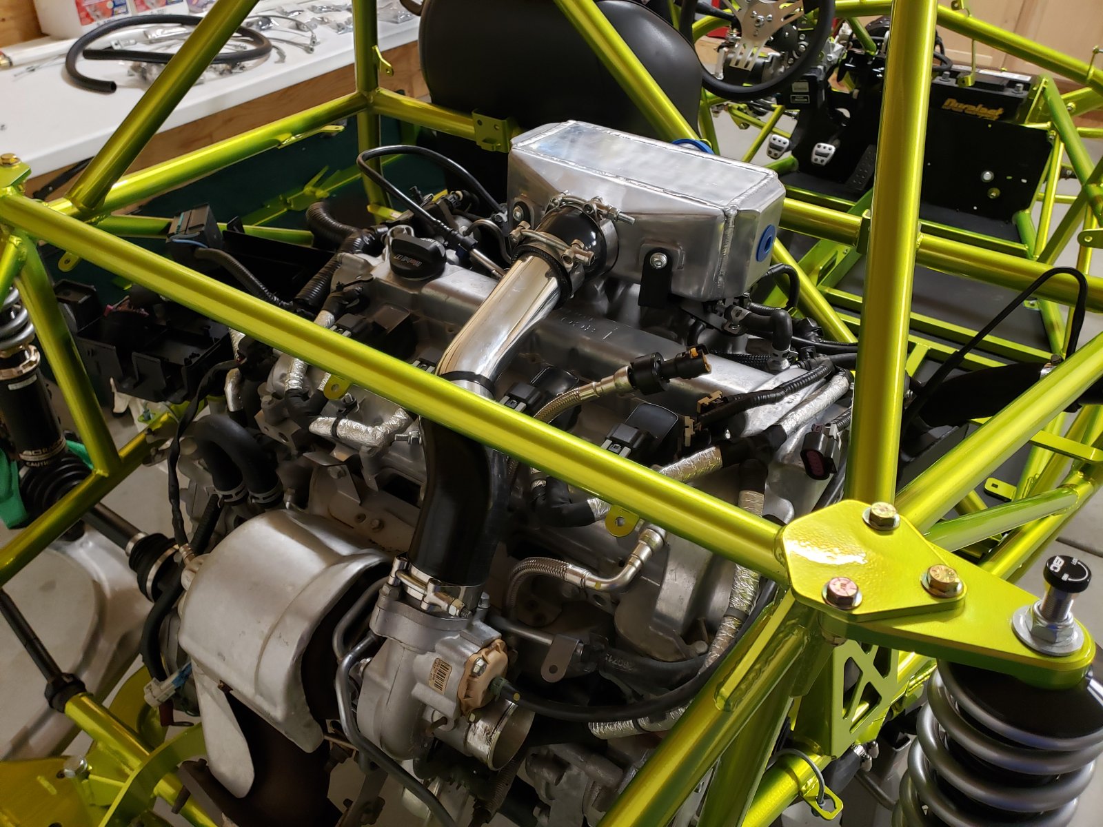

Worked on the intercooler tonight. Got it mounted and got most of the turbo to intercooler piping done. It is a very tight fit. I still have one clamp that I cannot get the nut started on(the smaller end of the Intercooler coupler).

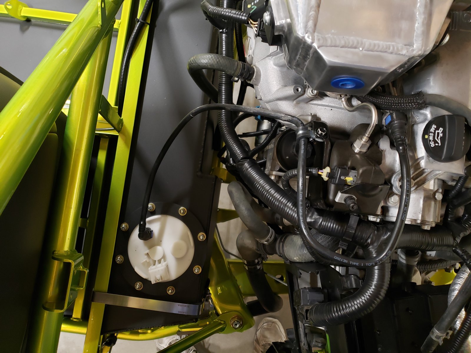

I also worked on the fuel line connection. I'm told that the original fuel line is too be reused. Not sure how everyone else is doing that. Mine was not in a shape to reconnect it without twisting it up to get the connectors to go the right way. I decided to use a heat gun to reform the line to get it to work better. I got it on, but not really happy with how it is routed. It looks out of place.
