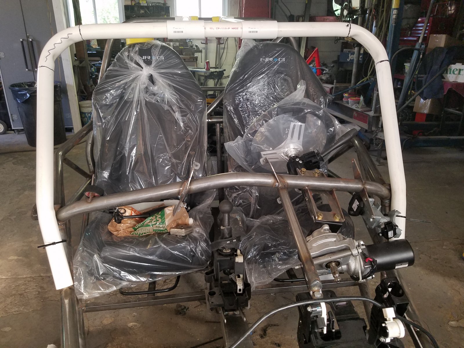

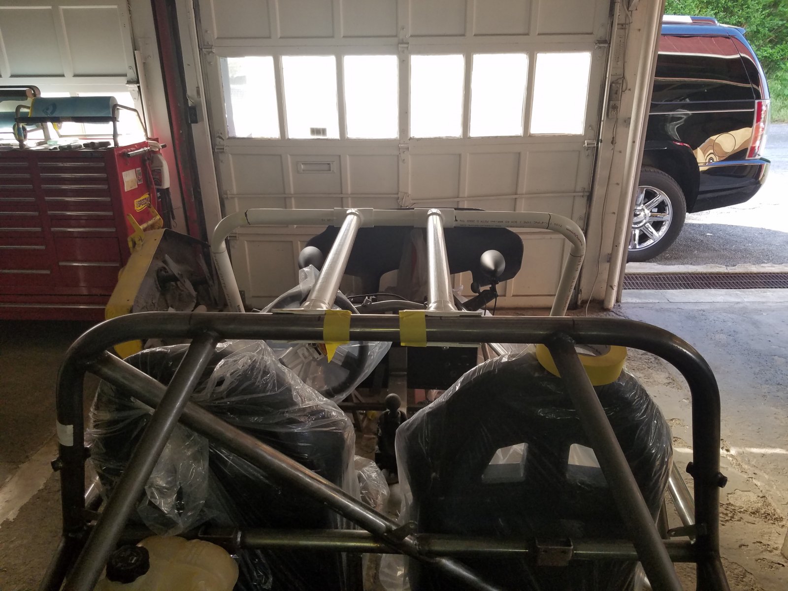

I agree with the clearance issues. You will not only need laminated safety glass but a wiper and apparently a washer.
I recommend a brace back to the rear hoop. I will be willing to bet that you will grab the windshield frame to climb in and out. If it flexes the frame the glass will break.
This is what I mocked up for my windshield frame

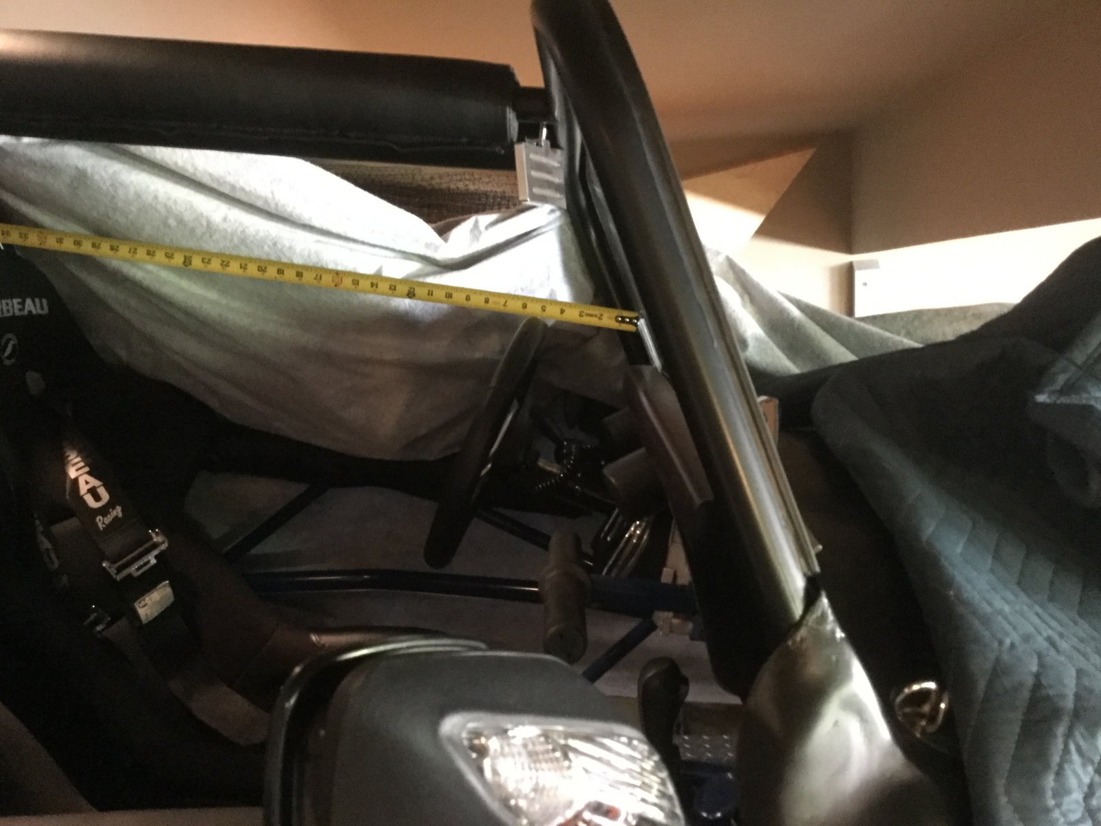

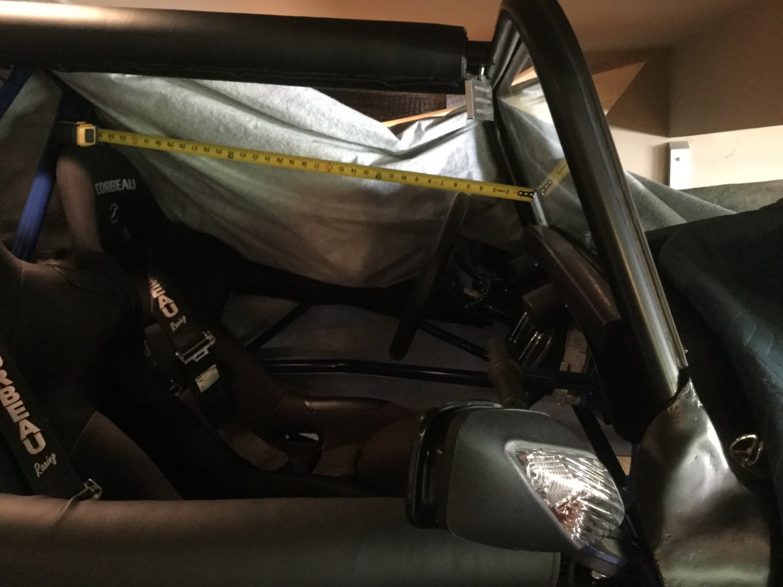

Good Evening,
Just a quick side photo of the clearance between the steering wheel and the windshield only about 4 1/2” and I’m a lot more vertical then I would have liked. Ron is basically copying what I did on my car. (And as we had talked about the two center tubes function to keep passengers from bending the windshield and also makes it a lot easier for you to get in and out of the car.)
Bruce
