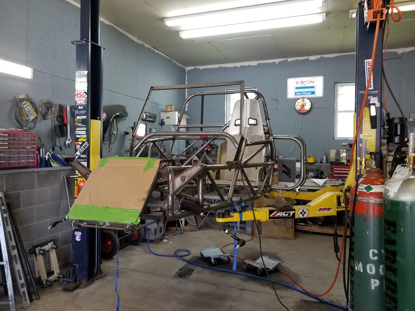

I did grab a picture when I was there dropping off a few last minute things the other week.
13086
The windshield is ~70% done. It is getting tied into the main hoop at the top corners. Aside from strengthening the windshield it should also help with getting in and out of it because so far all of my attempts to get in and out of it have been less than graceful.
The cooler that is in the side pod is just a 25 row oil cooler and I am having mounting brackets installed in each side pod for them in case I decide to run an engine oil or transmission cooler down the road. The heat exchangers for the supercharger will be mounted in front of them.
We changed the dash bar to match the shape of the hood and to try to raise up the steering column/shaft to give me alittle more room by the pedals.
Added a harness bar. The bar already there is too low to safely wrap the shoulder straps onto.
I think the total bill is going to be ~$2,500 for the modifications to the chassis that they made and it is going to be at least another $1,000 for the new fuel cell, heat exchanger tank, and coolant over-flow tank. The fuel cell and tanks won't be started until I get the chassis back.

I definitely hear you on the level of grace required even in the city frame. It's not bad if you can remove the steering wheel and step on your seats (since you have Kirkey's - as do I) but when you add the covers / padding that idea gets thrown out the window.
Excited to see how the side scoops come together, they're aggressive!
Mind telling how far above the original bars you added those? Wondering if I should consider this and if the same height would be suitable for the corbeaus (which I do not possess yet).
I do plan on running the covers on the Kirkeys and a quick release hub on the steering wheel. I also had an extra square piece of tubing added to the floor to stand on. Since we are remounting the steering column I want to try to push it forward as far as I can and then space the steering wheel into a comfortable position. Like what Fasterproms(YouTube) did with their S-10 build.
Looking good!
I don't have a measurement on hand, but I'll try to remember to measure it when I get the chassis back. But judging by the picture I took I am going to estimate the new bar is ~5" higher from the top of the old to bottom of the new. Honestly you should get the seats and mock them up to see for sure. DF's hardware with the Corbeau could have them at a different height than mine. I am not using DF's seat brackets and Kirkeys are pretty low seats. Too low of a mounting point for the shoulder straps and they can injure your back in a crash. Too high of a mounting point and they will not secure you properly.
