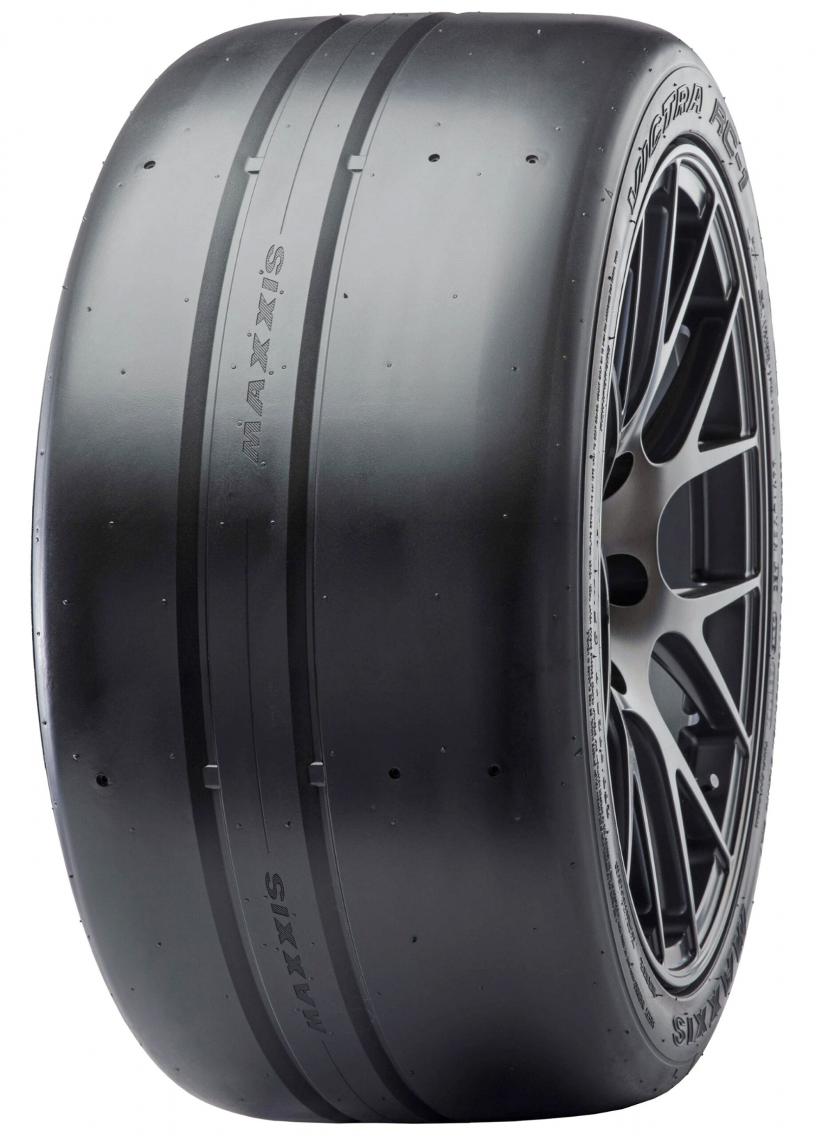

The Maxxis are my new 100TW street tires, just as the R888R are my current 100TW street tires.
Since I don't drive in the rain, I didn't see the need for many water moving groves in my tread.
I will need to be careful going thru puddles, but the same holds true for the R888R tires.

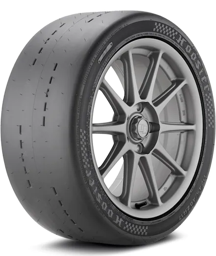

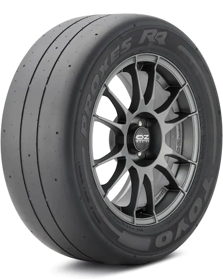

The Hoosier A7's race tires have a treadwear rating of 40, as does the Toyo Proxes RR... which looks pretty much the same as the Maxxis tire, but with the softer rubber that makes racing fun.
Hoosier A7:
40908
Toyo Proxes RR:
40910
Maxxis Victra RC1:
40909
