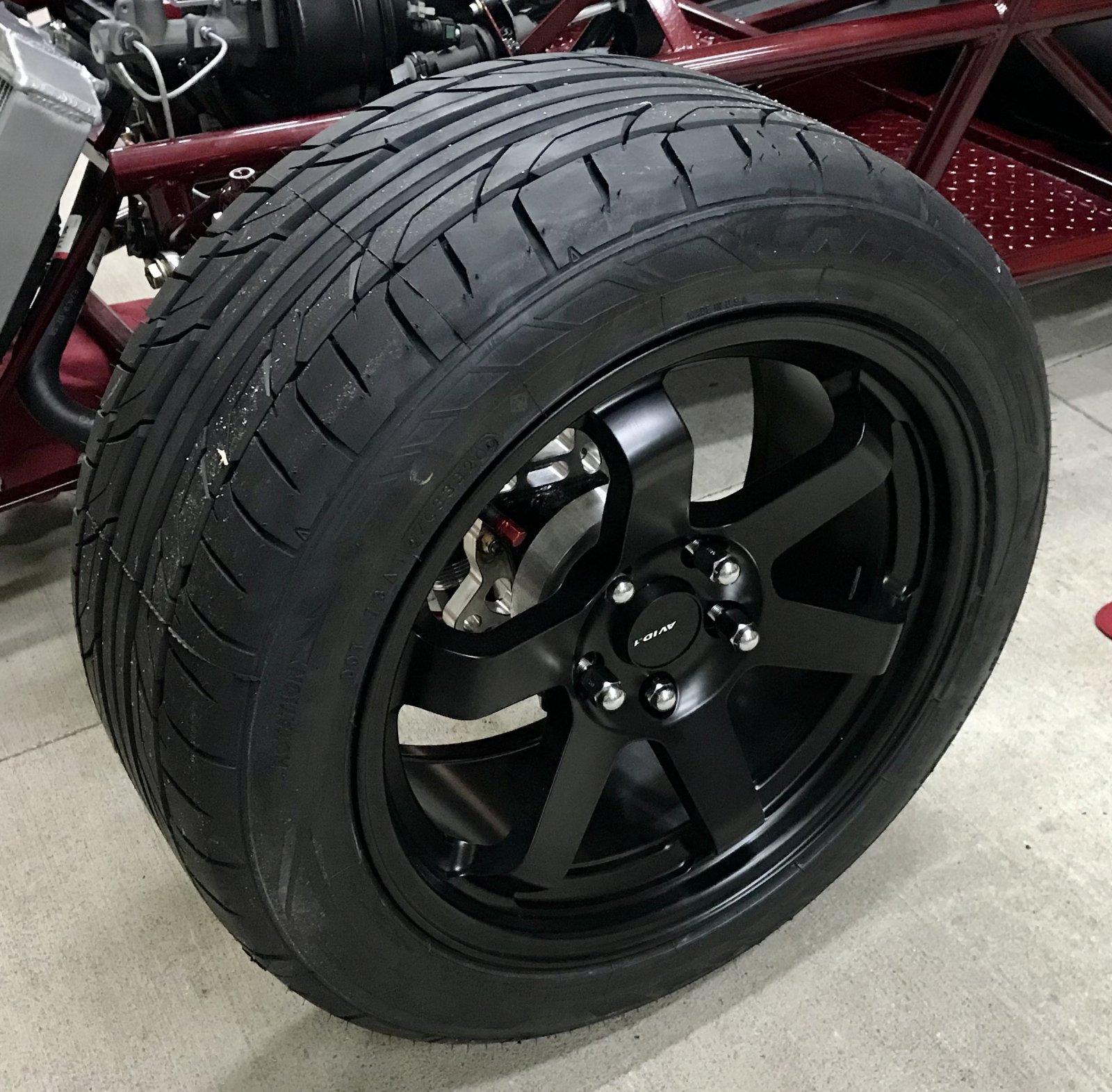

I'm running Nitro NT 555 G2 tires. 245-45-17 in front & 275-40-17 in the rear. I used a 32mm adapter (spacer) with my 17x9 wheels. I don't have any clearance issues. I did have to make special adapters to make the fenders work & widen the rear fenders.

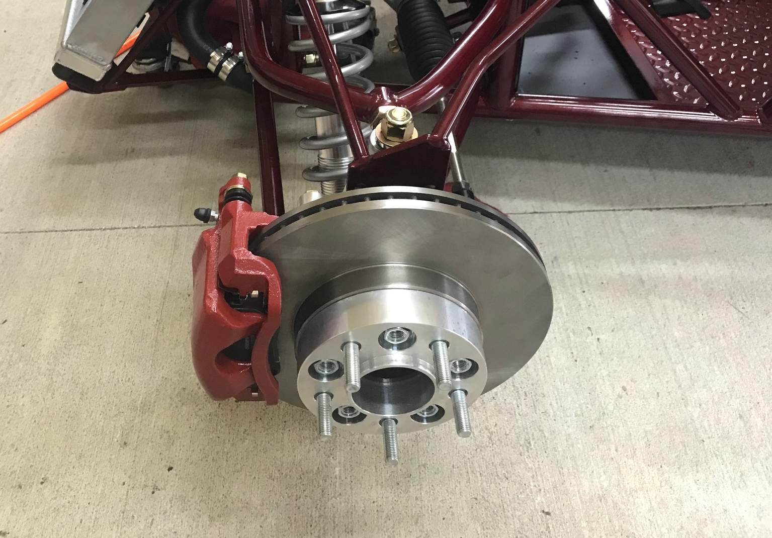

The offset is 32mm (1.26"). This is from the work order to have them made. "Custom - One Piece Adapter, HC to Car WC to Wheel, 2006 CHEVROLET COBALT SS 5 LUG, Studs:12x1.5, VehBP:5x110, WheelBP:5 by 114.3 (4.5 inches), CBVeh:65.1, CBWheel:73.1, thickness=32mm"
I had no issues with the the Stud length. As you can see in the 2nd picture the stock Lug Studs are recessed & look short. But they had approximately 80% thread contact. I do not believe this to be an issue since I followed the torque guidelines. If I was racing the car I would have replace them with longer studs.
