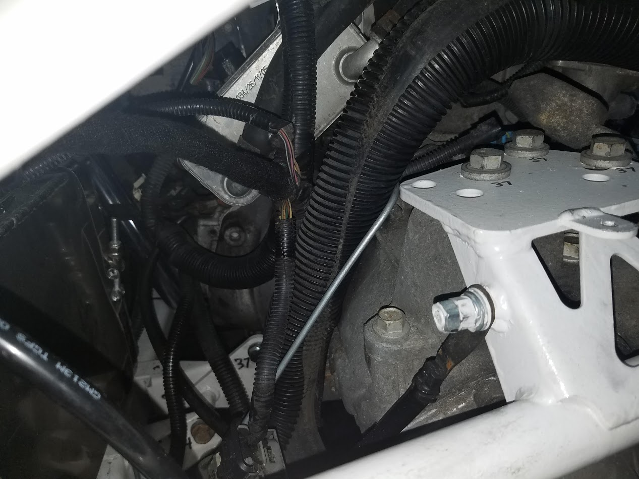

Thanks for the confirmation. Here's where I ended up putting it (the far end is on the existing engine harness ground stud).
Don't know about "best practice", but I put it with the engine ground on the mount plate.
aaronbuley
dang i'm glad you posted this picture. i forgot about that cable. it was just sitting on my shelf laughing at me as i tried to start the engine. :D
My frame had a grounding lug welded right beside the spot you used to ground it.
That is the engine ground wire - which makes sense when you have rubber engine mounts, but our engines are directly mounted to the frame, so that should provide pletty of grounding to the engine... probably an easy way to save some weight.

True, but I didn't think to remove the powder coat from the plates before bolting it up, so I figured it was good insurance.
