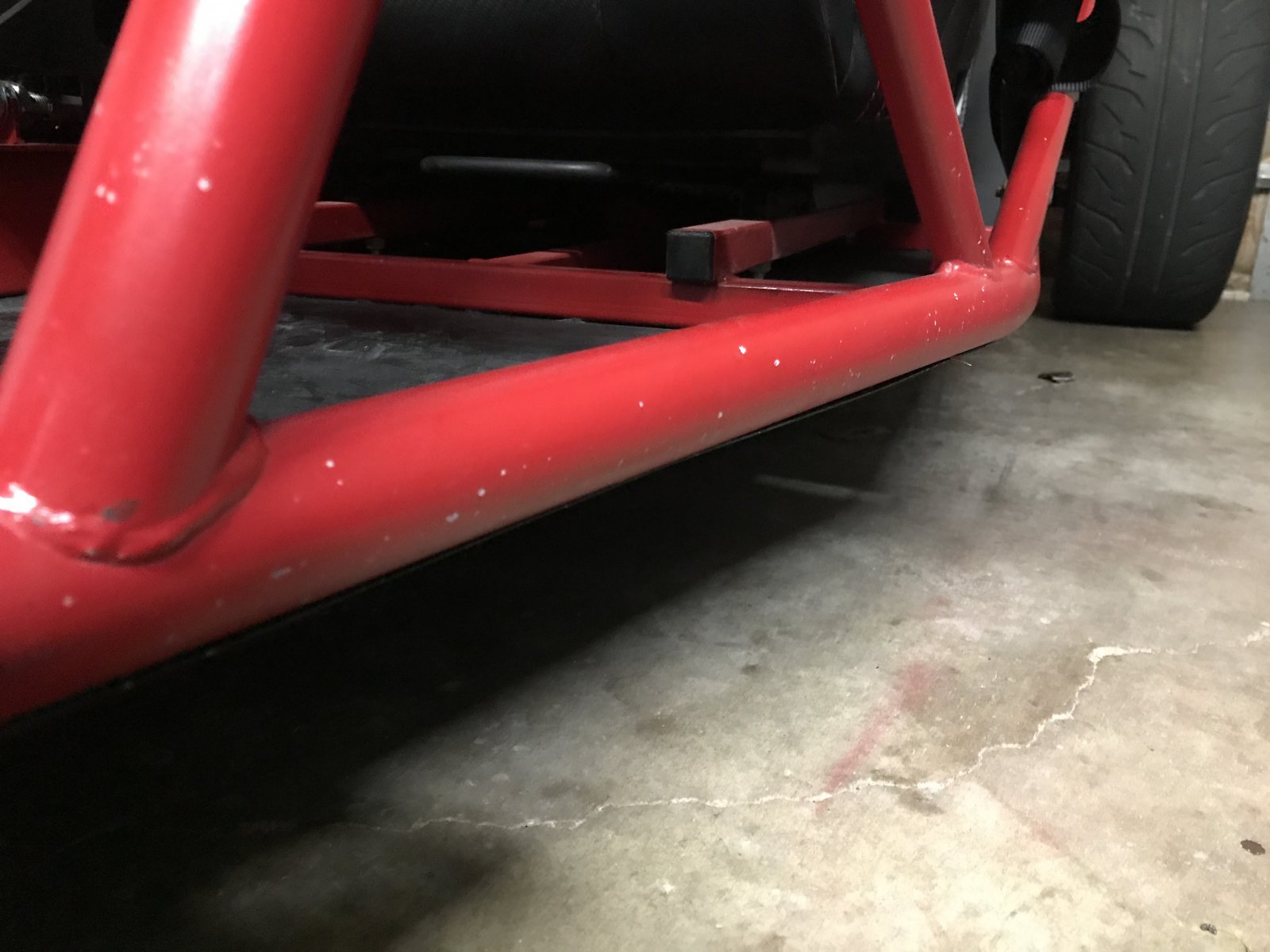

Two part paints are completely different from "normal" enamel type paints like rustoleum.
My biggest mistake of the entire process was using rustoleum. I used the paint that comes in the quart can and sprayed through a nice spray gun (only used aerosol cans to touch up small areas) and am totally disappointed in the paint, after only 400 miles it is completely covered in rock chips and has no durability.
A two step automotive paint or powder coat is the only way to go.
I didn't want to spend the money on powder coat and regret that. However if you wanted to go a cheaper route I would just take the frame to a cheap chain paint place like Maaco. While I'd never trust them with an actual car painting job the bare frame would be almost impossible to screw up and would probably cost about 1/2 a powder coat job.

I do really like JSATX's red on black. The photos don't seem to show the chipping. Is it chipping on the side chassis bars behind the front tires, as when you turn?
Wondering if a clear coating like the invisible car bra's would help protect those areas.

I'm sure the bras would help. Application would be a ***** though. And why cover it when you can just do it right the first time by not using cheap hardware store paint.
