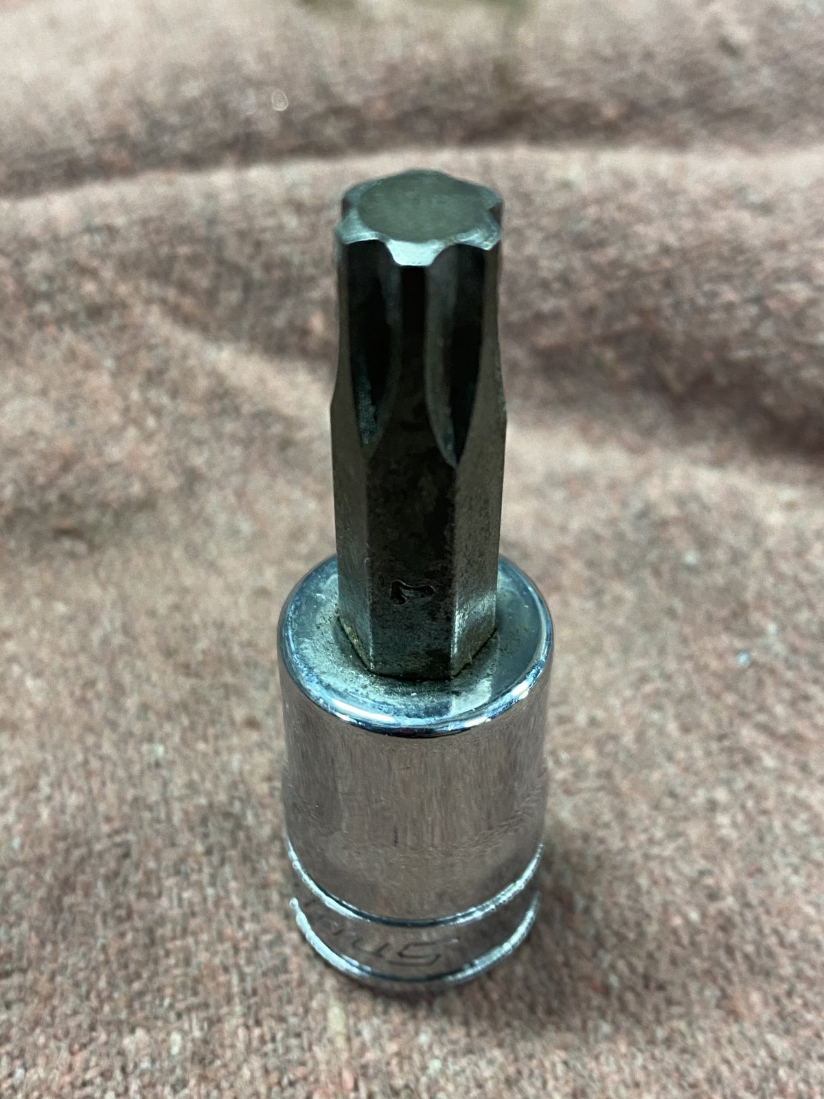

one of the biggest ones is a seat belt T50. There’s actually a special T50 for seat belts from Snap-On. its the T50OE. You’ll notice the the ends are not points, they are blunt cuts. This grabs the seat belt bolt much better and won’t strip them.

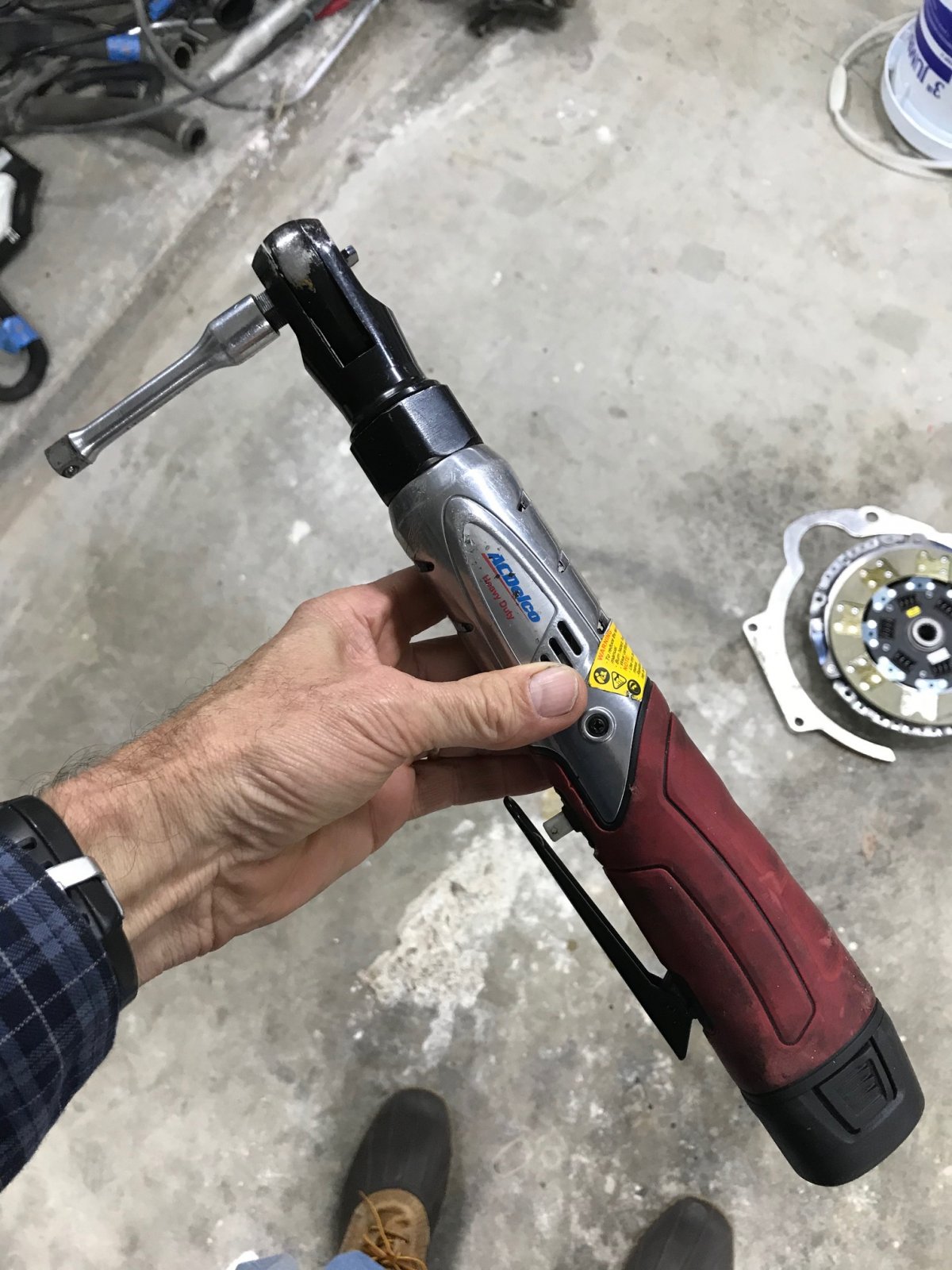

or electric equivalent ;)I have switched to Milwaukee M18 and M12 impacts, ratchets and such. I haven’t touched my air tools in a long time and don’t miss dragging an air line around.
I know that air tools have been the industry norm. With battery technology progressing, there are some good alternatives. I bought this wrench about a year ago. It is by far my go-to tool. I highly recommend it.

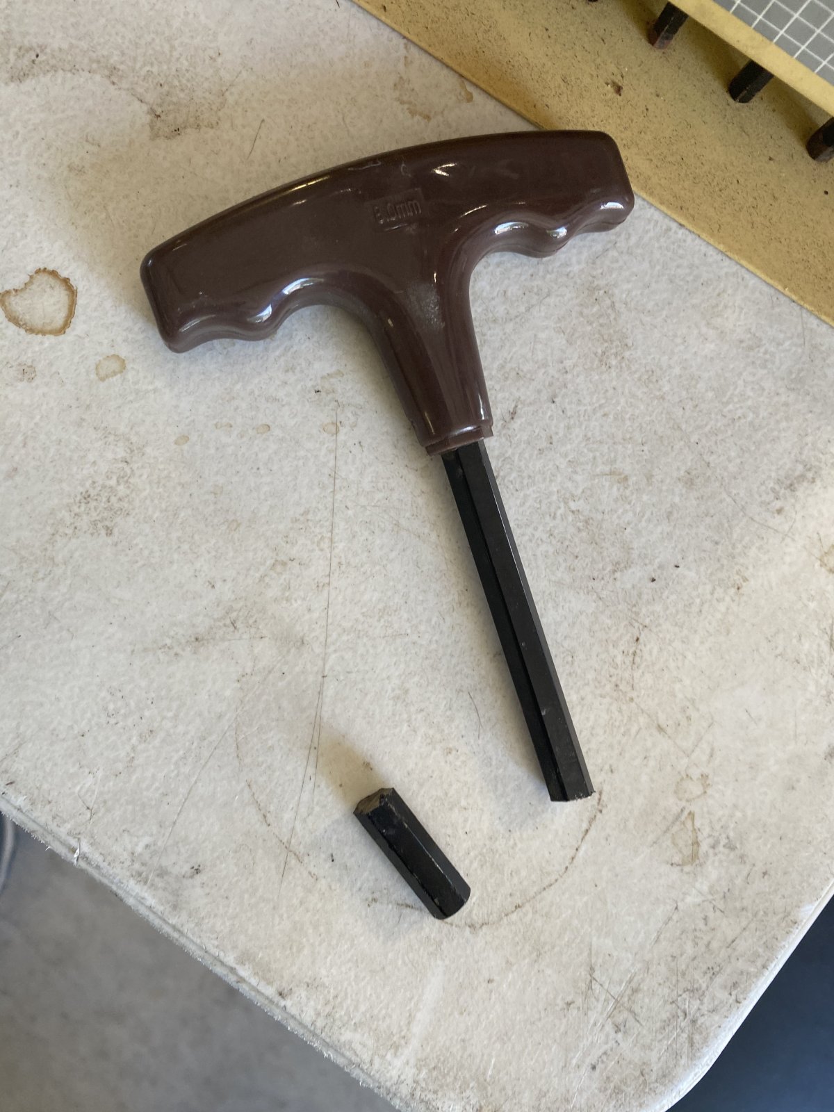

I cut an 8mm cheap-o harbor freight t-handle Allen so I could remove the trans drain bolt.

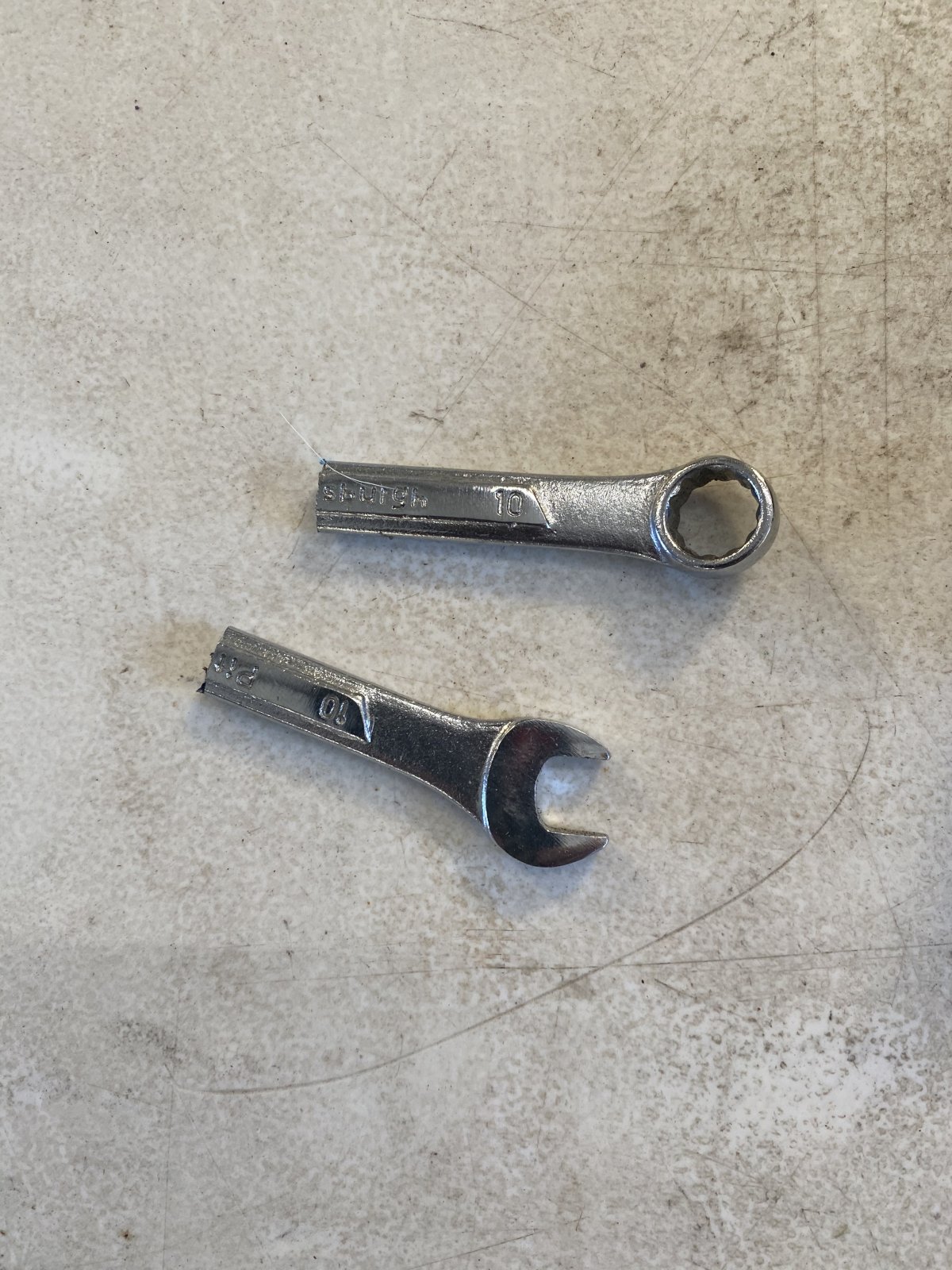

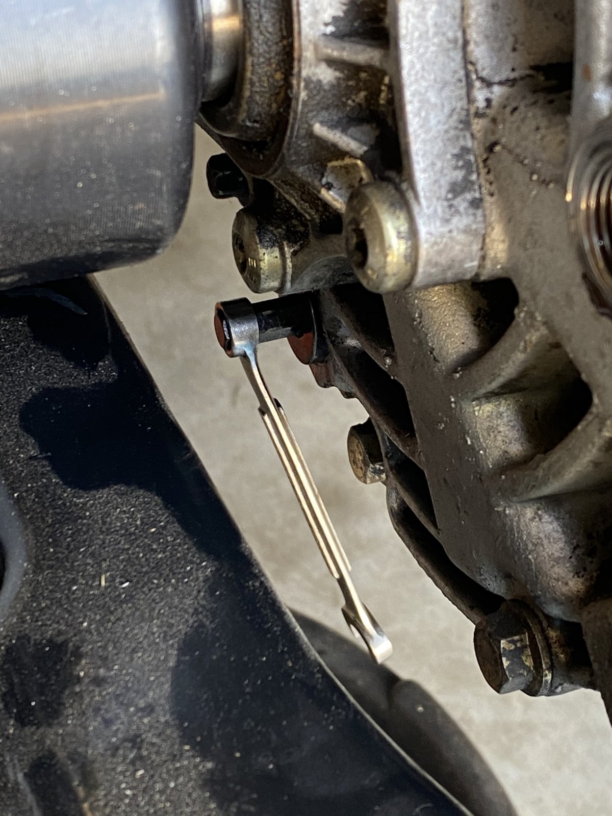

Another special tool. The rear brake calipers with a parking brake are a pain in the ass to bleed when you use a tube to catch the fluid, so I cut a cheapo 10mm wrench to get into those tight places.
dang! you just keep cutting up tools over there!!!...... :)

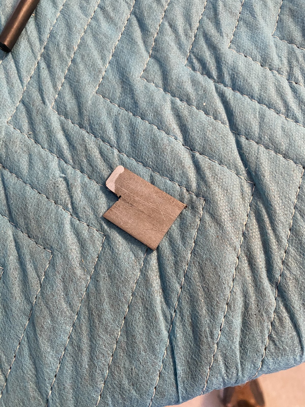

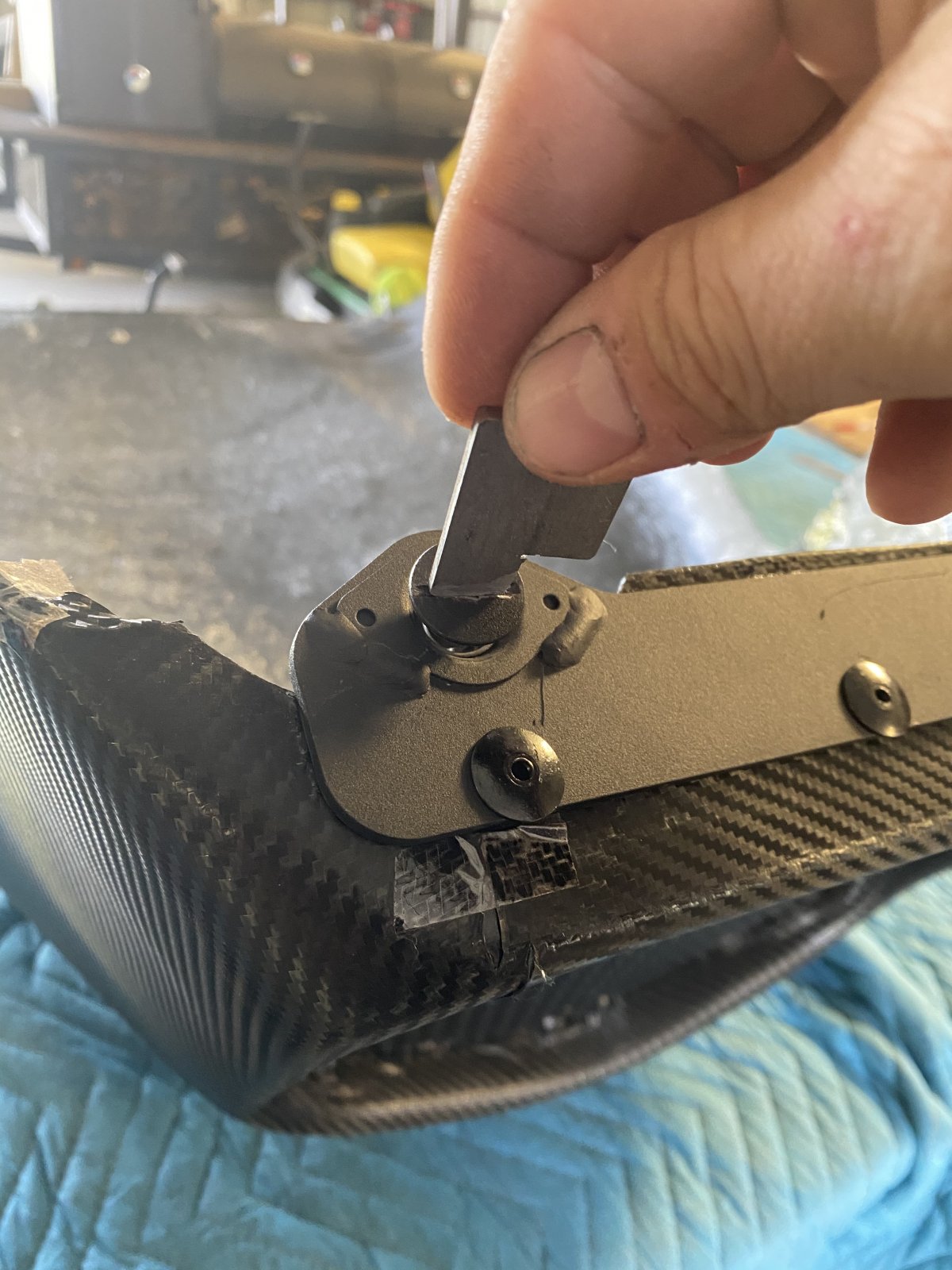

And some flat plate, cut thick to turn the quick disconnects for the hood.
