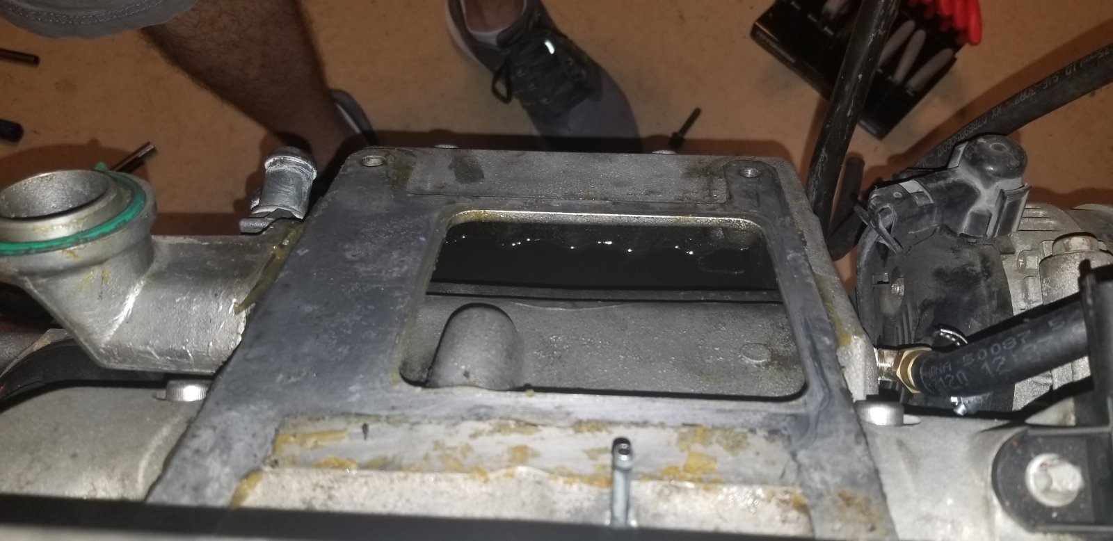

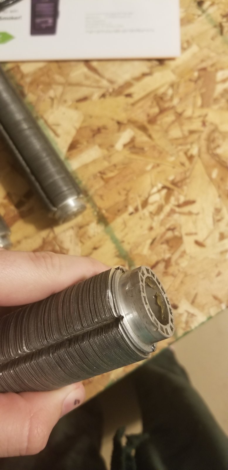

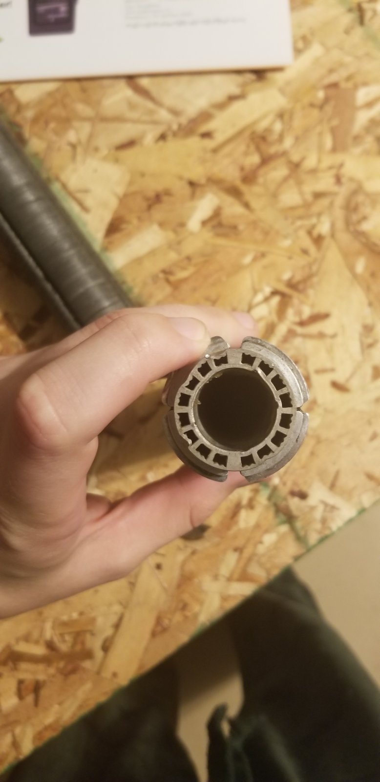

While thinking about the above, I was working on the intake manifold. When I got the car, the previous owner mentioned that he was afraid it was leaking, and boy was he right. When I took the SC off, there was a puddle of coolant in the bottom. I started to disassemble the intake manifold and found the cores to be damaged. They all appear to be damaged in the same way and the picture is of the worst one. (images below) Is this damage insignificant, or could this be causing the leak? If this needs replaced where can I find new cores. I haven't been able to find any online.
