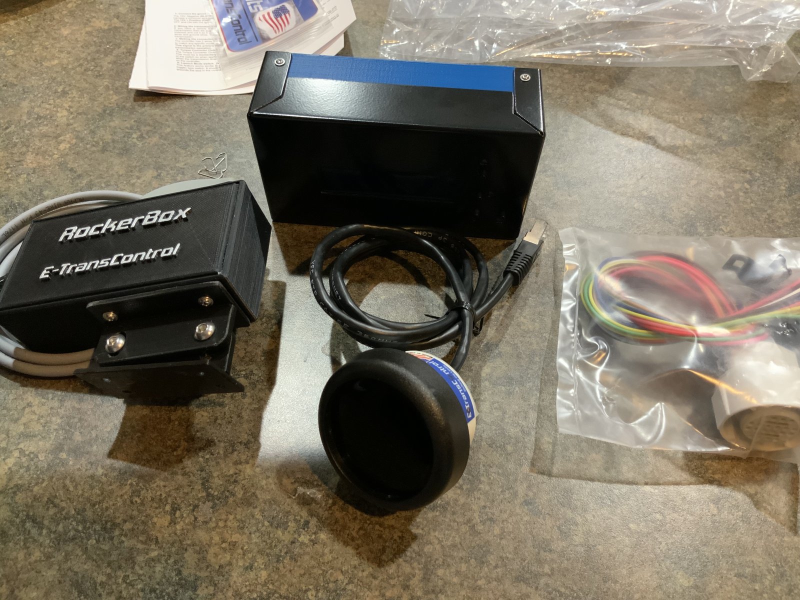

So this is what I am trying to install...
TCM 920 Transmission Controller from E-TransControl
It has a fully manual mode with converter locked and unlocked(actual line pressure control) and it also has an automatic mode... completely stand alone...

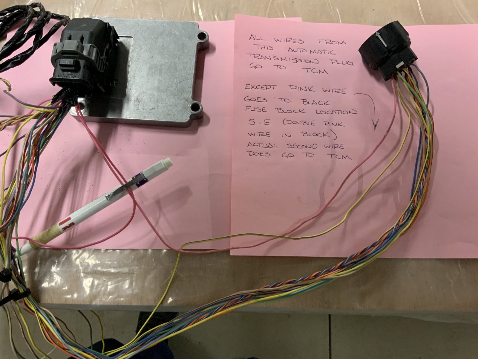

Is the circular plug all wires from that go directly to the TCM
(with the exception of the pink wire which goes to the Black fuse block location 5-E then doubles back to the TCM).

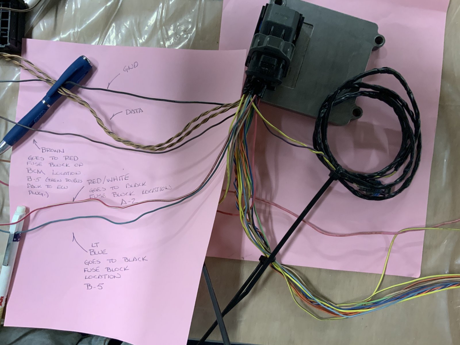

Picture #2;

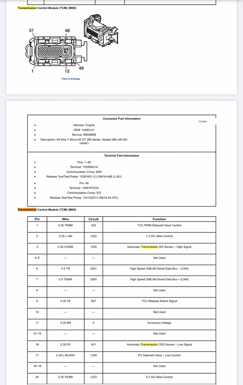

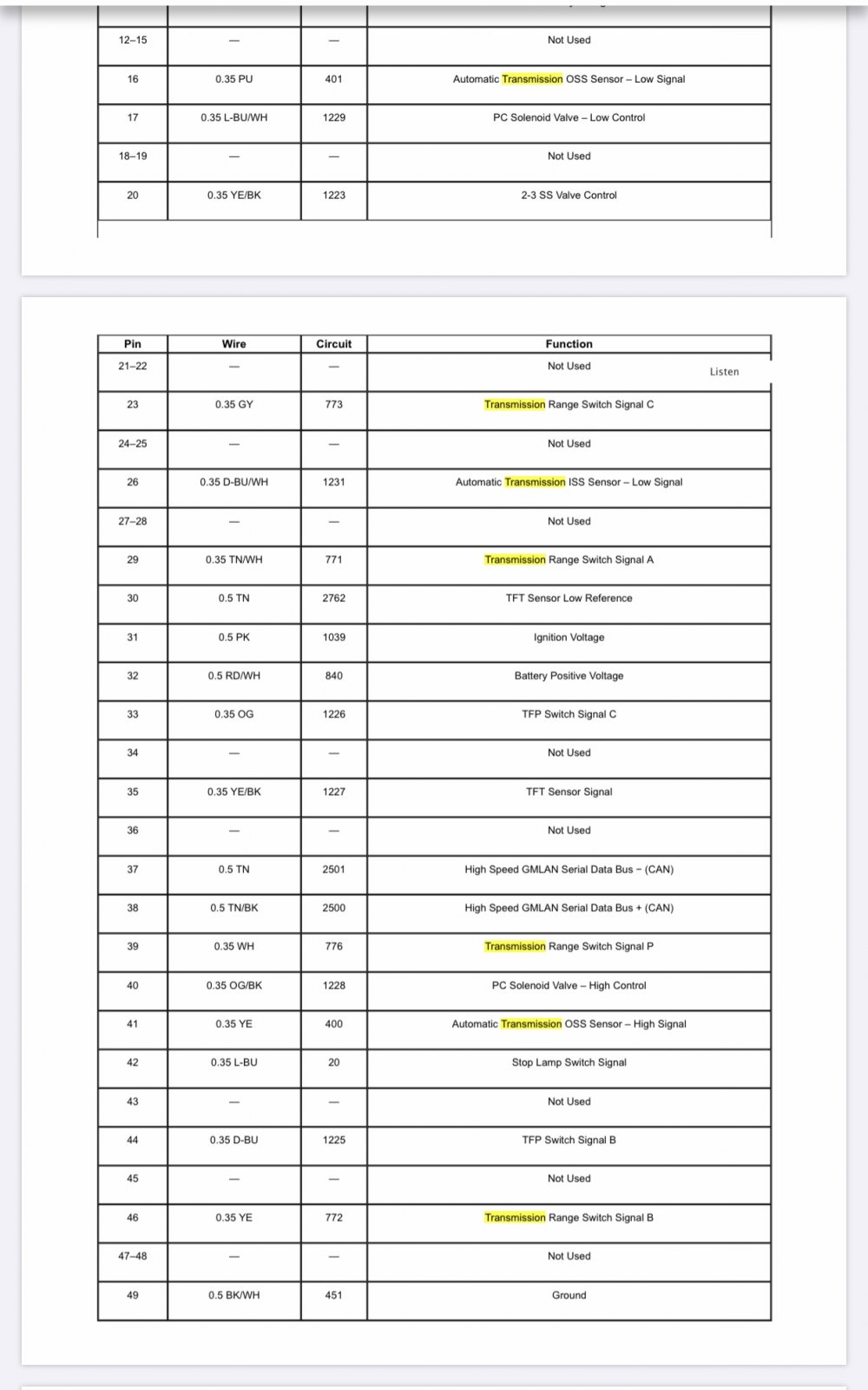

Wires from the TCM... only four wires go outside of the transmission harness
LT BLUE goes to the Black fuse block location B-5
RED/WHITE goes to Black fuse block location A-2
BROWN goes to Red fuse block on the BCM then doubles back to the ECU plug
BLACK goes to ground
DATA wires just go to and from the TCM

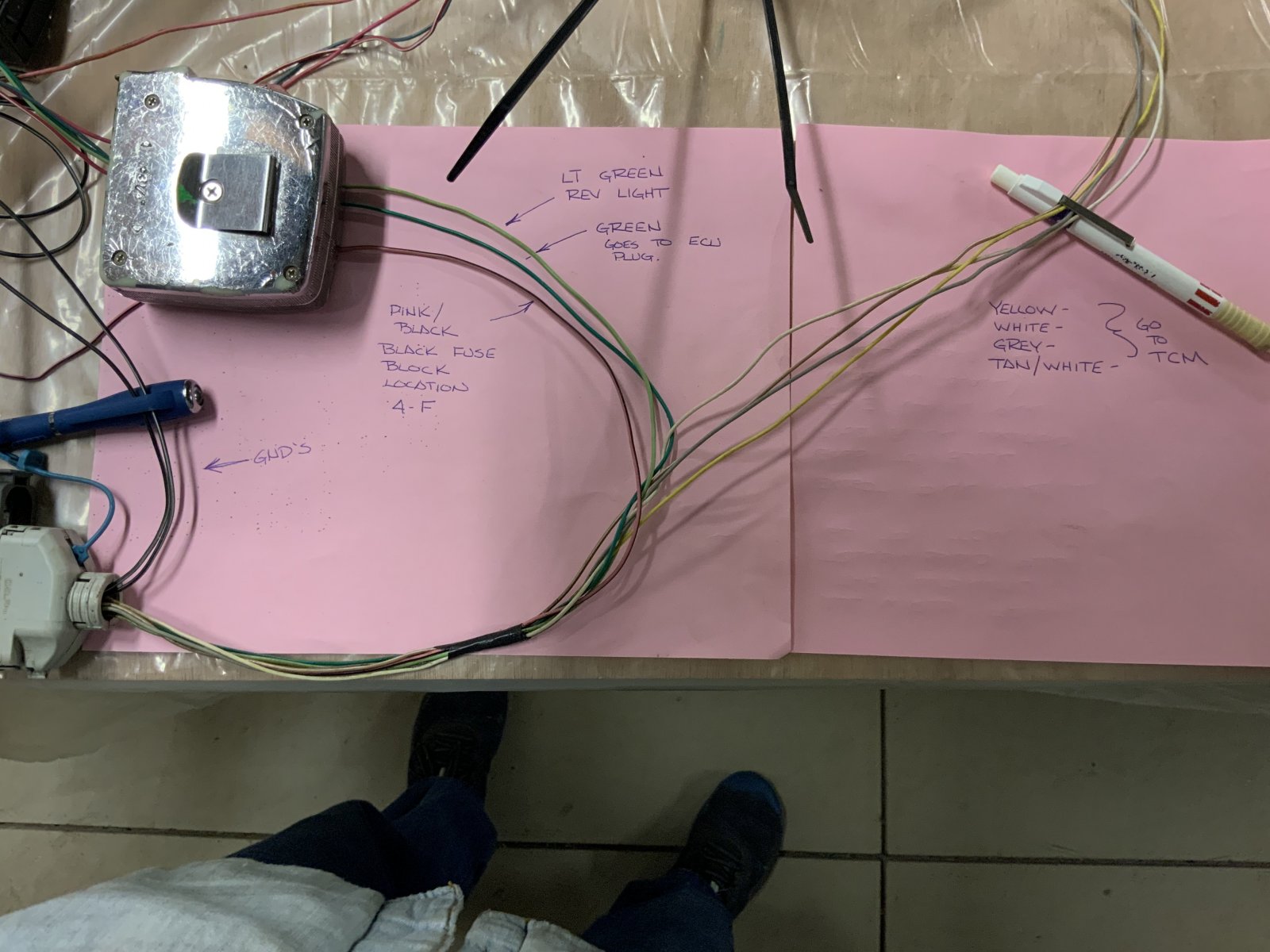

Wires from the automatic transmission selector on the transmission... only five wires go outside of the transmission harness
(2) BLACK go to ground
LT GREEN goes to the reverse lights
GREEN goes to the ECU plug
PINK/BLACK goes to the Black fuse block location B-5 (miss noted in picture)

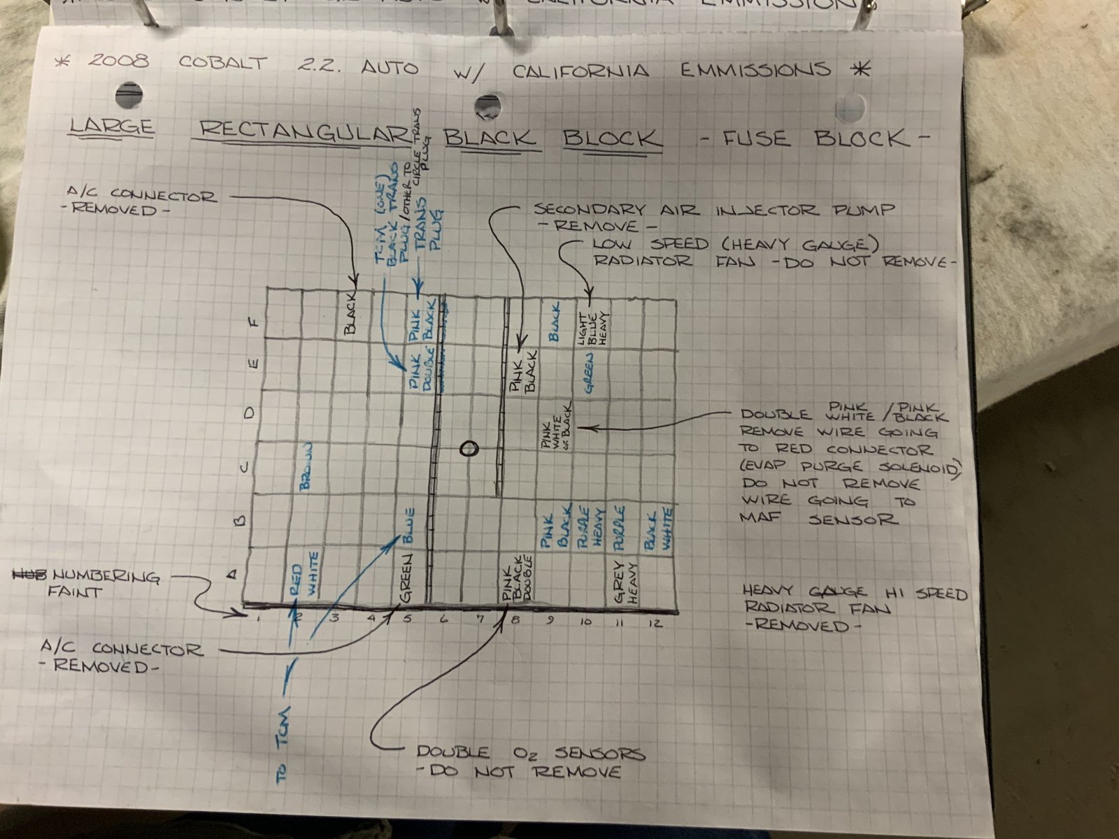

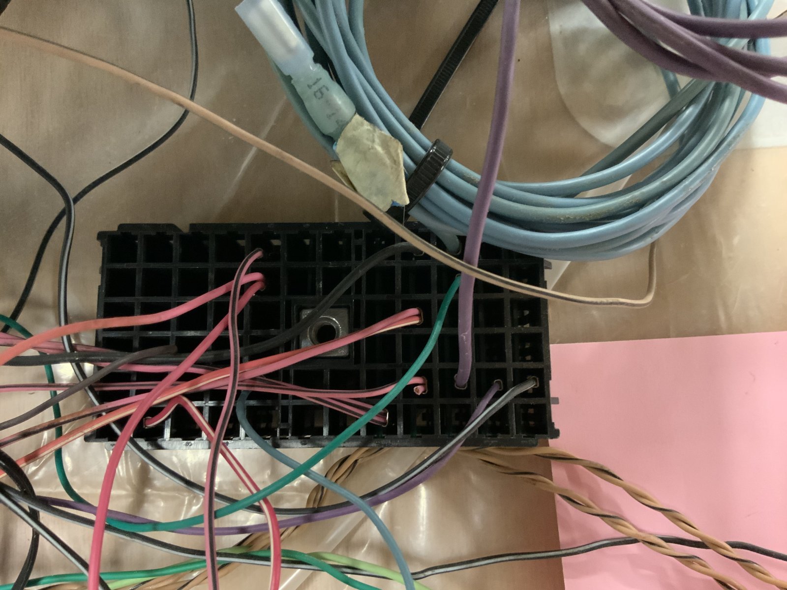

Just the Black fuse block and my notes...
Basic question... if I eliminate the entire TCM, circular plug, and selector plug.
if I tie the data lines together to eliminate that loop. What else will I need to keep?

All right first question. With my current harness the car will not start with the TCM unplugged. But will run if you start it with the TCM plugged in and then remove the plug once it is running. I’m guessing it is the Data wires need to be tied together to eliminate the TCM from the loop.

If you get one the rockerbox or switchblade shifter units, those have a knob to adjust line pressure. The TCM920 has that adjustment set in the programming.
BAR-AIR
That is what a got the rocker box with the line pressure and torque converter lock and un lock the TCM 920 also has an automatic shifting function.
