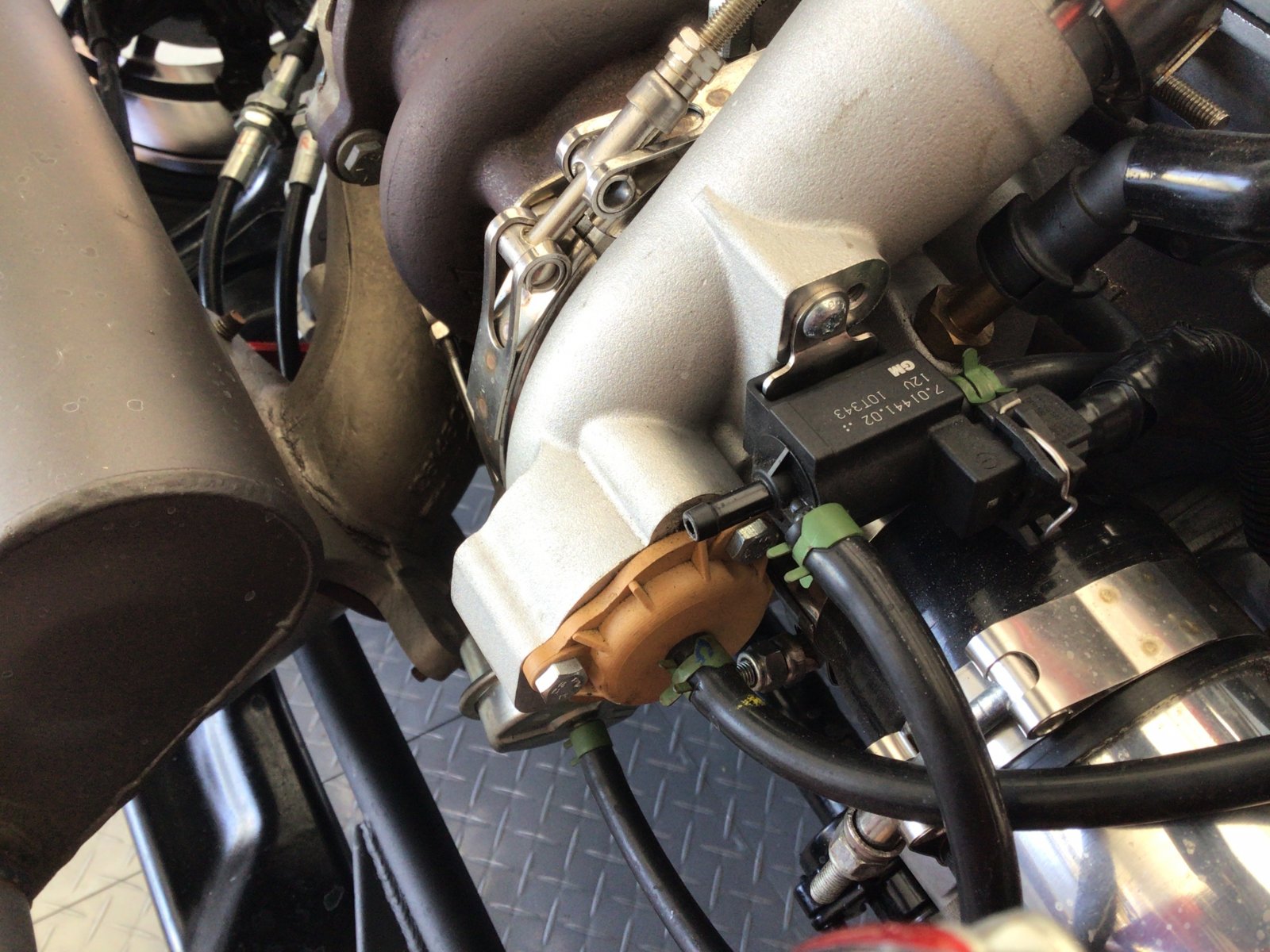

I have this open on my turbo, if I block it off the turbo doesn’t work, I guess that would effect the vacuum.
Justin Reed emailed me and said that’s what he did , so I figured it was good enough for him it would work for me :)

R
Not sure what that part is exactly, but it looks like a T connector in essence. When you say you blocked it off, did you put a plug on it, or did you run it to a vacuum source? That could be the reason as it looks like the one line is going to the bov (assuming that's it) below.
Edit:
So that's the wastegate, not the bov (dumb me). The T part is the wastegate actuator control solenoid and the one line that's open is the atmospheric reference vacuum line, so leaving it open like that shouldn't affect anything. Unless you are venting the wrong side of the control solenoid and have the atmospheric side connected to the boost refence vacuum line and you have the boost reference line open to atmosphere o_O

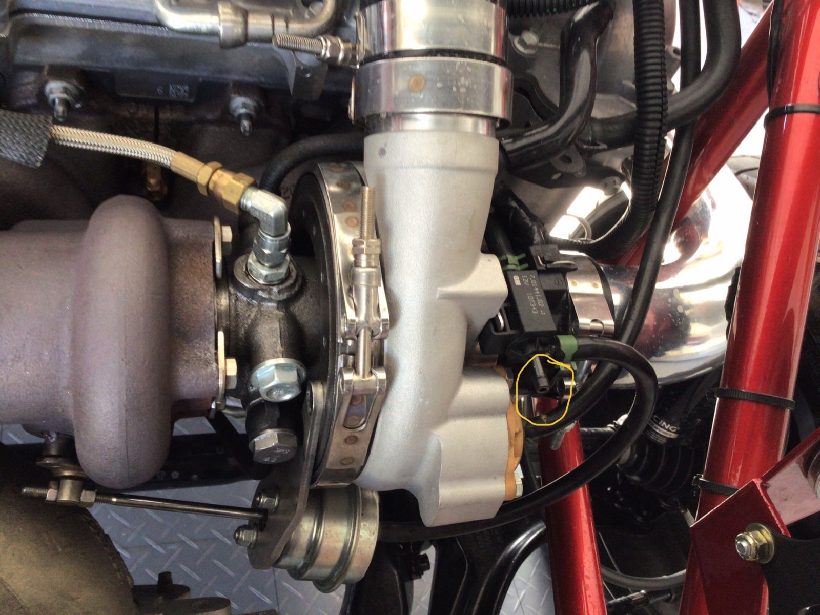

I plugged it up. I just sent a email to ZZPERFORMANCE sense I bought the engine from them and I‘m doing a remote to with them also. To ask about gobble noise
R
Definitely let us know! the z57 package comes with the remote tuning as well, but I haven't had time to pull the stock file (or even start the engine build) so I have no idea if I'll have that gobble noise or not (hopefully not). Out of curiosity, where do you have the bpv plumbed to?

The only lines I hooked up to the turbo was the water line and the brown looking vacuum thing, The rest was all done by ZZP
